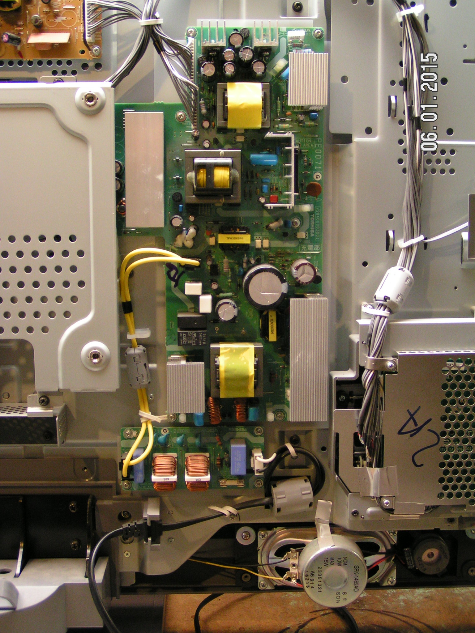

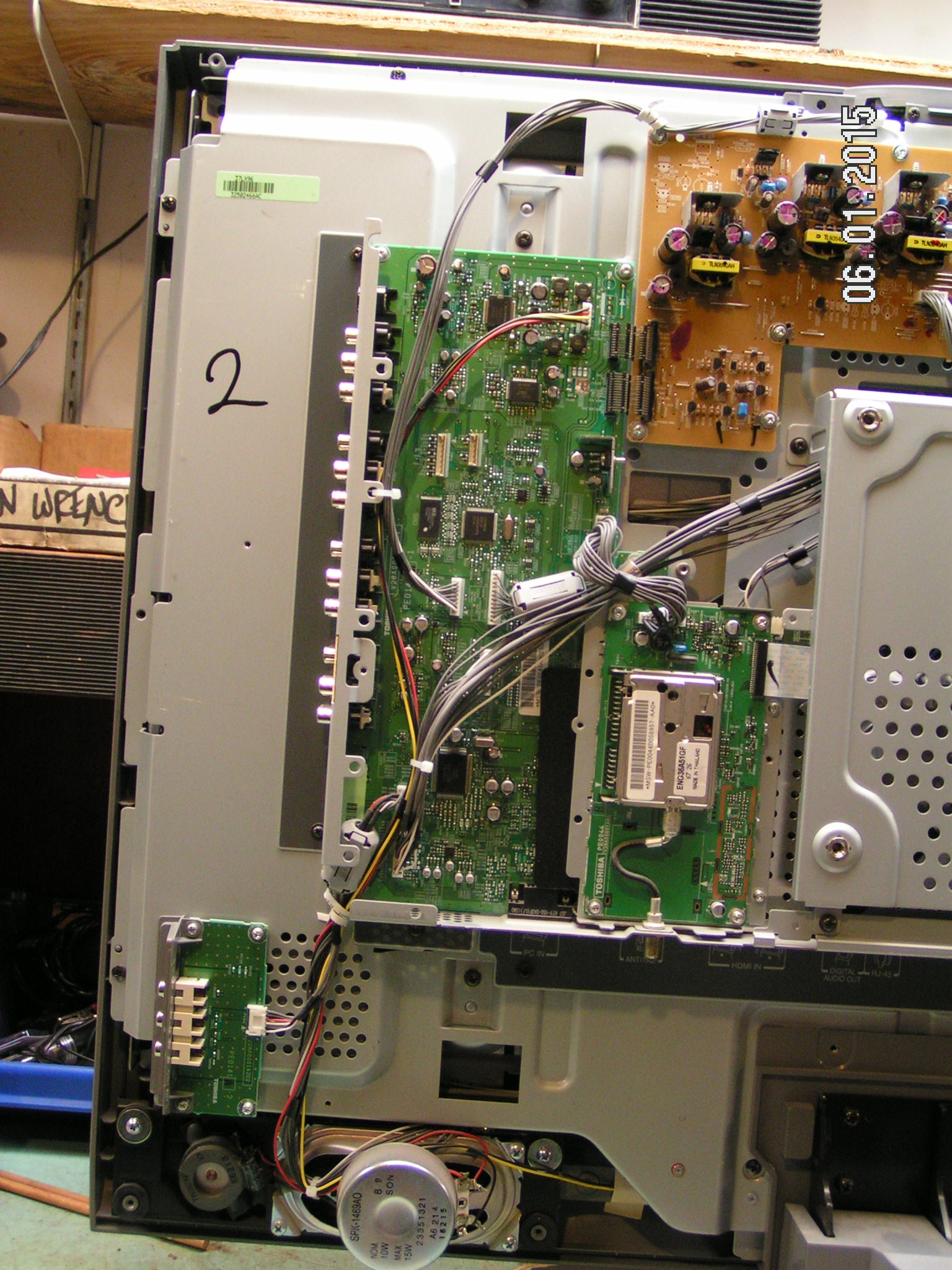

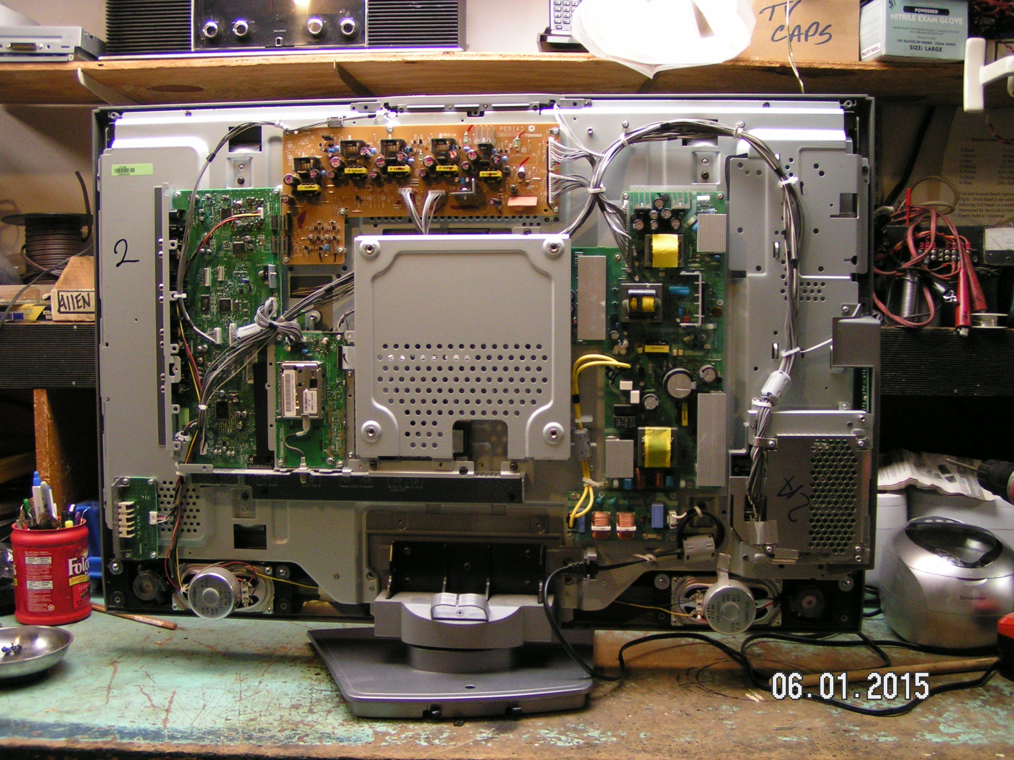

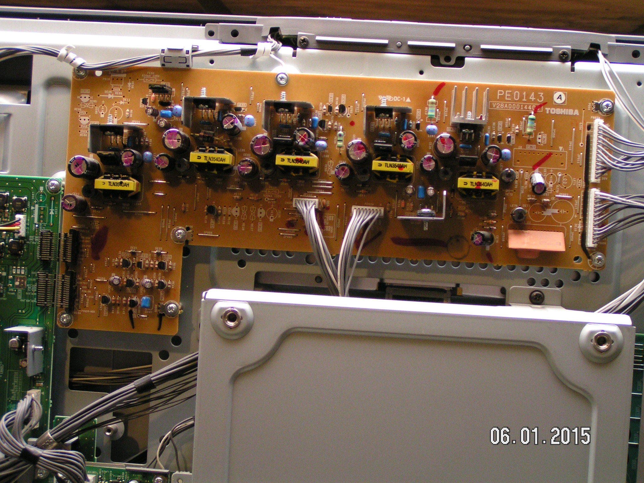

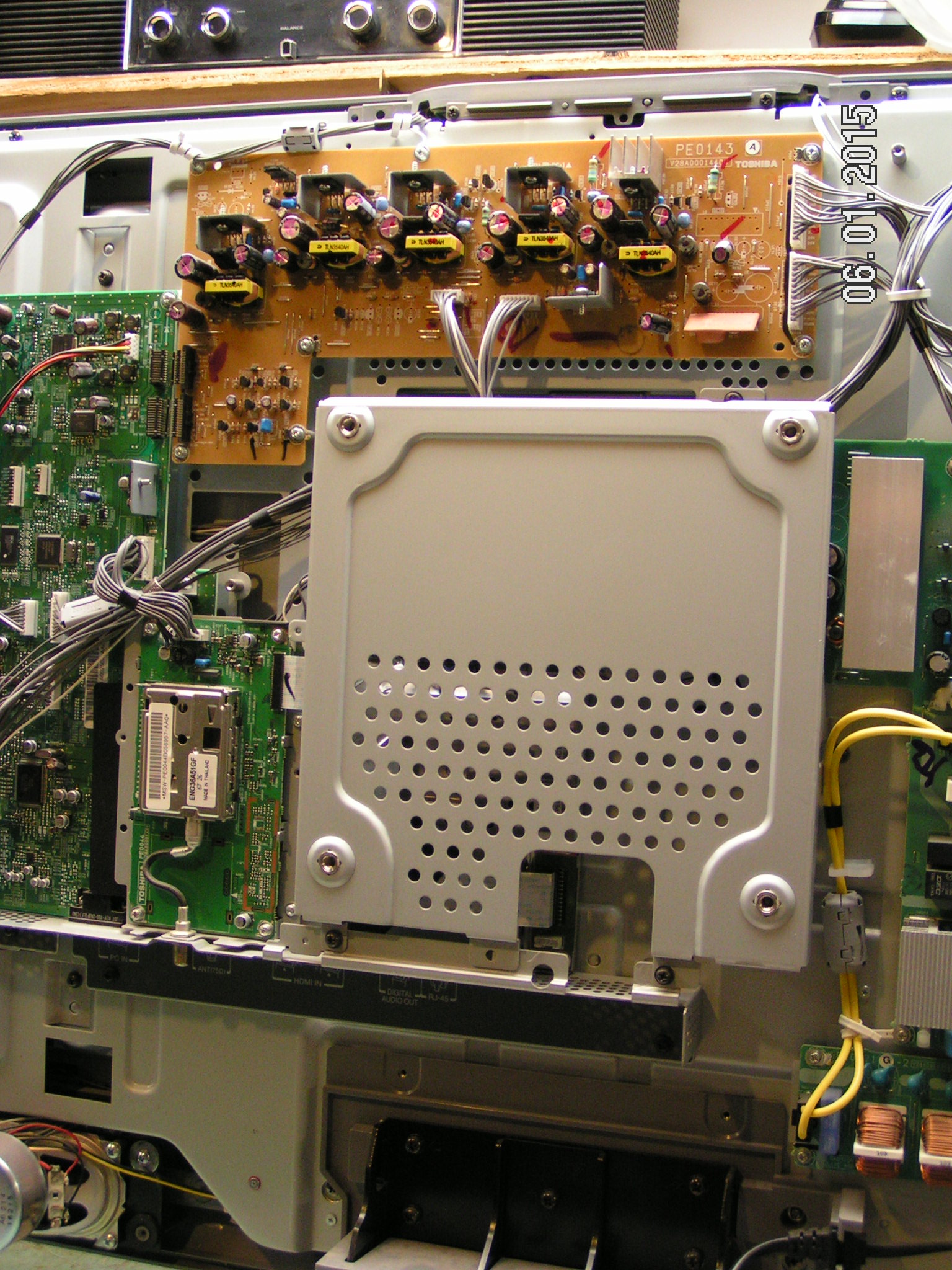

      Toshiba 37LX96 blinking yellow light
      Saw this older post where you had an identical set and wondered if you'd worked out the problem.
      Plugged in, I hear one click and then a series of three amber blinks that repeats, no audio, no video, no back lights, nothing. Pushing "Power" button has no effect.
      Were you able to resolve this?
