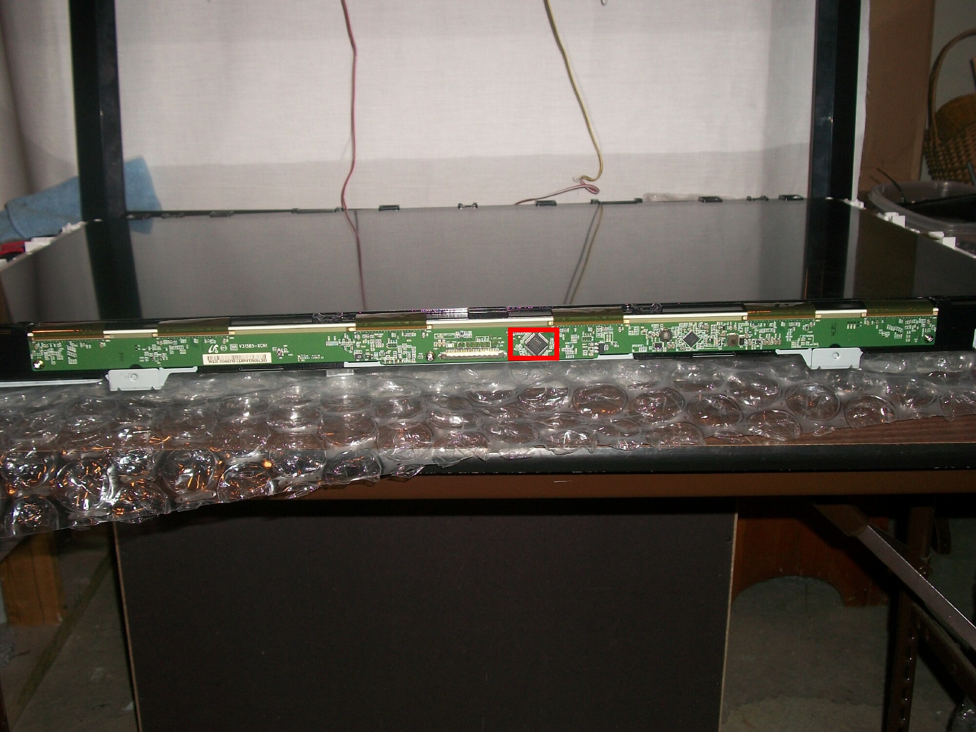

I found a continuity link between the 3rd leg of the AQU125 and a CM1685A which is a voltage regulator. I have attached a redlined picture of the part. There were several pins around the part that beeped. There was also continuity to several caps and at least one diode. I could not find a Data Sheet on CM1685A, but was able to find several suppliers for the part. Neither Digikey nor Mouser carry it so no Data Sheets from them. I have emailed the only US company that carries it hoping they will send me a link to the PDF. Hopefully it will tell us what the AQU125 is.
