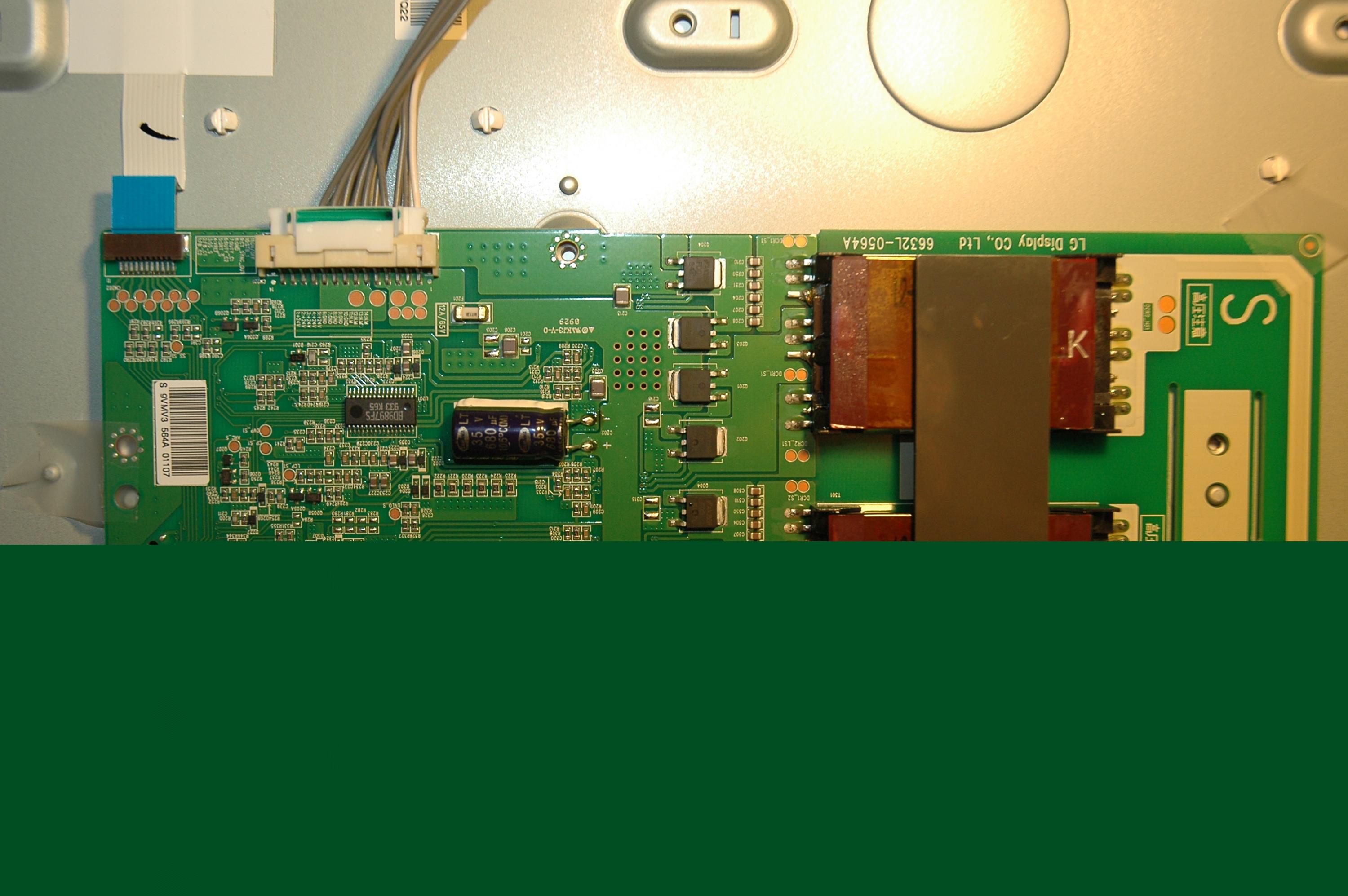

    Ok - I have read up on this for hours and not to repeat what has already been said but I would like to be sure before buying inverter(s).
    I have checked both Master inverter and Slave inverter inputs from power supply and leads that are marked as 24v have 24v.
    When TV turned on, sometimes constant green LED and sometimes constant flashing orange on front of TV; Toshiba logo within frame does light up. According to manual flashing orange means "Abnormal operation of back light. Turn OFF the TV and unplug the power cord. Plug the power cord in again and turn ON the TV." Putting a flashlight on the screen does allow you to make out picture and menu. I did a reset via the menu (while using flashlight). When applying an open circuit (1 probe from voltmeter) to one of the leads going from the slave inverter going to back of set, when no video input, I am able to see part of the TV Setup Menu (about 15% brightness upper left side of tv), this "trick" does not work when sending in video.
    Now I have read some posts about checking the fuse on the inverter; I don't see any fuse on either Master or Slave inverter. I see some posts saying issue could be caused by video controller though unsure if that is hearsay.
    So I guess my question is do you think this is an issue with Master or Slave inverter and if so how do you tell which one? Other issue? I am not an Electrical Engineer but I did stay at a Holiday Inn Express the other night.

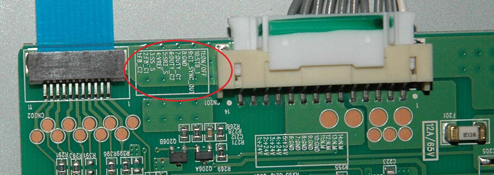

    You can see F201 in the picture of the inverter board.

      Thank you. I am measuring 24v on each side of the fuse (both slave and master inverter) and I believe 120v each side of fuse on controller
        Re: Toshiba Regza 47ZV65OU black screen with sound
        You are getting the 24VDC from the power supply OK, you need to look at the BL_ON (backlights ON) pin to see if it has 3~5VDC on that pin.
        I do not know if your inverter board has labels on them to tell you what pin is what or not.

          I am looking to for anything "BL_ON" or similar. Is that pin on both the Slave and Master Inverter?

            Would you be referring to pin 11 noted here on slave?
              Yes, there should be one on the master also.

                3.3v on Master and 3.3v on Slave
                  So the ON signal is OK. That means more in-depth troubleshooting needed. It can be the PWM IC is bad.

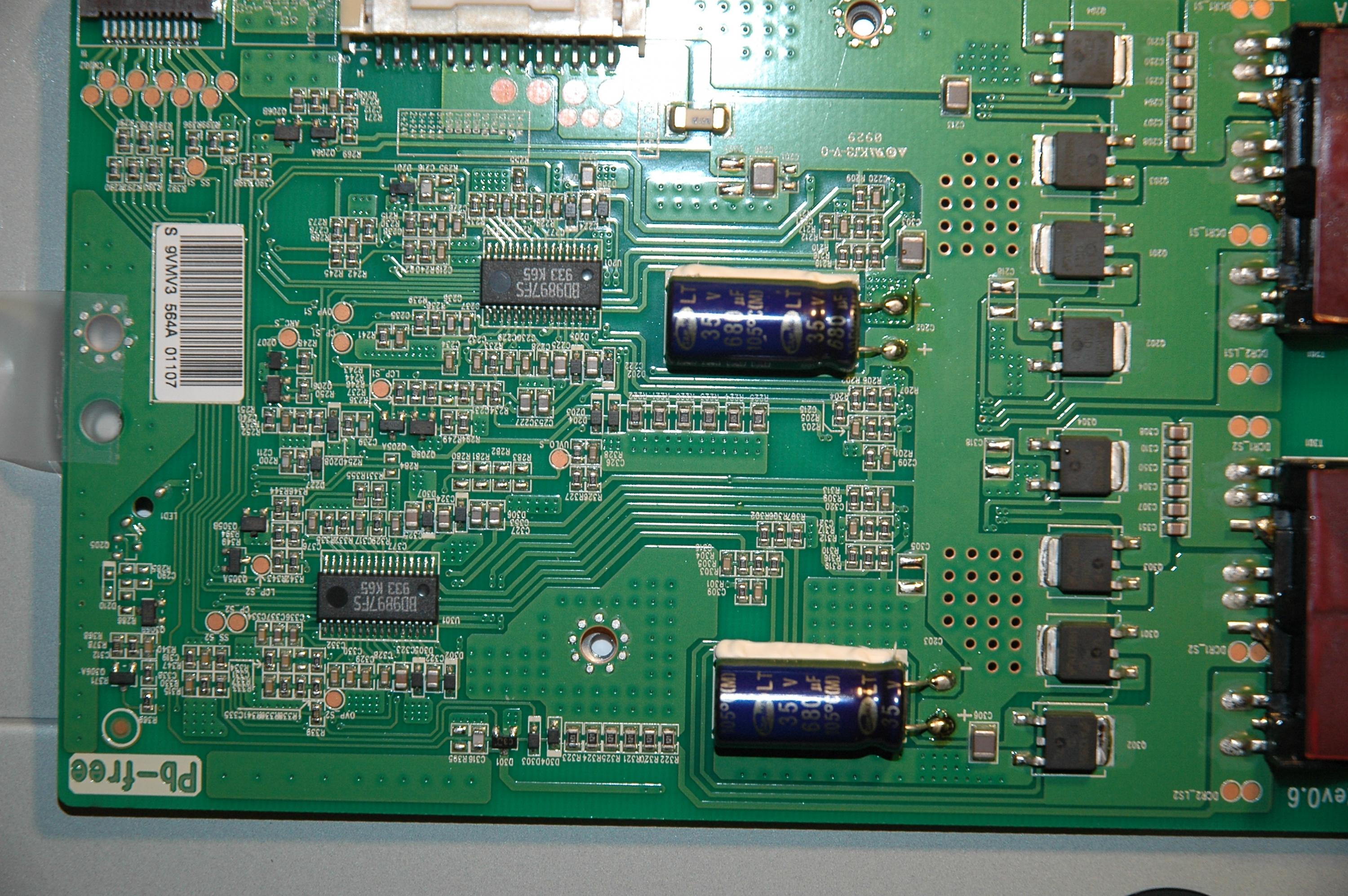

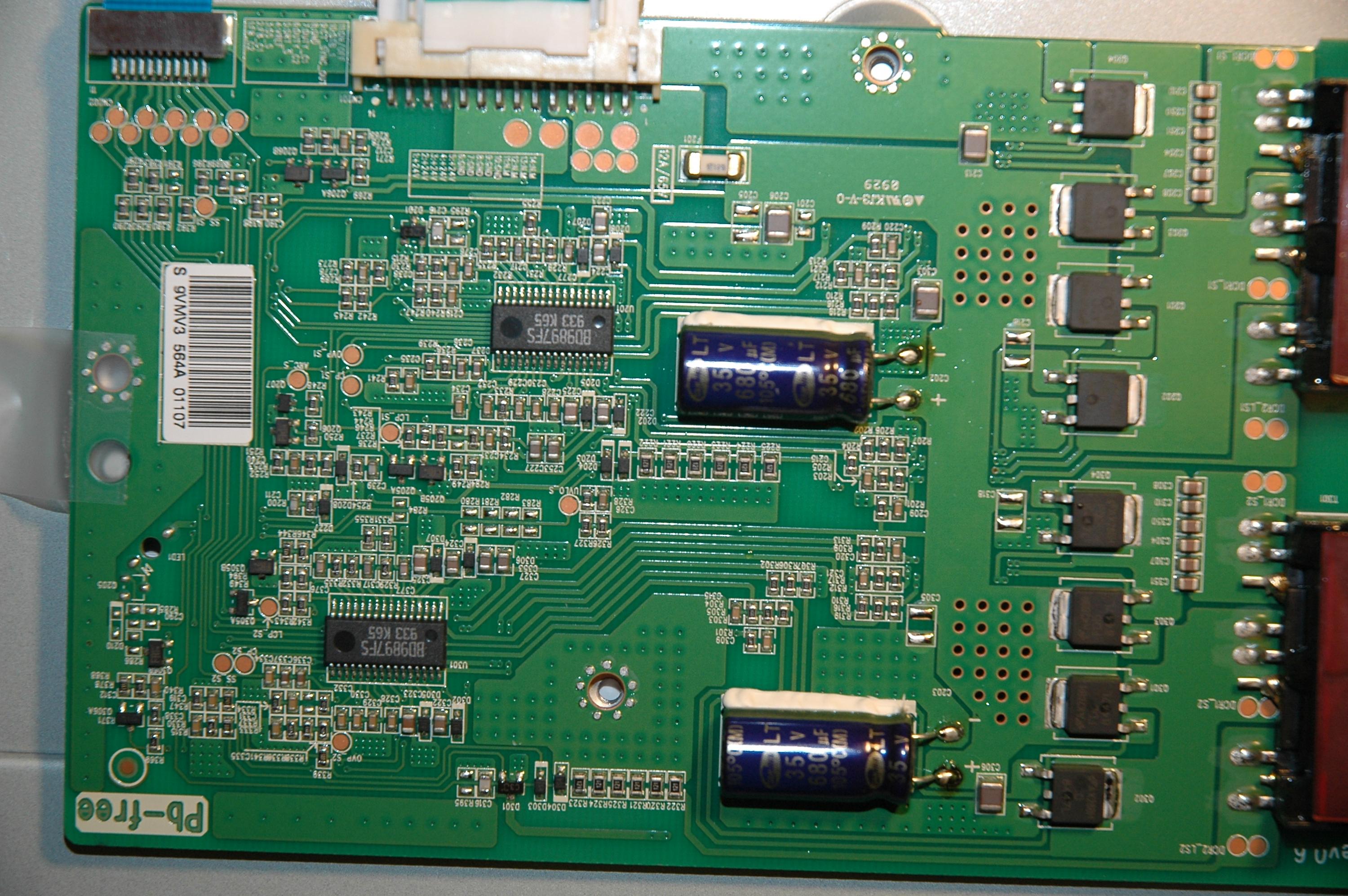

                    I had to look that one up. The Pulse Width Modulation Integrated Circuit consists of the 2 rectangular chips on each inverter? Is there any way to trouble shoot with a multimeter or narrow down to a circuit board?
                      Yes, those two are the PWM IC, have to get the spec sheet first and then check each pin to ground to see if any one of them has shorted to Ground. The spec sheet may also give the application notes on how they are common.y connected to form the circuits.

                        Chips on inverters are:

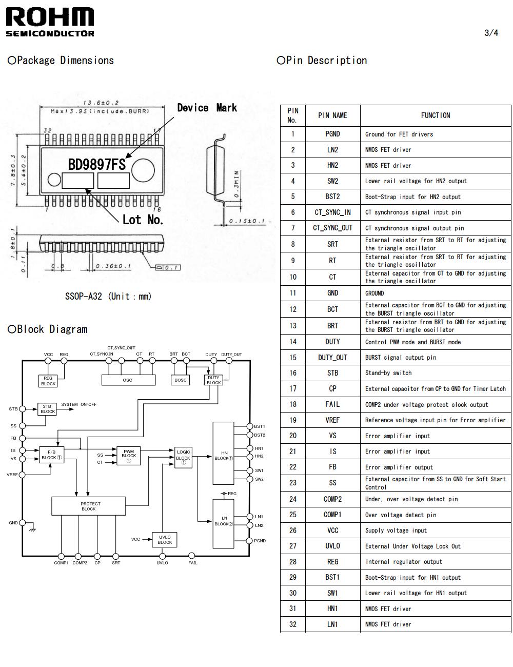

                        BD9897FS
                        933 k65
                        I found the attached at the following though I am a little confused on what I need to be checking. Am I just checking that I have ground on pins 1 and 11?
                        http://www.alldatasheet.com/datashee.../BD9897FS.html
                          Simple test is to find out if any other pin beside the ground pin are shorted to ground, as I indicated on post9, hope the lamps are not broken during transit. The inverter boards have the 24VDC and the BL_ON signal, so all the required signals are all there.

                            Another test to be done is testing the transformer windings, Do you have the P/N as printed on the transformers?

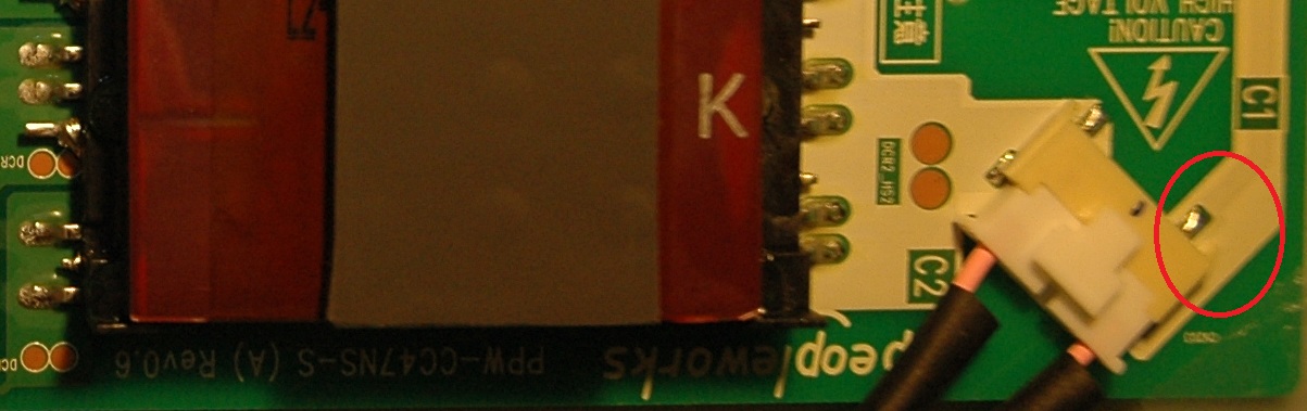

                                  Lamps do not flash, not even for a second and I viewed both front and back of TV with cover off when powering on. I was checking some voltages earlier and for whatever reason 1 lamp came on at least partially when tv has no signal input and an open circuit applied; I attached a picture and circled the pin that gives me a partial lamp when open circuit applied.
                                  There were metal shieldings over the inverters; shieldings have been temporarily removed. Part numbers "Peopleworks PPS-CS47NS-S and PPS-CS47NS-M". Slave part# in picture as well.
                                  I am leaning towards what you said earlier in that lamps may have been broken during transit or perhaps a weak weld came loose.
