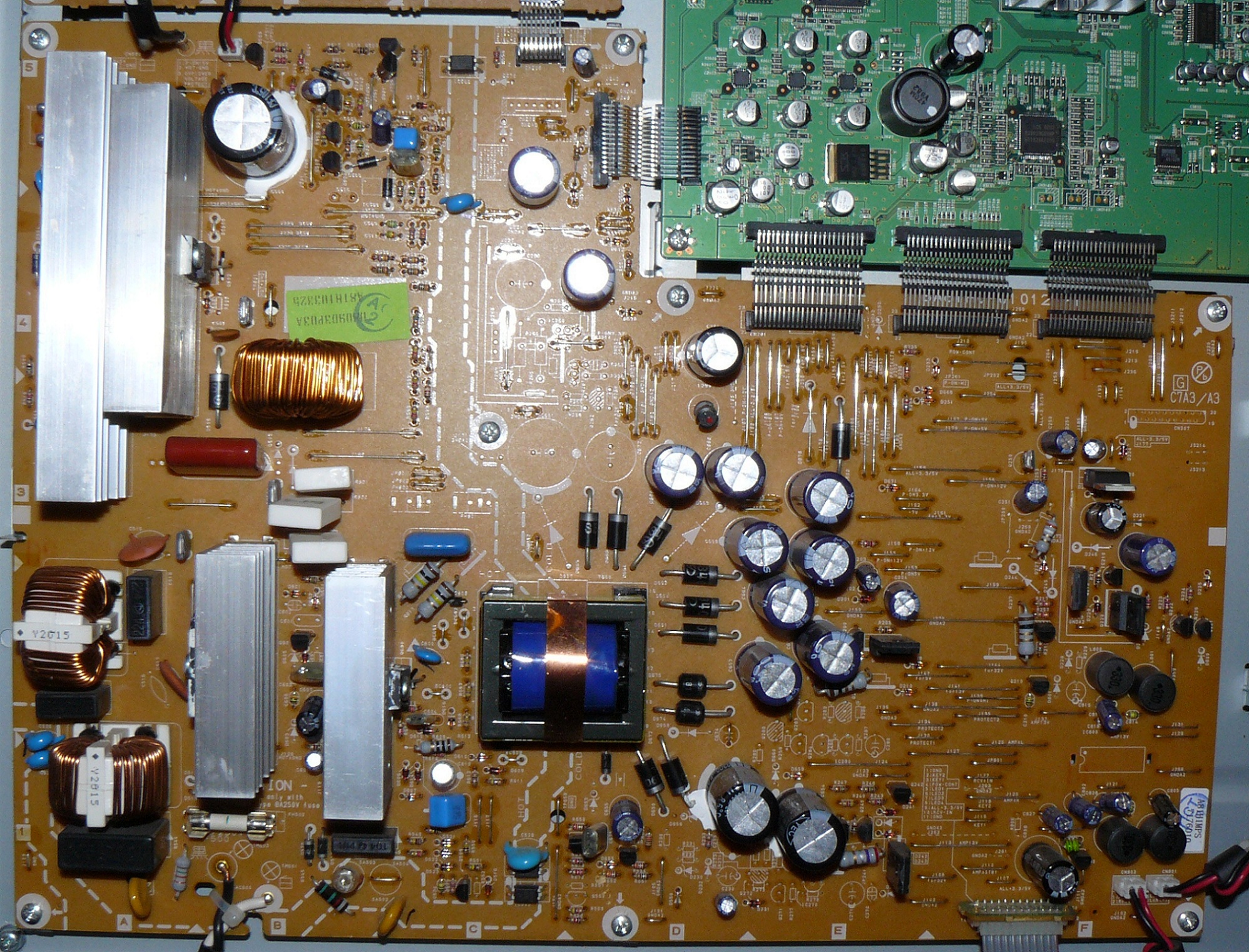

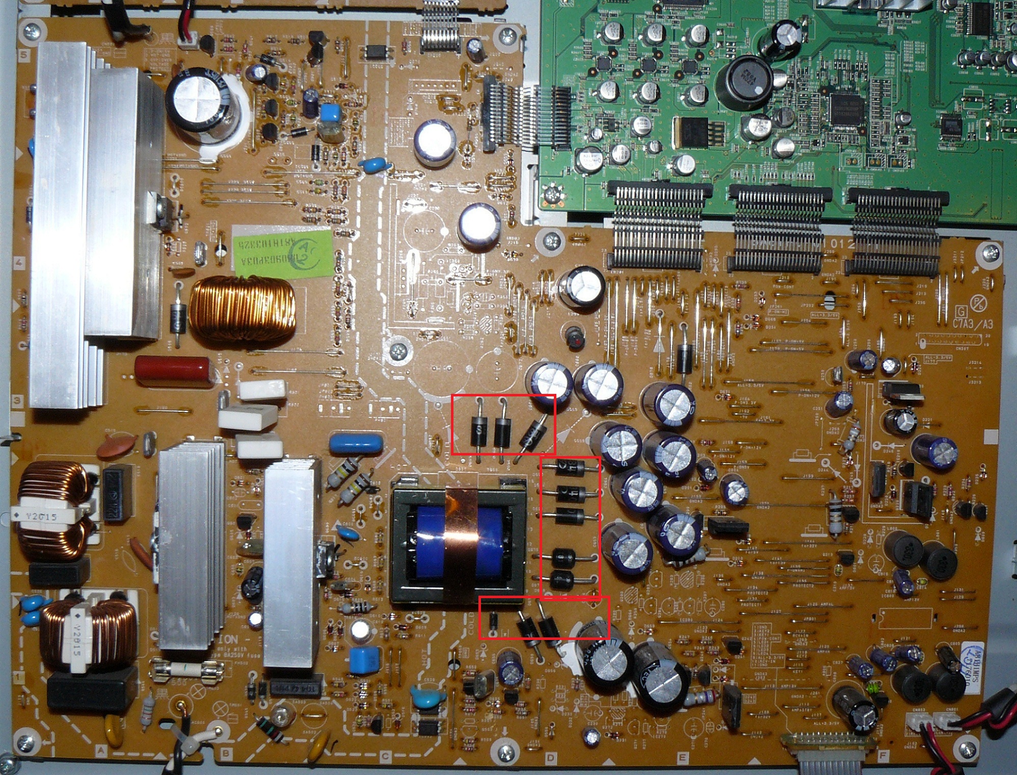

    I picked this tv up yesterday. It was completly dead. Turned out to be a shorted schottky diode. Replaced it and the tv came to life. It physically works but the only issue (complaint) i have is the transformer emmits a audible buzzing noise when the tv is in standby. I used a cardboard roll and used it as a makeshift stethescope. There is no noise when the tv is on. I did notice on ebay there is a "repair service" for my issue. So this makes me think that it's a cheap and easy fix. I've tested all the diodes on the power supply but thats as far as i have gone.

      In the end i found out what was causing the issue. There was a service bulletin on this issue. D655 needed to be removed from the power suppply. So the repair service on ebay was to remove a little zener diode and charge you $80.

                  D655 was removed and the buzzing in stanby went away? Does your board look like mine in post #1 since i see your from the UK?
                    Re: Sylvania LC420SS8 Buzzing When In Standby
                    Yes its the same board, its a US spec TV ( I am USAF stationed here). No I mean for the original power problem. You said it was a shorted Schotkky diode? Just trying to narrow the search. But it did have the buzzing too, so that will get removed thanks to you.
                      I can't remember exactly which diode was shorted making it dead but it was one of the diodes i put squares around.
                        Thanks, I will look at those more closely. When I was randomly testing diodes today I noticed like 4 of those had continuity but I think they had common connections. I will let you know how it goes.
                          Ok I found a shorted diode, its the one on the right next to the tall cap in the bottom square. They are parallel so they both shot bad till I desoldered one to isolate. Its an SB 390 which is a 3A forward continuous current, 90V peak reverse voltage. I have a SB 360 on hand which is 3A 60V reverse. Do you think it would be close enough? Or do you think the difference is too much?

                            There's probably a reason they used 90V there, but the 60V will probably work for a quick test, I'd expect it to fail quickly though.

                              Just wanted to say thanks, the diodes came in the mail today (I decided just to order the right replacement rather than chance it) and I replaced the pair and the set came right up. I instantly heard the buzzing (very obnoxious) and clipped the D655 and it stopped. Thanks for posting that service bulletin.
