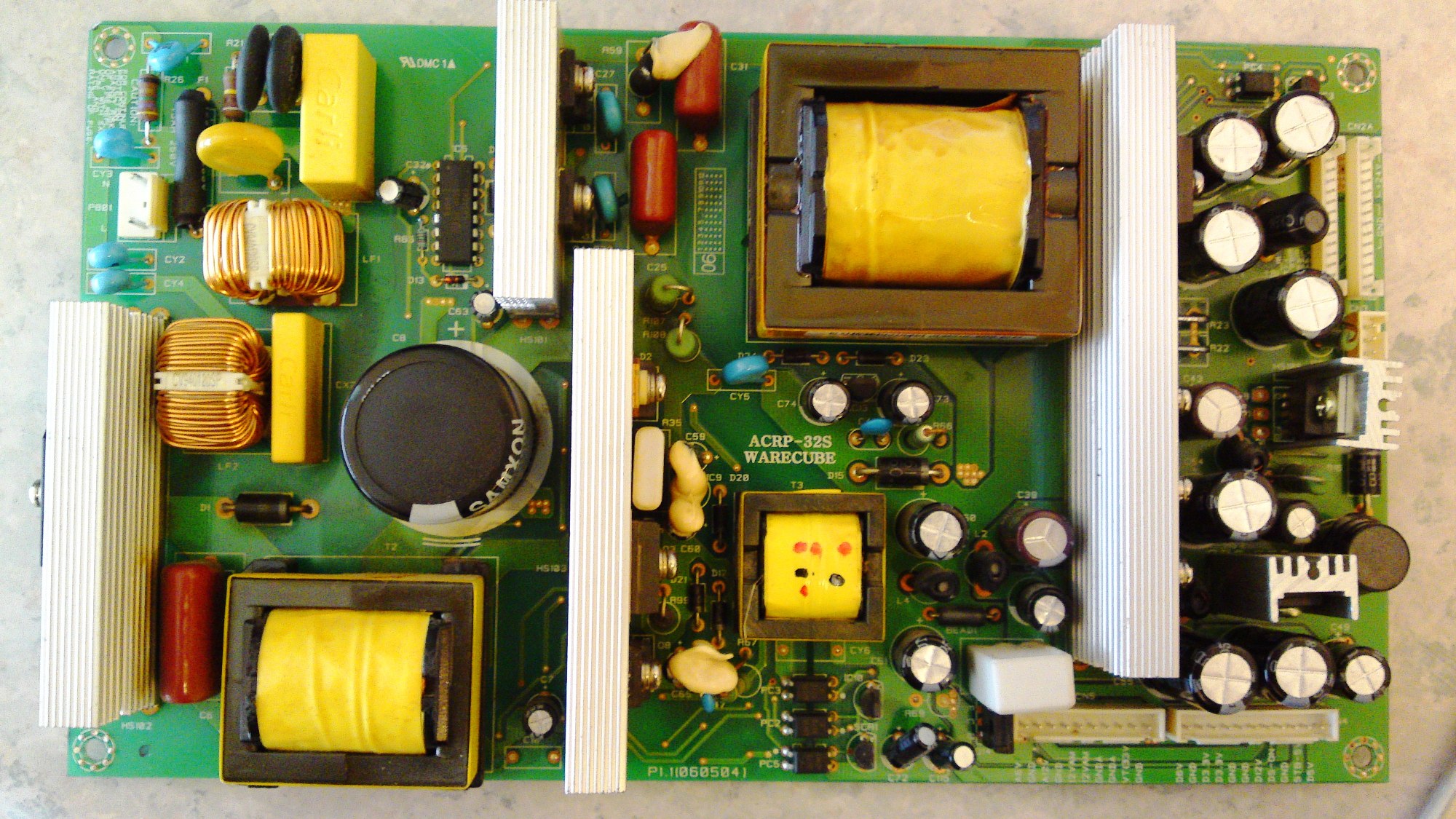

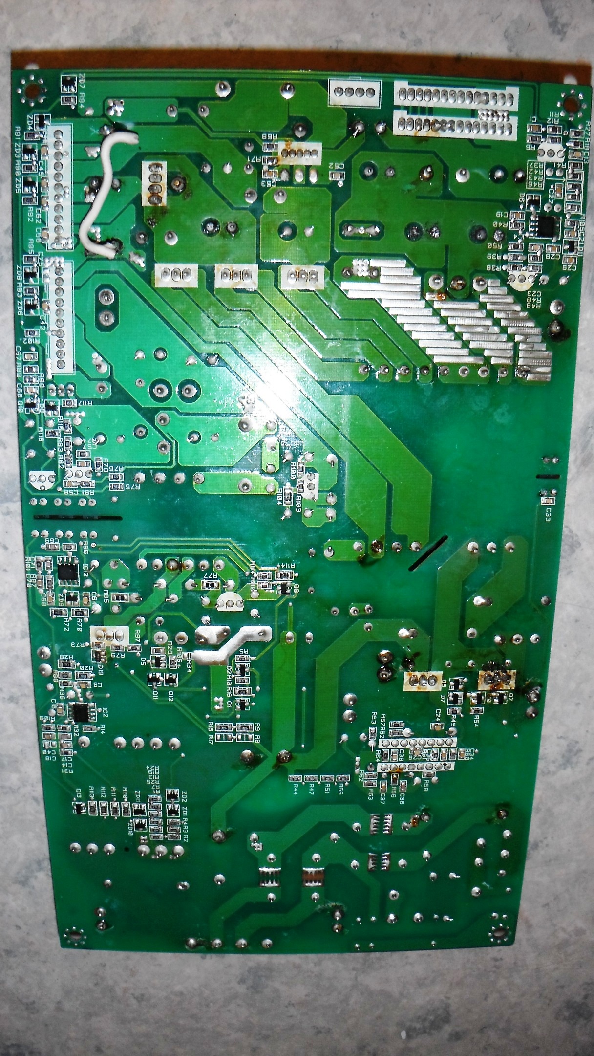

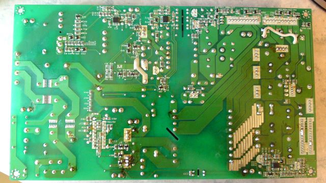

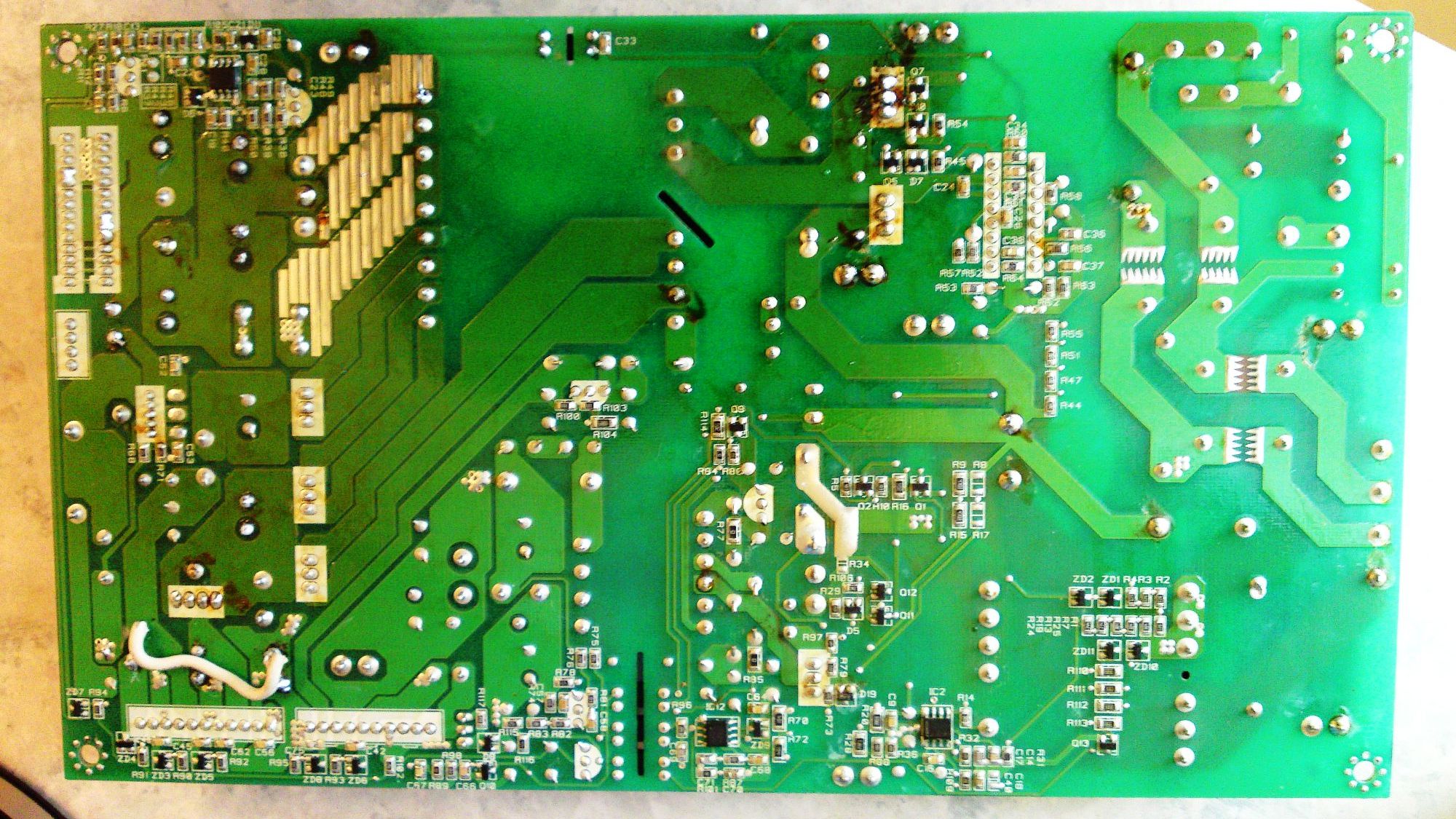

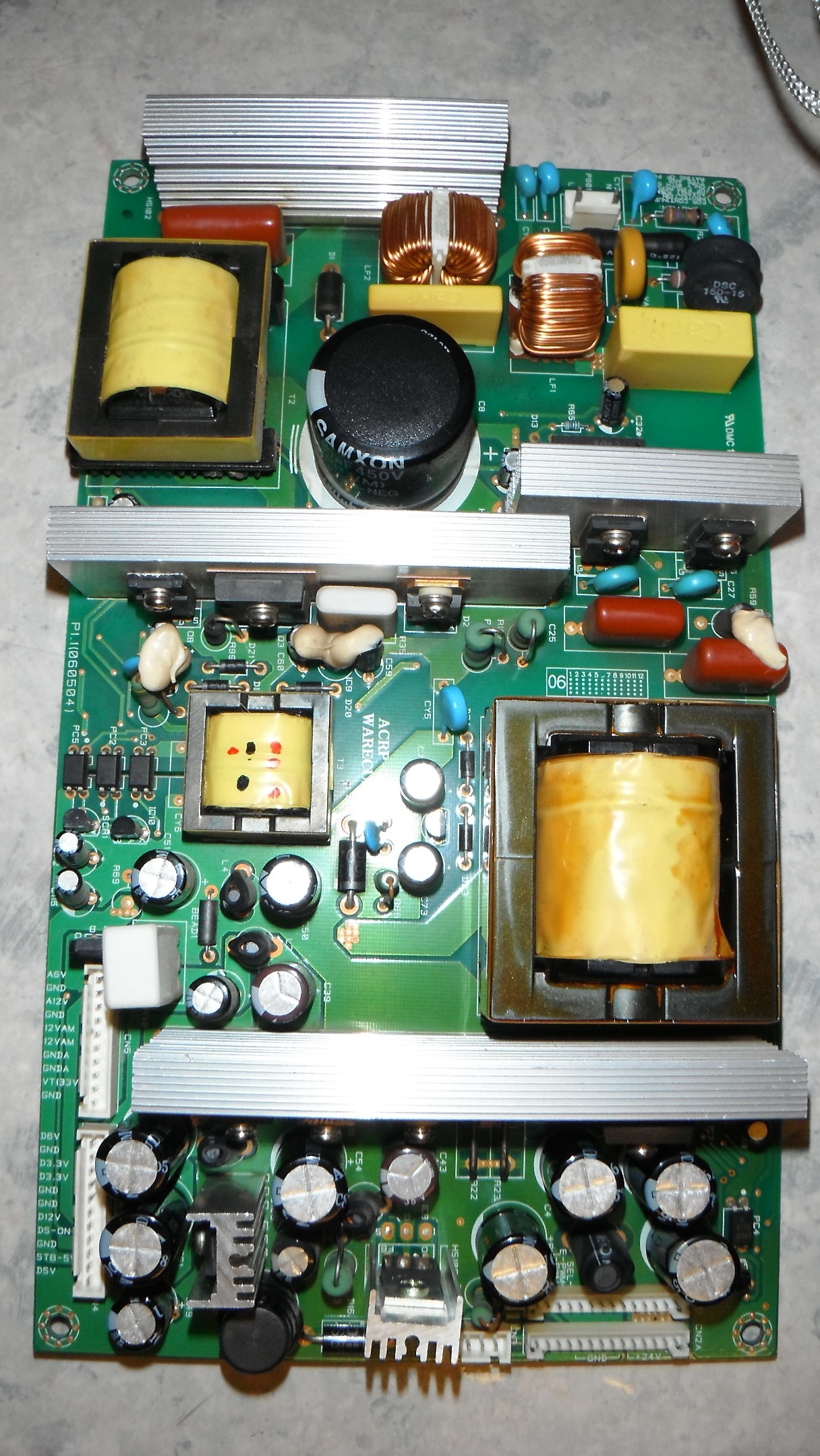

          here we go then heres some piccys
          [URL="http://*************/photo/my-images/232/06072012361.jpg/"]
          [URL="http://*************/photo/my-images/689/06072012360.jpg/"][URL="http://*************/photo/my-images/820/06072012359.jpg/"]

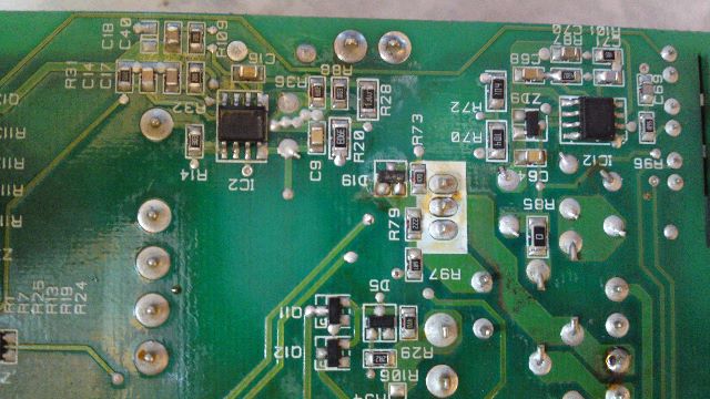

          ics are 7601 628 , top middle of pic , loc ic12
          13002L 604 top left of pic , LOC IC2
          290g12 bottom right of pic loc , ic4
          ok so the 7601 is a fairchild fan7601 green currentmode pulse width modulation contoller
          the 13002L havent a clue what this is ???
          the 290 g12 looks like a ritchtek RT8290GSP dc-dc step down converter (adjustable)
          right so iv got 5 volts coming out of stb-5v and 4.98 v coming back in on the motherboard however this is open circuit to the psu ,
          as soon as i put that steady 5 volts back onto the psu it drops to 1.48v?
          also there is a squealing noise audible not mains ac much quicker just within the audible range and it sounds slightly unsteady ?
          any help?

            Sorry, not my power supply. Mine was different. What is the model of your TV?
            13002 is an NPN power transistor - rare to see one of those on a TV power supply, ancient technology!
            I would replace the 5V cap. It could fail without bulging.

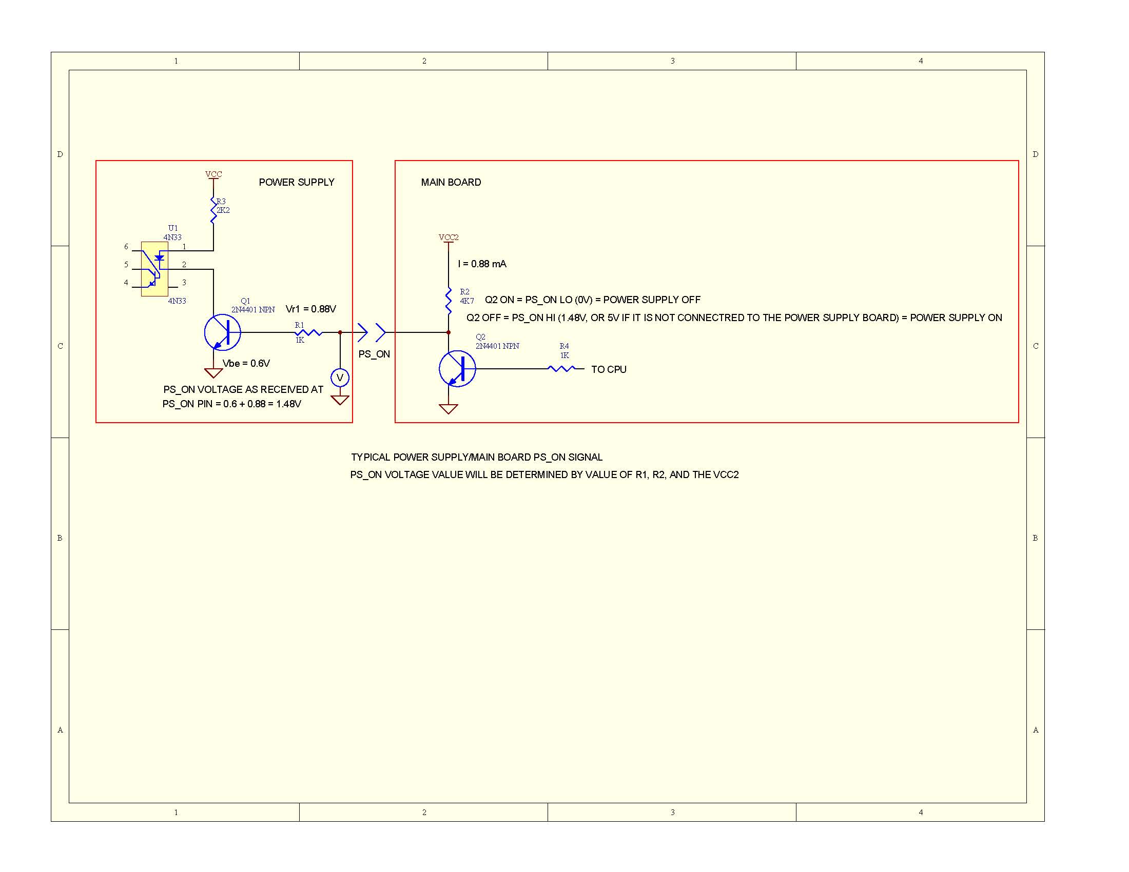

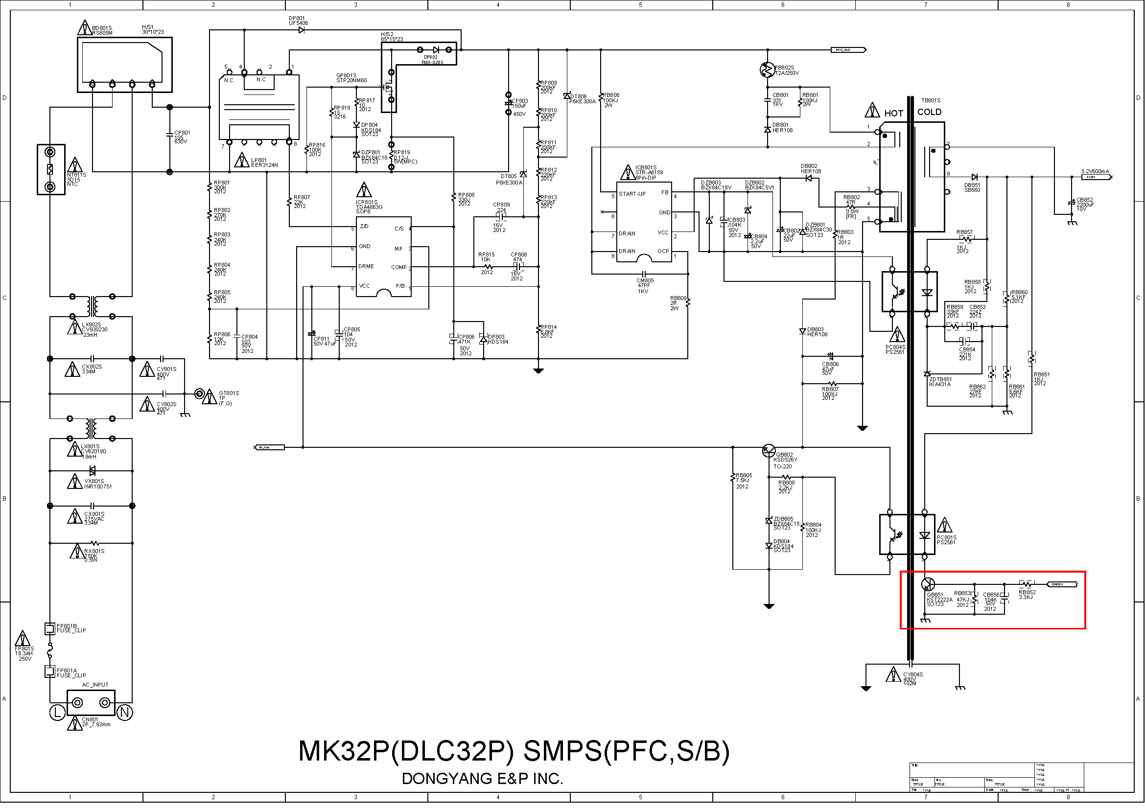

              That 1.44V reading may be fine due to the voltage dividing of the pull up resistor on the main board and the Base resistor plus Vbe of the transistor.
              Since this power supply has PFC circuits, you should check the DC voltage on th at main DC filter cap (the 450V cap), when the TV is off, it should have about 325VDC (230V x 1.414 = 235), and when the it receives PS_ON, the voltage should go up to around 400VDC, if it does then, that 1.44V is enough to turn on the transistor on the power supply board.
              See example of the PS_ON receiving side on the power supply board.

                thanks budm and tom , clearly i need to go back to school!
                il check that is actually recieveing the signal by checking the dc filter cap
                also tom i cant find a 5v cap could you point me in the direction, i esr`d most of the caps but il esr all of them on monday and get back , cheers

                    Did any one work on this board before? I can see the circuits areound the 12/24V power supply primary side has a lot of flux around the two MOSFET's.
                    By the way, we do need higher resolution pictures so we can easily zoom in and look at the details, pitures of the connectors taht we can read the labels will help also.

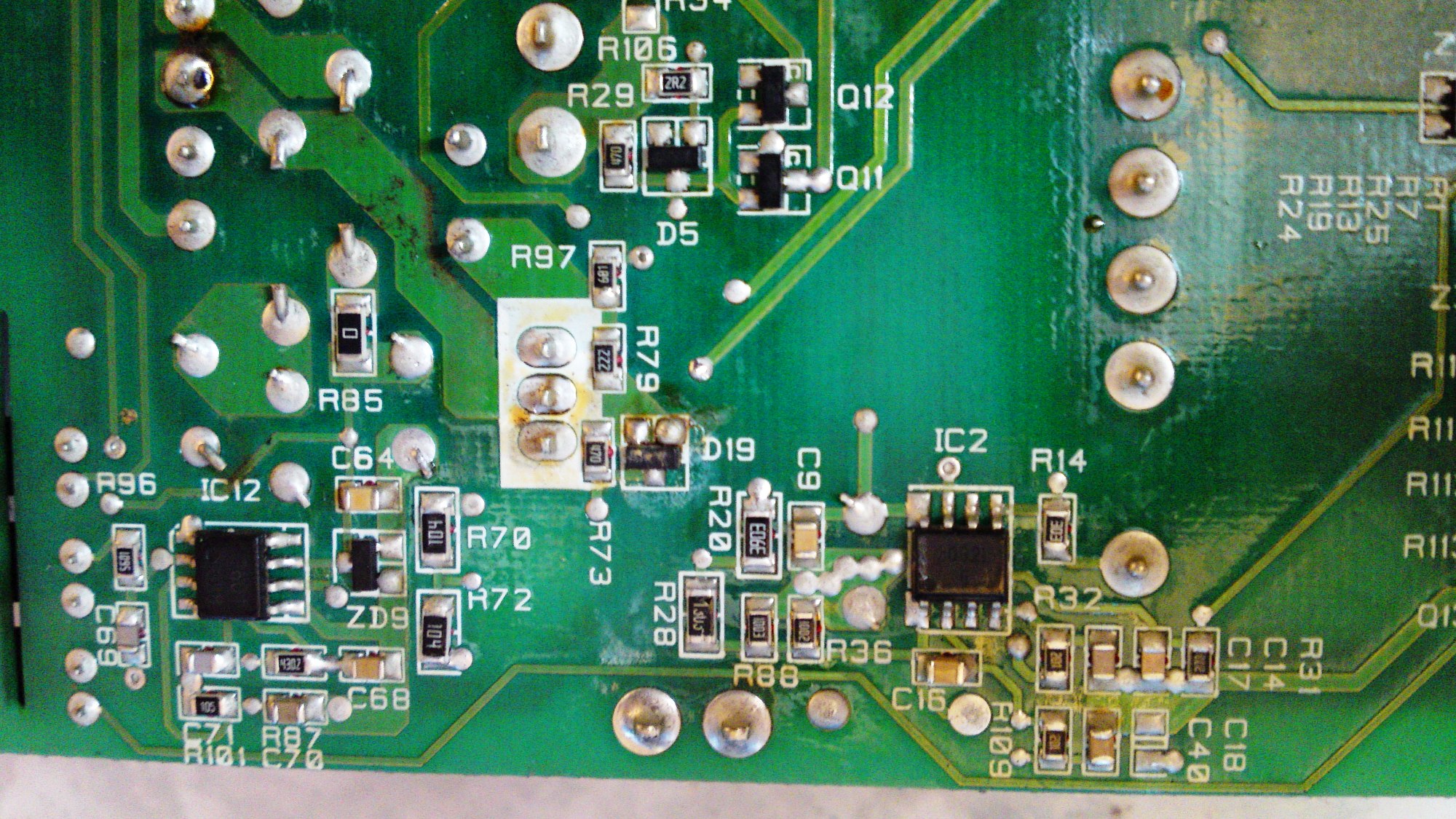

                      http://*************/photo/my-images/207/dscf0182i.jpg/
                      http://*************/photo/my-images/43/dscf0183p.jpg/
                      these are a bit better sorry about the flash guys its nearly time to stop feeding the mugwai i think

                                  quick update had a quick look last night dont have my scope at the mo just a multimeter ! just had the psu board on the kitchen table after making a bit of toast mmm,
                                  powered it up and gave it a small pulse on the ps on tab to try switch it on, i heard a change in note of the buzzing , got slightly slower ,
                                  it looks like the ic12 fairchild green current mode pwm controller is pulsing ok for the standby transformer,
                                  however the chip on top left (the one that has a part number of the old transistor) loc ic 2 with number 13002 (8pin ic sm) seems to die,,,
                                  ok so when the psu is not recieving ps on (standby mode) this illusive chip seems to have an 8 volt supply between two legs and 5.5 on another when i give it the on command this chip seems to die the 8 volts dissapear there is no output , but if im honest im not entirely sure how this setup works the ic 2 seems to do someting with a IR21571 chip ballast control chip iv also tested this and it seems that vdc pin 1 on this chip also dies i think it had 7 or 8 volts and when i sent ps on signal it dies to 0.3 volts
                                  i know this board is worth nothing its an old tv with no hdmi input but come on if i dont find out why this thing aint working i wont be able to sleep at night ,,, yeah im one of those .
                                  so on monday i will re work the entire board for solder to make sure and esr all the smaller caps like tom said il see if i find anything , thanks again
