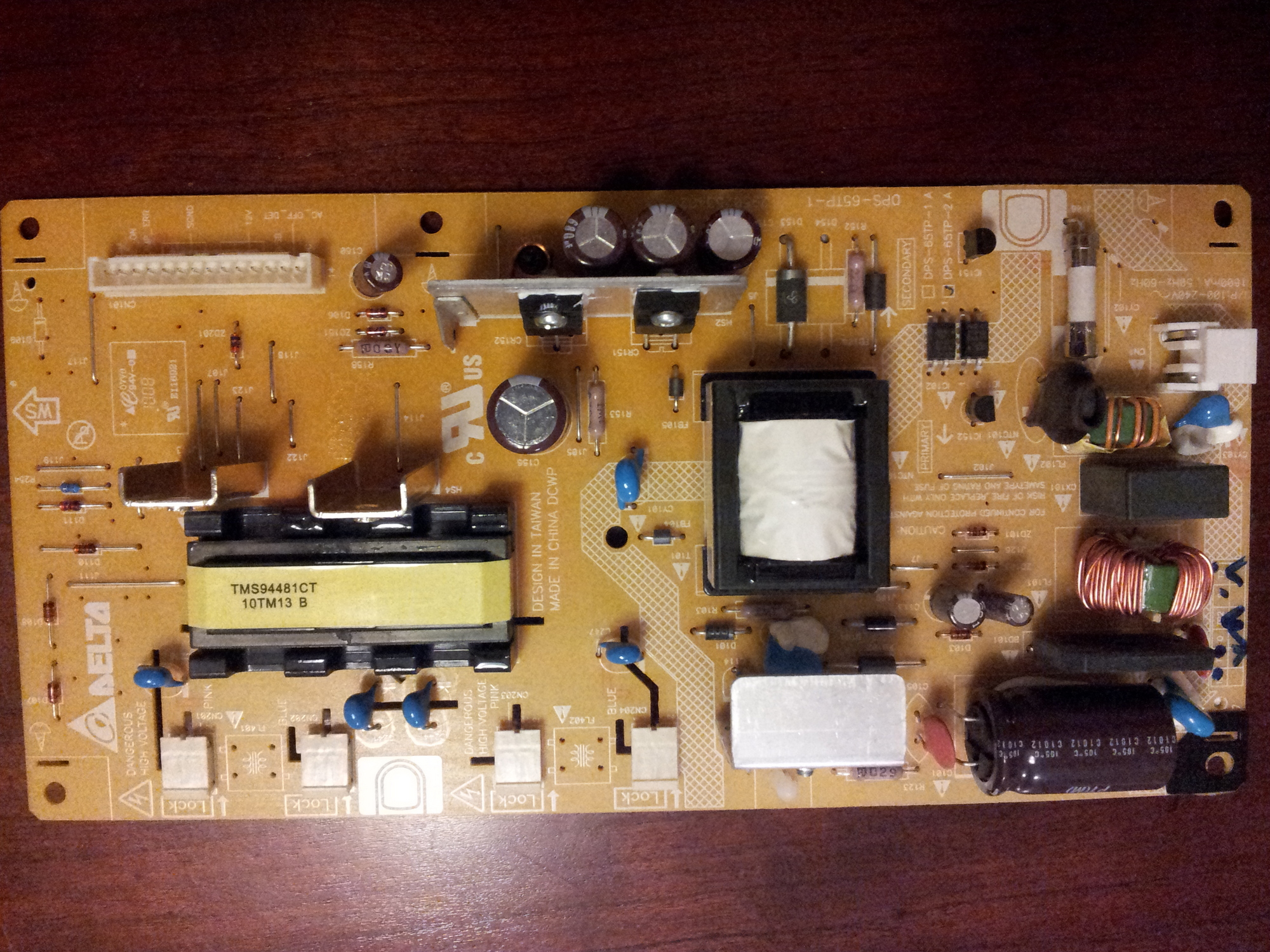

    The flashlight test on the screen allows me to see faint images and the sound and DVD player are working.
    From other posts, I suspect the issue with primary or secondary transformers, but I'll refer this to the experts.
    Primary
    1-3 0.0 ohm
    1-5 0.L
    1-6 0.L
    1-7 0.L
    1-8 0.L
    1-9 0.L
    1-10 0.L
    1-12 0.L
    Secondary
    1-2 .986 ohm
    1-3 0.L
    1-4 0.L
    1-5 0.L
    1-6 0.L
    1-7 0.L
    1-8 0.L
    1-9 0.L
    1-10 0.L

    There are two secondary windings on the inverter transformer T302, pin 1-2, and 3-4
      Re: Dynex dx-22ld150a11 with 2 seconds to black.
      T302
      3-4 17.79-18.03
      I measured this several times and the results varied each time.
      Thank you.
        See
        http://www.lcdparts.net/TransformerD...ProductID=4010
        for the pinouts. We want the resistance between S1-S2 and S3-S4. The two reading should be around 960 ohms.

          Your meter is good with good batteries, I expect 3&4 to be in the same ballpark as 1&2.
            Fresh batteries in the meter. Those were some old batteries.
            Here are the new readings
            1-2 .983
            3-4 17.96
            Not much of a change. I can try another MM if there is some doubt about it. Would removing it from the board help at this point?

              The problem, we, the regulars, are having with the above is that there are no units and we can't see what you are doing.
              Is that 17.96 ohms, kohms, Mohms?
              If it is the latter two, that transformer is bad. If it is 17.96 ohms, then something weird is going on.

                As you can see pin 1 & 2 are connected to two connectors of the lamps, same setup is applied to pin 3 & 4 as well, so it looks like the winding on pin 3 & 4 is bad. To be sure, you may want to remove the transformer and inspect it more closely. So far I cannot find the pin out for this transformer yet.

                  1-2 .983 kohms
                  3-4 17.96 kohms
                  So it appears the transformer is at fault. I'll remove the board for a visual inspection tomorrow night. Is the link I have below a suitable replacement?
                    http://www.ebay.com/itm/Transformer-...item35bbb44efb
                    That is the correct part although I can't vouch for the seller.
