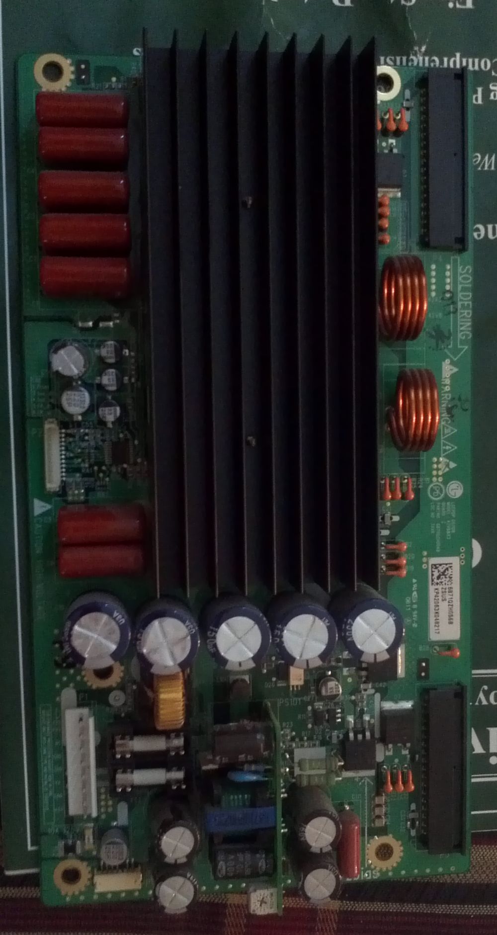

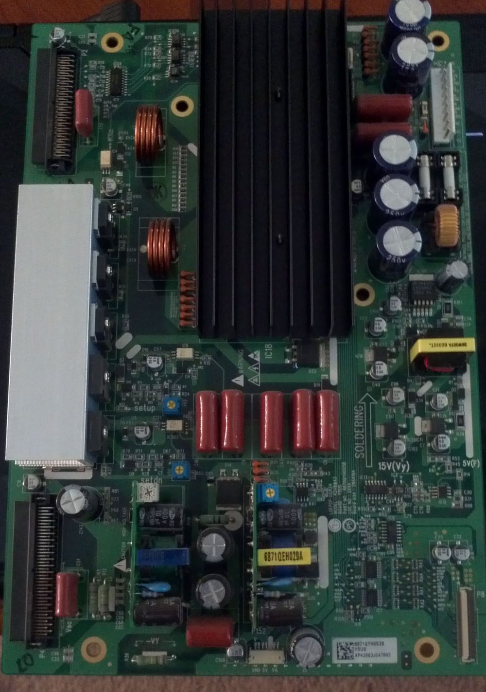

    Maxent MX42HMP20 snow
    I have replaced the power board with the same model# and adjusted the Vs and Va to spec, which are Vs 195 and Va 65. I still have snow just not as bad as before the power supply adjustment. I cannot find the voltage specs and test points for the xsus and ysus. Also ysus has 4 potentiometers whereas the zsus has 1.
    Re: Maxent MX42HMP20 snow
    This is the same chassis as the LG 42PC1D. The problem is with the control board; it needs a firmware update, to fix the "sparklies" problem which plagues these TVs.
