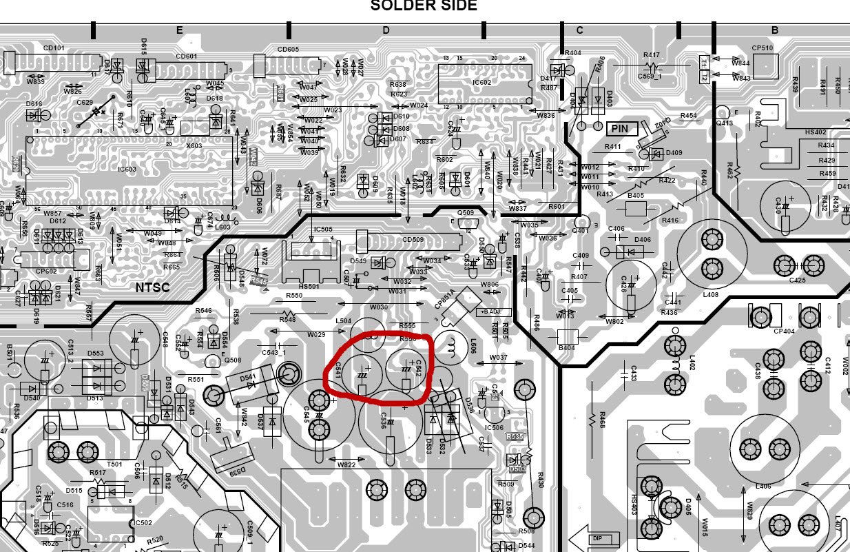

      From what your describing sounds if your not hearing some issues coming from power supply noise i check and repalce c541 (2200 UF 10V) c542 (1000 UF 25V) attached is picture of 2 capacitor circled in red ...hope this helps
        sorry for the late reply but thanks for that when i get a chance i will take a look

          ok i just checked c541 and c542 and they are fine is there anything else i should look at?

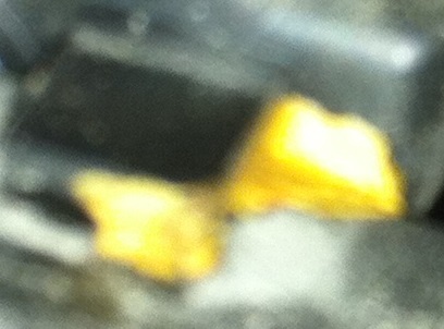

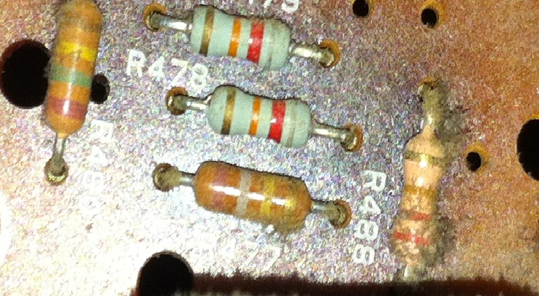

                            ontopic, ok i have the tv with me and have managed to look at the board, the sound is coming from either the flyback or some place really close to it, its real hard to pin point, here is a couple of pictures first one is just some stuff on the board with some black mark under them and second is something on the flyback might be normal im not sure also sorry for the bad pics i took them the best i could

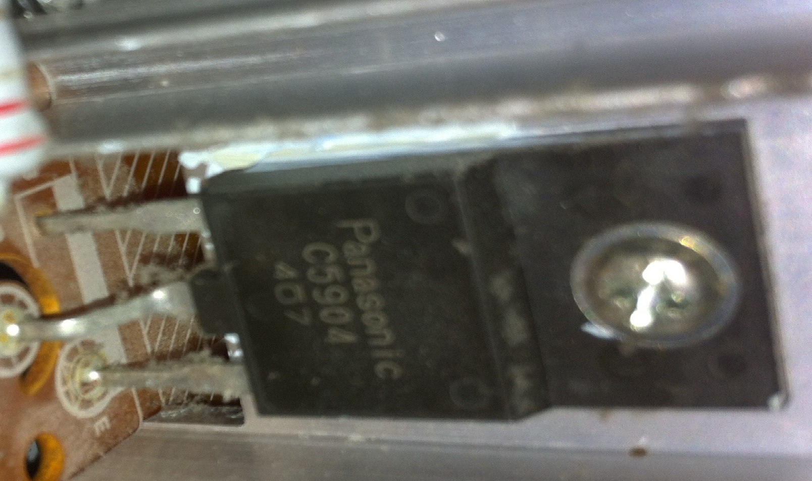

                                ok im guessing it might be a power supply problem which is hard has it is on the same board as the flyback, anyway i plugged the tv in and pressed the power button and for a couple of minutes tried to find where the sound was coming, well i couldnt find it, so i unplugged the tv and plugged it back in and right as i was about to hit the power button, it powered on on its own
                                • luke9511
                                  • Jul 2009
                                  • 101
                                  Re: Toshiba 30HF84
                                  ok i had my fiancee listen for where the noise was coming from and she says it sounds like its coming from the part in the picture does anyone know what this is and where i can get a replacement?
                                    Re: Toshiba 30HF84
                                    That's the HOT (horizontal output transistor) for driving the flyback and horizontal scan of the TV. 2SC5904 is the full part #.

                                      well there is a bit of a horizontal shake, could this be my issue? and do these go bad from time to time?
                                      edit does anyone know of a suitable alternative replacement for it as i cannot find a place that sells this part
                                        Re: Toshiba 30HF84
                                        I wouldn't expect it to cause that fault, maybe some ripple on the B+? Don't know much about CRTs myself.
