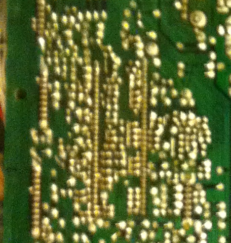

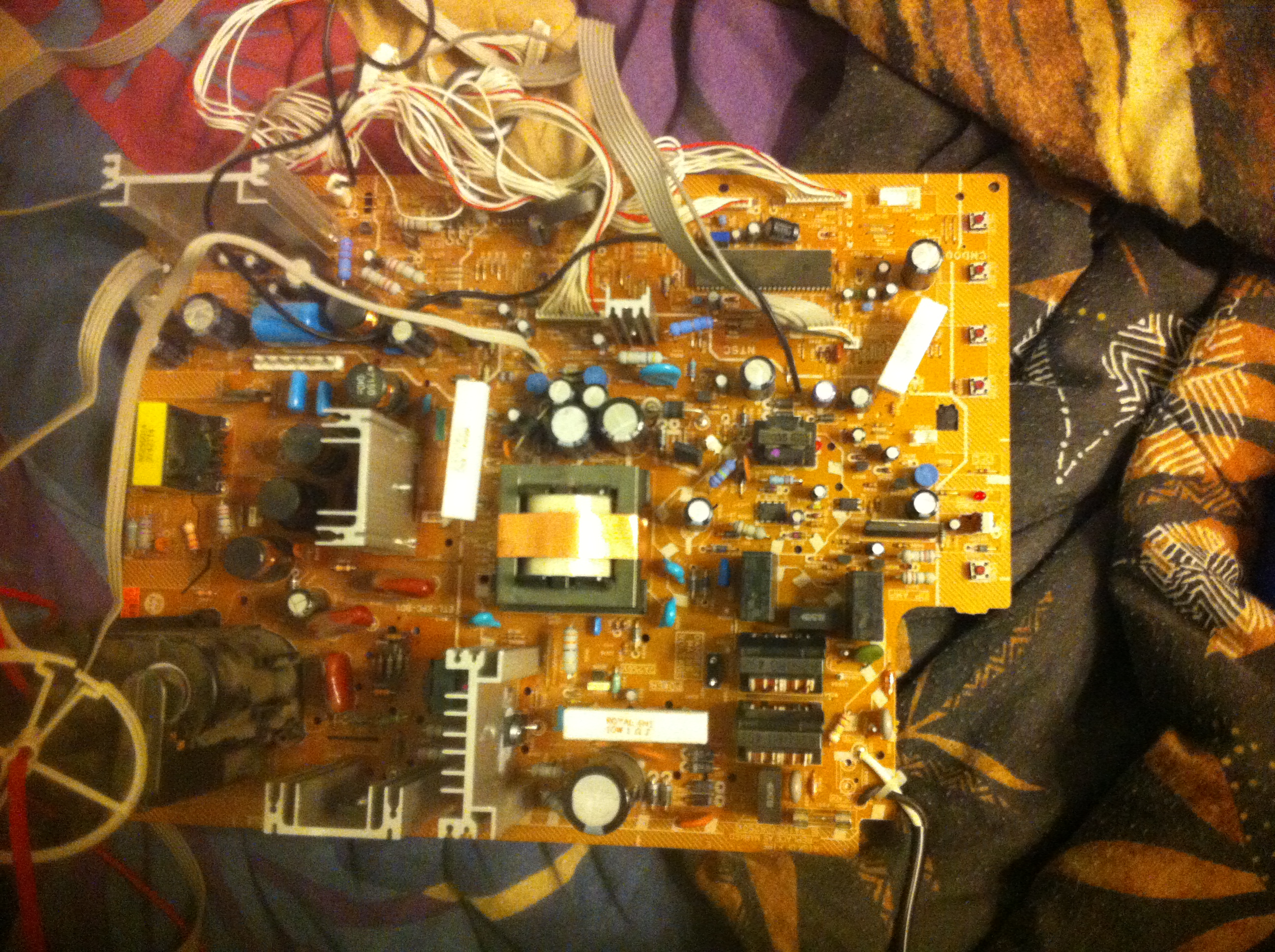

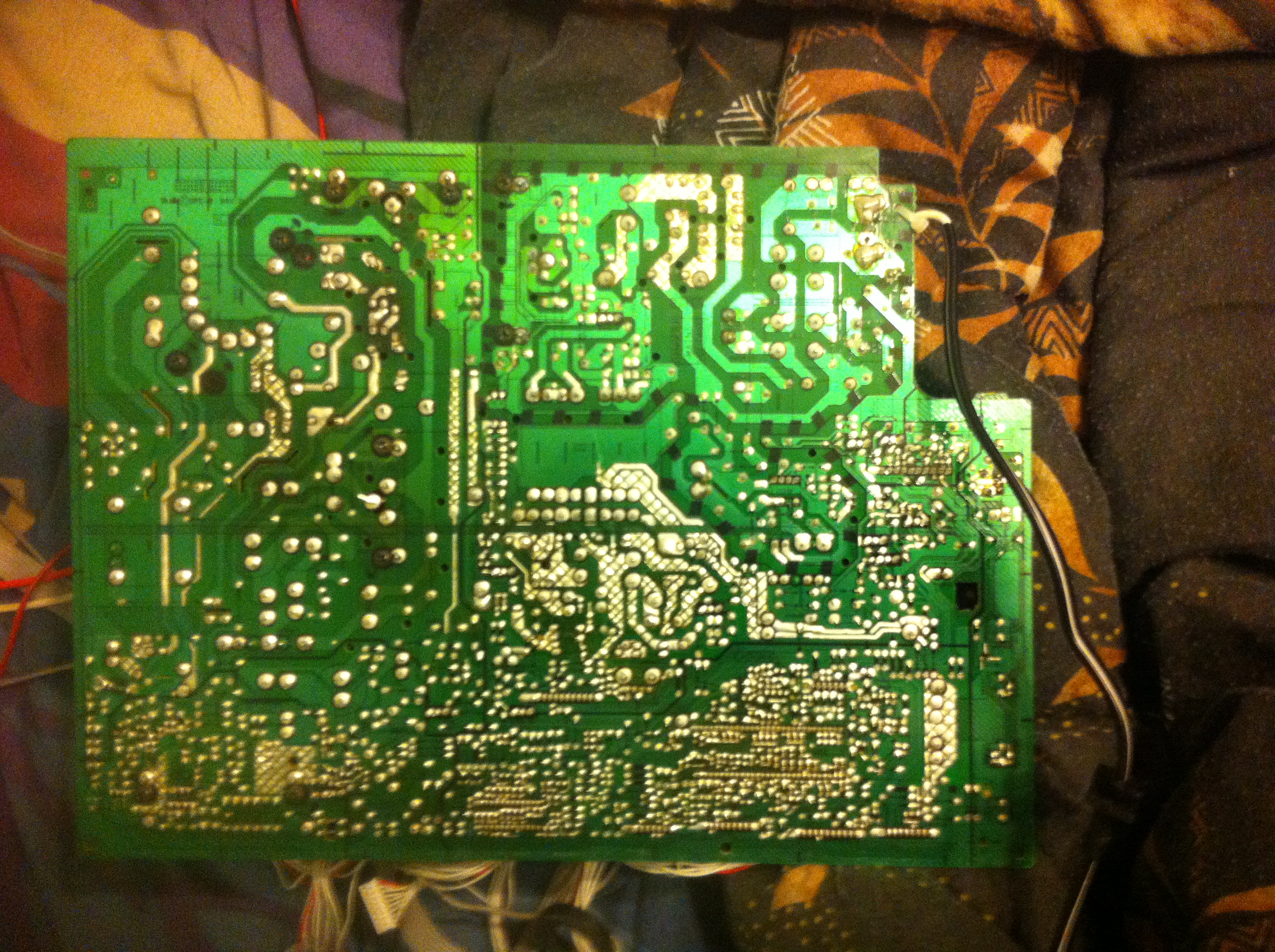

                    Re: Toshiba 30HF84
                    Show photo main board top and bottom
                    • luke9511
                      • Jul 2009
                      • 101
                      #30
                      Re: Toshiba 30HF84
                      there ya go let me know if you want any close ups

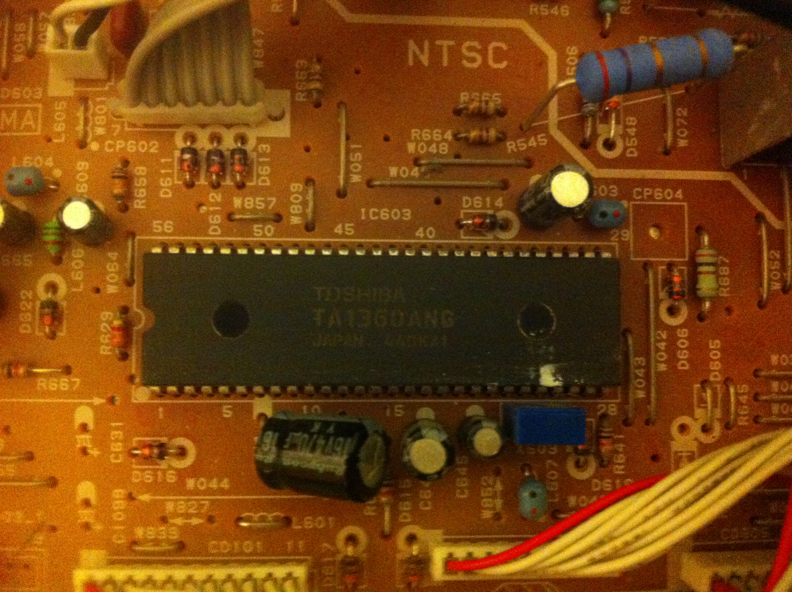

                        Re: Toshiba 30HF84
                        Please foto this place and the name of this chip
                        • luke9511
                          • Jul 2009
                          • 101
                          #32
                          Re: Toshiba 30HF84
                          here ya go it is a Toshiba TA1360 ANG
                          JAPAN 440KA1
                          • kasfamily
                            • Aug 2014
                            • 774
                            • Russia
                            #33

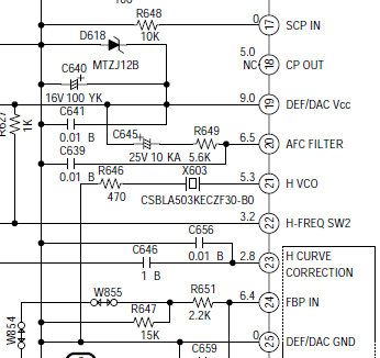

                            Re: Toshiba 30HF84
                            Need soldered well X603
                            • luke9511
                              • Jul 2009
                              • 101
                              #34
                              Re: Toshiba 30HF84
                              solder joints are fine, but here is the part from the service manual and the part number from the part itself
                              X603 AE004348 1002R01502 CERAMIC OSCILLATOR CSBLA503KECZF30-B0
                              B503 F 30
                              • kasfamily
                                • Aug 2014
                                • 774
                                • Russia
                                #35
                                Re: Toshiba 30HF84
                                I know. Still need to solder
