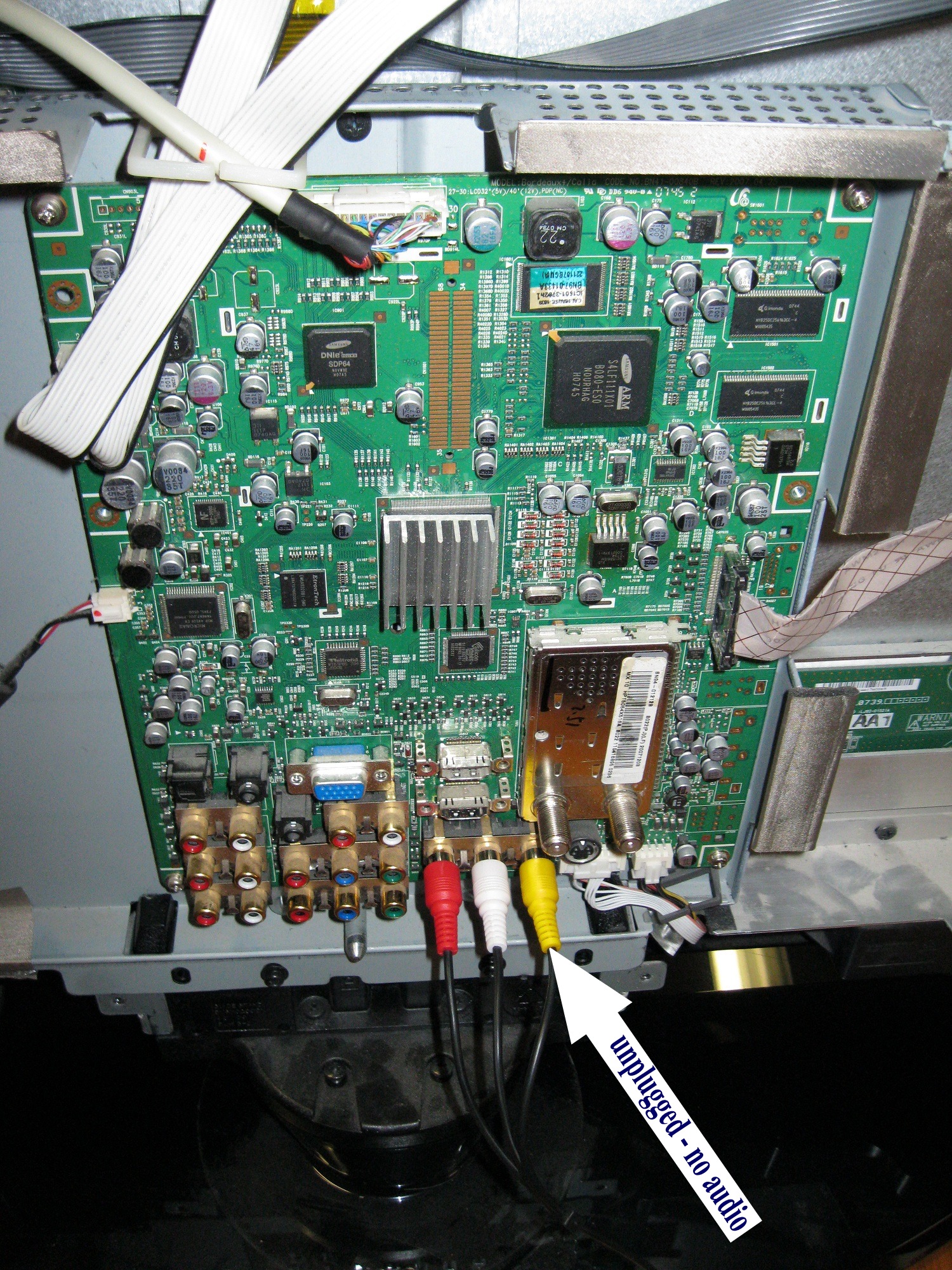

    Here goes, I have a Samsung HPT5064 Plasma, I turn it on and has sound, no video. I have tested out both the X & Y as well as the buffers, replaced the T-CON logic board because I was told that was the problem (NOT). Anyhow, I plugged in RCA jacks to a DVD player and the inputs on the back of the TV, I have sound until I unplug the video (Yellow) from the TV - wtf: I was always under the impression only video flowed through yellow and (Red) was right and (White) was left audio. Anybody have a 50" Sammy with the sound-no video problem?
    SEE ATTACHED
    Please help, I need my TV back up and running.

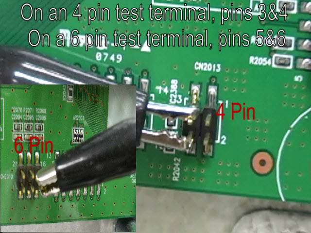

            try removing the lvds cable from the main, then at the control board some models use a 4 pin or 6 pin test connector.If your model use the 4 pin jump pins 3/4 together or if has the 6 pin connector jump 5/6 together. Power set on you should see the test generated patterns scroll on screen from the control board if you do more likely bad main board.

                Ronbo, I am a newbie so I can only assume the lvds cable I am removing is at the top of this board, where are the test pins, on the T-CON board? Is the board behind that (smaller) what you are calling the control board?

                    The LVDS cable is the white round cable @ top of your Main board in that square connector,follow that to your T-con board,then follow my post#6 this will tell you if the control board or main is bad,Now if you still don't have any picture from following post#6

                        Re: Hp-t5064
                        After doing this test if you don't see any test patterns scroll on display then you might need to troubleshoot using methods describe in post#7 by electronicsurplus

                          No test patterns, black screen. Damn, I'm thinking maybe the Y-SUS main and buffers is bad after all. I'm not keen on testing voltage and I'm not sure where VS and VA are either. I'm a newbie learning by latching onto the professional techs. Now, if it was a computer I'd be on it like white on rice. If you can direct me I surely will take a shot at it but I need direction. The TV has sound, but the screen is black as night, not a thing.
