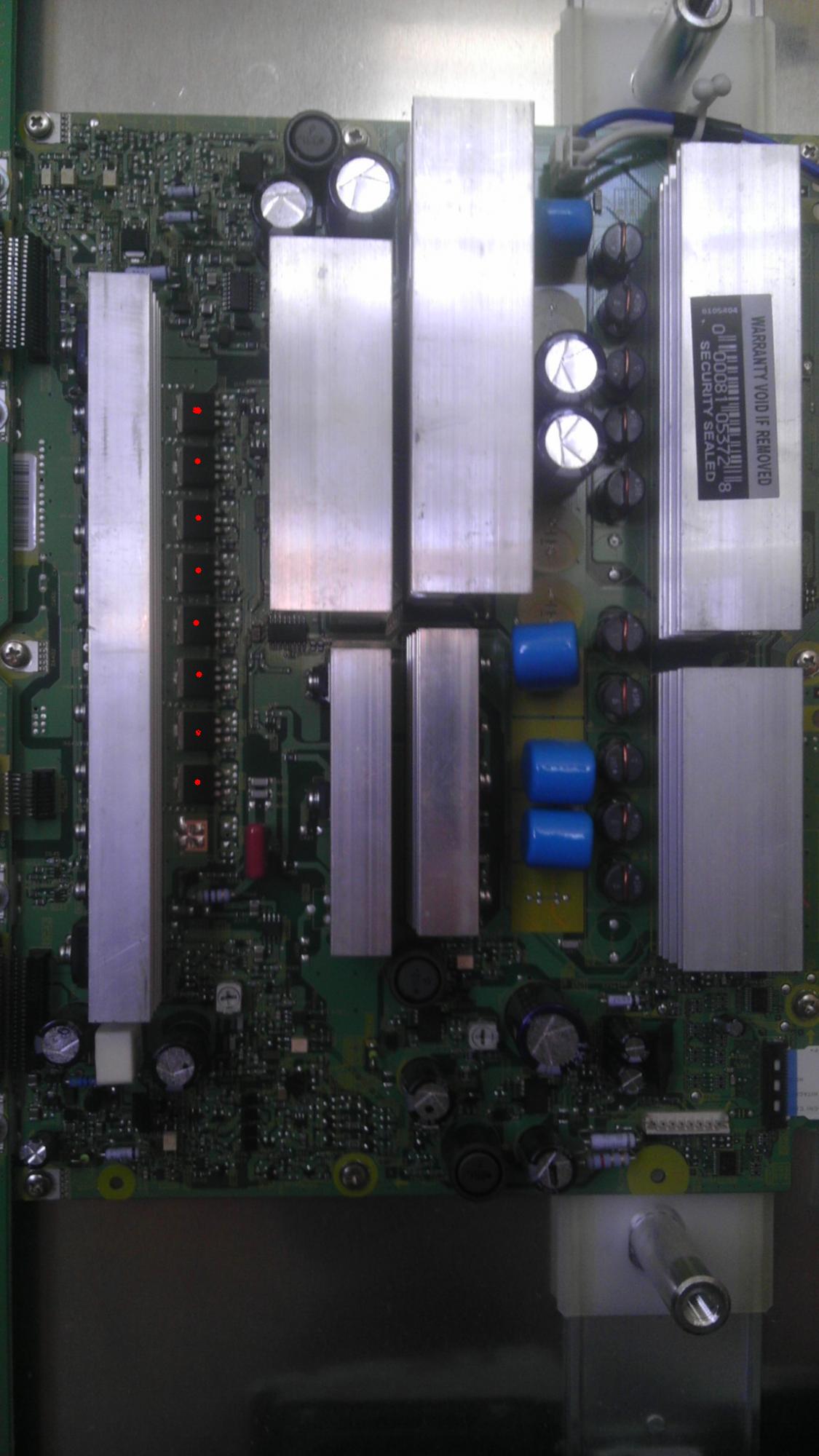

                        Can you post a detailed shot of your SC?
                        • caprat
                          • Mar 2012
                          • 29
                          Re: TH-50PZ800U Viera 7-Blinks, Replaced YSUS, Still Bad..
                          Here is the replacement SC board.
                            Okay, these marked devices are common failures on the 42" version, so I expect the 50" is the same.
                            Check between each pin for ohms; use 200 ohms range. For example 1-2, 2-3 and 1-3. The stub pin in the middle is electrically the same as the big fat tab on the top of the device, which might be easier to test.
                            If you get a reading of less than 30 in any direction for any FET, I would call that a shorted device.
                            Make sure the TV is off (unplugged for at least a minute) while doing this test.

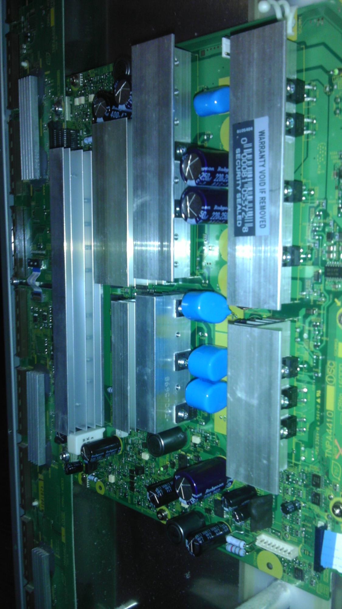

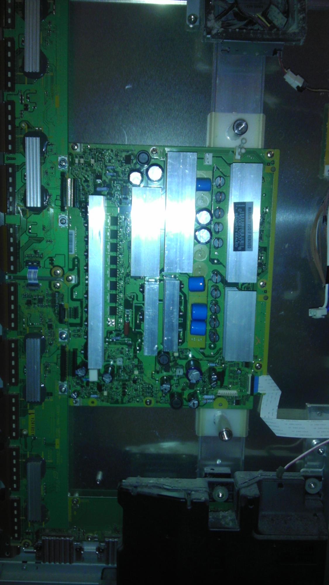

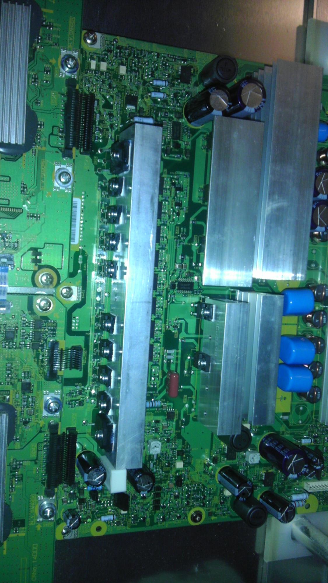

                              Your pictures are really not clear enough for troubleshooting.
                              Good light is the key - perhaps take the boards outside and do
                              pictures of both sides - without flash.
                              They should look like these examples
