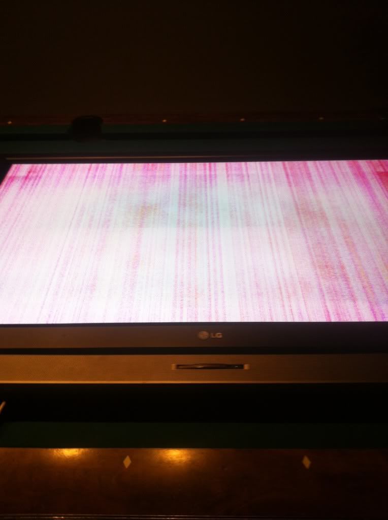

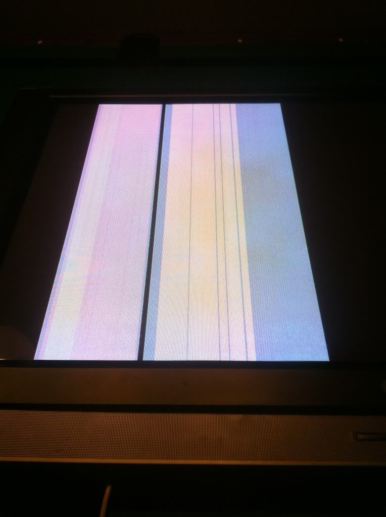

    Hi Guys .. I have a tv with red vertical lines .. 1st picture is of that , second picture is how the menu shows up when you press it .. the power supply had 10 bad caps , i recapped the entire board .. all voltages out test ok ..
    any ideas?.
    Model is a LG 50PC3D-UD
    Red Lines
    http://i1161.photobucket.com/albums/...n/IMG_1012.jpg
    Menu Display When Pressed
    http://i1161.photobucket.com/albums/...n/IMG_1014.jpg

    Re: Lg 50pc3d-ud
    Hard to tell but probably a Y-sustain or control board issue. I repaired the 42PC1D and 42PX5D so I can offer some advice, but I think the 50" and -3D has some significant differences.
      Re: Lg 50pc3d-ud
      I had a simuliar fault on my 50pc1d set, don't know if it's any help but I had a short on 1 mosfet on one of the bufferboards.
      https://www.badcaps.net/forum/showthread.php?t=19791
