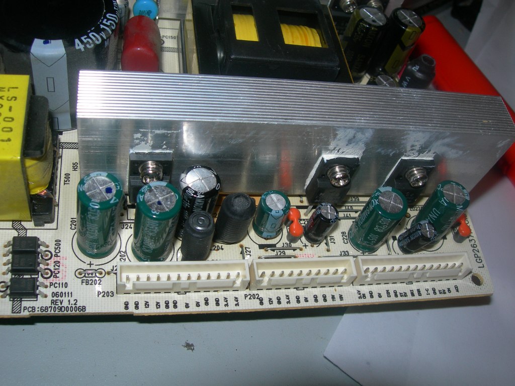

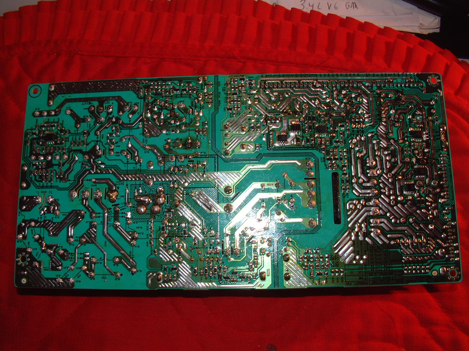

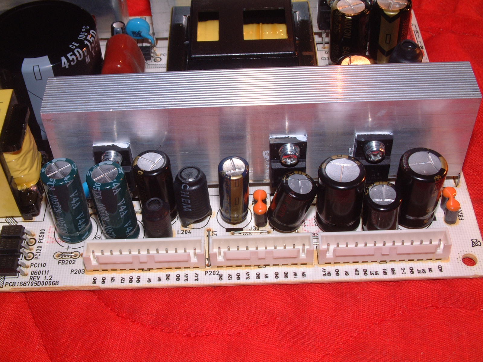

                      The PSU is currently at the office, I'll have access to it on Monday, so I'll post a pic then. It's very bad. You can even see the browning on the top. Thinking about it, the one bad cap was very close to this heat, so this cap could have simply been cooked.

                        If you look near the heatsink in the pic, you'll see the browning I'm talking about.

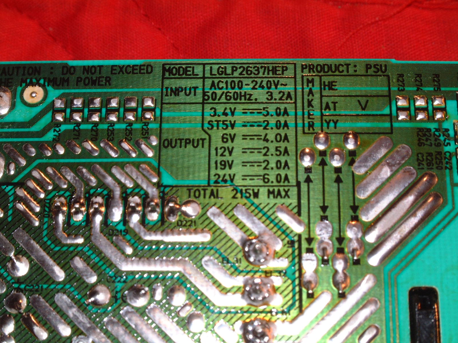

                          I just look at the pictures I took 2 years ago, the 3.4V is rated at 5A! no browning sign on my board.
                          Is that buck regulator a surface mounted, I cannot see that in my picture.
                            Re: LG 37LC2D No sound, picture okay, remote control and side buttons glitchy
                            Yeah, I saw that too. 5A is massive! Given it runs off the tiny 5Vsb transformer which looks capable of maybe 10W...
                            But since the audio DSP and the remote control seems to be the only thing that depends on 3.4V, I think it will be okay to replace it with a supply capable of 2-3 amps. However, I don't have a clamp meter yet to test this theory.

                              Here's the buck converter position.
                              I am thinking of using an LM2576T simple switcher. 3.3V at 5A is possible, but 3A is a more reasonable output.
                              It looks like the 6V might also be generated using a buck converter.
                                15W switcher with copper pad for heat sink? No wonder it runs hot.

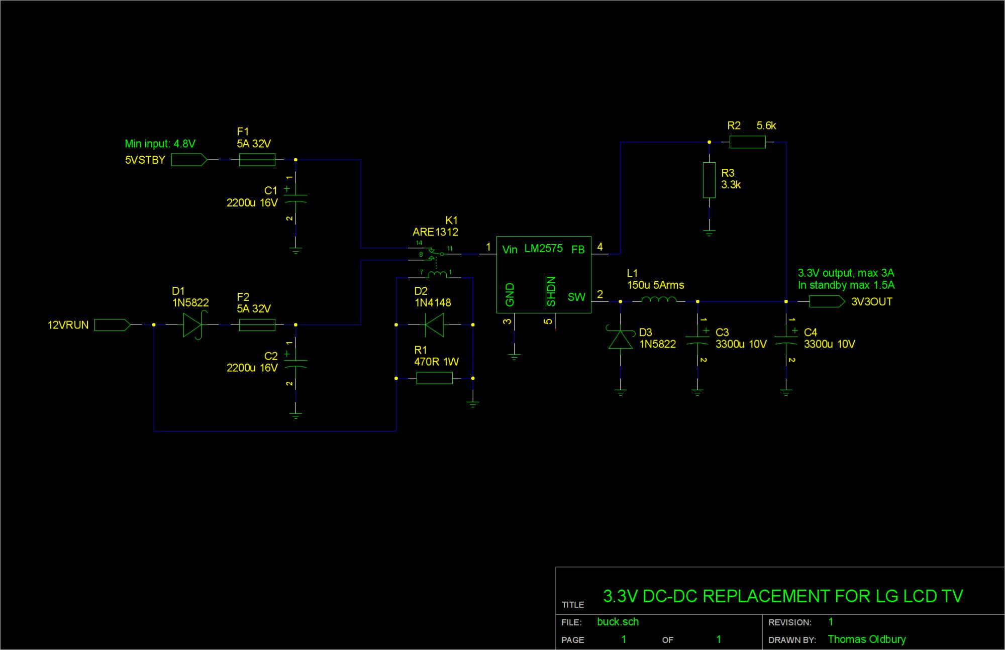

                                  I have drawn a little circuit diagram of what I'll build when I get some free time. I have designed it so it runs off the 5V standby in standby (which should draw less than 1W) but then switches over to the 12V supply to lighten the power dissipation in the switcher (which is higher at higher input currents.) A little 1 amp relay I have will do the job fine. I would normally use a p-CH fet for this, but I have lots of these little relays lying around.
                                  When the 12V is on, the relay will switch over to using the 12V run supply. When 12V drops out, the 3.3V output stays high long enough for the relay to change over due to the extra large 2x 3300u cap and the high 2200u input cap. The relay will then deactivate (helped by the diode and resistor in parallel with the coil) and power itself from 5V standby. If this circuit proves troublesome, I will just use the 5V standby, but I'd prefer to use the 12V when it is running. (Probably like LG should have done originally.)

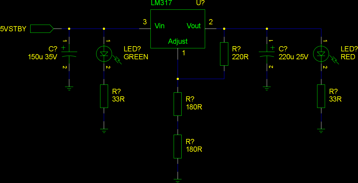

                                      Okay, well I've decided for now I'll try using an LM317T to power it. The only thing that draws from the 3.3/3.4V as far as I can tell is the system MCU (hence side buttons and remote control don't work) and the audio DSP. The power hungry display processor appears to be powered from the main 6V rail. So, I've built a little LM317T circuit up, this can provide 3.3V at 1.5A with a decent heatsink. I think 1.5A would be very high for this TV. But I will characterise it with an ammeter.
                                        Okay, bodged it in. Result: Audio and remote control/side buttons now work. However, the 3.3V output drops to 2.99V as the whole TV draws about 1.43A, just within the 1.5A limit of the LM317T, and it is clearly in drop out with 5V input. I will need to think of a more permanent solution, perhaps using the 6V output or using a buck converter. Regulator gets quite hot too as it's dissipating about 2W, but I have got a good heatsink on it. It overheated after about 5 minutes.
