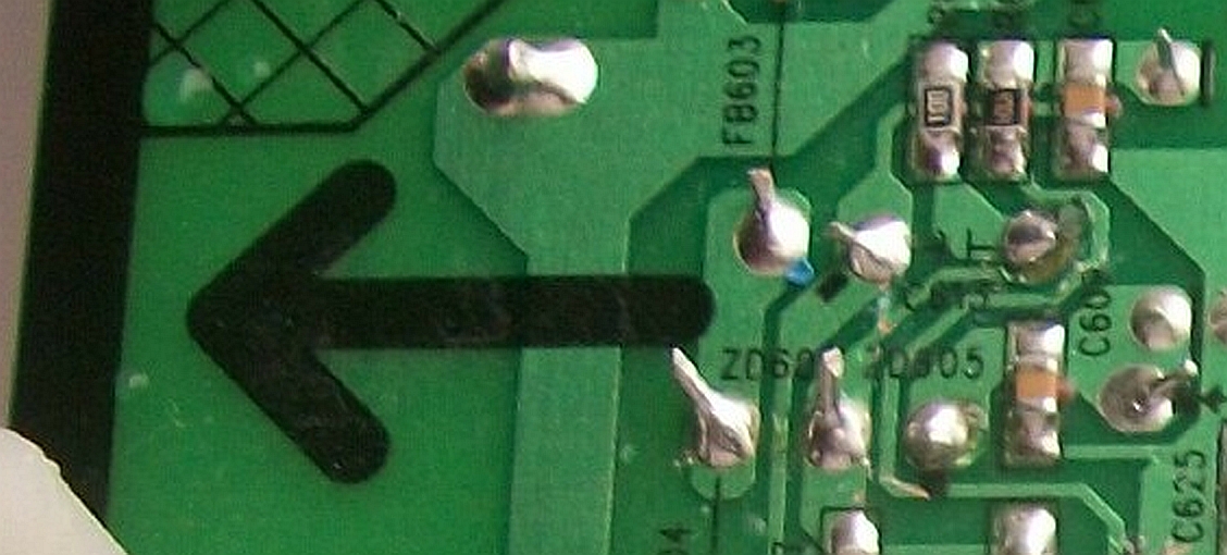

                    New here just poking around the forums and read this thread and was checking out the pics posted. Might have already been mentioned and addressed or dismissed, but I noticed something that looks a bit suspicious to me and thought I'd point it out just in case. The foil trace at one end of what looks to be C613 seems kindof odd to me (see pic).
                      Re: Vizio E321VL
                      Yes Jeetyet I agree - I have asked for traces to be checked several times there appear to be lots of problem areas and have been assured they are ok. OP has not provided any better pics so I have given up on this thread.

                        I have attached several sets of pictures of these boards. I will check the trace he is talking about, but I am pretty sure that it is not the problem. That C613 is one of the Electrolytics that I replaced and what is showing up is rosin from the solder. It is just sort of shiny. The trace is fine. I am waiting on a MX25L6406E for the Main Board which is the EEProm that, at least in some cases, has been found to solve this Orange Light No Power problem. It should show up today according to tracking and I will try to get it installed today or tomorrow and will report back whether it is a success or not. Budm and I sort of mutually agreed back in Post #102 that this might be the problem.
                        I do appreciate all the help. So don't give up on me yet.
