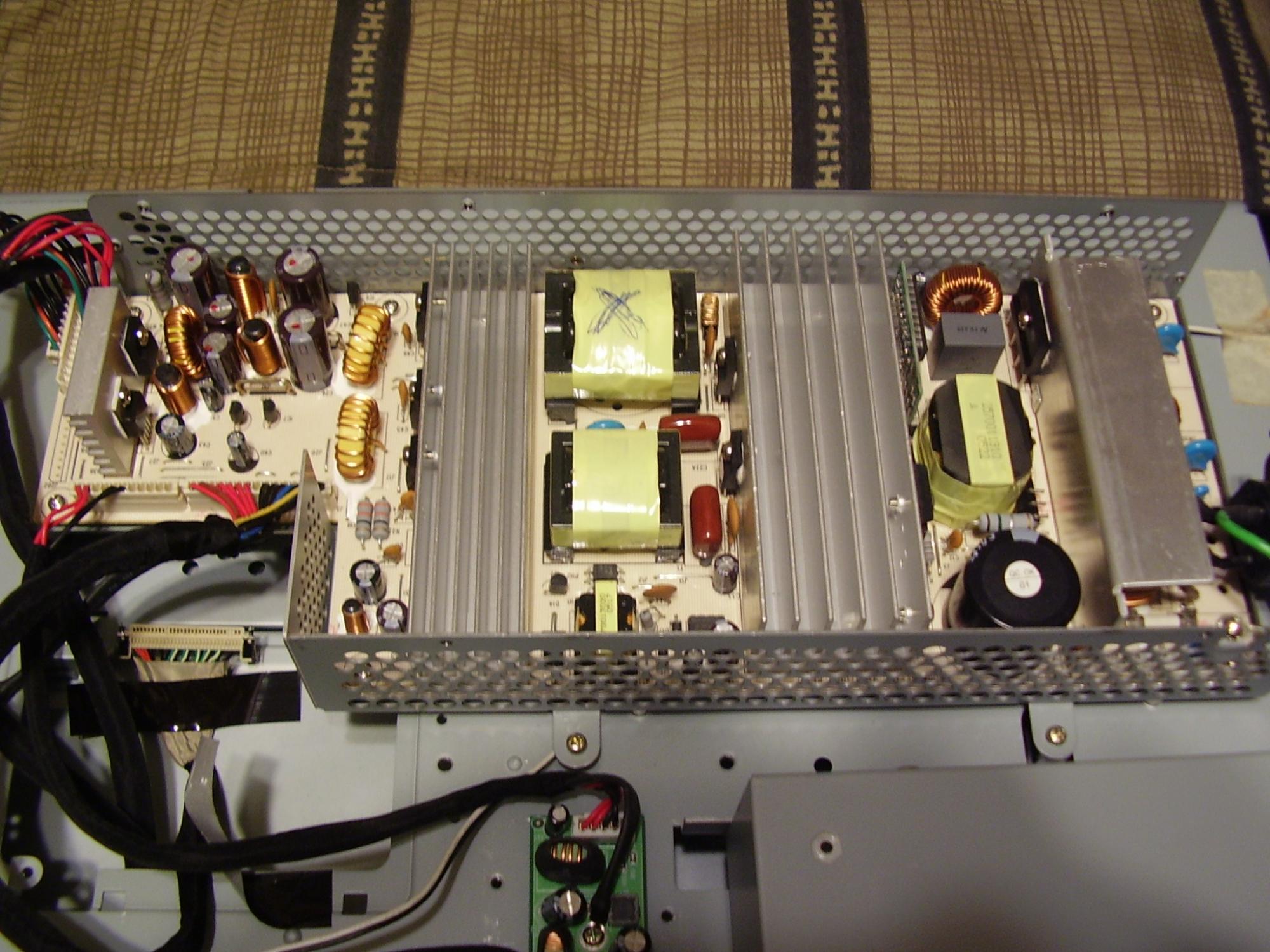

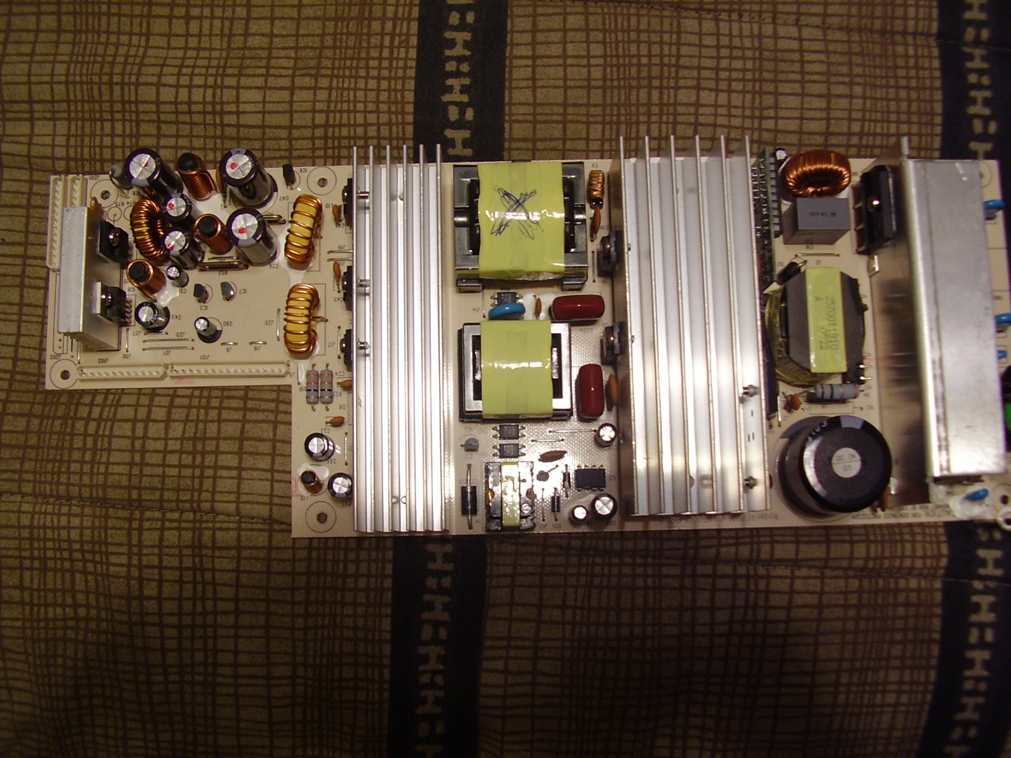

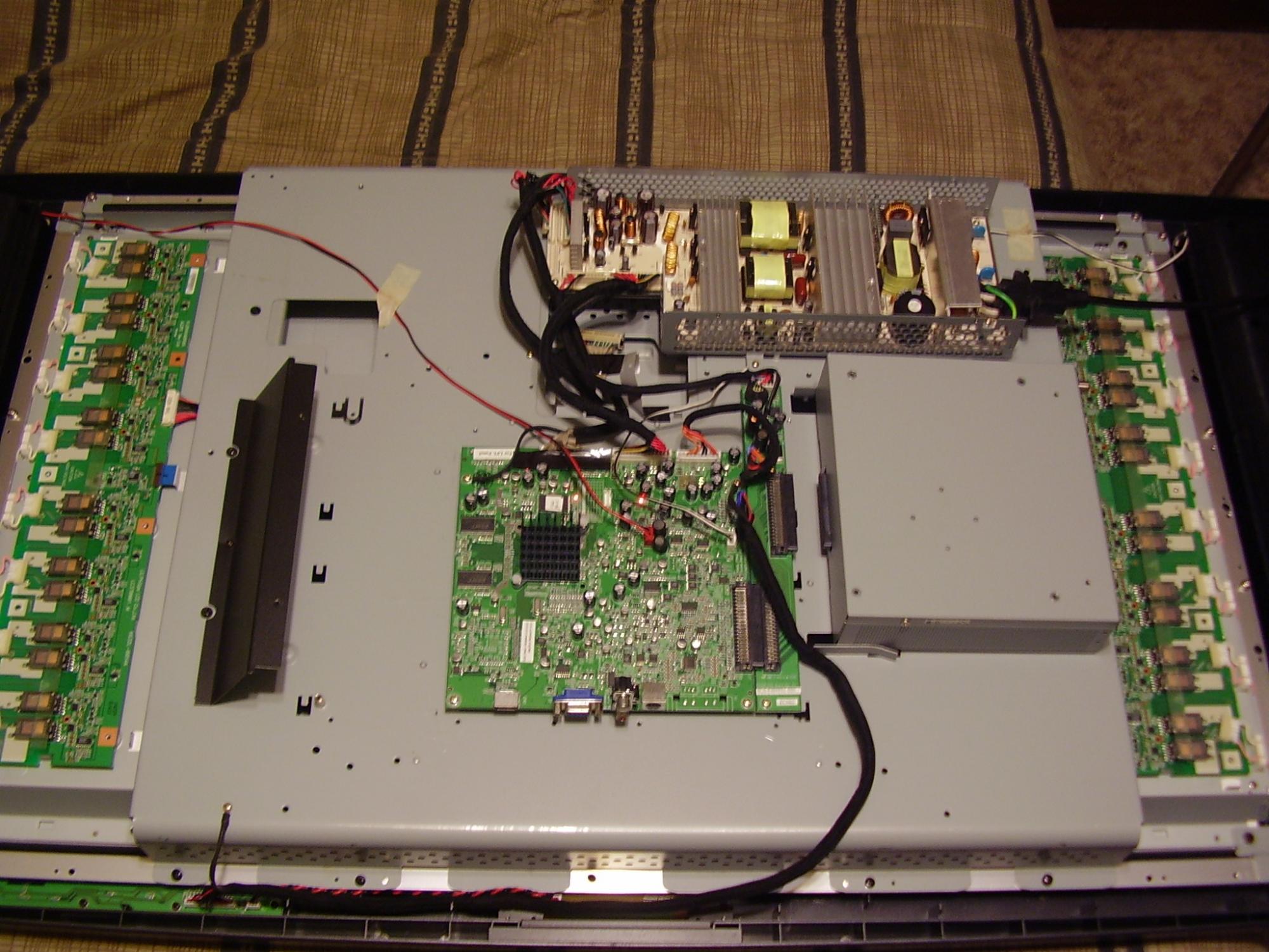

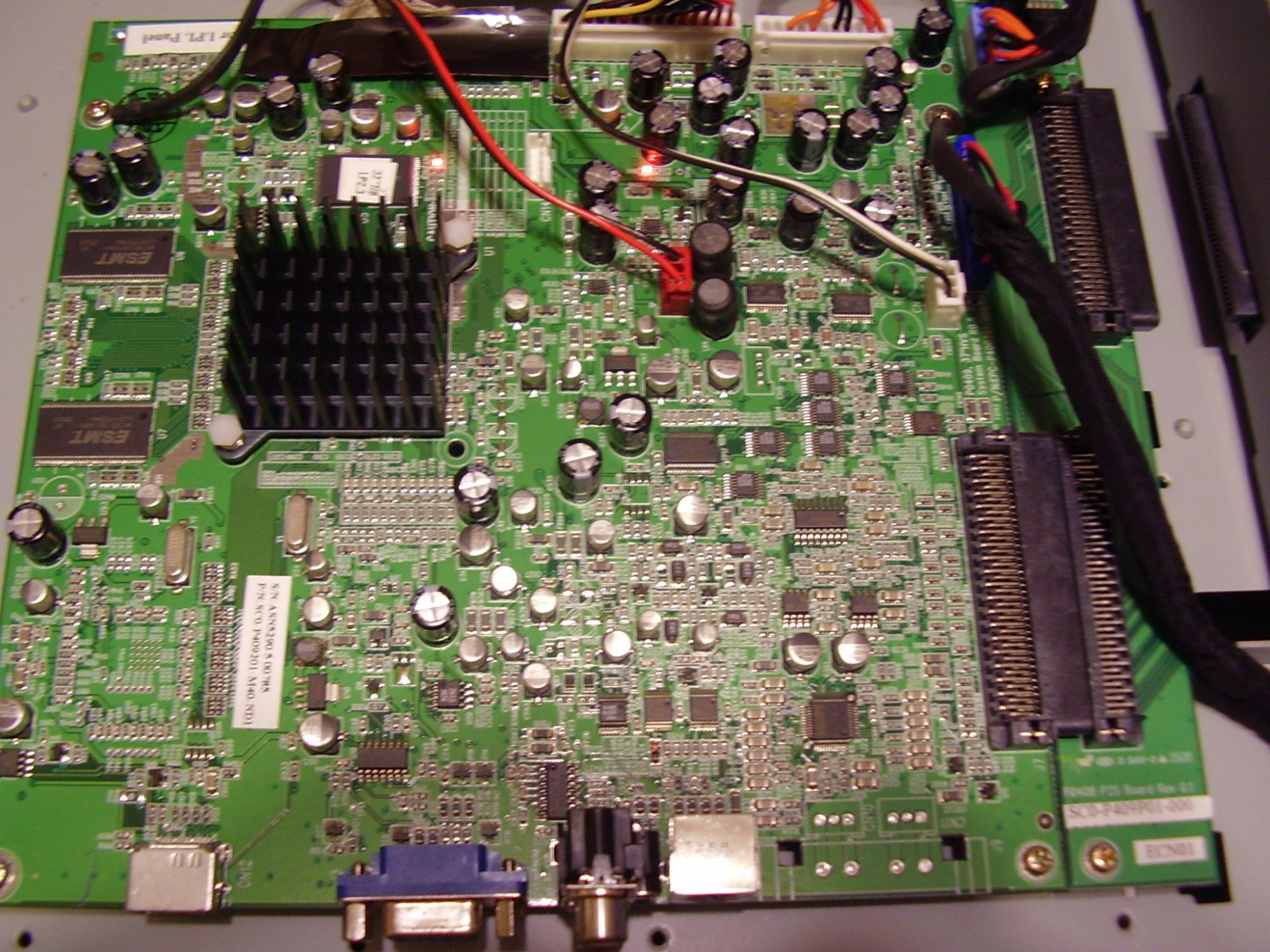

    I inherited this lcd tv and I know they are out of business but I thought I would give it a shot . When plugged in it immediately gets to come on, the blue olevia light comes on and then goes off and I get a blue screen for about 5 seconds then back to a black screen and the blue olevia light flickers then the blue screen comes on again and there is no sound .It repeats this over and over and the buttons have no control and I have to unplug it. I took the back off and plugged it back in and on the power supply there is a buzzing and clicking sound that coincide with the blue screen coming on then the click and the blue screen shuts off. The sound is coming from a transformer?? That is wrapped in yellow tape. I unplugged the inverters and get the same buzzing and a click then I unplugged the t-conn board also and still the buzzing and click. I'm not sure how to test the transformer but could something on the control board be causing it to overload and trip off and on? I hate to throw this out cause the lc370w01 panel is in other 37's and I believe its good. I will post pics in a bit.

    Re: Olevia LT37hvs
    some pics.

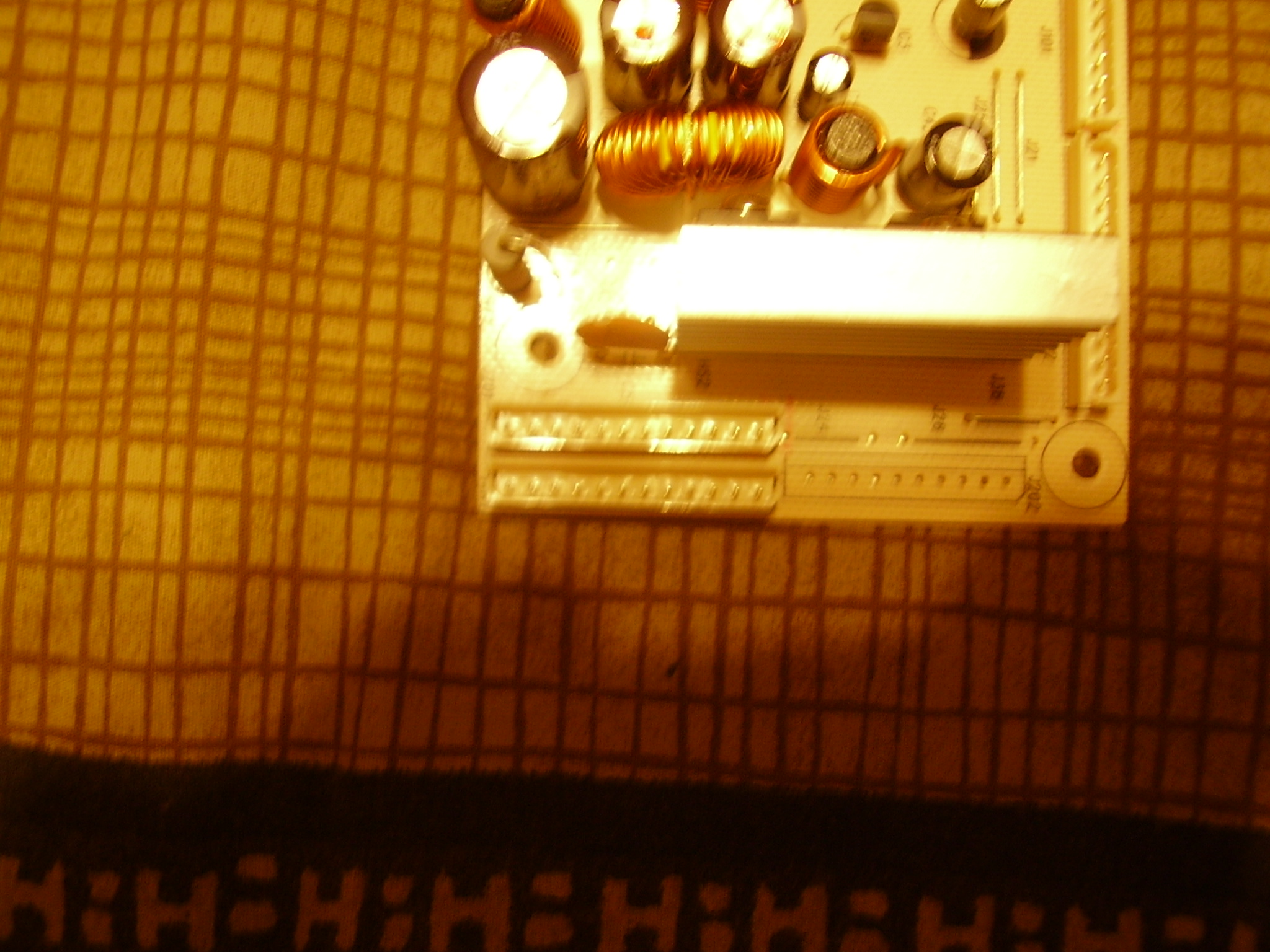

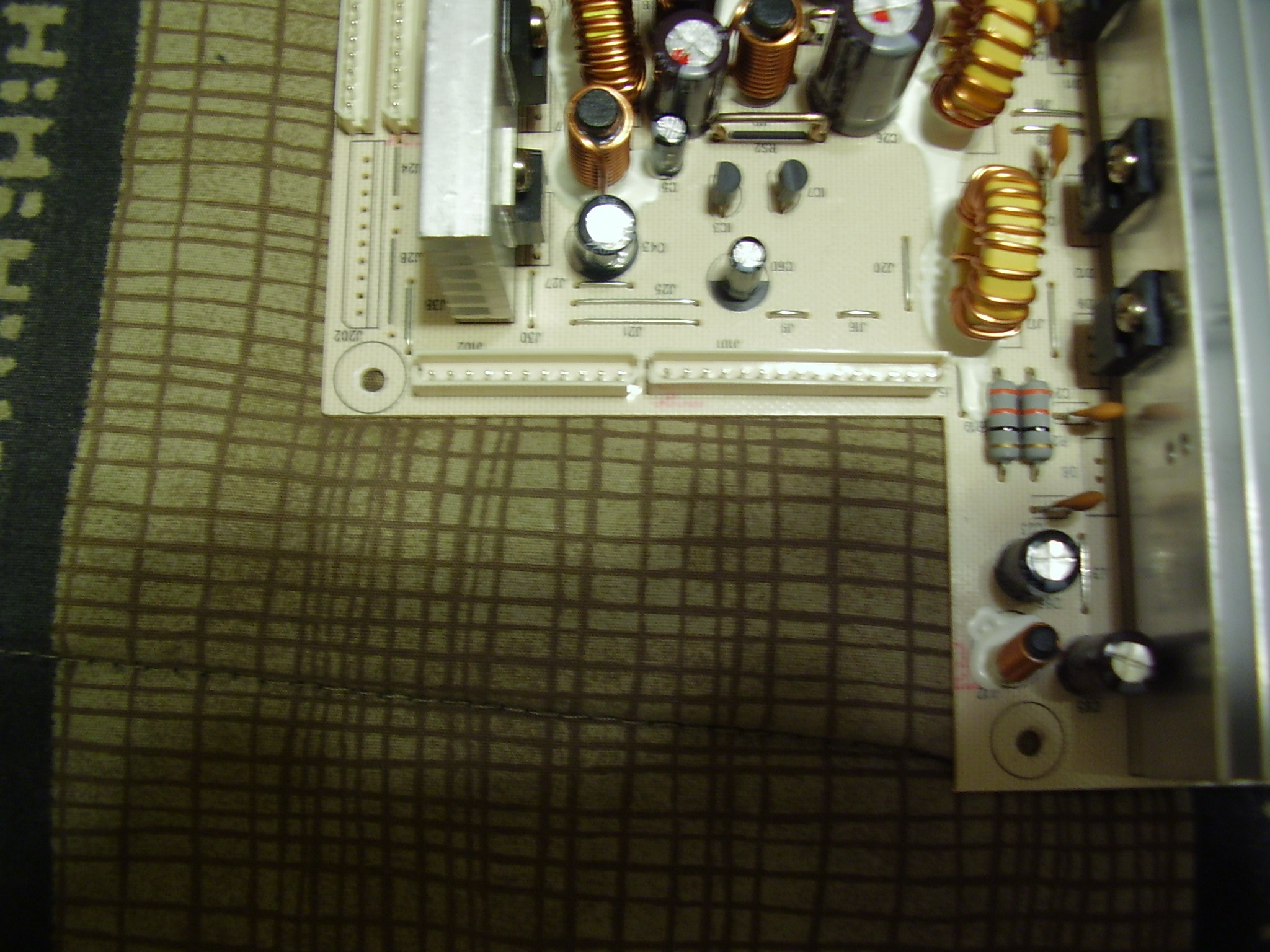

      Re: Olevia LT37hvs
      Can you post a clearer and up picture of the Power supply and, the plugs on the power supply while they are unplugged?

        Re: Olevia LT37hvs
        Hope these pics will help.

          Re: Olevia LT37hvs
          Any idea where to go from here Electronicsurplus?
