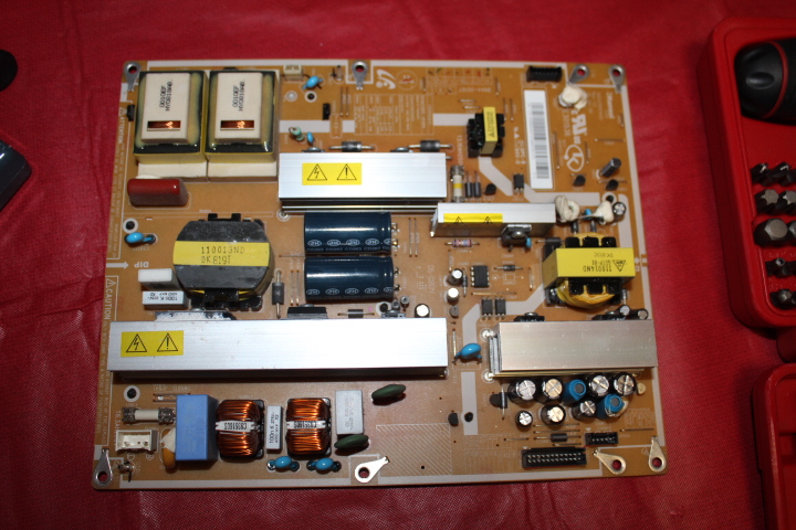

      Re: samsung LN40A530P1F screeching
      OK i finally got the pics.
      The pics are of the power board and everything looks good there there dosent seem to be and bloated or blown capacitors although i did not test any of them with the multimeter yet.
        Hi - pictures are not really clear enough for troubleshooting but have had a quick look and cant see anything that outstands as bad. If you can get better pictures do so and also of the other boards.
        Really what we need is for you to narrow down the screeching - perhaps you did? If not put it all together and get a rolled up tube of card and use that to
        pin point where the sound is coming from.

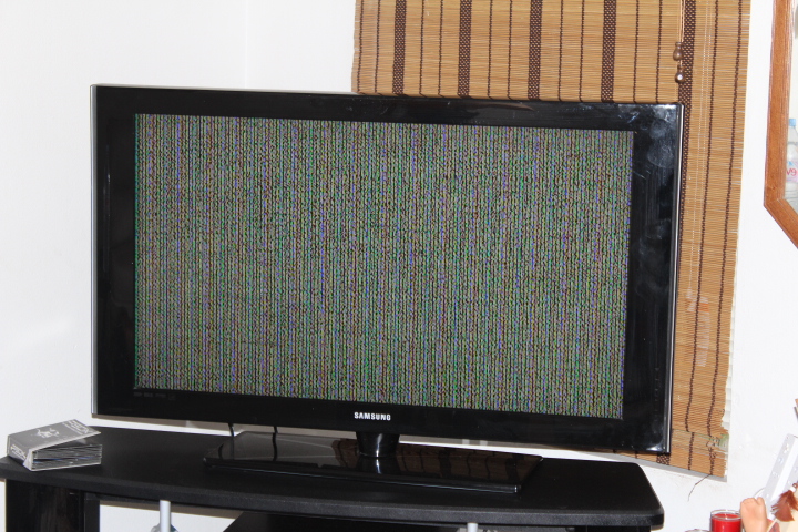

          While I was there I did no hear any screeching from the television.
          The pic of the screen is all it was doing before and after i got it apart.
          and also the television does not do this once it is warmed up

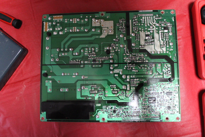

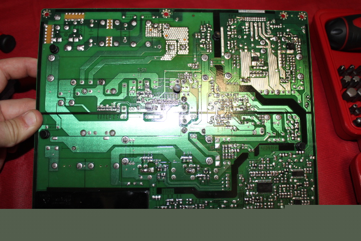

            Also I went over the back of the board with a magnifying glass and there are no jumped fuses and no indications of melting solder or anything like that.
              Did it have a valid source connected
              Do you mean when it has warmed up it works ok with sound and vision
              IF that is the case then you need to let it cool so it doesnt work then switch it on with a valid source and with a hair drier heat one board at a time to try and shorten the time it takes to come on. When you have found heating which board helps then try and narrow it down to a section.
              It could then be a faulty cap or cold joint.
              Also make sure ALL cables are connected - disconnect and reconnect all you can
