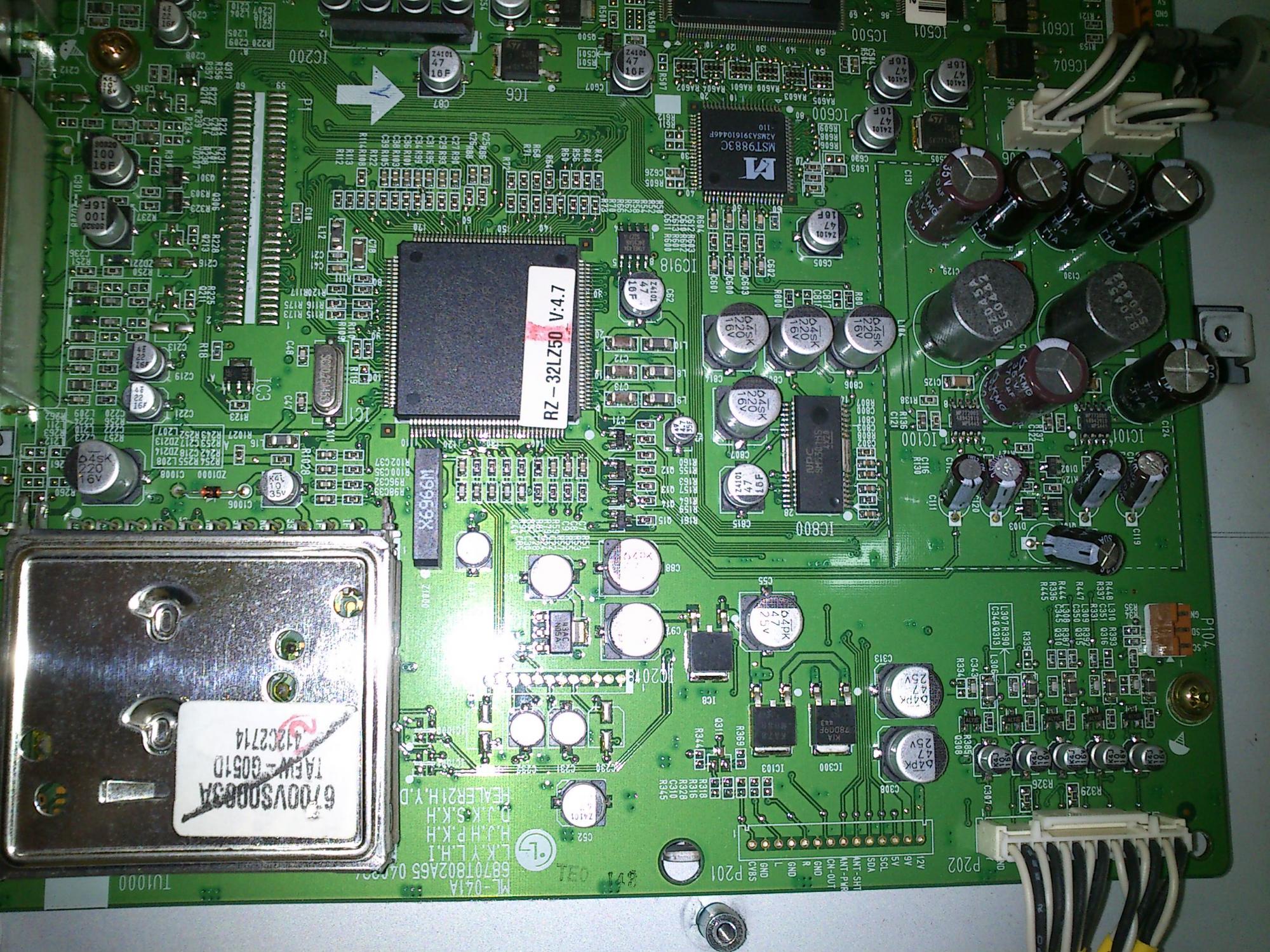

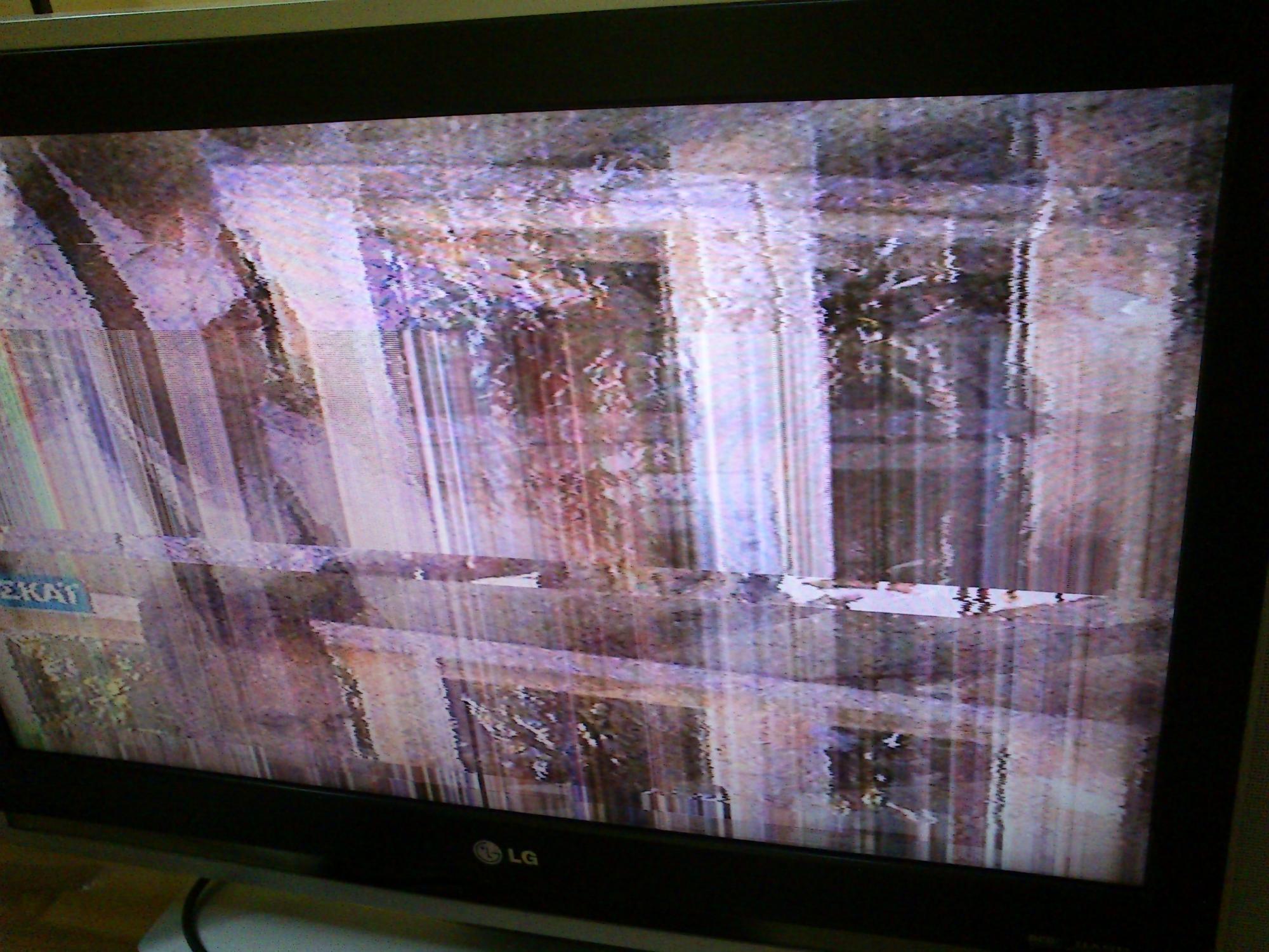

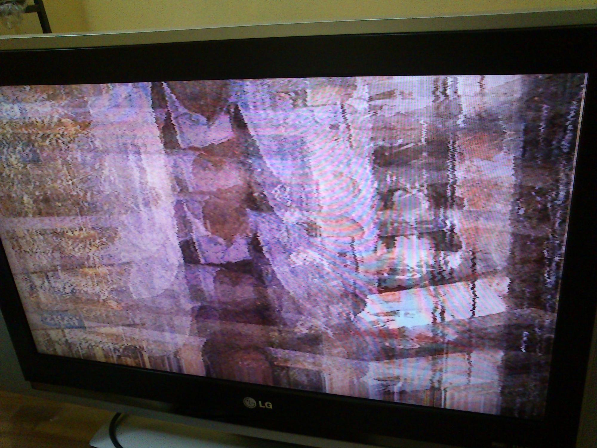

    I have an old LG RZ-32LZ50 LCD TV and the screen is totaly green and fuzzy . I can almost see the menu (not steady on the screen) but on green background .
    Does it worth to play around and fix it since it's a 5 year old+ TV set ?

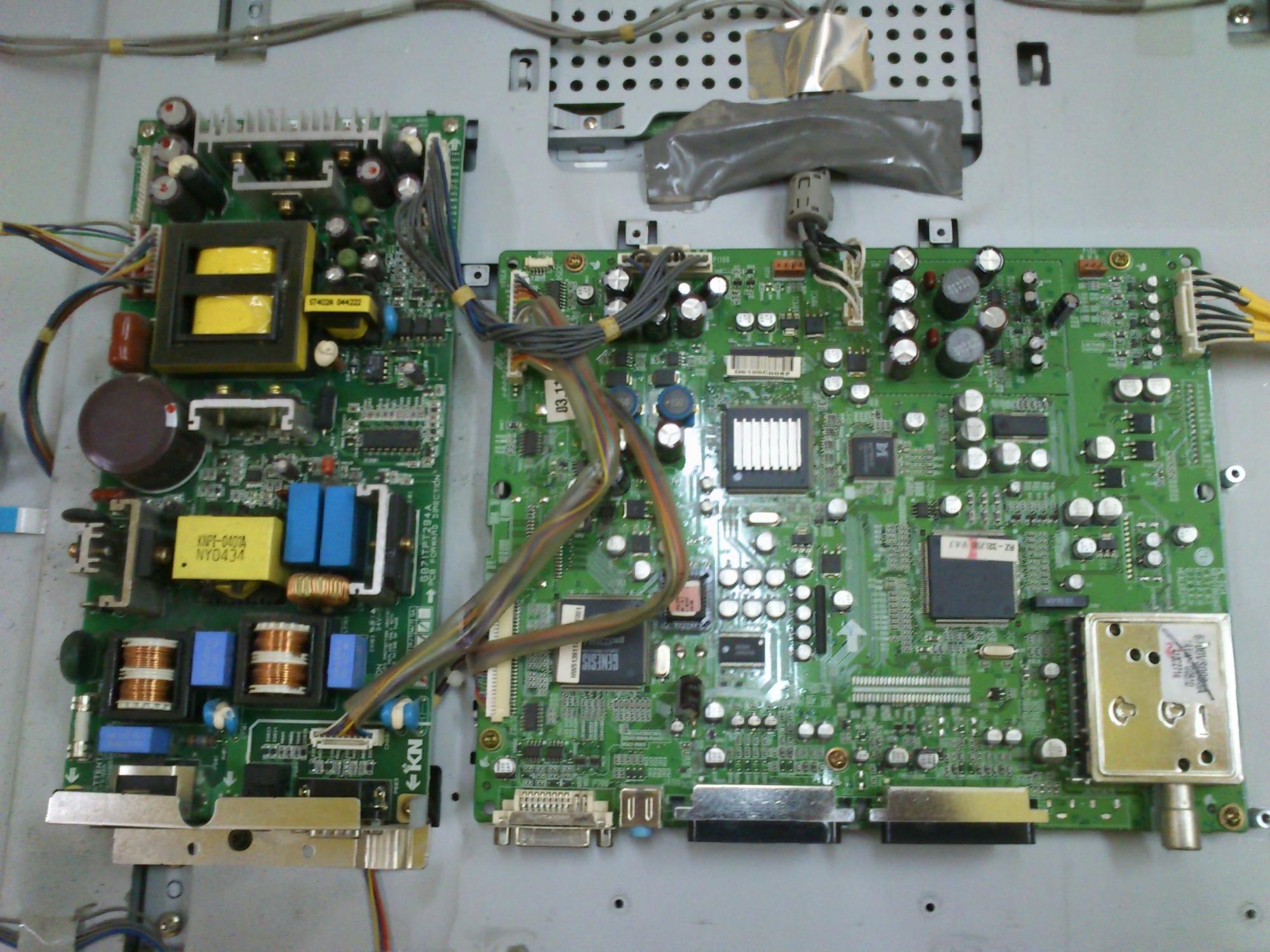

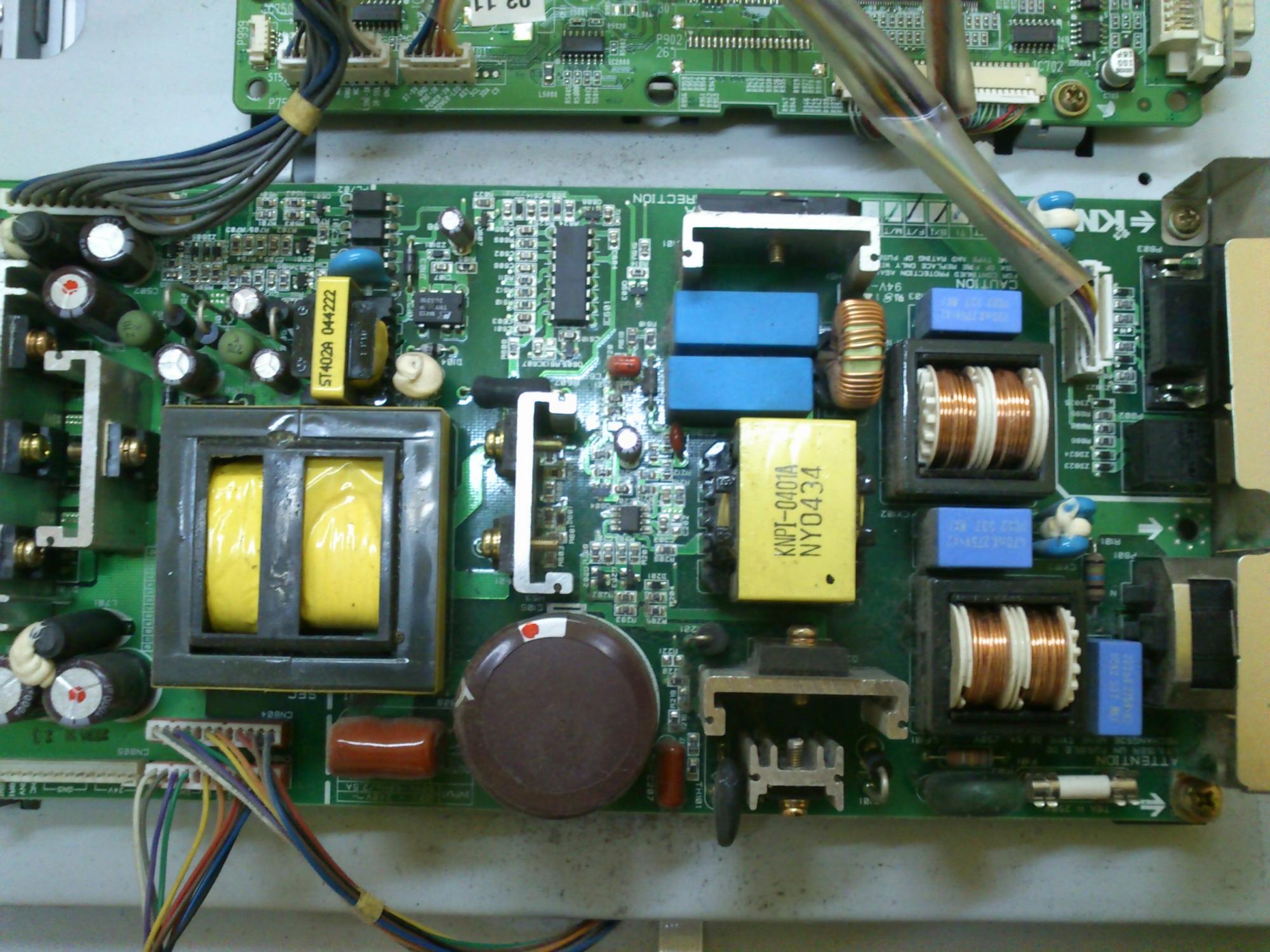

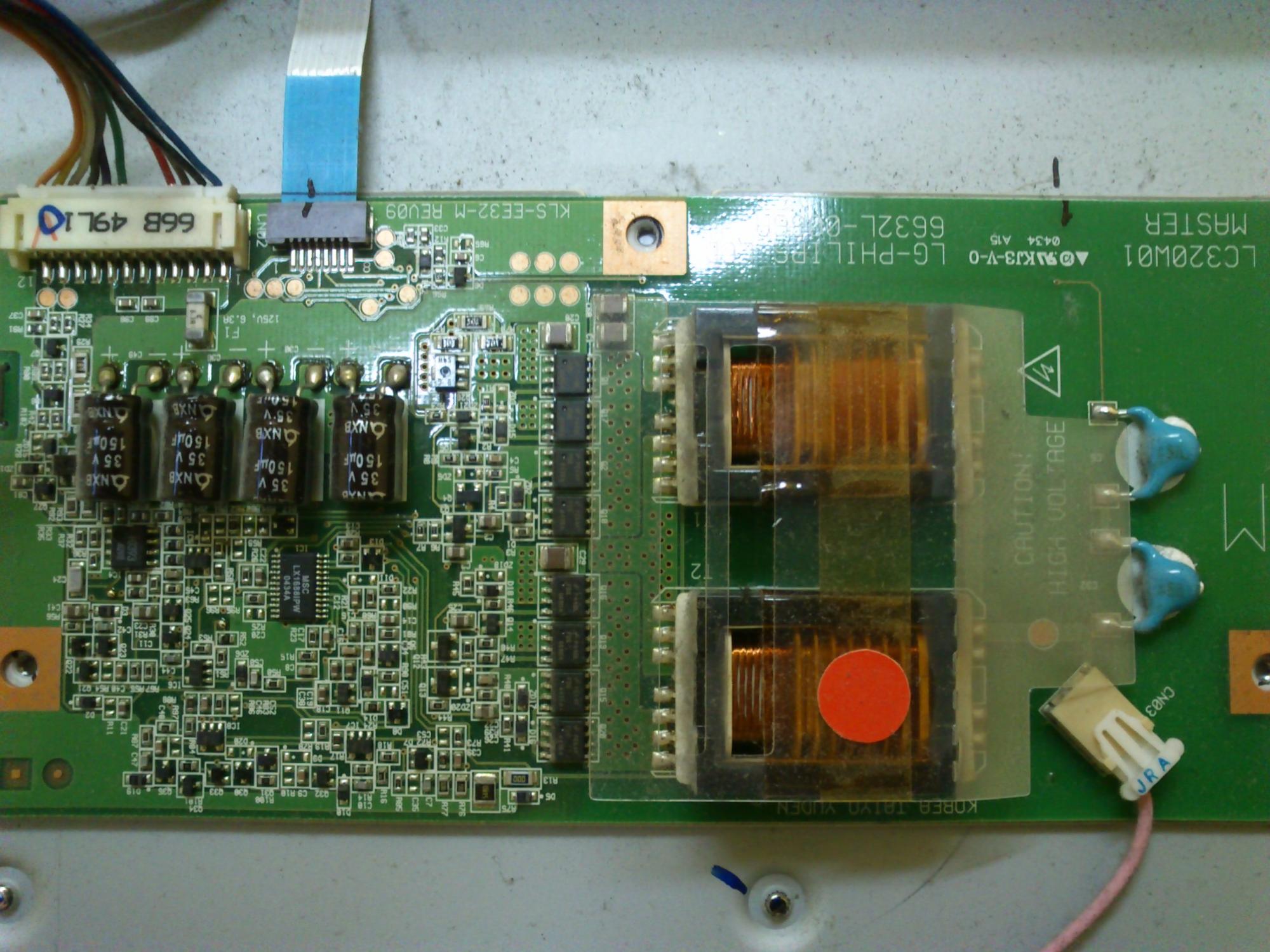

    First thing to try would be to reseat all the cables especially the one to panel or
    tcon.

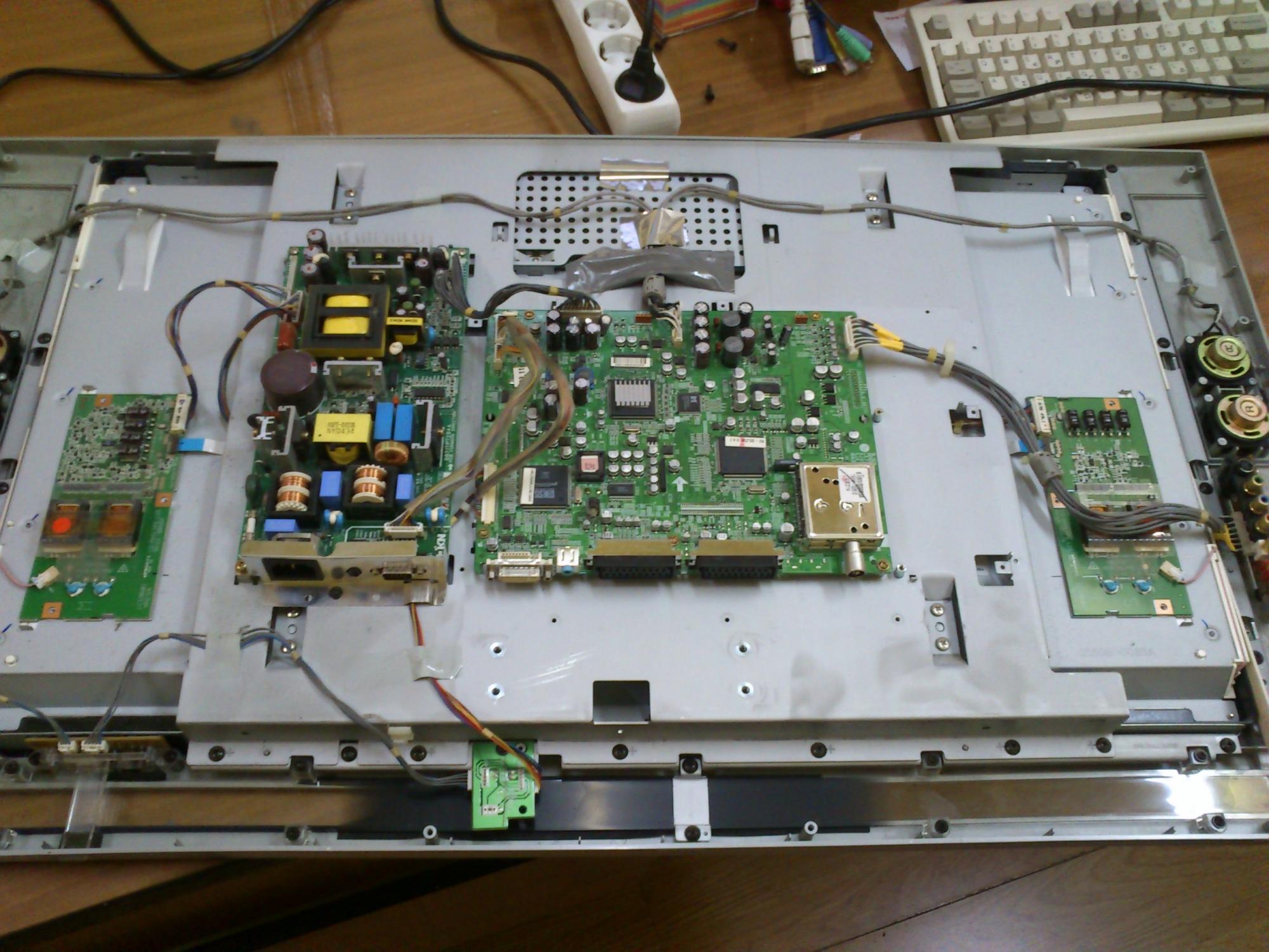

    We can help a lot more if you please post good clear pictures of the whole chassis, and then pictures of each board, front and back and close up of connectors, (max resolution 2000x2000 and 2MB) using the manage attachments button, which is found by clicking "go advanced" under quick reply.

      Thank you for your answer . I tried reseating all cables but no result. The picture sometimes is green and always fuzzy . I have perfect sound and I can see picture but not steady . I can use a multimeter and iron .

        Does it show the same on an AV input?
        • pctek
          • Apr 2012
          • 53
          • Greece
          Re: Lg rz-32lz50 tv
          yes , the same fuzzy screen on all av inputs

            Green screen appears when the tv is cold ... after some time green colour is gone but the flickering remains

              Re: Lg rz-32lz50 tv

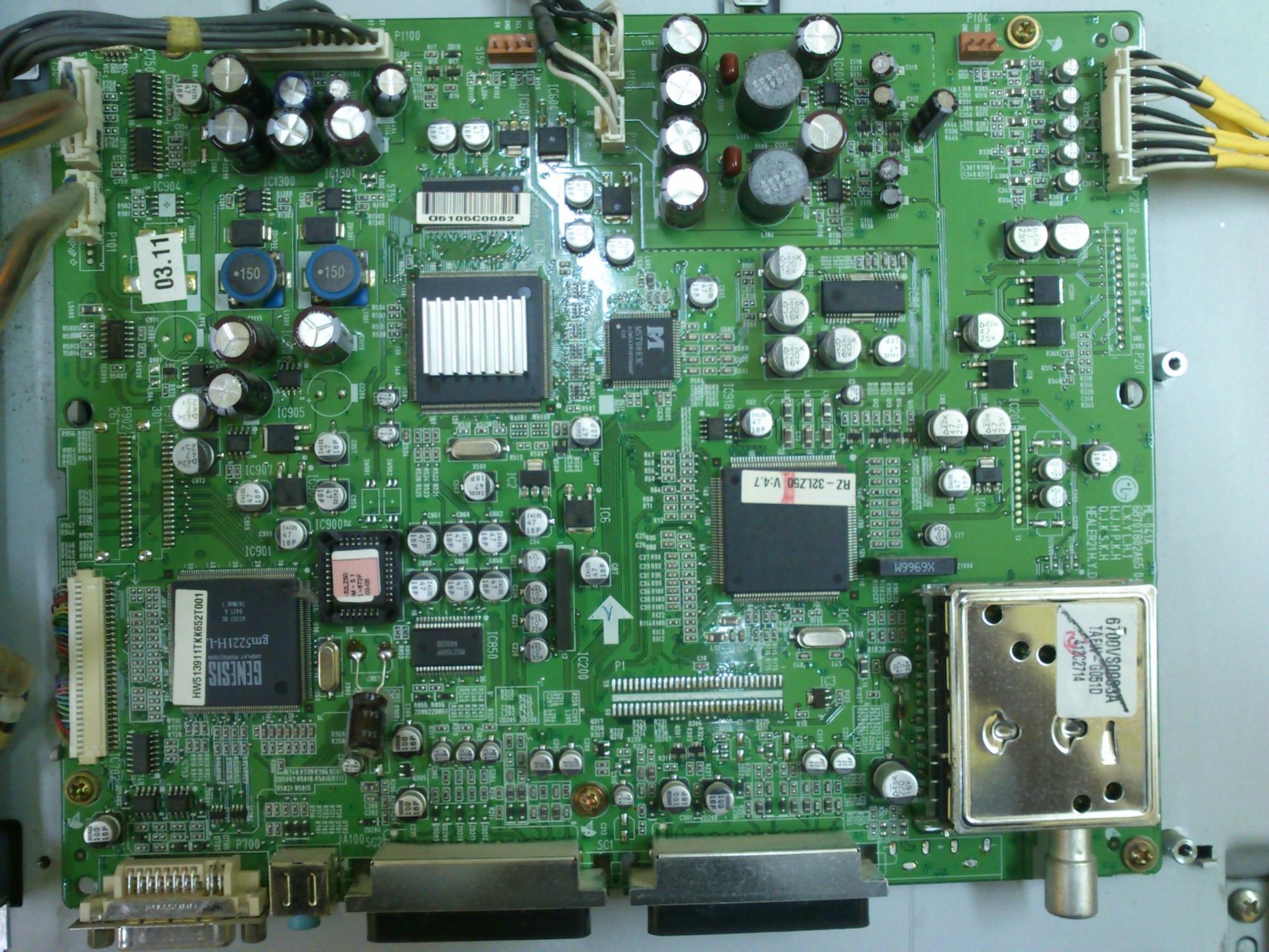

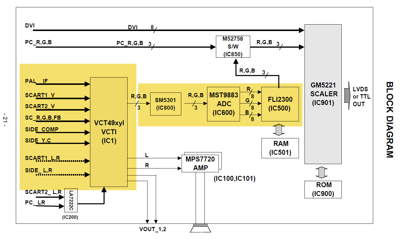

              Hi. I saw that this post is very old, but I have the same model TV and it has a problem like this but not so bad. You can see good image but with a little flicker around D all image. When I use DVI input the image is OK. Only other inputs have this problem.
              Do you have any tips on solving this problem? Regards

                Re: Lg rz-32lz50 tv
                Could be a Main Bd. issue. Though I was tempted to say a T-CON or Panel issue.

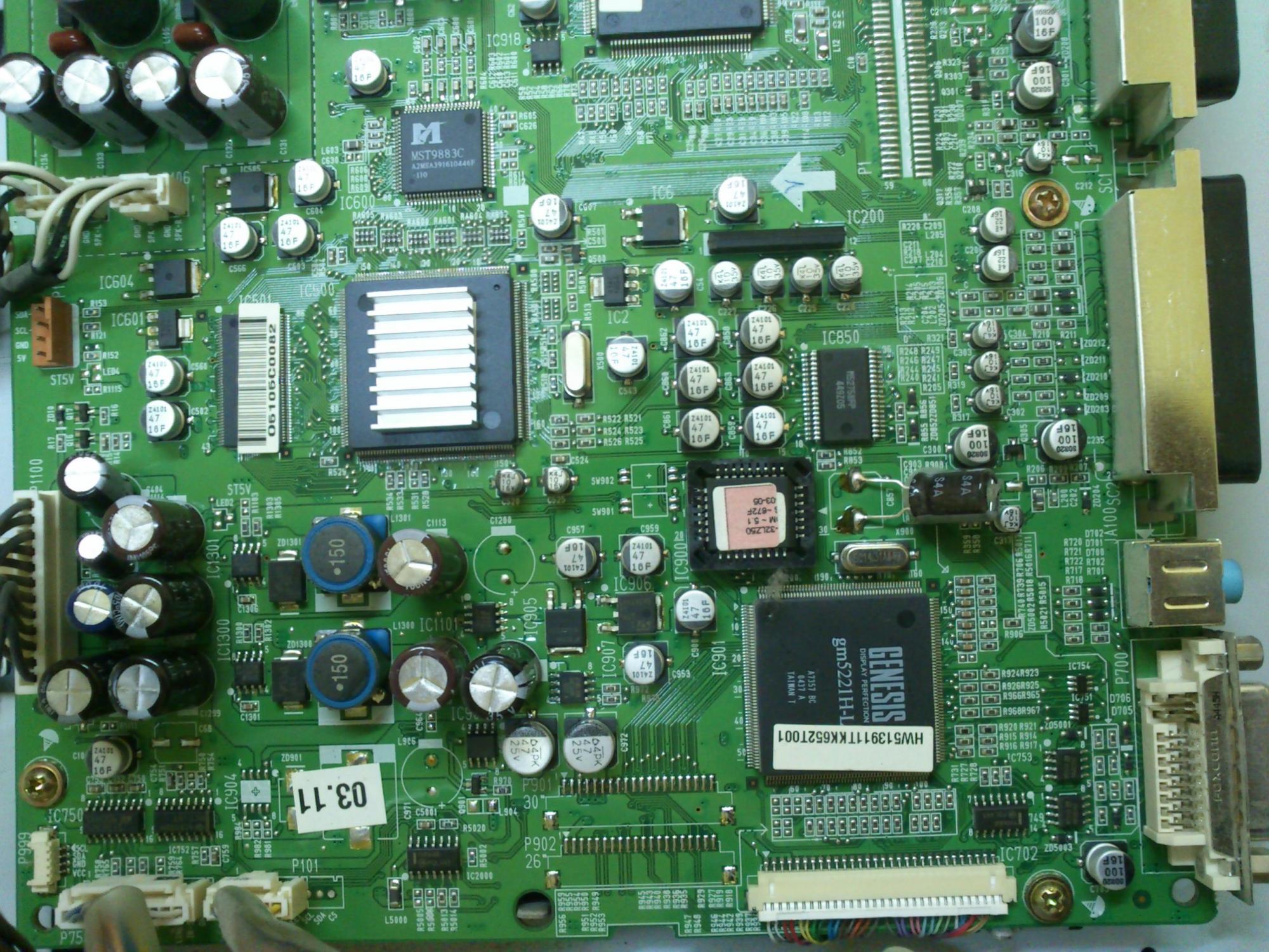

                  Re: Lg rz-32lz50 tv
                  hi. not tcon or panel issue. i've wrote that DVI is 100% working. The problem its in the decode section of the other inputs than DVI as you can see in block diagram. I will try first some solution for a similiar problem as you can see in the photos i will post and then tell you something. regards
