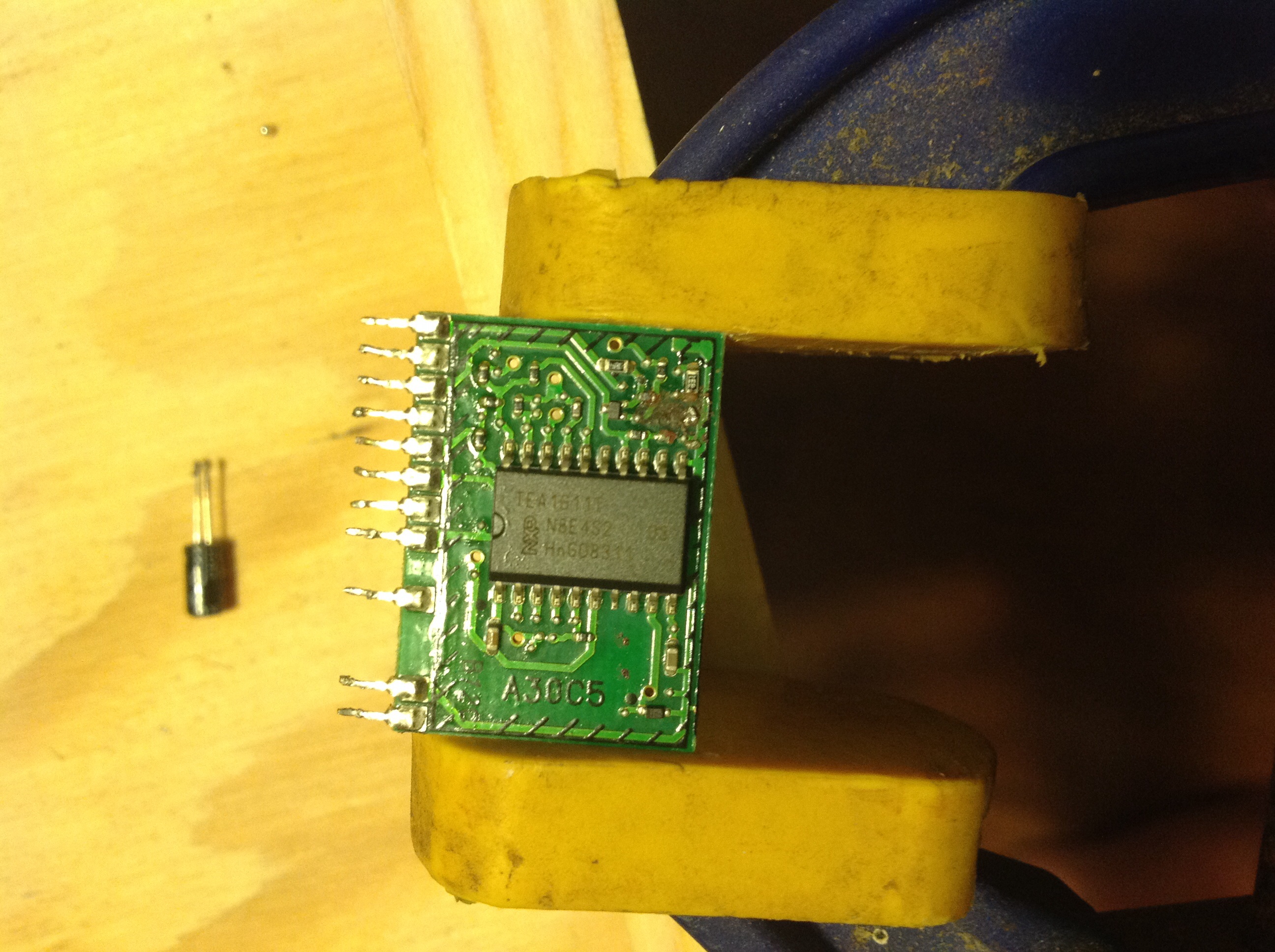

                    Re: Panasonic Plasma TH-50PZ800U power supply light 2 blinks
                    Originally posted by Sevenqi
                    Finally I fixed it.
                    I only cool the ceramic capacitor on the power supply boards MC201, it could power up, so that cap is bad cap.
                    I bought 10 common 1uf 50v capacitors for 1 dollar, and use 1 to replace the bad cap. It's hard to sold because it's too small, I almost damaged the curcuit, so I use two soft / small wires to link to the new cap as show in the photo, and it works fine !
                      thankyou so much! I fixed my tv.
                      th-50pz800a melbourne
                      2-blink
                      Cool the ceramic capacitor on the power supply boards MC201, it power up
                      Solder a 1uf 50v BIpolar capacitor to replace the bad cap. very hard
                      I did it. thanks again.
                                Search ebay, there are some repair service for MC201. If you didn't ruin the PCB, try the board MC201 without that bad cap to see if this works.
                                If the PCB was ruined, then try to download the datasheet TEA1611T and fix it or go for reapir service.
                                  #36
                                  You have caused some damage to the board, but it is repairable. I know this because I did the same on my first repair (on one pad.)
                                  You just need to put the capacitor across the pins 11 and 13 of the TEA1611T chip. This is easier if you glue the capacitor to the top of the chip first. The negative side of the capacitor goes to pin 11.
                                  I do recommend you have a professional try it though unless you feel confident.

                                    #37
                                    Thanks guys for your knowledgeable input.
                                    I want to verify your direction prior to trying this. Attached is a diagram of what I believe you are suggesting I do to remedy this problem I created. If I understand correctly, I should solder my cap onto the top of pins 11 & 13 which are already soldered in and that will circumvent the cap and connections I damaged? I drew on the diagram attached what I believe this will look like. (please no comments on the poor artistry) HAHA
                                    • martino
                                      Not so "senior"
                                      • Aug 2013
                                      • 997
                                      • canada
                                      #38
                                      That is correct......negative lead from cap goes to pin 11....
                                      As Tom66 suggested,glue cap on top of IC first,then you can easily bend the legs to pin 11&13 and solder them on,double check that you don't have a solder bridge between any of the IC legs...

                                        #39
                                        Ok thanks! I will verify but I did not replace the ic so hopefully they were good from the factory. I assume it is okay to do this same capacitor replacement method on the MC301 while I have the pcb removed? In the event that MC301 is the culprit for my issues.
