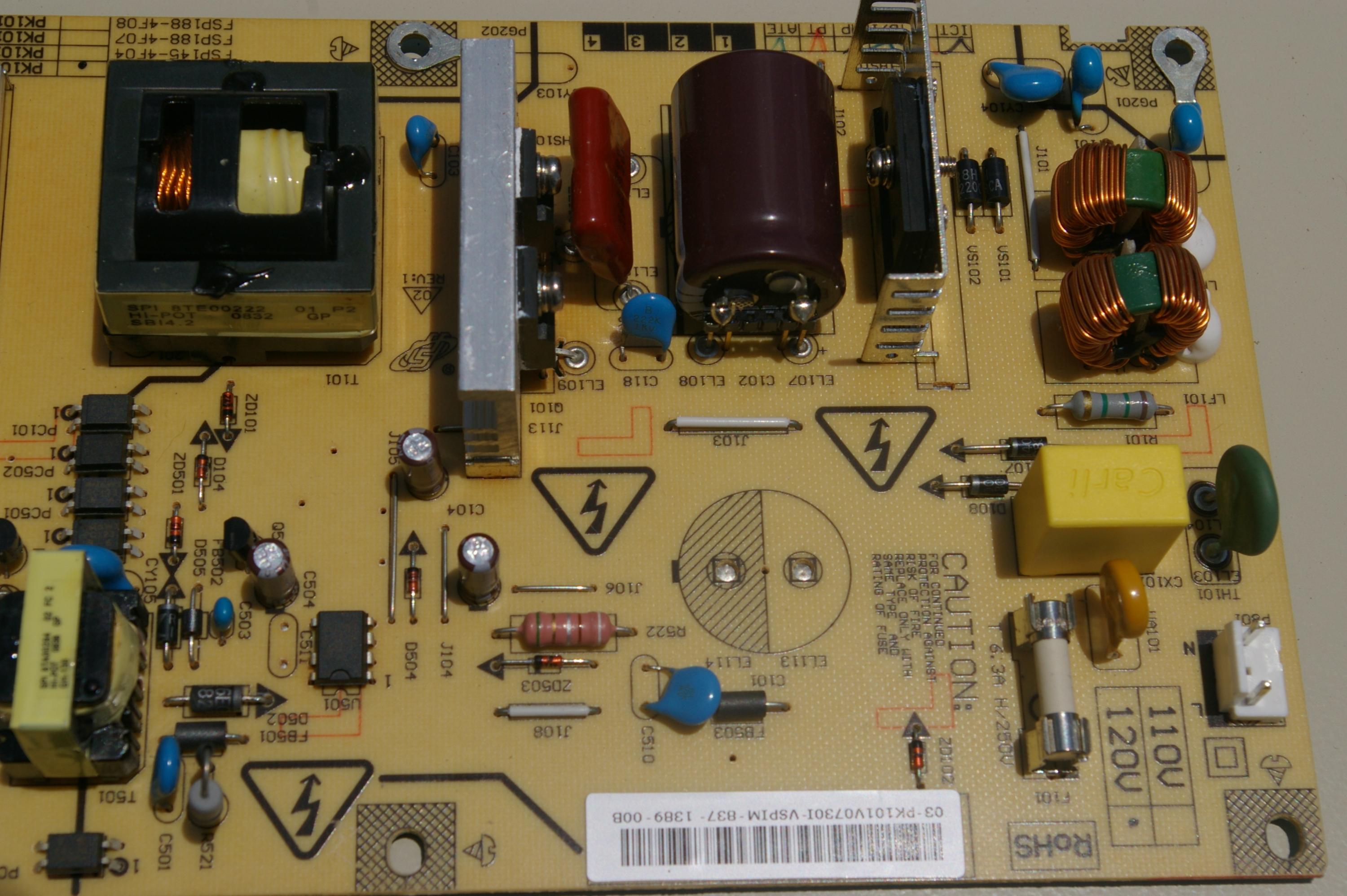

So, based on budm's previous instruction, I'm not sure what I should do next in troubleshooting. If I should try heating up the caps, or move to replace the diode? Given this was probable surge (or repeated surge) related damage, I wonder if the snubber is a likely culprit as well.
"it read about 65-75 in both directions" is that 65 Ohm, 65K Ohms, 65M Ohms? I should show OL in one direction at least.
Can you read the number as printed on it? I still need the P/N of that IC next to it so I can look up the spec sheet.
I get that reading of 65 in one and about 75 in the other direction only with the meter set at 200K ohms or higher. At lower settings, it just seems to show infinite resistance, or it will jump back and forth between infinite and some random number.
I'm including a bunch of new closeup pictures. Regarding the chip. I'm assuming at U501? That number (hard to read) is A625M SK873 481D. Thanks!

1) Try heating up C502, 504 startup cap with hair dryer for a few minutes then plug the TV into the outlet to see if the 5V STBY will work.
2) If not, unplug the TV, then check ZD501, check and report the resistance between ground pin 3 of IC U501 and all other pins of the IC.
