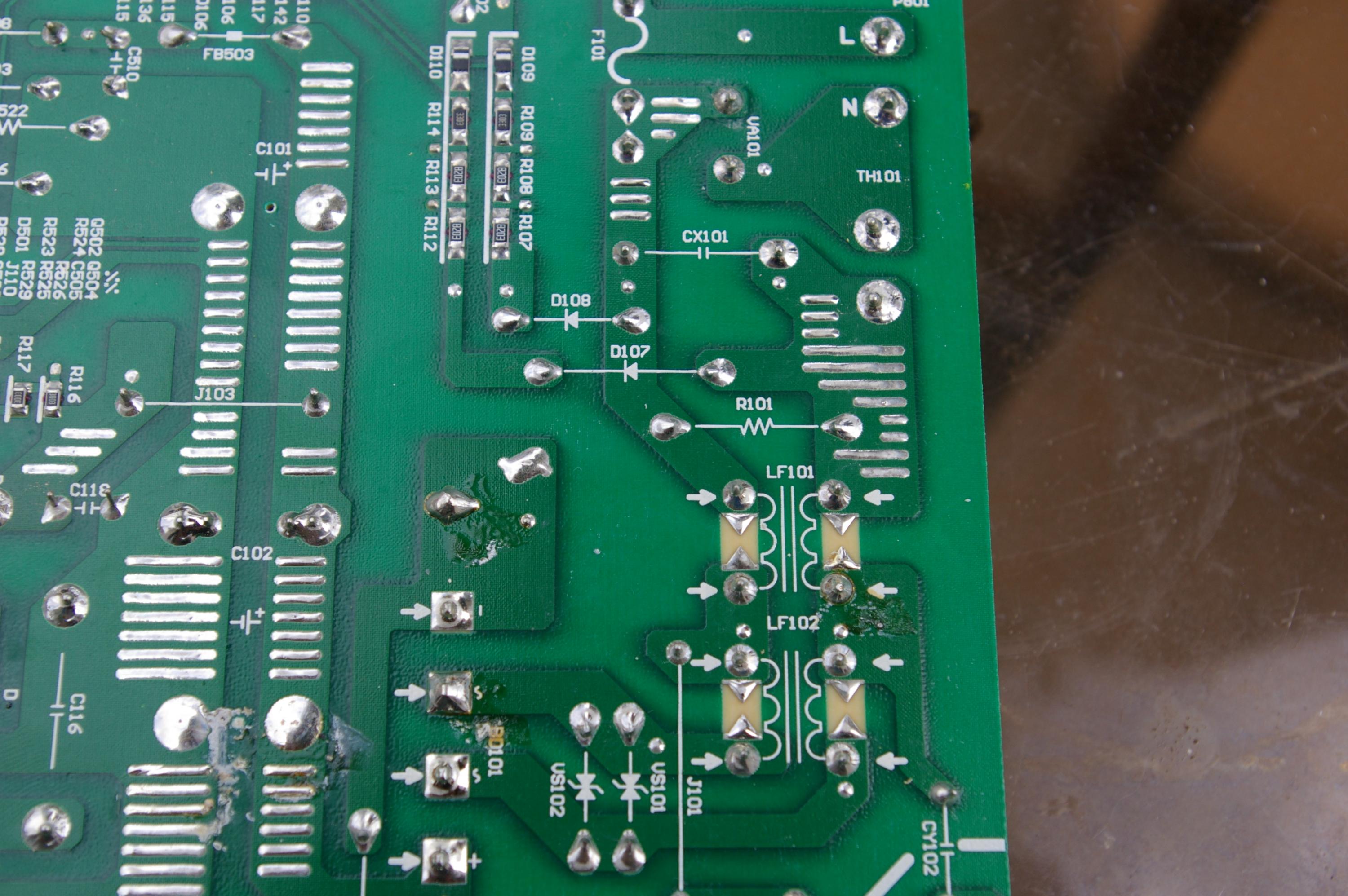

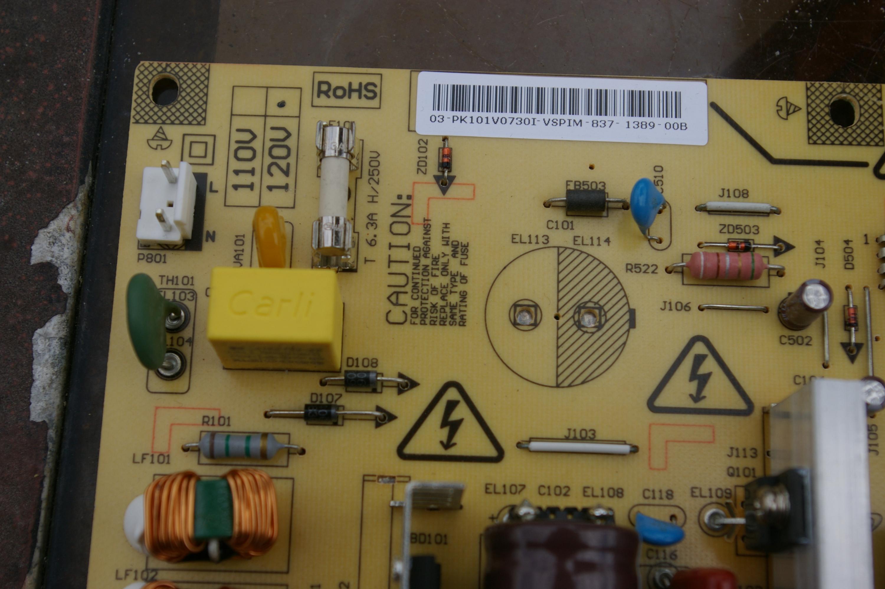

                #47
                Re: Toshiba 32AV502U fuse blows
                Thanks for the replies. Here are some pictures as requested.
                  #48
                  Can we see the pictures of YOUR board? Both sides of the board and around the area that you have checked the AC voltages.
                  By the way, the board has TVS (P6KE220C) also for the surge suppressor.
                  So you are not getting 120VAC at the two pin of the MOV UA101? Remoev and reinstall the fuse.
                  The line (HOT) is fed through one end of the fuse, the other end of the fuse is connected to one end of the MOV, the other end of the MOV is connected to the Neutral. If you are not getting 120v right at the two legs of the MOV, you either have open fuse of bad solder joints. Fuse reistance reading using 200 Ohm scale?
                  Have removed and re-installed fuse. I get continuity across fuse, so I assume it is good. Based on what you said, it would appear I do not have voltage across the MOV. I'm puzzled, because the solder is there as you can see. Voltage at the first leg directly off the neutral trace, but not on the other side, so no voltage at fuse.
                    #49
                    There is not that many connections in that areas, something is being overlooked. Resistance reading of the fuse?
                      #50
                      Resolder connection at the L, N of the AC input connector, fuse holder pins, TH101 (in rush current limitter) pins.

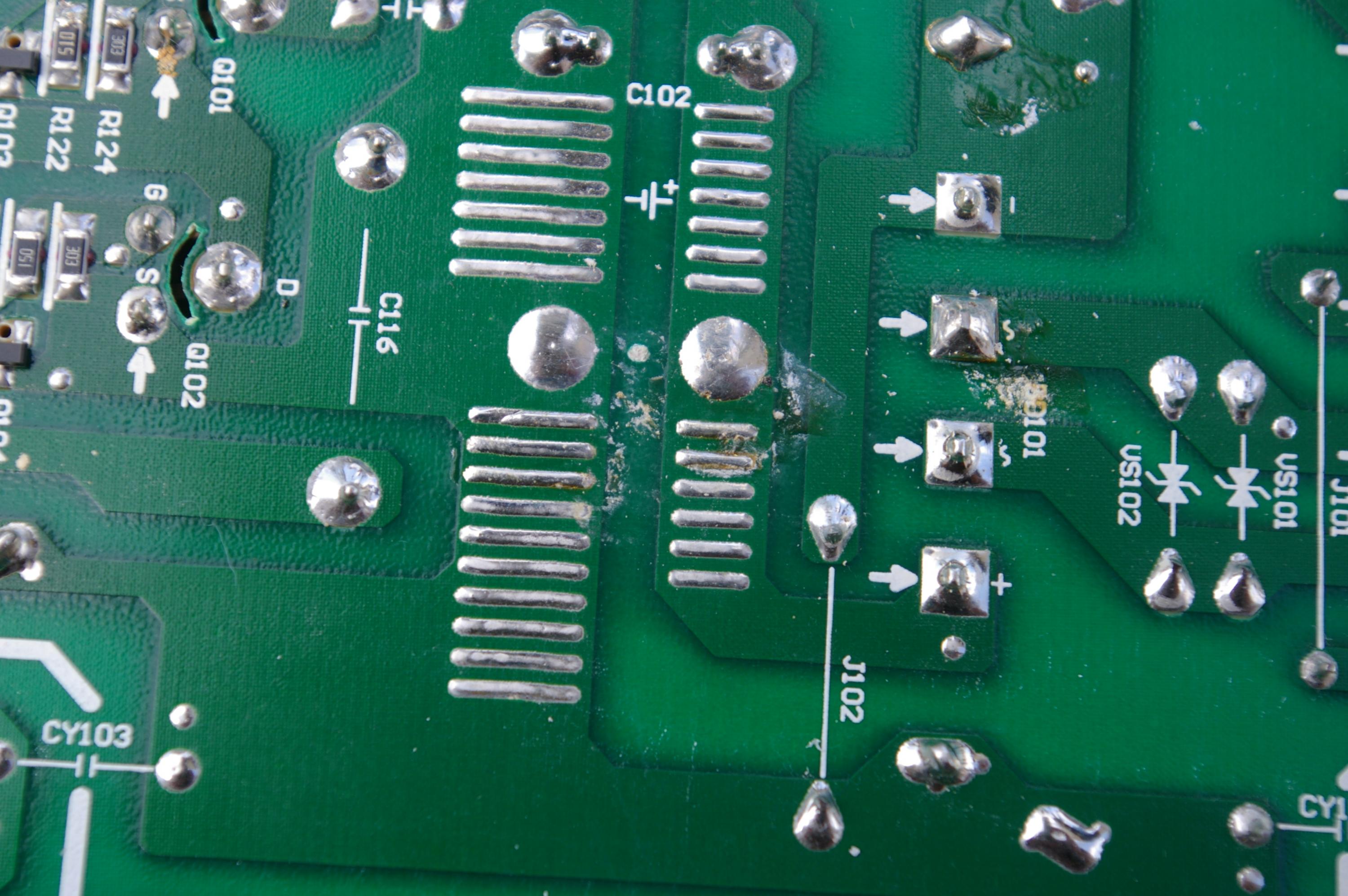

                                    #57
                                    Is this a clue? I tried to spot any visible damage on the board. There were some additional deposits around the large cap here that I scraped off with fingernail. I think I have power leading up to this cap.
                                      #58
                                      Did you use AC or DC voltage?
