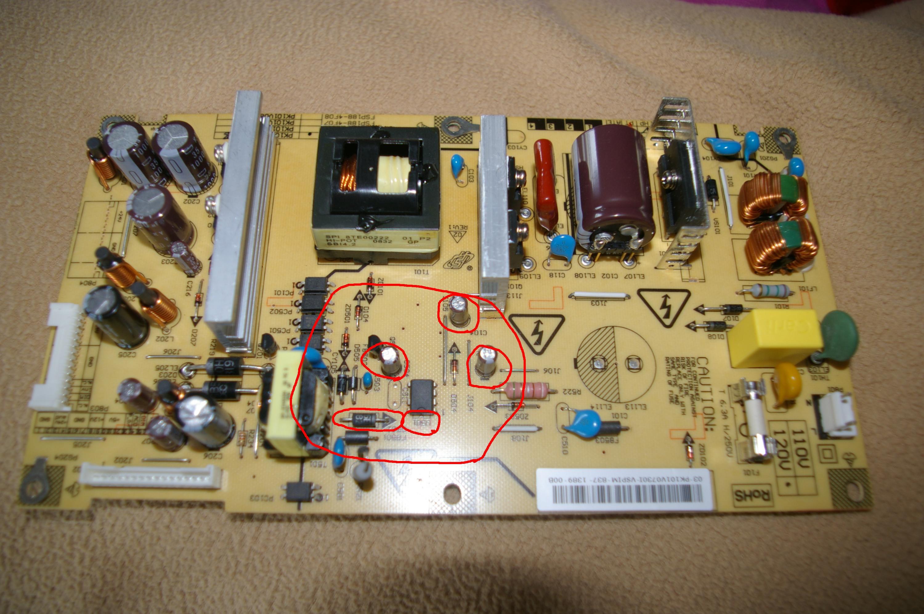

                          #72

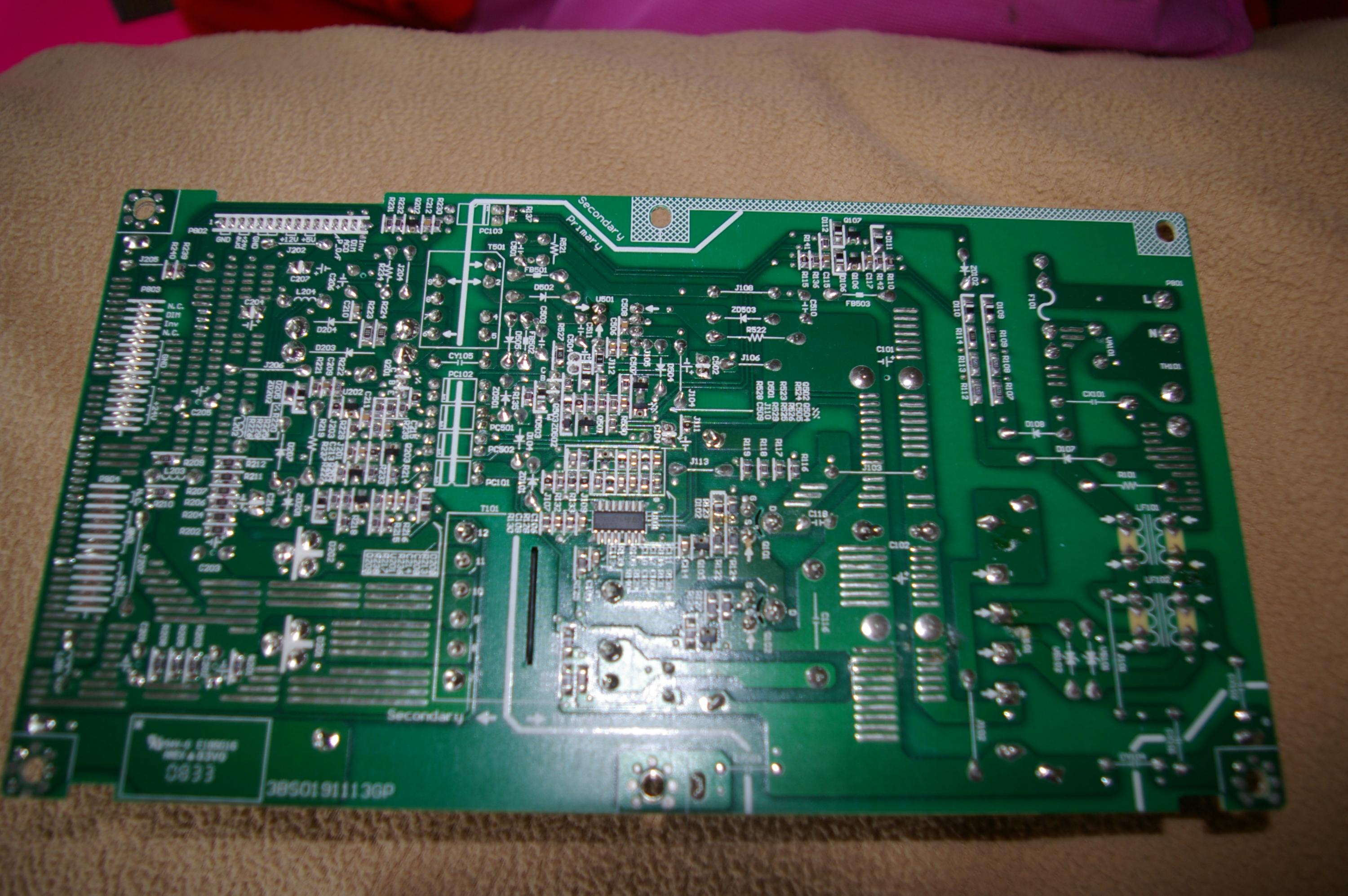

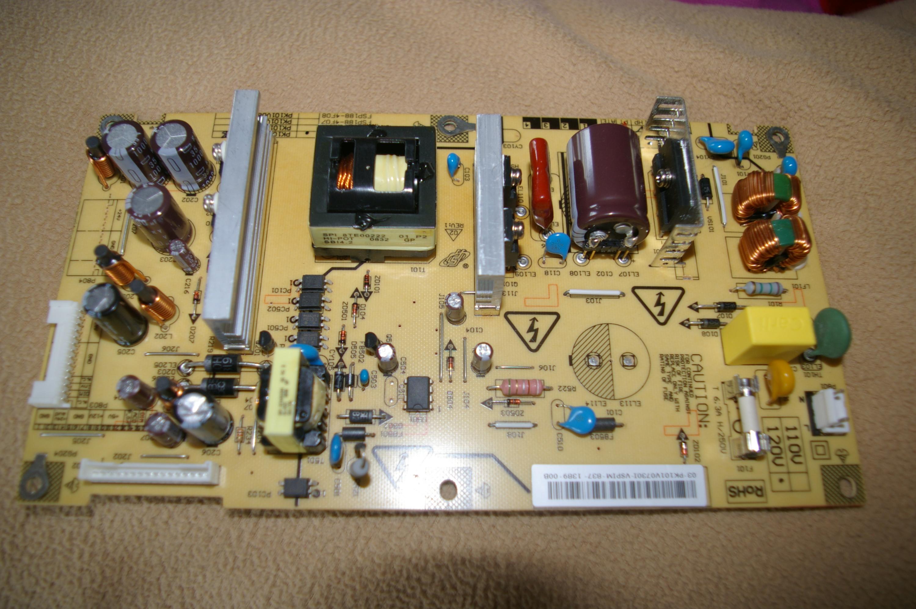

                          Re: Toshiba 32AV502U fuse blows
                          Thanks for the reply, budm. Yes, I do have 160vdc at C102.
                          Here are the pictures of the board as requested.

                              #74
                              OK, your main DC is OK, there are two power transformers, the small one is for the 5V stby power supply which is not working right now, we need to get it running first.
                              Can you read the P/N of that 7-pin IC (U501) which is the switched mode power supply IC. Check the snubber Diode D502 to see if it show low resistance reading on both directions. If it tested good, then With the TV not plugged into the outlet, heat up those 3 small caps with hair dryer for about 3 minutes, then plug the TV into the outlet, no need to turn on the TV, then check and see if you get the 5V or not.
                              I also need good closed up pictures of the board (both sides) in 1/4 section at least so I can tell you the test points and the components to test.

                                #75
                                OK, I used a small analog volt/ohm meter to check the snubber in "both directions". I'm not sure if I did this right, but I ensured the meter was set to ohms x10. I then tested with terminals touched together which moves the needle all the way to the right to 0. I used the 0 adjust to put needle at zero. Putting the probes on both sides of the diode, I got a reading of about 3. Reversing the probes, I get no reading (infinite resistance?). Does this mean the snubber diode is no good? I did this check with the board disconnected completely from the tv.
