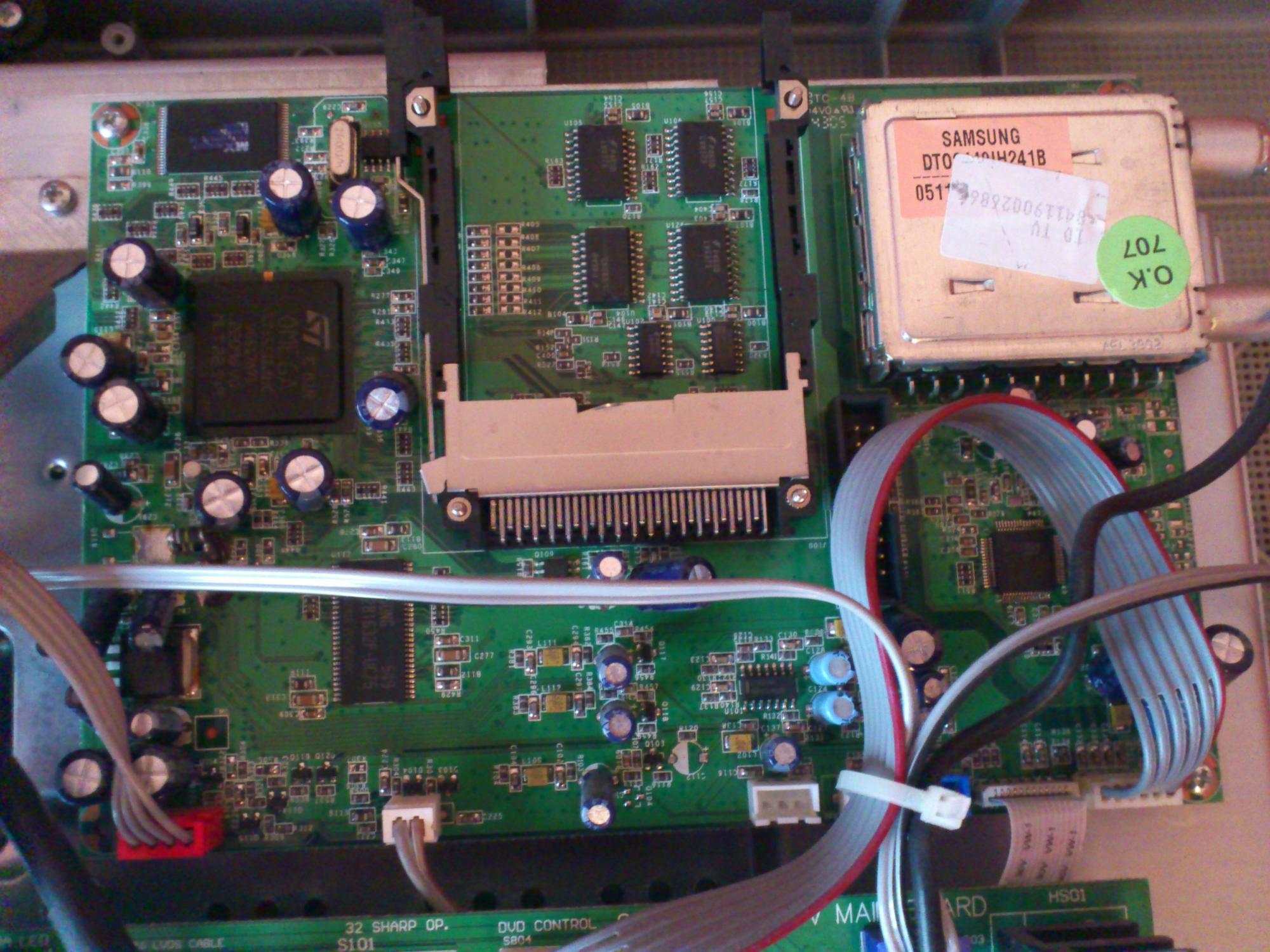

    hi, ive managed to fix the faulty power board on this tv, and now it works until i tune in freeview channels, then the tv starts to glitch and then freezes and i have to either turn the tv off then on, or change the input to scart or tv and it works ok but then when switched back to digital its still on the same freezed screen
    would this be the tuner board(suspected) or could it be a main board issue, i dont want to order the tuner and it still not work, so anyone with similar fault could point me towards a solution
    will crack open again later and take pictures of tuner and main board if needed
    Re: Bush IDLCD27TV006 fixed but Freeview crashing
    Vestel chassis? Reseat the connector from Freeview DVB board to the main board, on mine it was loose and causing random lockups.

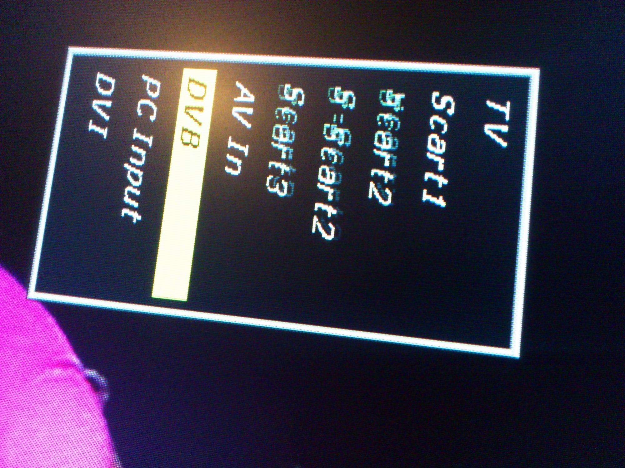

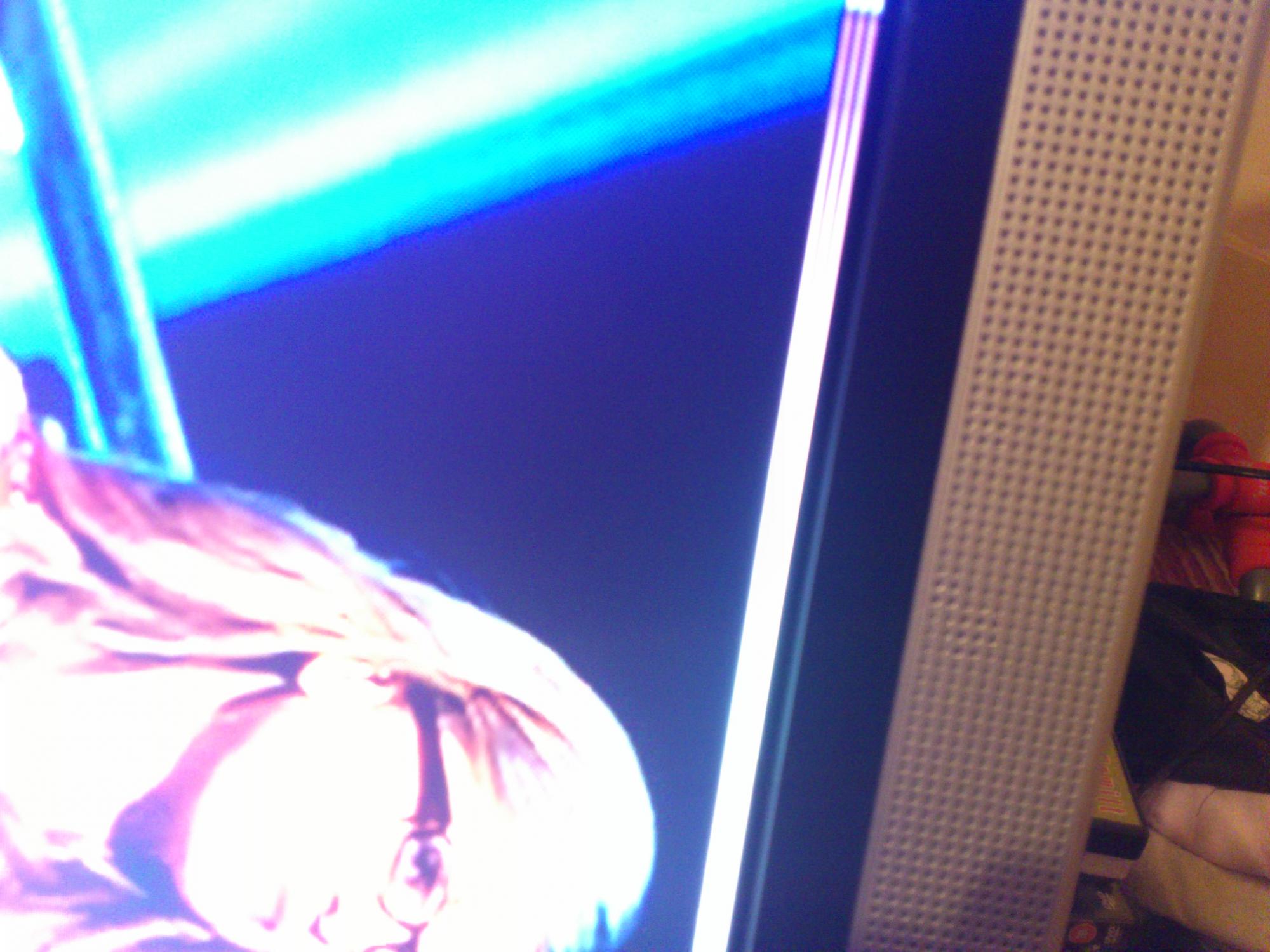

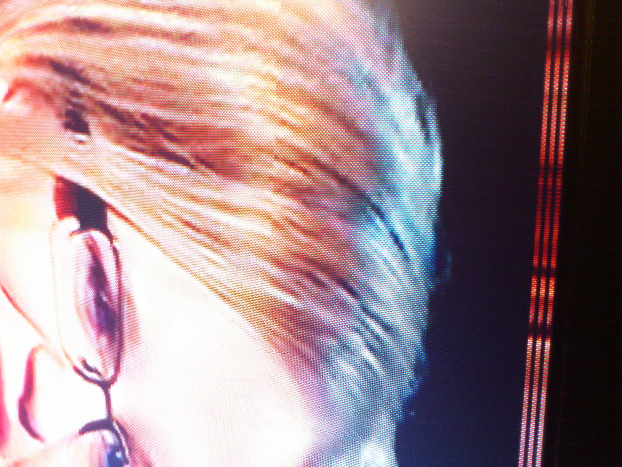

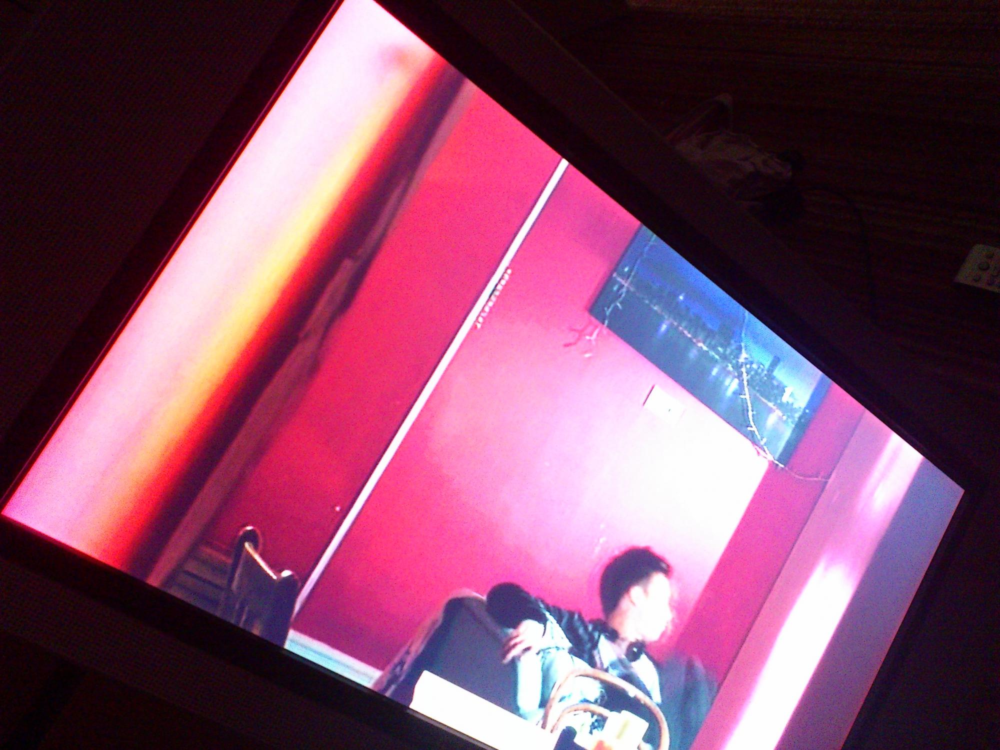

        tv works fine through SCART FREEVIEW BOX, ITS PERFECT!
        but through tv(analogue) and Digital its like theres an issue with the tcon, glitching screen and menus glitching(see pics with the lines), but when through scart the menus are fine and picture is good(last picture)
        ive checked all the connections and they seem fine, ive even tried wiggling when tvs on and its not done anything differant, im starting to think the main board might be knakered and thats why the scart works and the others dont
        any ideas anyone?

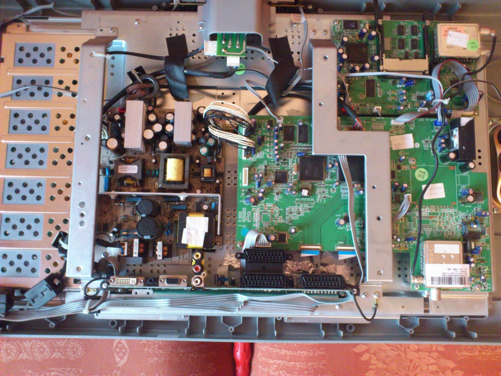

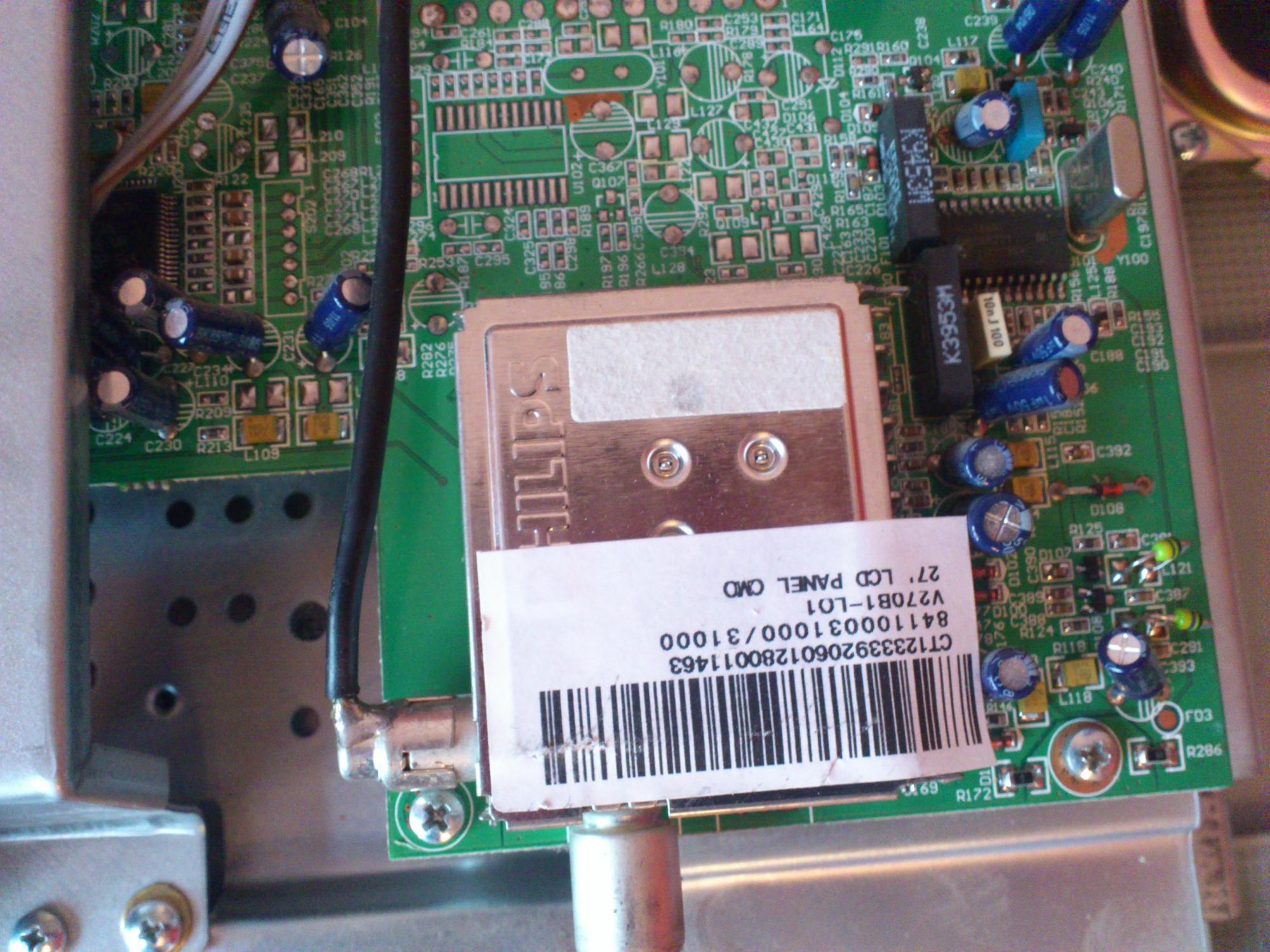

          more pics

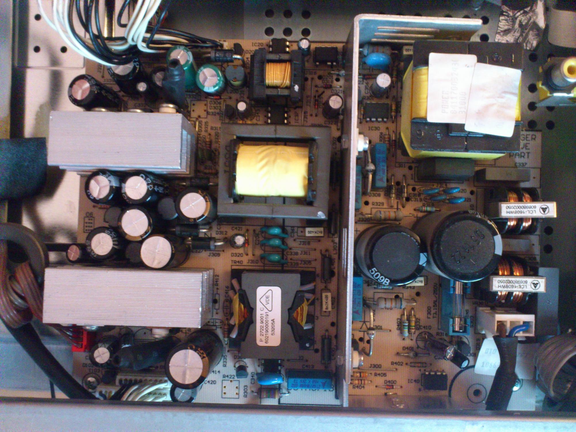

            Is it a Vestel?
            Are all the PSU outputs ok?
            • shepp
              • Mar 2012
              • 377
              • England
              how will i check that? numbers on the boards are all 05TA(071B power board) 059A main board, and tuner is 05TA092
              ill check voltages now...
              they all check ok 16V seemed a bit high....20V
              but now ive powered it up without the aerial in it its ok no lines or glitching or anything
                Vestel have "Vestel" written all over them.
                If it doesn't affect SCART, the fault is with the main board, which could be tricky to source. You may sometimes find it by pressing on the larger processors on the board.

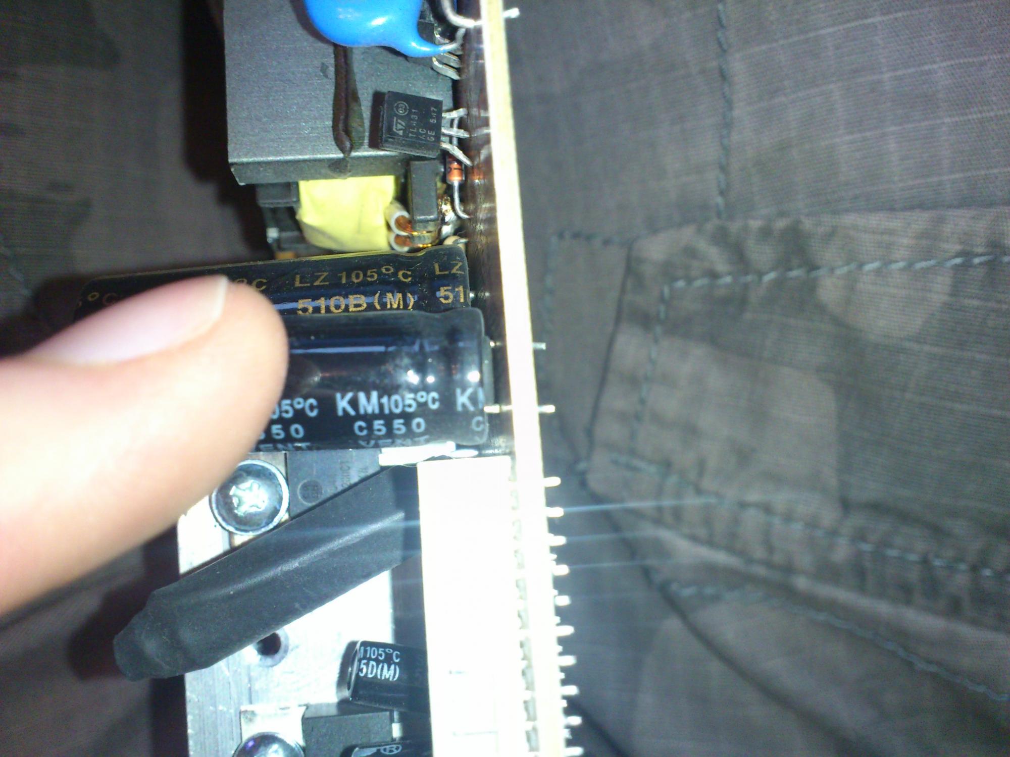

                  you got me thinking now tho....coz its got loads of G-Luxon caps on the PSU, so gonna try and get it to fault again then retest to see if voltages are all still there and try your pressing method
                          think im gonna replace all the caps first!
                            Eeep - bulging from the bottom! CapXon?
                              yes mate, but it hasnt made any differance
                              might just give up on this one and sell it for spares or repairs, because it was working fine a minute ago freeview and every thing and i cant get it to fault now, only thing now is the screen stays black for a bit before coming on unless you give it a tap(im guessing ribbons are loose on tcon) but im not stripping it down again tonight
                                Bad BGA or solder joint on main board... or loose connector...
