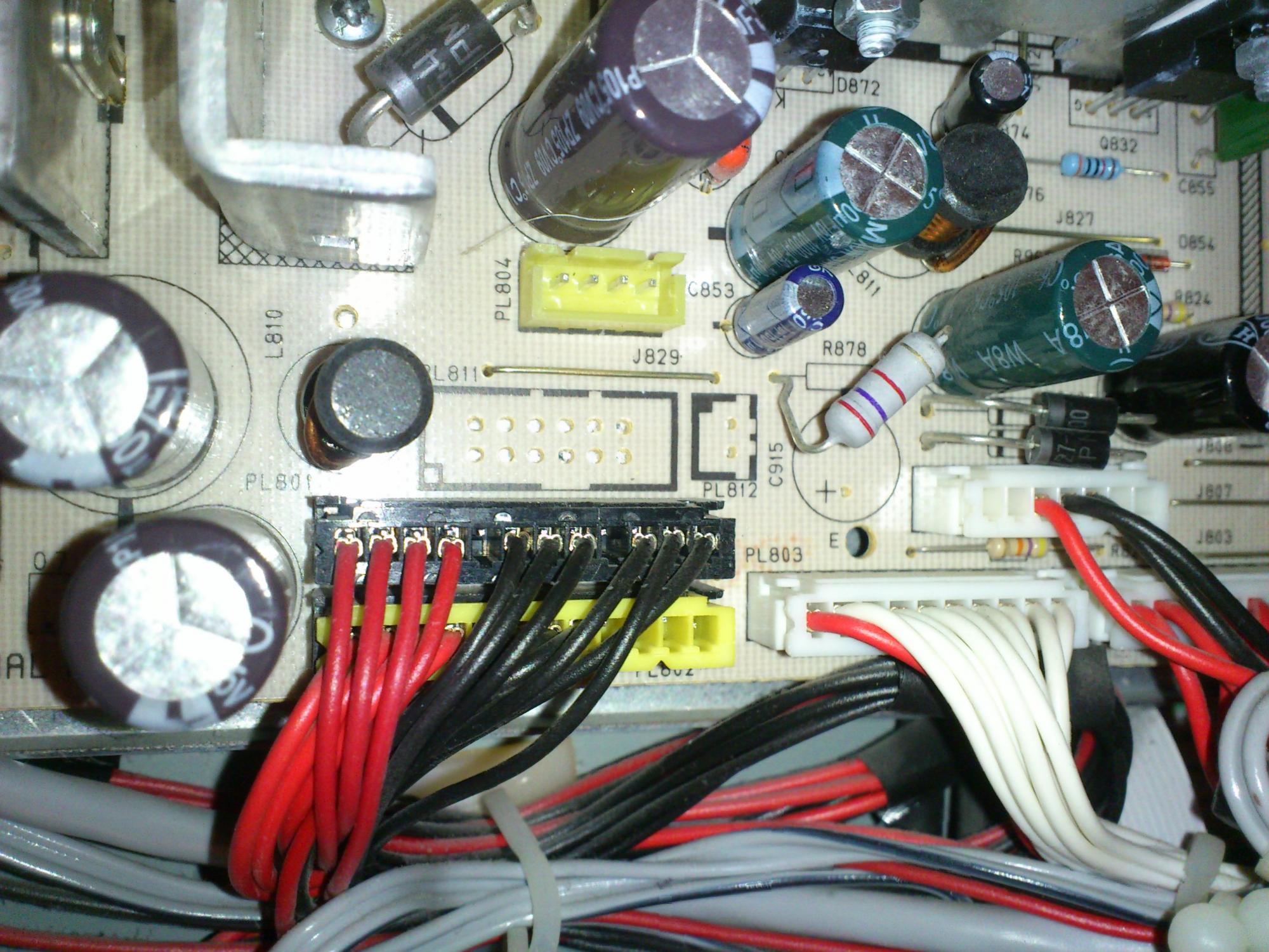

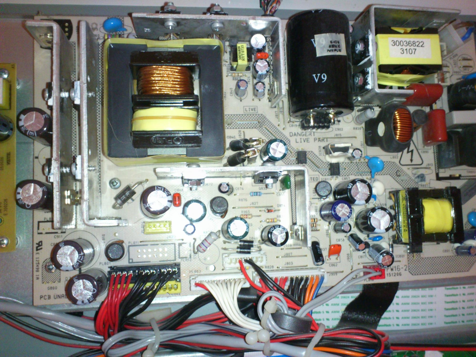

            Re: Wharfedale LCD42F1080P comes on but then picture turns off
            right ive just measured accross the supply 0V's and i get 21v on the first black wire then 23v on the second black and only 16v on the third black coming from the Power board theres no markings on the board to see what there for but ill post a pic any way in 2mins
            the measurments are using one red wire from the 24v + then from right in the pic to left (black 0v)
            • shepp
              • Mar 2012
              • 377
              • England
              pics
                Oh dear. It's a 17PW16. 37/42" LCD PSU.
                Report the voltages on connector with orange/blue wires please.
                  Is that bad? Lol
                  From right to left (blue to red)
                  Standby
                  1. Blue 5v
                  2. Orange 3.4
                  3. Orange 3.4
                  4-6 black 0 v
                  7-9 red 1.3V
                  10 is empty
                  11+12 red 0.7v
                  When on 11+12 change to 5v and rest remain same as above

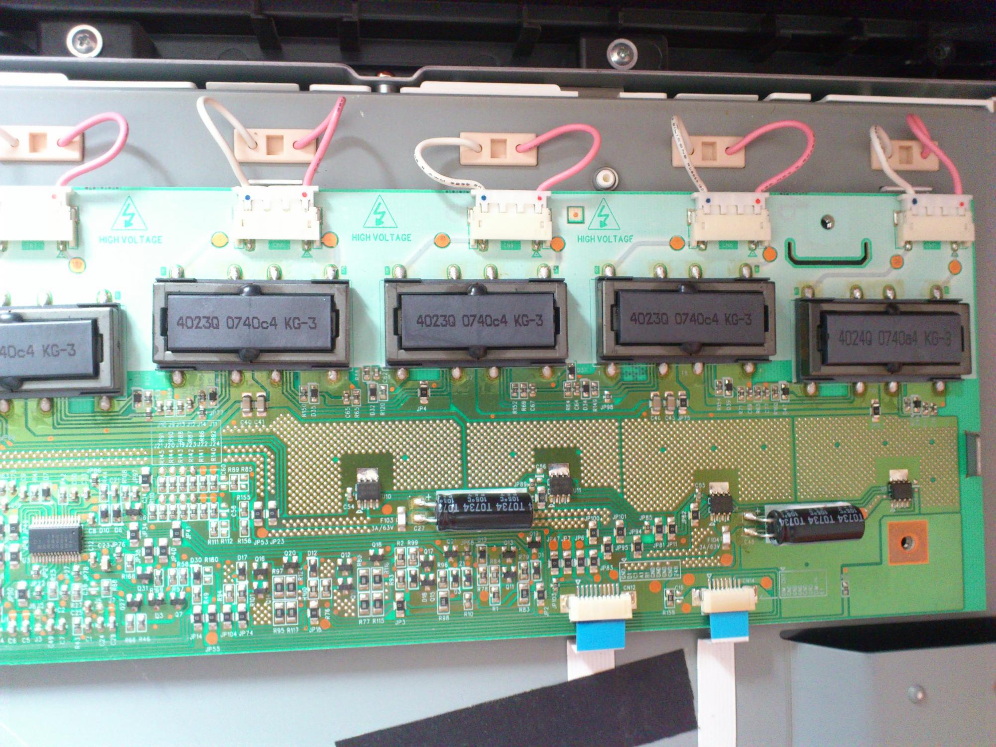

                    The 17PW15, 16 and 20 supplies are probably the worst power supplies I have ever encountered in an LCD TV. They are designed and manufactured by Vestel.

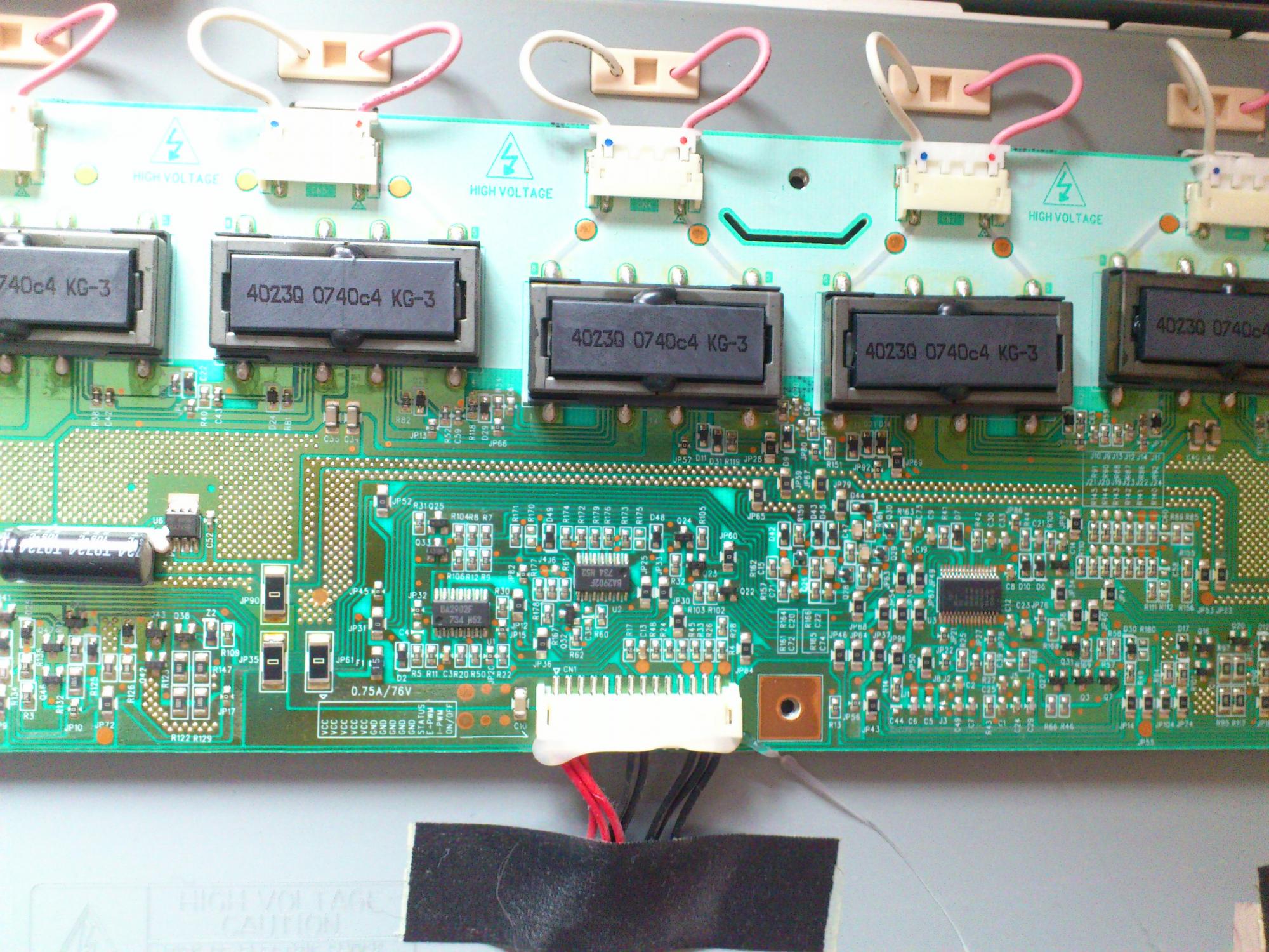

                    Can you post a picture of the inverter?
                    • shepp
                      • Mar 2012
                      • 377
                      • England

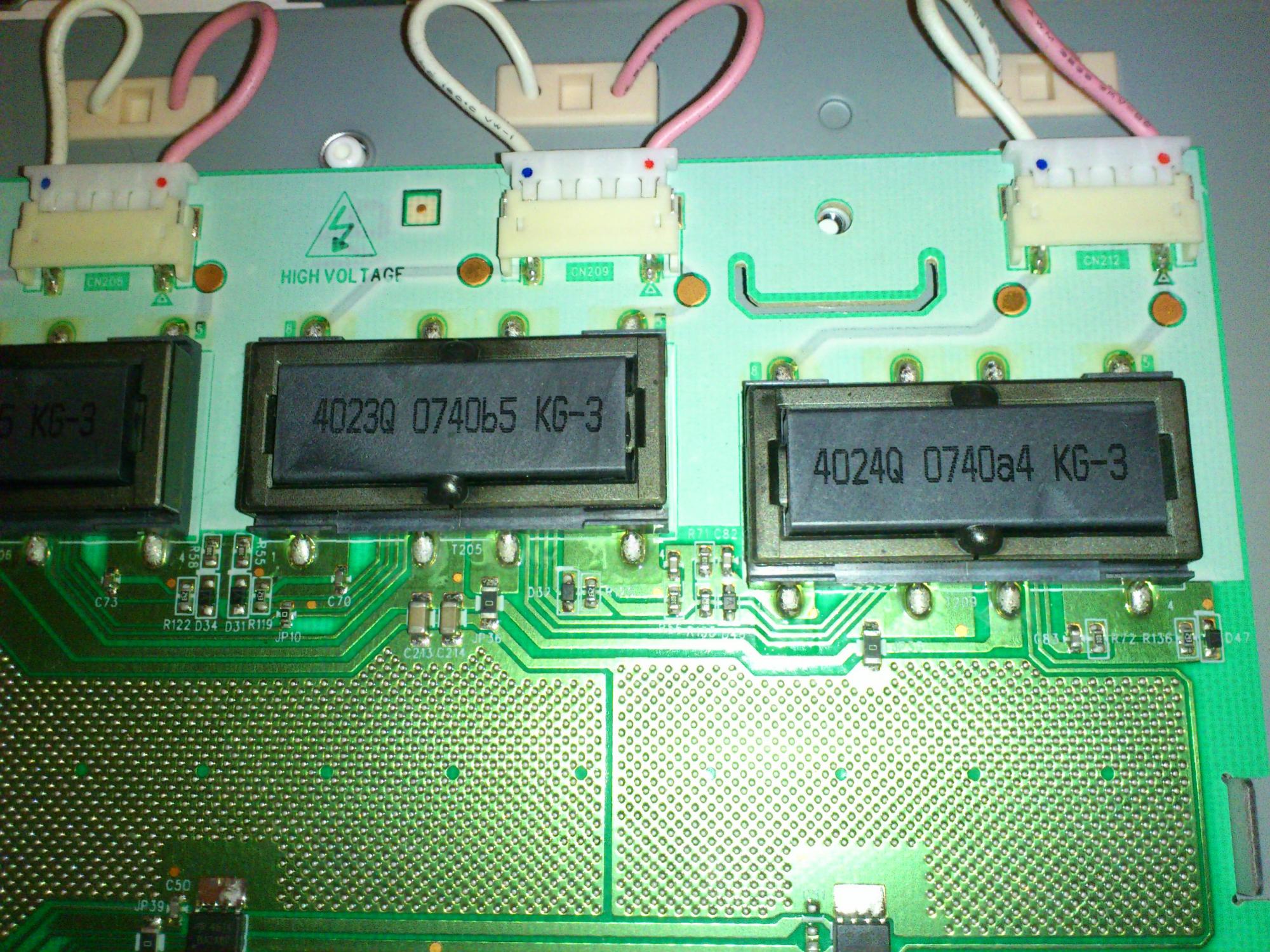

                      this is only pic ive got coz ive put the covers back on to test voltages (model : I420H1-20B-MASTER / SLAVE)
                      but these are the same on ebay :
                      http://www.ebay.co.uk/itm/2709597472...84.m1423.l2649
                      been looking for info on transformers but couldnt find anything, i checked them all and the primarys were all roughly 1kohm within +-10%
                      when the power comes on it seems like all the bulbs are coming on so i dont think its a bulb out
                        It's difficult to tell if a bulb is out on a TV.
                        But it's rare - most common failure is a transformer or output (fuses, MOSFETs, driver IC...)
                        Are there any fuses on the board, there are sometimes individual ones for each group of inputs, so check these...

                          ill have a look tomoro...will the fuses be surface mount ones? ill take some more pics of the invertor boards when i strip it down again tomoz.

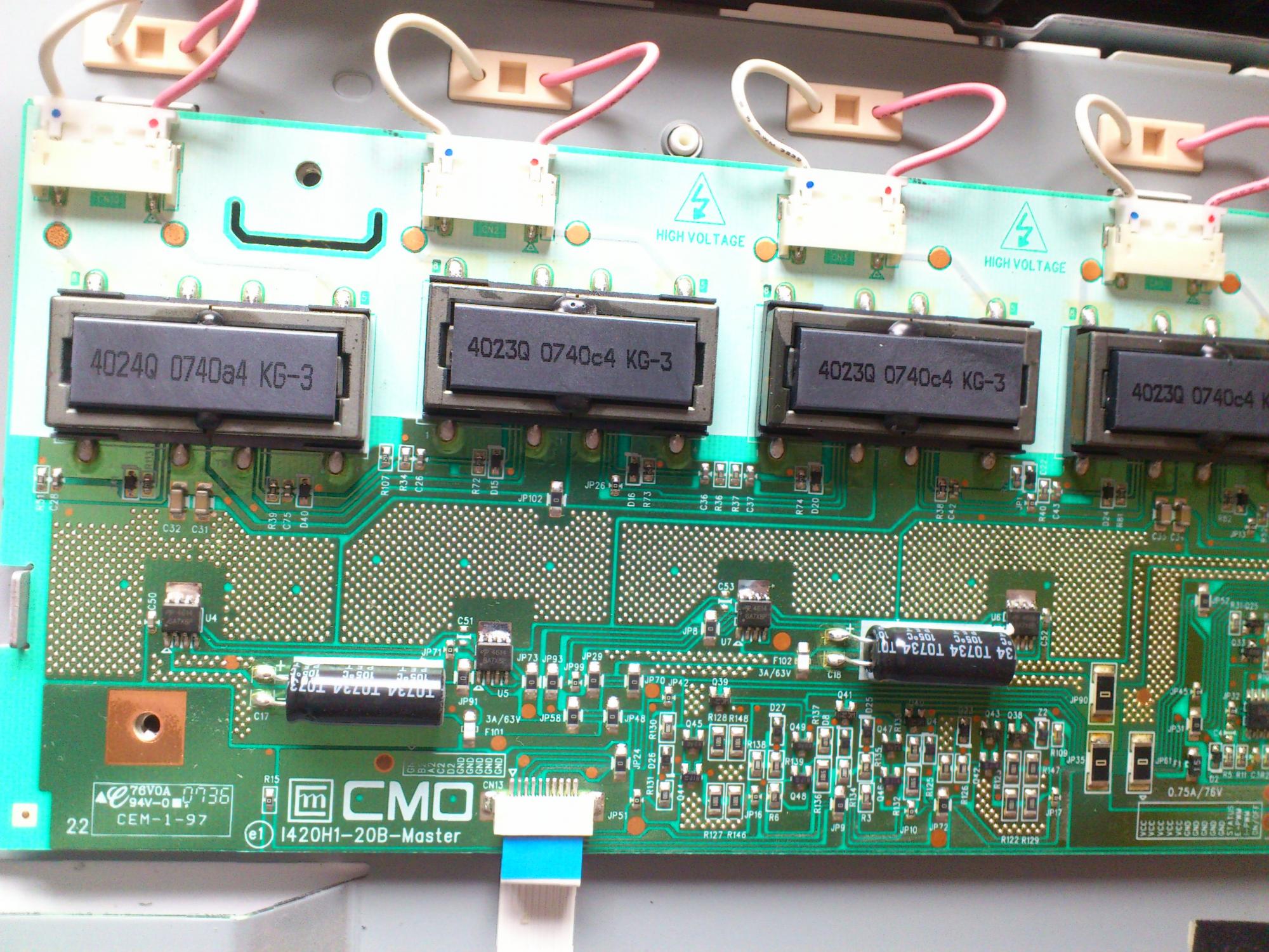

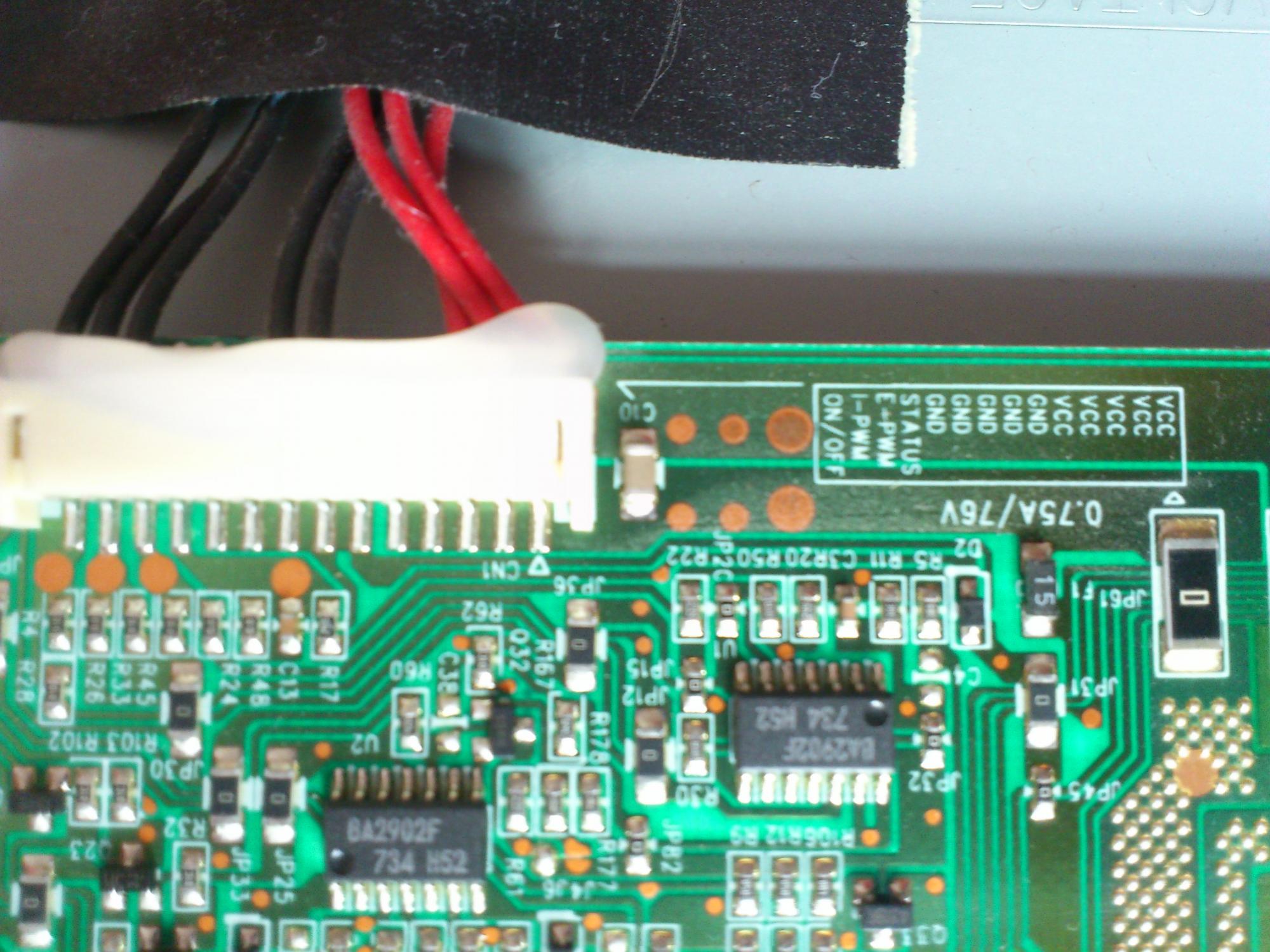

                              invertor master pics
                              all 4 fuses on this board are ok

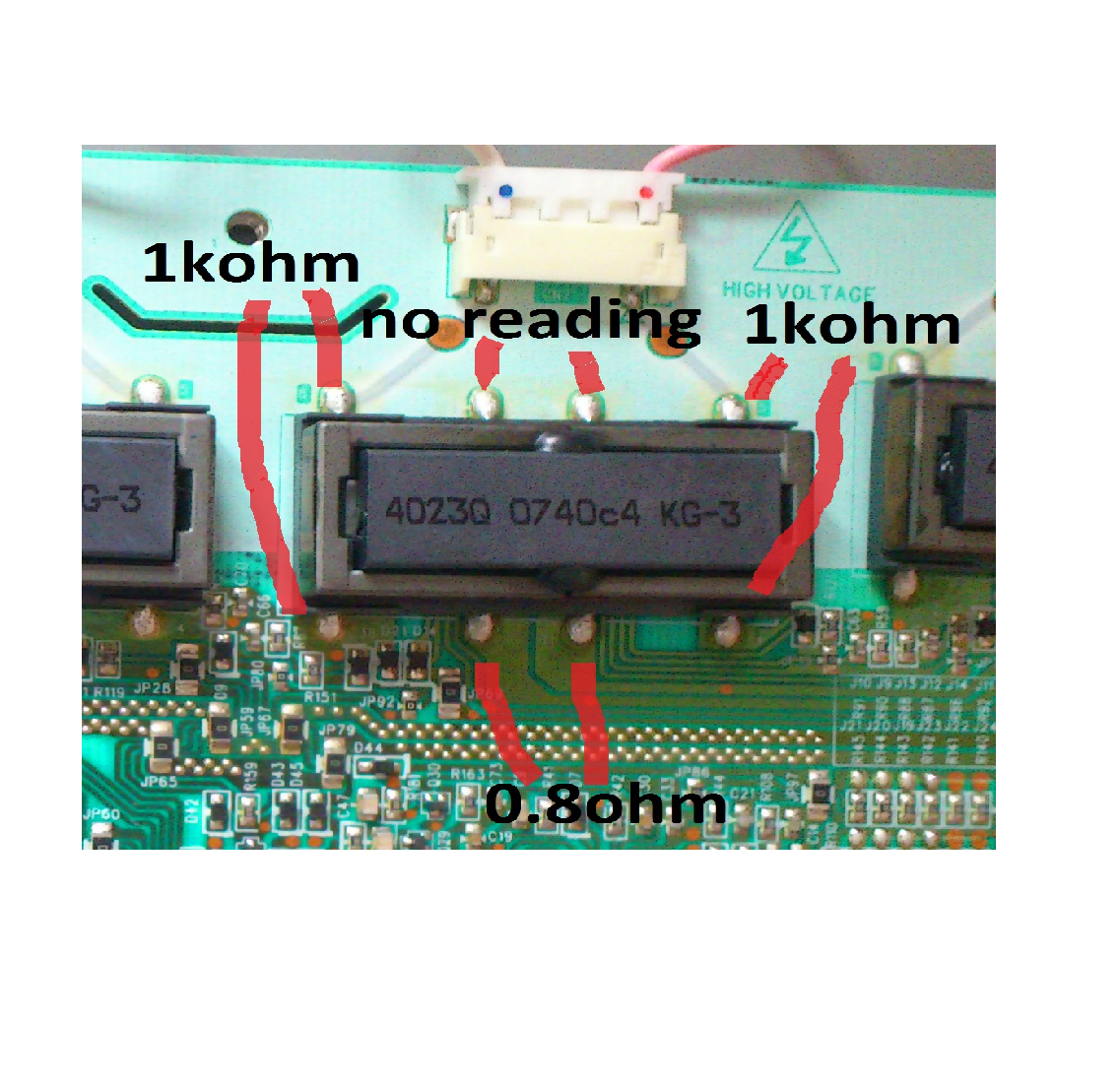

                                OK check primaries of transformers too all should measure close to zero.
                                • shepp
                                  • Mar 2012
                                  • 377
                                  • England
                                  i checked through the pins and there the only sensible readings im getting on all the transformers, there isnt really any that sticks out as shorted or open
                                    Do you see 0.8 ohm on all the transformers?
                                      ye all are below 1ohm but i have just spotted that when ive reconnected one of the bulbs i bent the pin so when i tested it again it did the same come on then went off, so it might be a bulb gone, ive just put the pin back right and retested and its still doing the same, how do i check the bulbs? with the meter? or shall i just disconnect them one by one and see if it stays on?
                                        just checked other board, fuses are ok, just gone through the bulbs using the test points and they are all measuring 5.6kohms roughy (within 0.1kohm) on both boards that must be the winding on the transformer tho.
