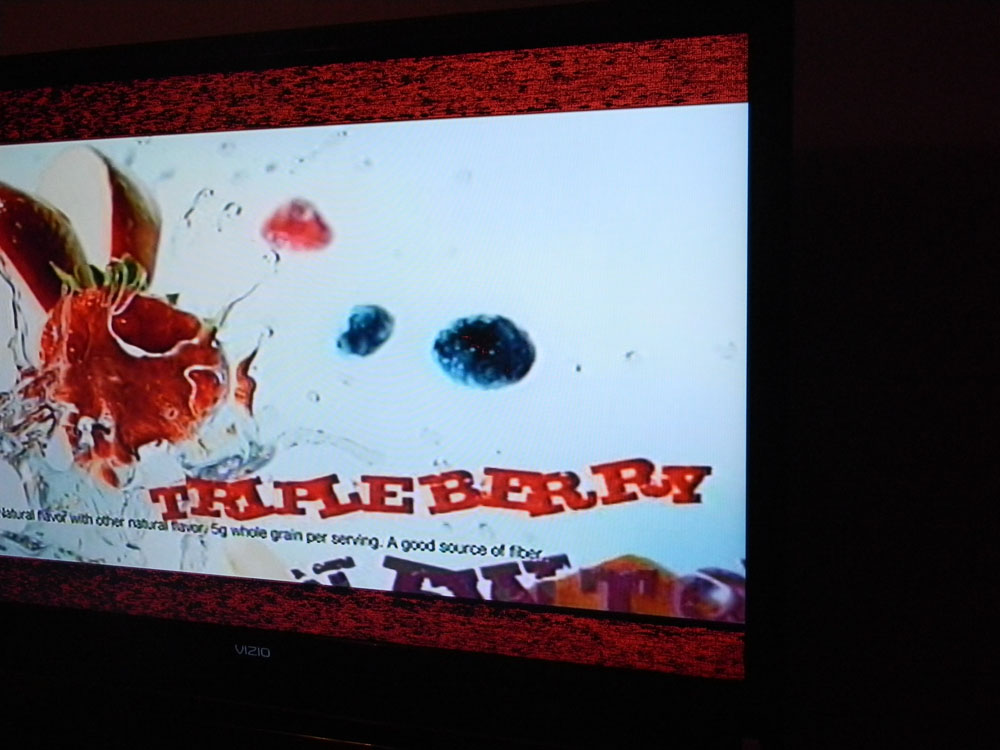

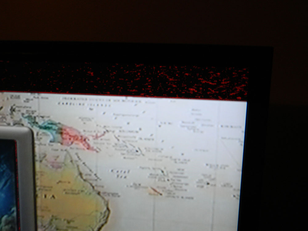

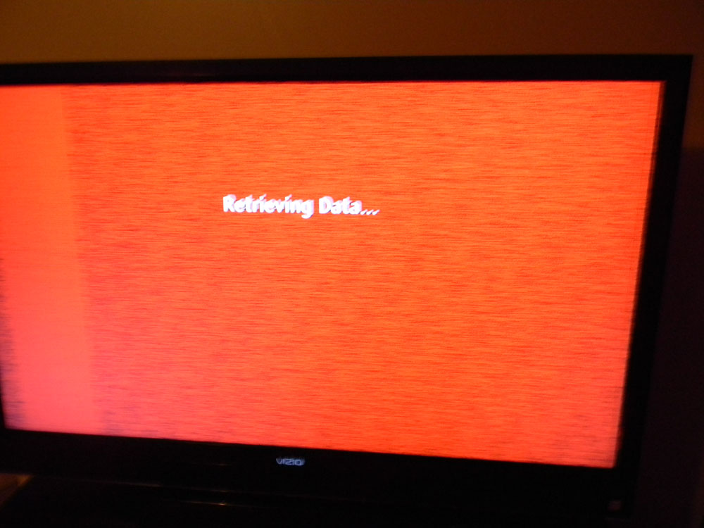

    I am having a problem with my Vizio VO47Lfhdtv30A. At random times when turned on the screen will go completely red. When the cable is on all of the black areas of the screen will have flickering red lines running through it and once I turn the cable off the whole screen is red or flickering red. I have some pictures that I will post of this happening. I have taken it in to a local TV repair shop and had them unplug the LVDS cables from the T-Con, clean them off and reconnect back to it. After doing this it worked for about 2 weeks with no problems then it gradually started to flicker red again.
    I have ordered a new T-Con for 30$ off of Ebay and new LVDS cables from Vizparts and plan to have them both installed. I bought this TV used from a repair shop about two months ago. It also has a loud buzzing noise when it is turned on. Everything else has worked fine to my knowledge. I will post pictures of my new T-Con once I receive it in the mail. Any help or comments on my situation would be appreciated.
