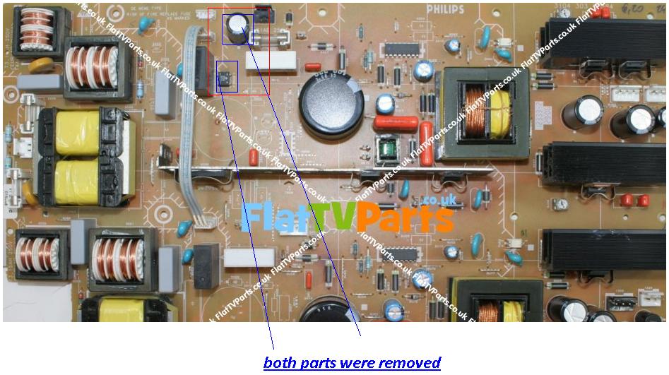

    does anyone know where i can find the scamatic for this power board i am reluntant to purchase a new board when looks like just an a transitor and cap missing but can't see from photos what missing parts are.
    have attached pic from stock site showing missing parts
    background on tv , friend took it to repair shop was qutoed £600 , he decided to buy new tv guy at repair shop ask to bring tv back as good for spare friend decided to keep it ask me to take a look looks like guy removed parts but not sure if faulty and not sure on transitor what it is
    any help would be good
    cheers

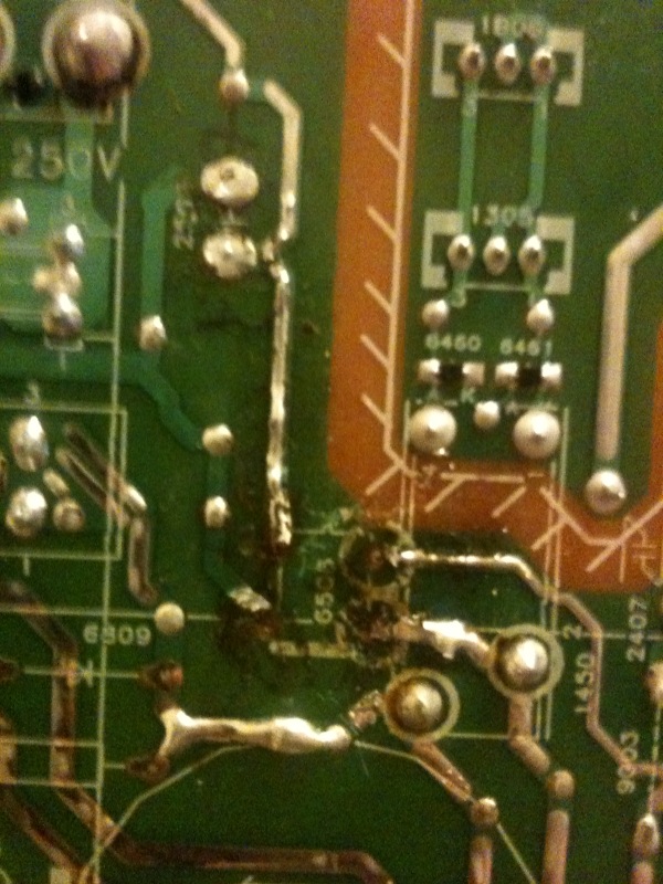

      not that i understand it but photo of empty space on psu board attached
      Part Type PSU POWER SUPPLY BOARD
      Part Number 3104 303 39584
      Panel Number LC420W02 (SL)(B1)
      TV Manufacturer PHILIPS
      TV Model 42PF5421/10
      hope this helps

          It helps tredendously, because everyone needs to see the numbers marking each missing component.
          All you really need to do is search the Service Manual PDF file (Ctrl-F) for the number, and you will find a chart listing all of the components.
          Unfortunately I can't really see the markings, was it taken with a cell phone? It's just too blurry, but I think the cap is marked 2064?
          There's no marking near the transistor, but if you flip the board over to the solder side you will find more numbers. I think transistors start with 70 on Philips products, and caps usually start with 20.

            Re: 42" PHILLIPS LCD TV PART PSU POWER SUPPLY BOARD - 3104 303 39584 idenfy missing p
            ah ok well could have relayed the board numbers have download service manual thank to your prevoius post
            could use dig out slr cam tho it kinda makes large resoultion photos
            and figures iphone would be quicker
            cap number on board 2503
            transitor number was 6506 ( tho probally need a magnifery glass looking below)
            number on back says 6505
            Again thanks for you help and will update after i get parts in on how it goes
              That looks fairly nasty, either the person removing the transistor was horrible, or the parts exploded off the board, in which case they might not have been the bad part, but were destroyed by whatever else went bad.
                yeah there scoring marks from the iron but it the only place on the board with damage and the fuses had blown so replaced fuses.
                thank you guys have part number
                Manufacturer Part Number DF06M
                Description DIODE BRIDGE 600V 1.5A 4-DIP
                hoping to be able to make some repairs and get up and running
