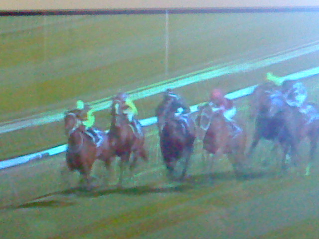

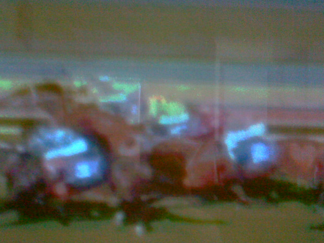

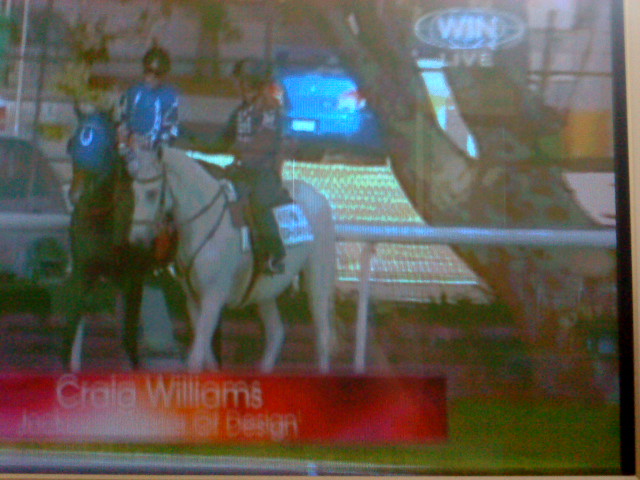

                          Got remote then fixed everything
                          I have been keeping it switched off at the main power all week.
                          Now it has a luminescent green over all the white.
                          also some luminescent blue over some stuff.
                          Anyone got any ideas about where to start?

                              Re: Tcl pdp42u3h
                              worked that problem out.
                              Was playing with the screw things in the back of it.
                              and also found the system menu. where you can set the default colors.
                              Now I'm stuck with 1 second flickers.
