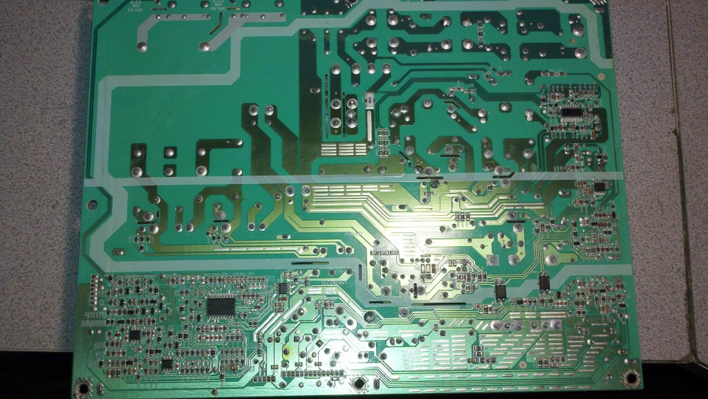

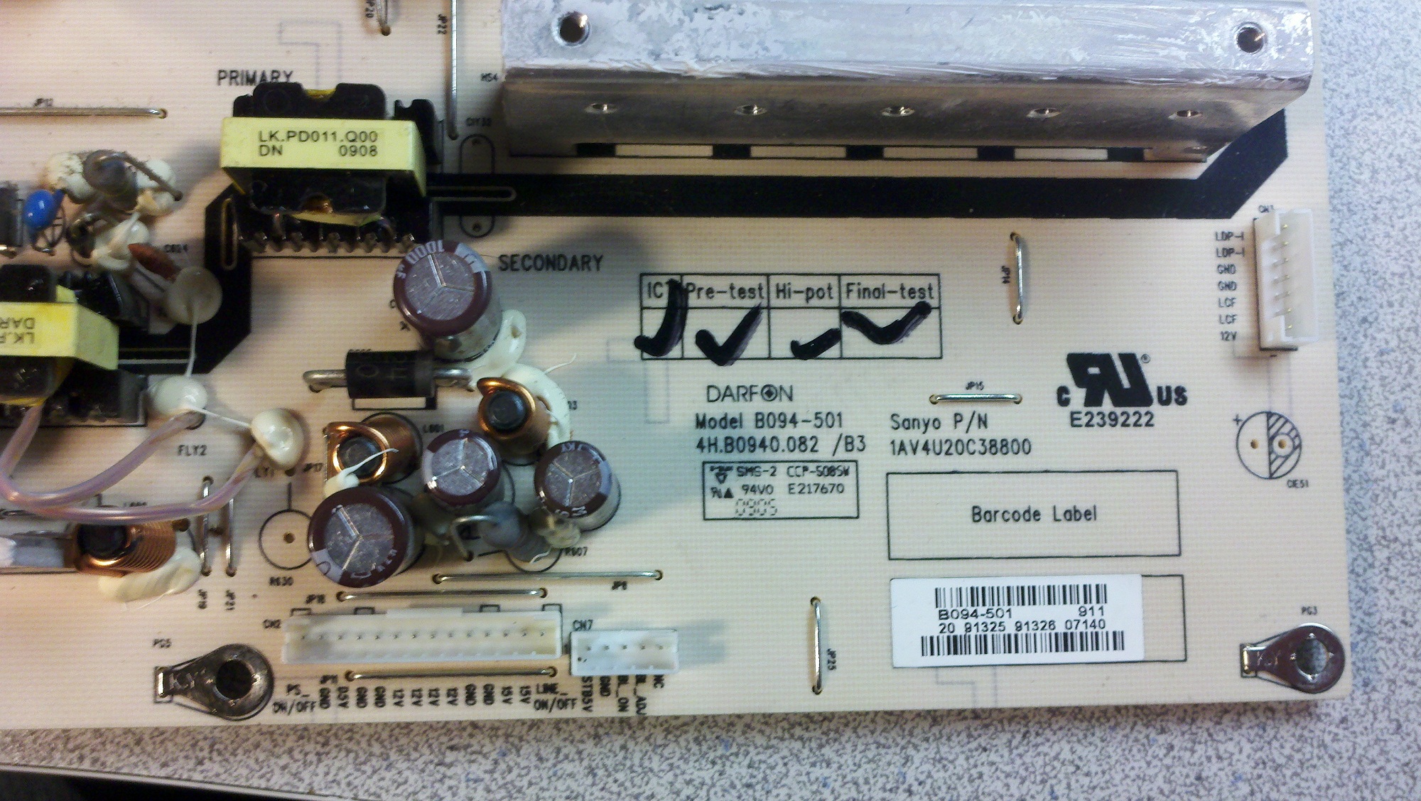

    I have a Sanyo DP46849 that I recently got from a buddy that replaced it when it stopped working. When I FIRST plugged it in, the image came up and displayed for a minute and then now, when you turn it on, the GREEN LED turns on but thats it. Nothing else. The problem seems similar to this post, but there was no fix... Visually the Caps appear ok. I have a DMM what/where should I test?
    The pictures are the highest RES I can do with my camera. If you need closer pics of certain areas I can try that.
    https://www.badcaps.net/forum/showth...=Sanyo+DP46849
    Re: Sanyo DP46849 No Image

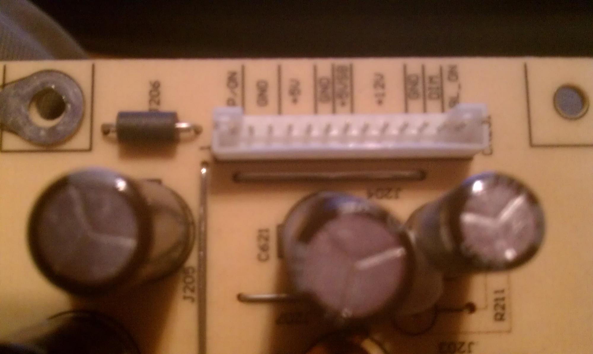

    We need a good closed up of the connector so we can read the voltage labels on those pins, take pictures at both top and bottom of the board. Right now the standby power supply is working. We are looking for the pin that is labeled with PS_ON, or PWR_ON.

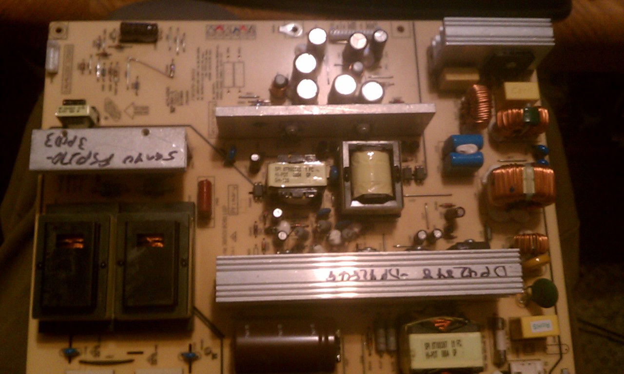

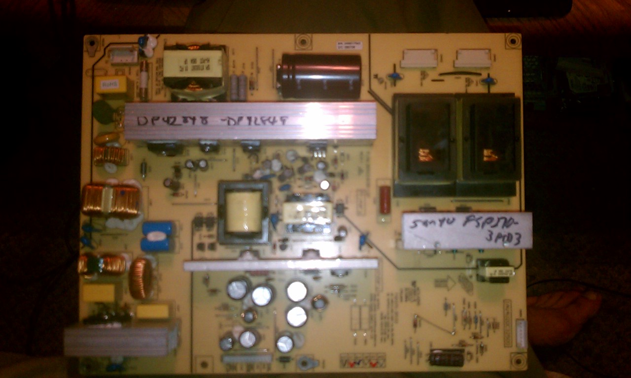

      Thanks for the reply. There is a PS_ON/OFF, its the bottom pin on the connector. Here are pics with and without flash.

          Sorry I did not read your comment about the error, so look and see if you have 3.3~5vdc on that PS ON pin. You may want to read my guide to get some basic ideas also.
              I'm getting no voltage on the PS_ON
                Is this with you trying to turn the TV on/off? If not, try pressing the power on/off button to see if the voltage changes.

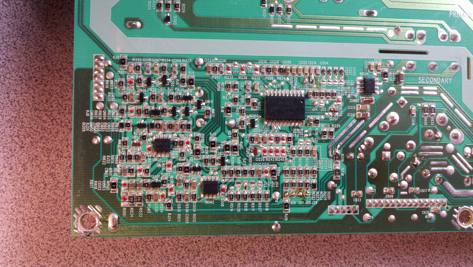

                Now we need a clear picture of the main board.
                  Actually, I just went back to my work bench to take the pics, I guess I left the power button pushed... The TV is working, no joke. I just hooked a PS3 to it and its playing a bluray for about 5 mins now. Maybe I just had a lose wire. I will let it play for a while before I confirm its "fixed"
