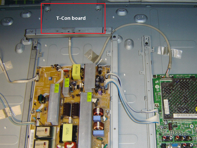

    General lcd picture fade in and out question
    From reading some other posts , seems usally panel problem / or possible invertor problem . I also don't have a much to go on except the video i was sent , and was told the picture fades in and out .
    Iam thinking of going to look at it and wondering if theres anything i can look for while there to rule one or other out before i consider buying it . Any tips on what to look for ?
    Heres the video , again he is saying its a fade in / out problem seems darker on right side to me in the video , ideas ? http://youtu.be/Cfuae7QsZHY

    Re: General lcd picture fade in and out question
    If you mean half of the screen being like in slow-motion (ultraslow response), that's usually a T-CON fault. Could be the bonds/tabs to the glass panel too, but that normally doesn't affect exactly half the screen (it's more irregular most of the time).
    The T-CON (Timing Controller) is usually in the top center on the back of the LCD (where the mainboard connects to)

      Thanks Scenic ,
      I know its hard to tell from that video , I'll see what i can get it for price wise , knowing it could be the panel , i don't want to take a big chance , money wise .
