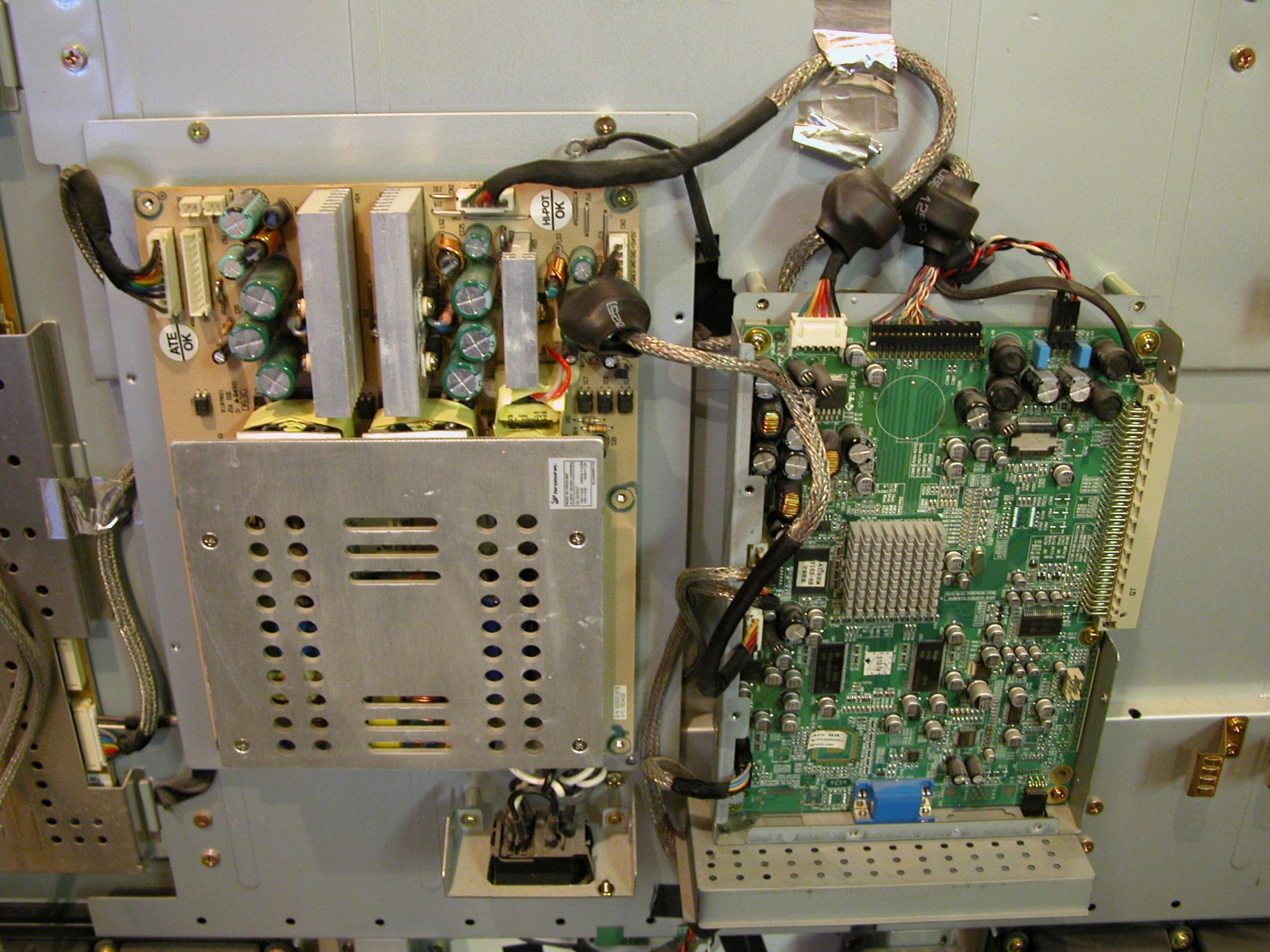

    Digimate DGL3201 no sound
    32 inch lcd model. powers on good. picture is ok. sound is no more. when i first got this item the sound was haywire. it would work for a bit then i would get a hi pitch squeal. i would have to shut it off then turn back on then the cycle would repeat itself. now there is no more sound. tried external speakers thru the audio out port and nothing there either. any suggestions. pics attached please advise if any further info is required. thanks.

    Re: Digimate DGL3201 no sound
    A picture showing the interconnections would be useful. As it is, I can only guess which of two sections are for audio.

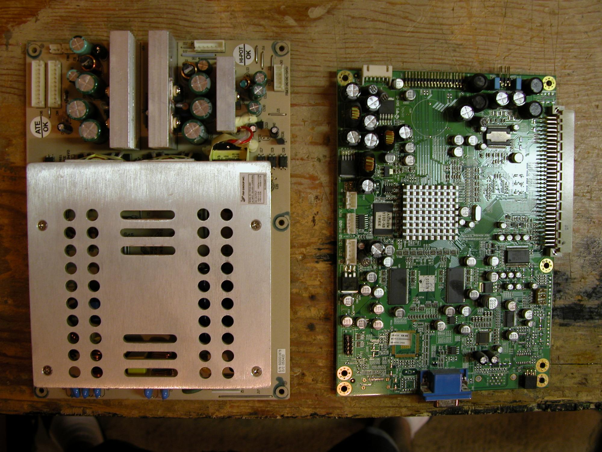

      as requested....that would have been a good idea in the first place.....
        That looks like the audio amp is in the upper right corner of the signal board. Is there a part number on that IC?

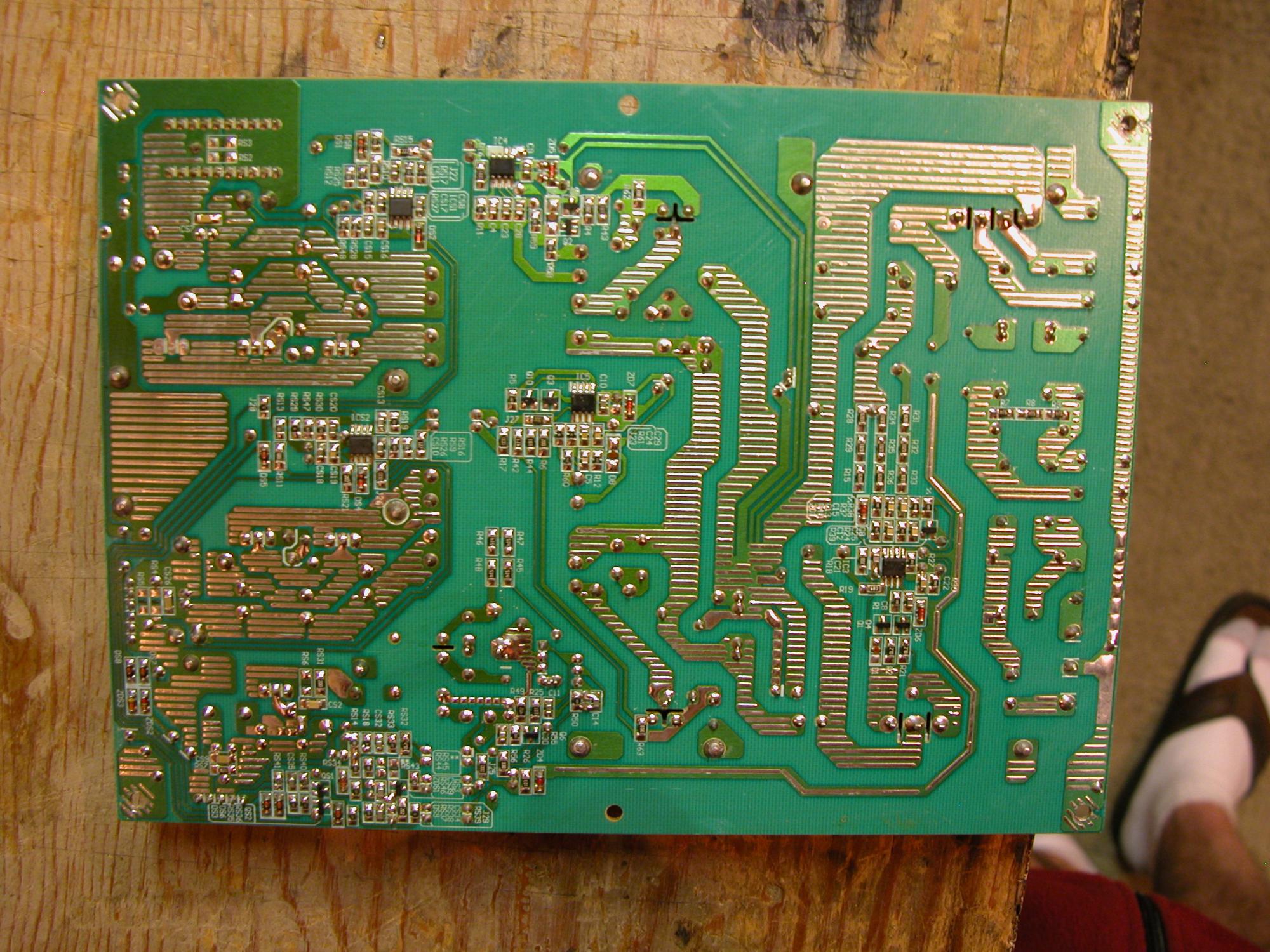

          i hope i have the right one. the ic chip with the silver looking kinda top?
          anyway...
          APOGEE DDXI-2101 along the top of chip
          CBVJKZ MYS516 along the bottom of chip
          hope thats the 1!
            anyway...
            hope thats the 1!
            That's it. Here's the datasheet.
            I'd check the power supply voltages, then replace all caps in the neighborhood.
              are u suggesting all caps with + on the tops or the whole board itself. let me know then i have to start gathering some stuff thanks plainbill
