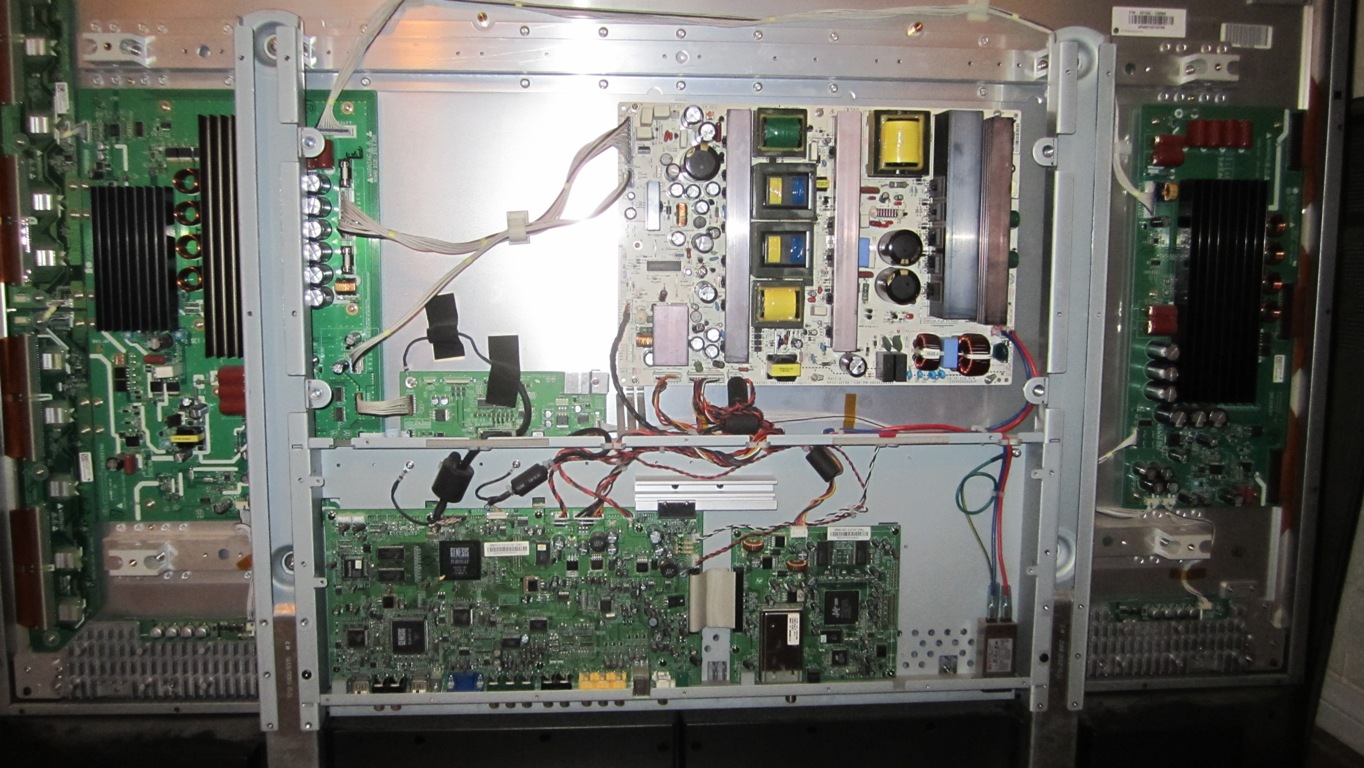

    First of all, this my first post. Thanks in advance for any help! This seems to be a great forum.
    Current condition of the TV is it powers up but there is no picture (screen does not seem to turn on at all - no faint glow). But green power light stays on.
    Also, there is sound in that you can hear the speakers turn on. I am unable to select any source (cant see source options since no screen) so I am not sure if I could get sound form a source. I have tried using remote to select a source (not sure if actually selected) and no sound from that source.
    The heat sinks on the ysus and zsus get warm (not hot but warmer than when it is off).
    Voltage readings out of the power supply are all correct.
    How we got here.
    TV started acting up and would have a somewhat scrambled picture. Turning the TV off and an on a few times would get it to be OK. And we would watch the TV. This got progessively worse.
    Ultimately, one time the picture just did not come on (and I cannot be sure but I do not think the speakers came on at this time either).
    So I did a little reading and then discovered more than half the caps on the power supply were bulging. Bought a replacement kit and replaced those. As I said, all voltages out of there are now correct.
    And that is where I am today.
    Any ideas, anything to test? Any help will be greatly appreciated and fixing this will make my girlfriend very happy since it is her TV.
    Also, I can get any pictures that would assist.
    Thanks again in advance!
    Steve

    Re: Vizio Plasma 50HDTV10a no picture and sort of no sound
    It seems to me this model had a reputation for blowing the Y-buffers or Y-Sustain. The first step is to open the TV up and check fuses on the Y-Sustain.

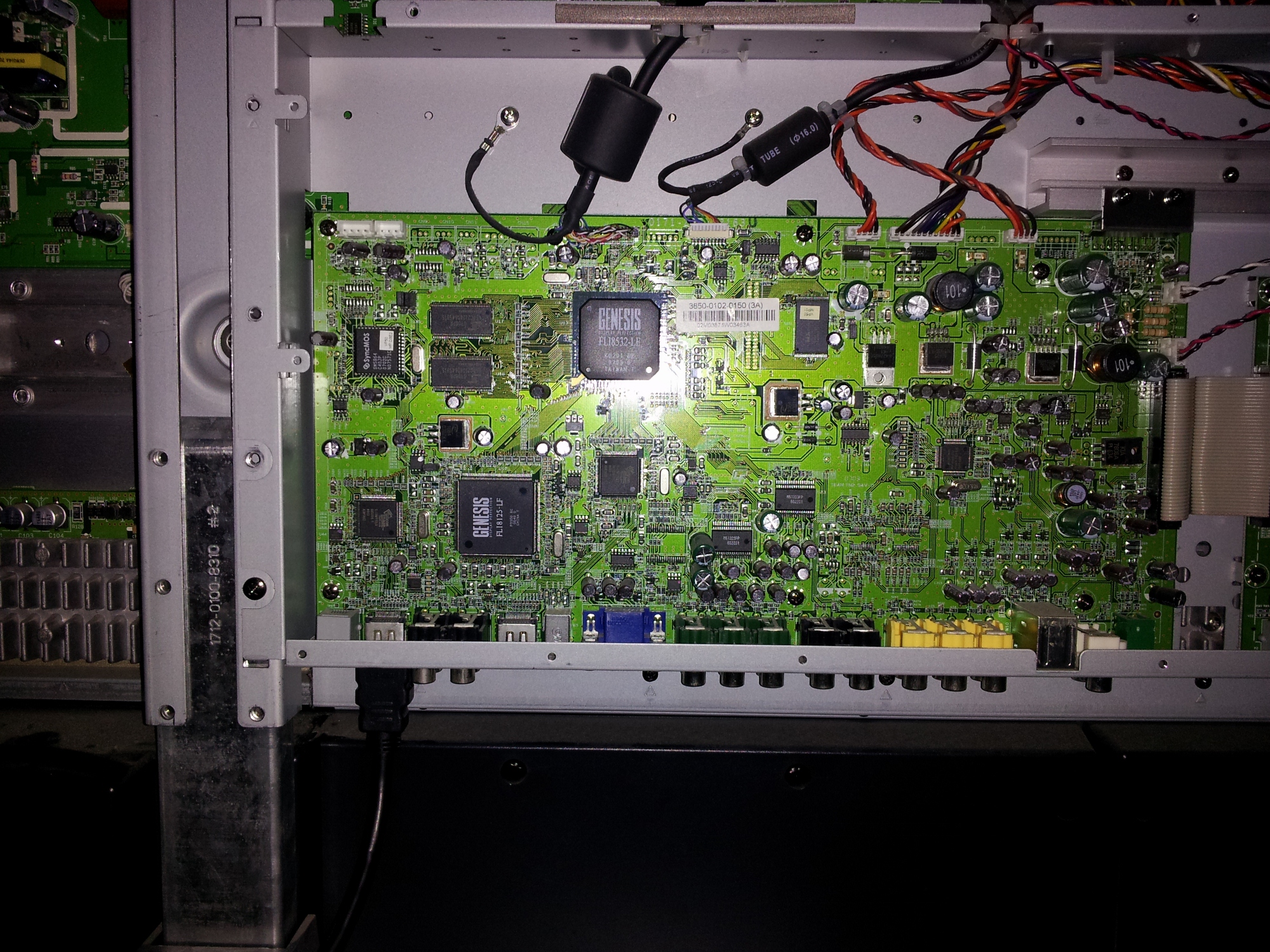

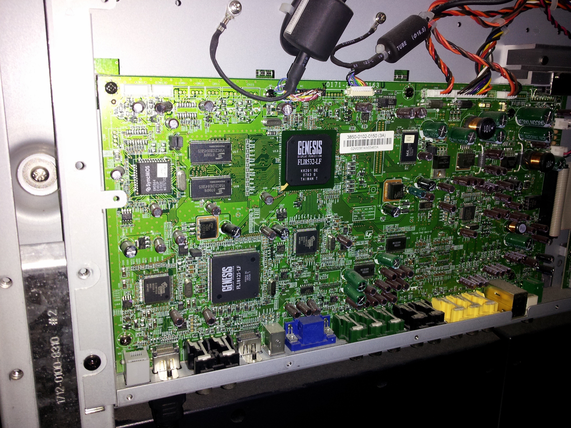

        A couple of Tests. Turn the TV on in a dark room. Do you see any light from the screen? With the TV on, press and hold the volume up button. Do you hear any static from the speakers?
        I'd like two pictures, the first is an over-all shot of the back of the TV, so I can relate to what I am working with. The second is a high resolution shot of the main board. The limit is 2000 pixels in either dimension. Attach the pictures using 'Manage Attachments' - below the test entry area.
          Ok a little bit of a delay on this. Sorry about that.
          On the tests -
          1. Light from screen - I do not see any light at all from the screen.
          2. Sound - I hooked up the cable to the cable hookup and chose that input with the remote. Can hear the TV channels and can change channels and get the sound of the next channel. So there is sound - at least for that input.
          Thought I would add one more thing the d2,d3,d4,d5 lights. For split second when powering on, d3,d4,d5 all light up. The d5 goes off pretty quickly and d3,d4 stay on.
          Just realized the pictures I took are not good. Will retake and post.
          Thanks!
          Steve
            Back
            • Swedeking
              • Jan 2012
              • 8
              Please let me know if you want any other pictures or if any of these are not sufficient.
