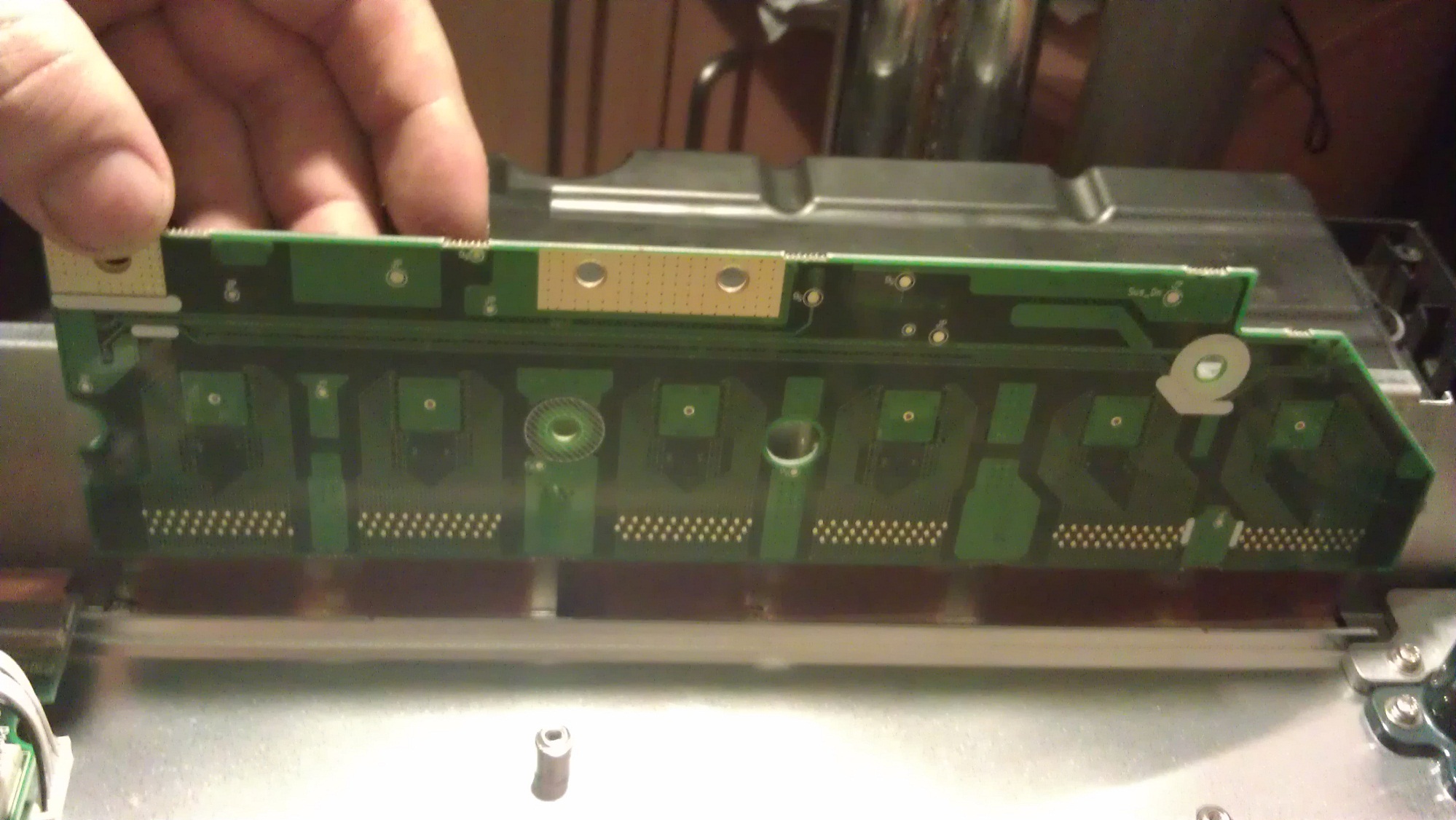

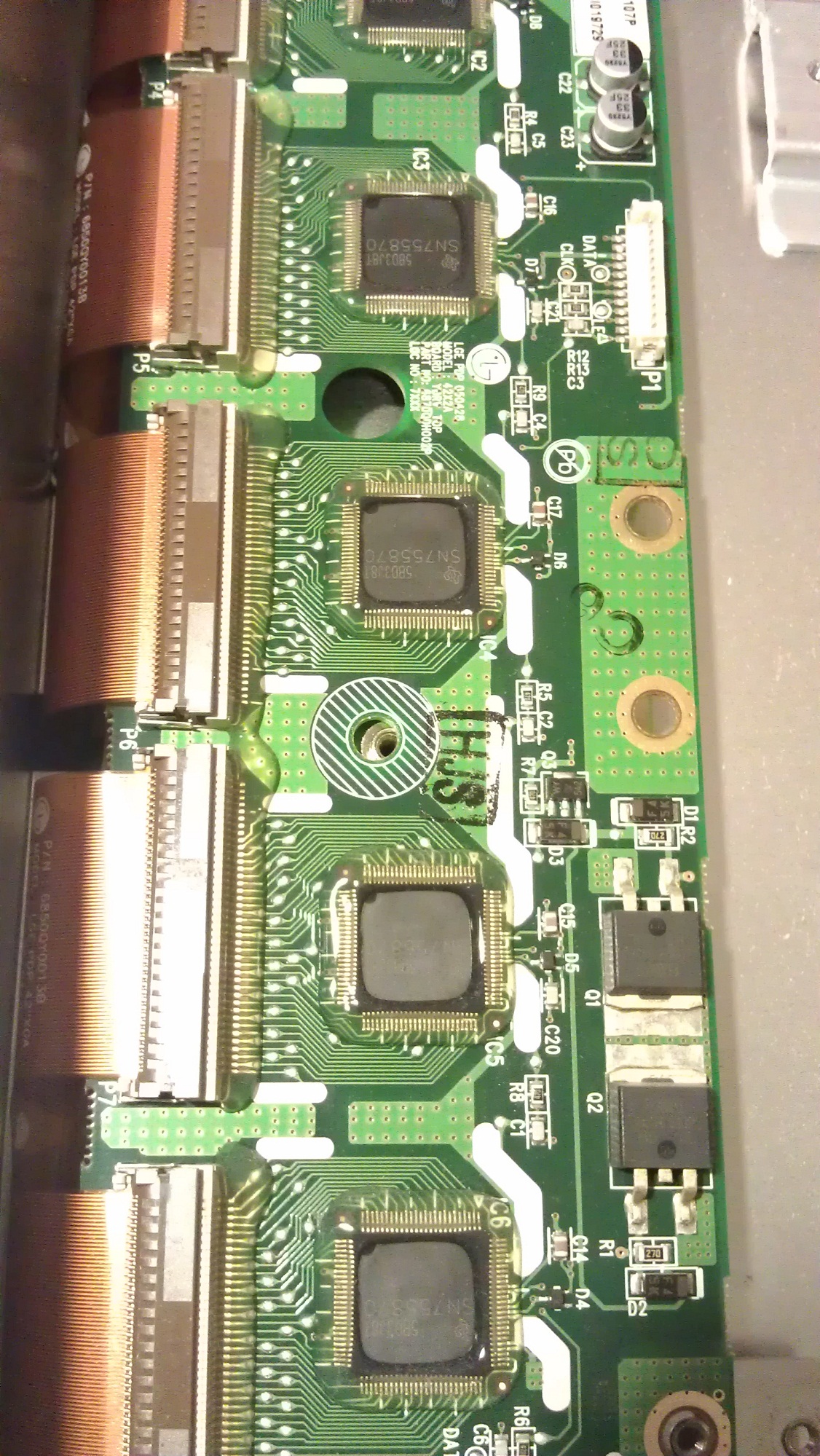

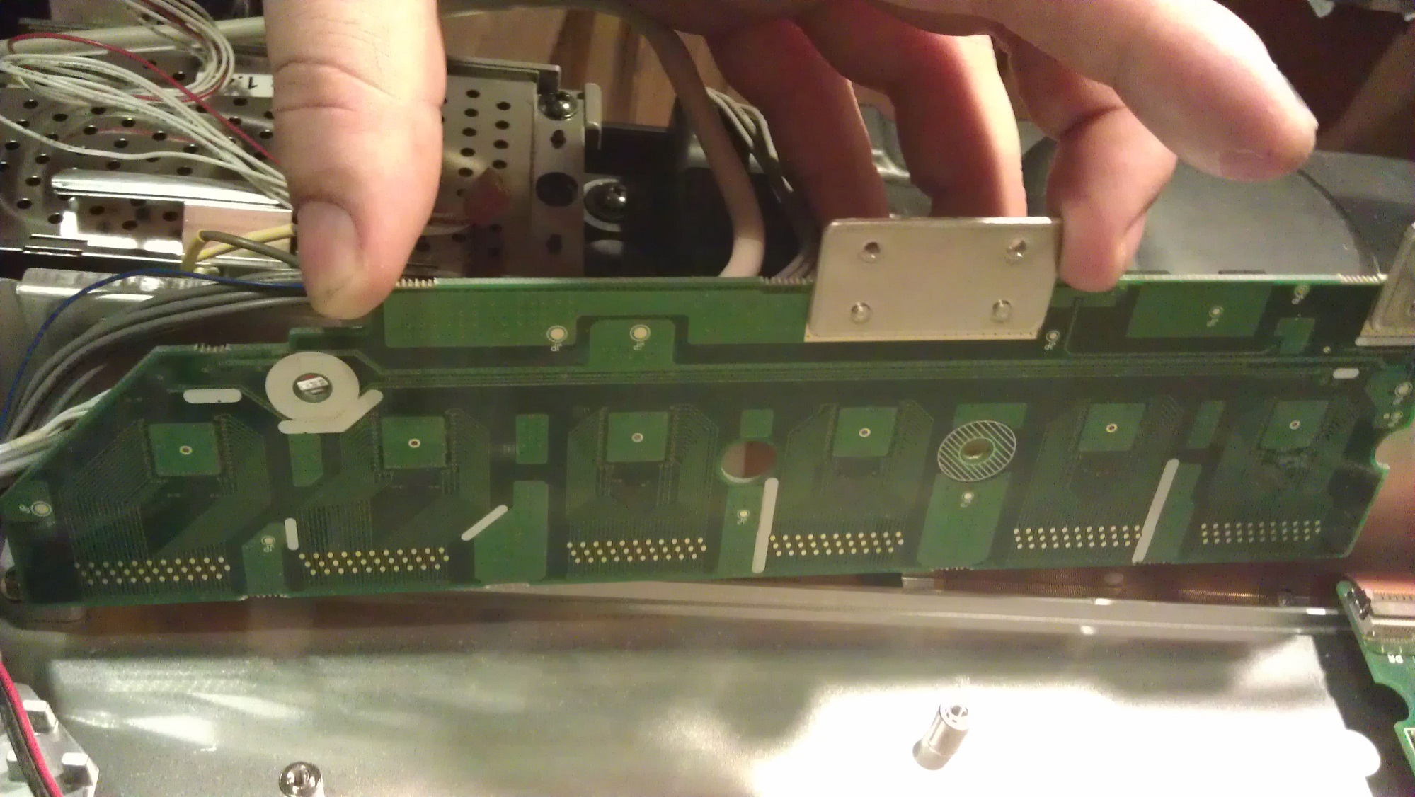

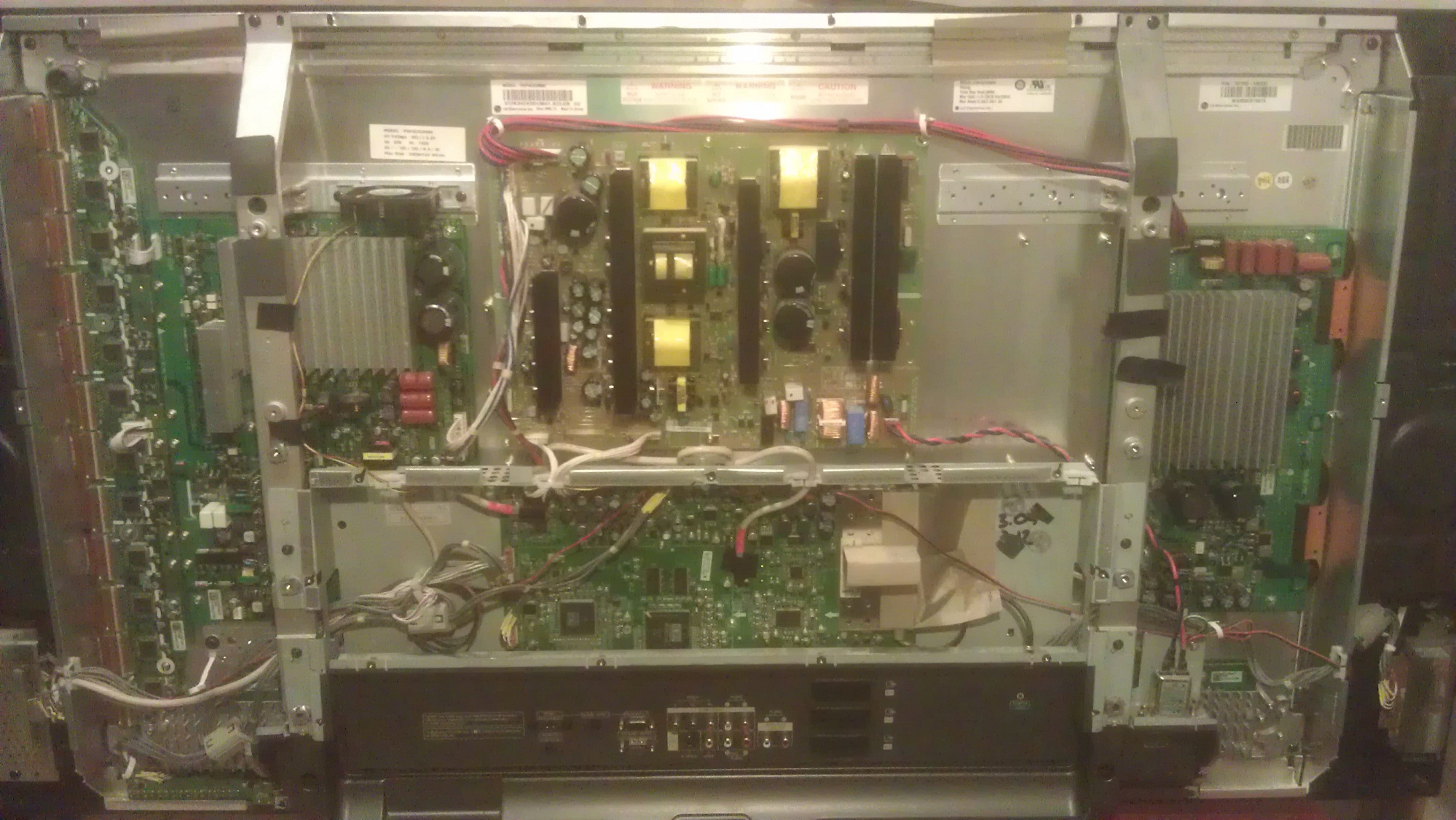

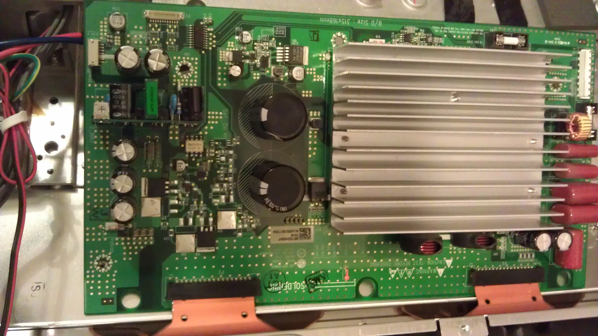

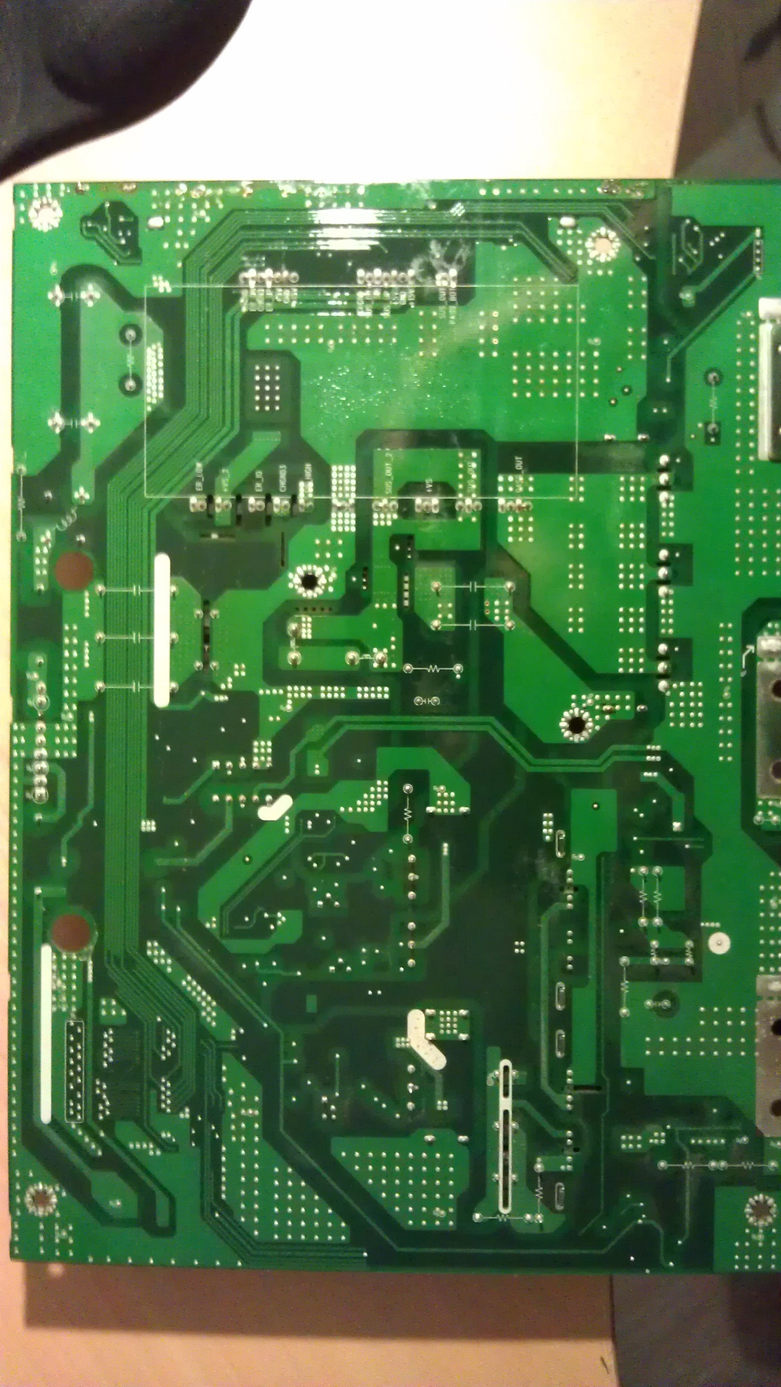

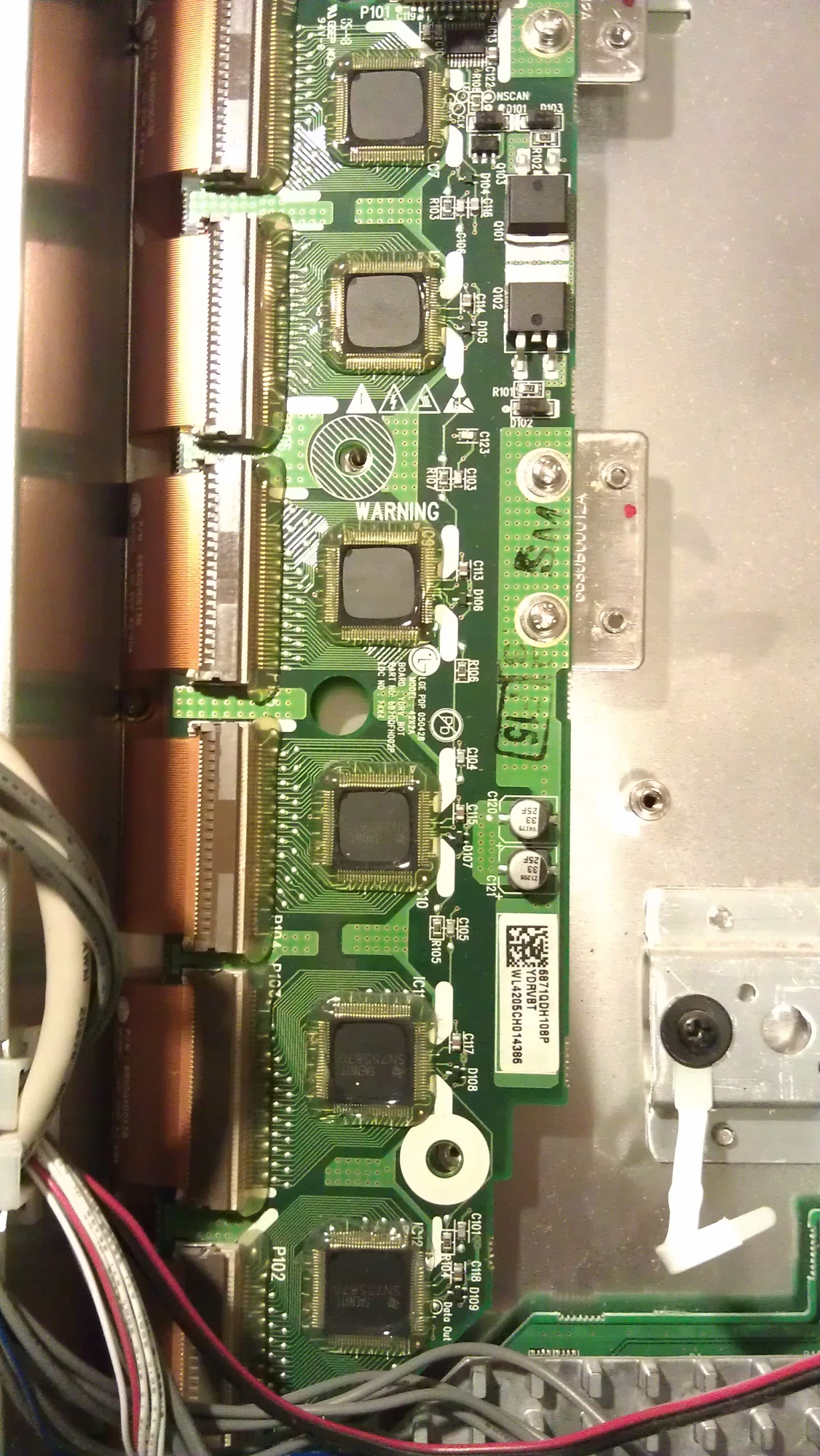

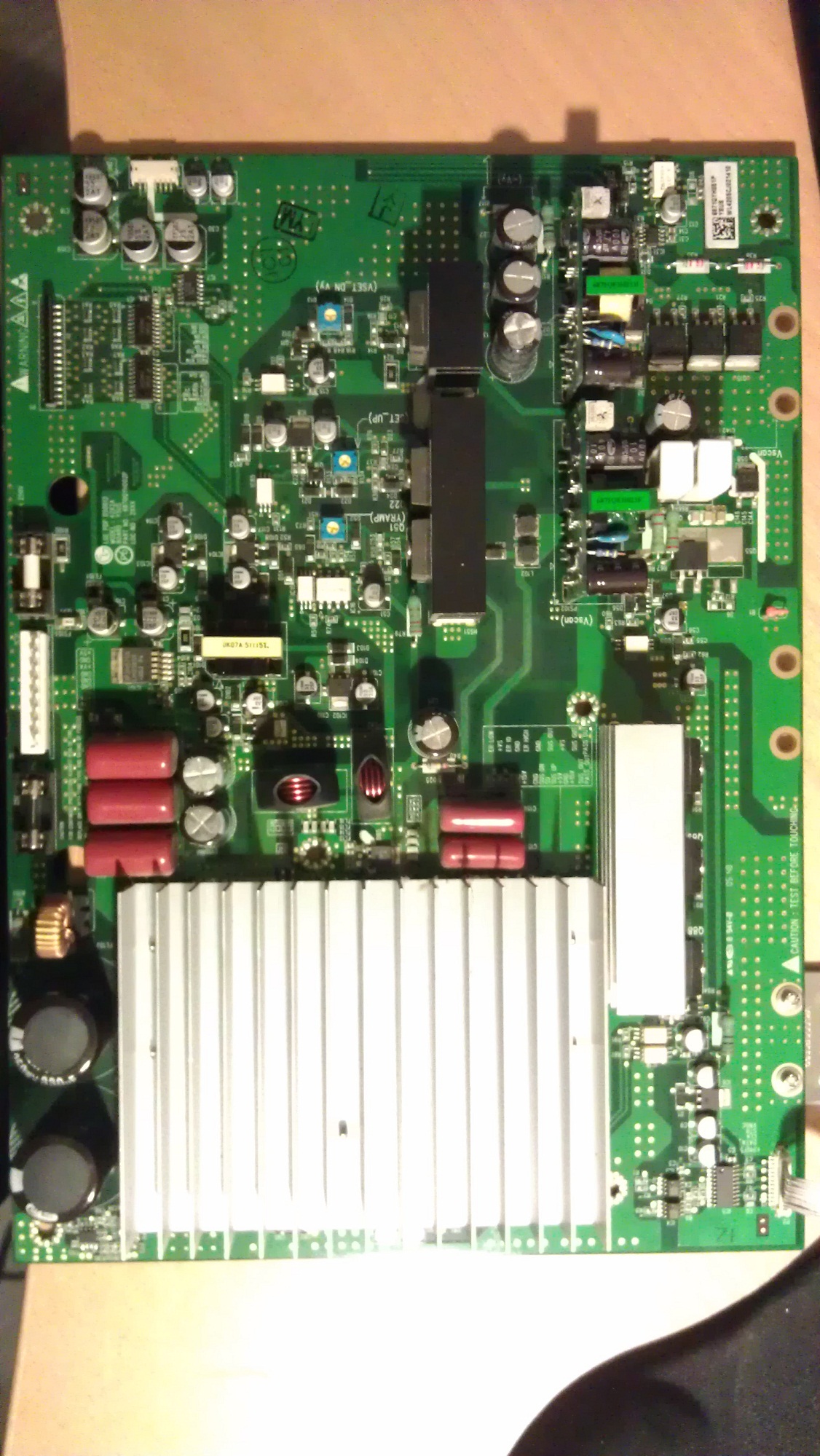

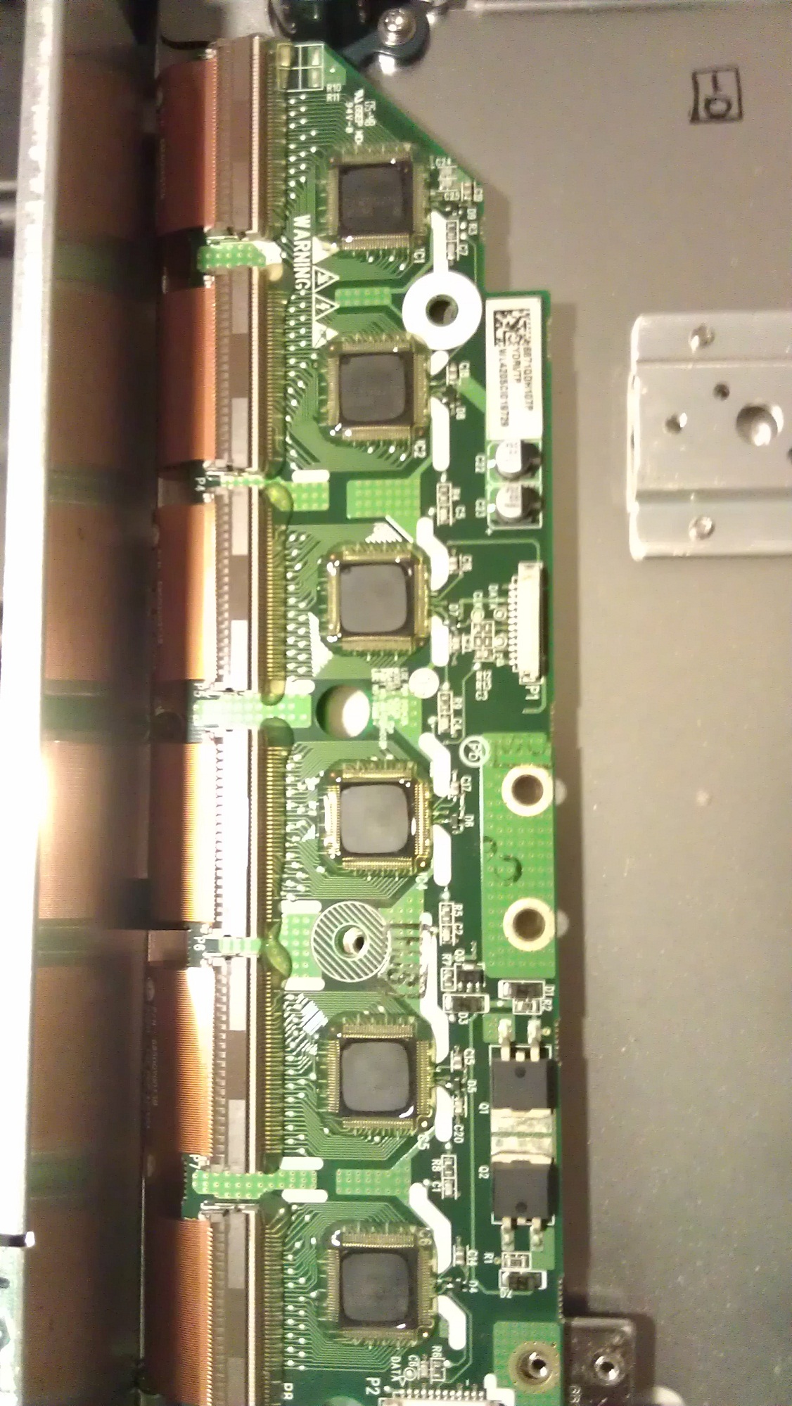

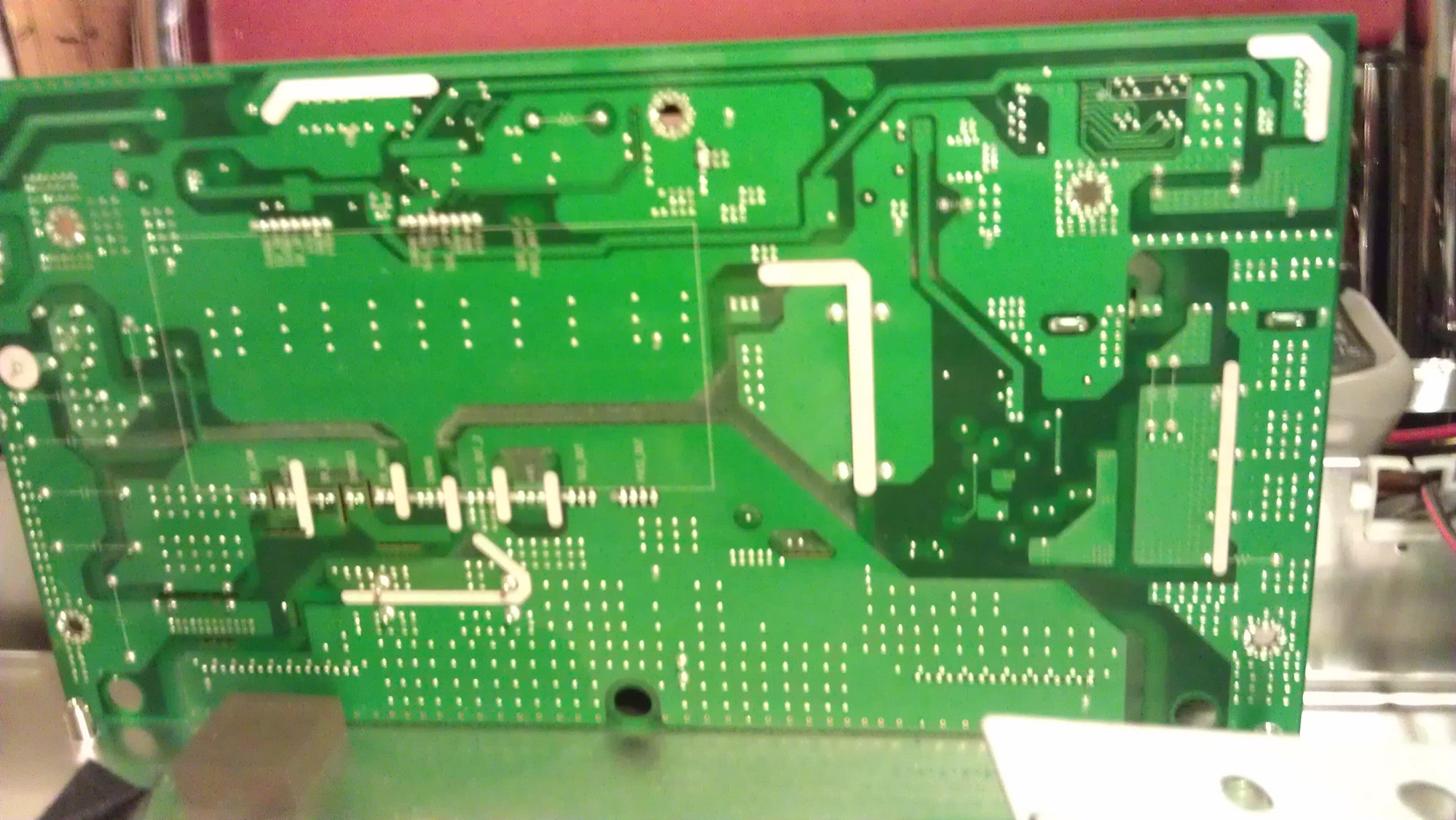

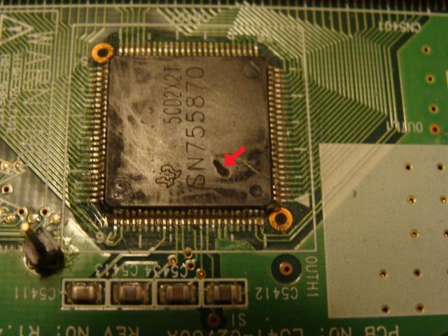

          Re: lg 42px5r no picture with sound
          Post an overall pic of all the boards connected.
          Post front and back of Y-buffers, Y-SUS, Z-SUS
          Here's what a burnt Y-buffer IC looks like
          • nalle077
            • Mar 2009
            • 102
            Here are the photos, note that all buffer look the same as the buffer close up photo.
              Here is how to test Y-SUS IPM.
              http://blog.coppelltvrepair.com/2011...s-ipm-for.html
              • nalle077
                • Mar 2009
                • 102
                Thanks.
                I have measured according to the site and I found 1 thing that might be wrong. On my IPM (not the one on the picture I have 4921QP1027Q) there is no "ERout" I have "ER_I0", "ER_LOW", "ER_HIGH", "ER_DN" and "ER_UP" I have short between "ER_I0" and "SUS_OUT" and that is of course because I have it on the board ( if "ER_I0" and "ERout" is the same?) but I have 293 ohm between "+VS" and "ER_I0" if I have black probe on "+VS" and red probe on "ER_I0" the other way around I have almost Infinite.
                What to think?
                Does anyone have the same card and can see if it is the same on that?
