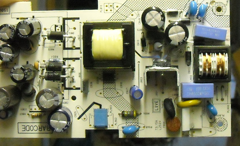

    Not been able to figure this one, it's basically a Vestel TV (both power and AV boards) with CHI MEI LCD panel. PSU board is 17ips16-3
    Have found the following symptoms:
    Standby LED flashing at approx 1hz and very quiet ticking that sounds like it's coming from the primary side of the PSU and in time with the standby LED flashing.
    With everything disconnected from the PSU this noise is still there.
    Checked caps on both primary and secondary side, all seemed ok -
    Mains filter caps 18uF 400v both reading 17uF one with 1.6 ohms ESR and one with 1.7 ohms ESR
    302VDC across the filter caps (a pair in parallel)
    Startup cap 33uF 50V reading 31uF with an ESR of 0.6 Ohms
    Charge resistor 96K ohms in circuit (is this a bit low - should I pull it and check?)
    Current sense resistor ~ 1 Ohm in circuit
    Q802 chopper transistor is recognised properly by the DCA55 tester so assume it is ok.
    303.2VDC at centre pin (Drain) of chopper transistor
    D810 not shorted, forward voltage of approx 0.45v measured with DMM
    D815 D817 and D818 not shorted, forward voltage of 0.25v with DCA55 tester
    SMPS transformer (details shown below)
    30065656
    SMP-C2331
    Primary (Pin4 NC)
    1-2 1.3 Ohms
    1-3 0.L
    1-5 O.L
    2-3 O.L
    2-5 O.L
    3-5 1.4 Ohms
    Secondary
    1-2 0.6 Ohms
    1-3 O.L
    1-4 O.L
    1-5 O.L
    2-3 O.L
    2-4 O.L
    2-5 O.L
    3-4 O.L
    3-5 0.6 Ohms
    4-5 O.L
    No sign of a short on the PSU at the transformer secondary pads with transformer out of circuit.
    All component tests done out of circuit unless stated otherwise.
    (DMM leads connected together show 0.6 ohms)
    Pics of primary side attached, can post others if needed.

    Re: Vestel based 16" LCD: PSU ticking
    Of these snubber components (RCD clamp), are any failed?
    If none are, my bets are on the tiny 6-pin SMPS controller.

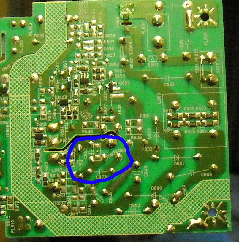

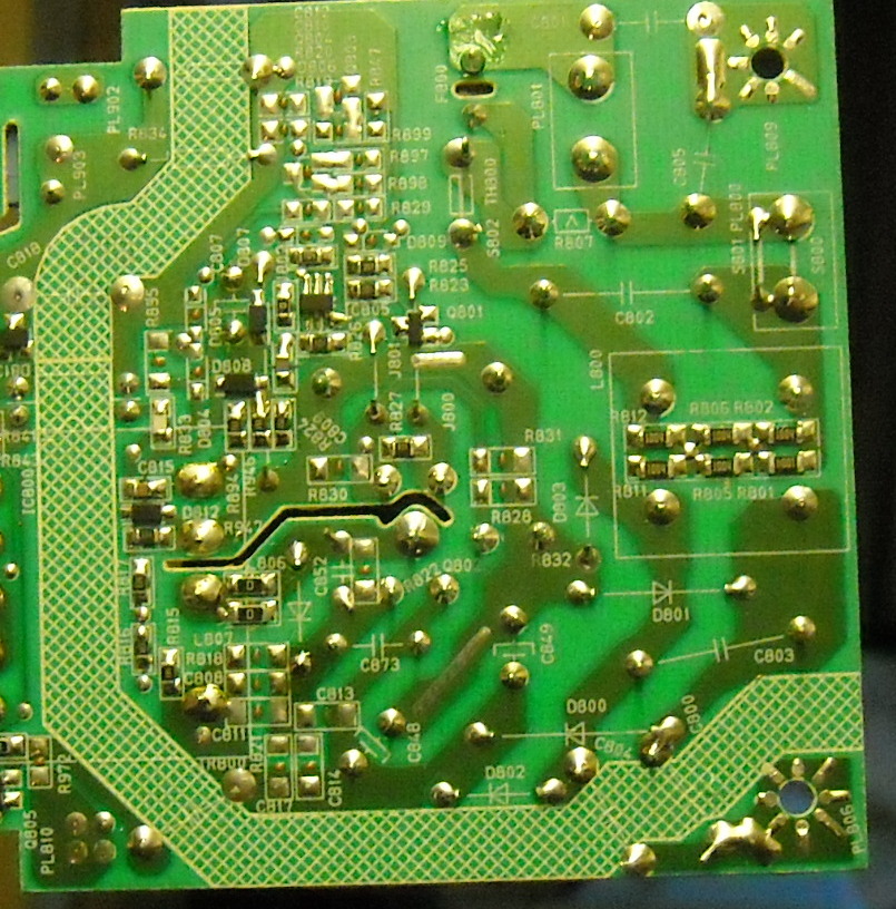

      Also check D608 (D808?) on bottom of the board and the three SMD resistors near it.
      • bbjunkie
        • Dec 2011
        • 301
        D808 has a forward voltage drop of 0.488v the three SMD resistors are checking at 50 ohms each which ties up as they are 150 ohms each and in parallel. All those were measured in circuit
        C852 marked 101 measures 200pf
        C873 measures 4.7nf
        Both cap tests done out of circui
        The diode on the left side of the circle is D810 already checked above.
