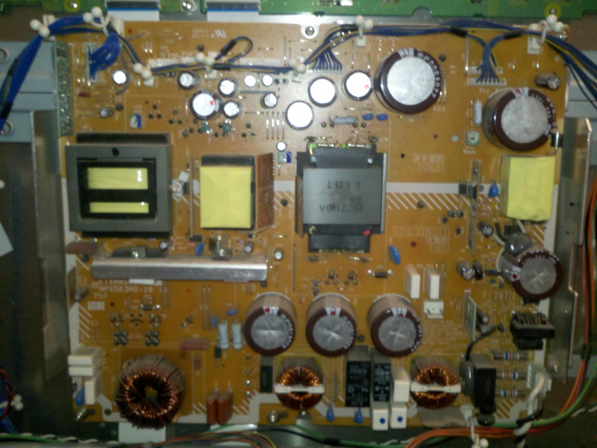

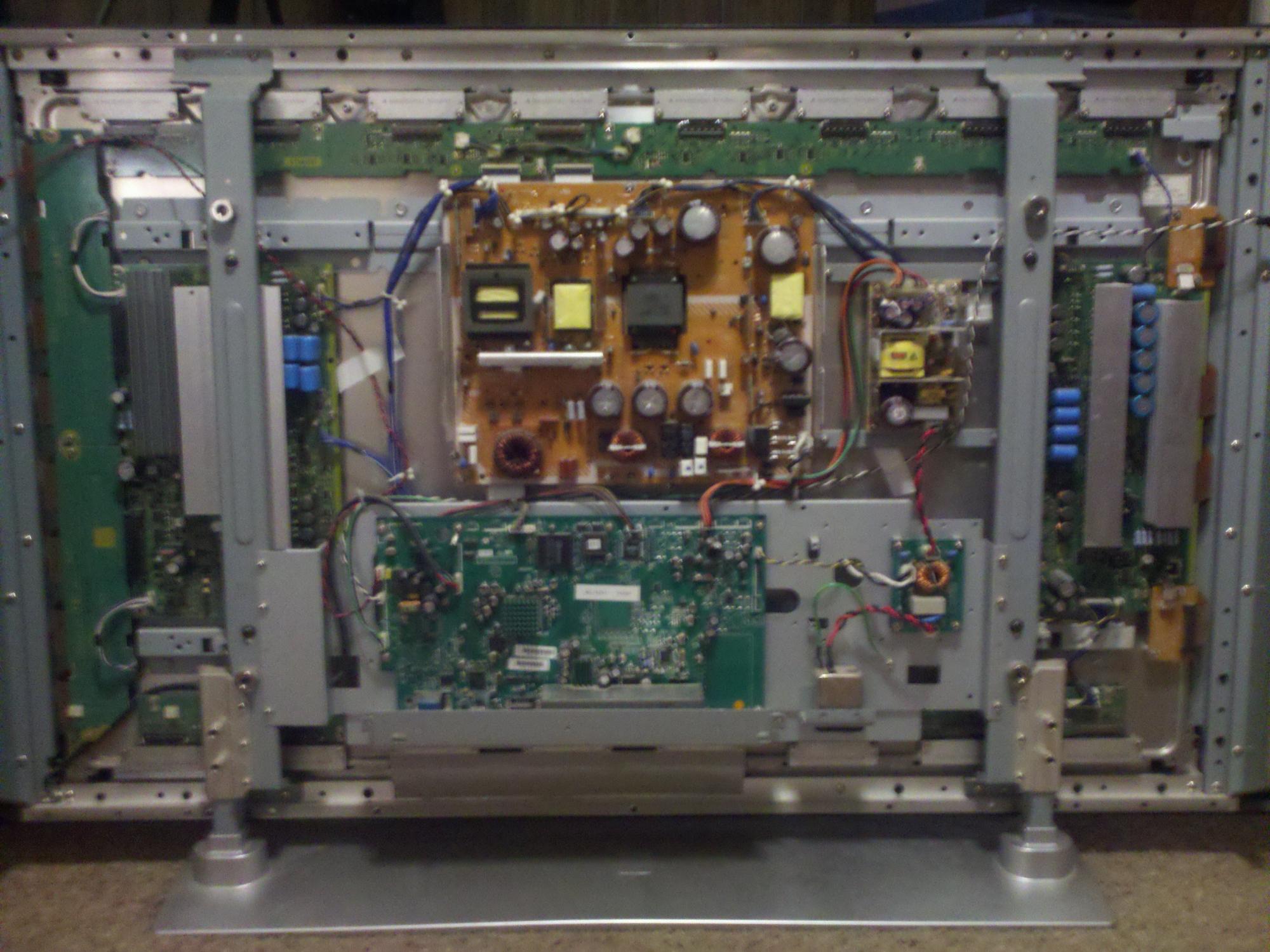

    Hey there again guys.
    Got a plasma now...
    The guy I got this TV from said that he was able to get the screen to come on by putting a heater in the center of the back of the TV at the very top.
    I put the heater where he said and I could not get the screen to work.
    The best I could get were some wild looking flashes of light on the screen.
    (See attached .zip for video)
    The main board is up high in the center. (See attached pictures)
    What could be the cause here?
    Thanks!

    To clarify, the video shows the flashes that happen only when the heater is applied to the main board.
    With no heater, all I get is a glowing black screen.

      Re: Maxent p420542hm8 - Screen will only come on with a heater behind it
      I remember my parents' telling me about their Rank Arena colour TV bought in 1975 developing bad solder joints over time, and heating it made it work for some time.
      On an LG plasma TV I tried to repair for someone, applying heat to the boards with a hairdryer caused it to shut down over time, and the board most sensitive to heat was the power supply board.
        A glowing black screen would indicate the plasma panel is working but there is no video signal. Do you have sound?
        The prospects for a successful repair aren't good. What you call the 'main board' is the power supply. The main board is below it.
        I agree with japlytic - it sounds like a bad solder joint.
