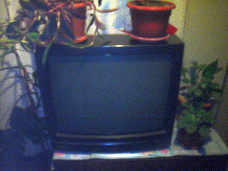

    I was going out for a little midnight walk. I live on the 3rd floor and i've made a habit of not taking the elevator at night coz i'd hate getting stuck in it till morning. Turns out my habit of taking the stairs was worth it...
    On the 2nd floor, with two flower pots sitting on top of it, there was... *gasp* a 28" CRT TV!!! A brief look at it shows that it had the power cord cut off, but all the guts were still there. Probably coz whoever threw it out didn't have a Torx screwdriver on him, it's secured by that kind of screws. Anyway, the missing power cord clearly signaled it as "up for grabs" so i moved the flower pots off it, pulled it into the elevator (well, i HAD to use the elevator this time), and took it home.
    http://www.eserviceinfo.com/download..._28mn1570.html
    Here's a quick grab i took with my phone of the TV's original position. All i can say is That's the life when you're living in the !
    Edit: Just took the back off and it's full of dust in there - this has last been taken apart long ago, if ever. So it might actually be working! Edit 2: I've spotted a sound converter hooked on top of the TV tuner, so yes it was taken apart before, but by the looks of the parts in the converter it's been like 10 years since. I give this one a 80% chance of being useful.

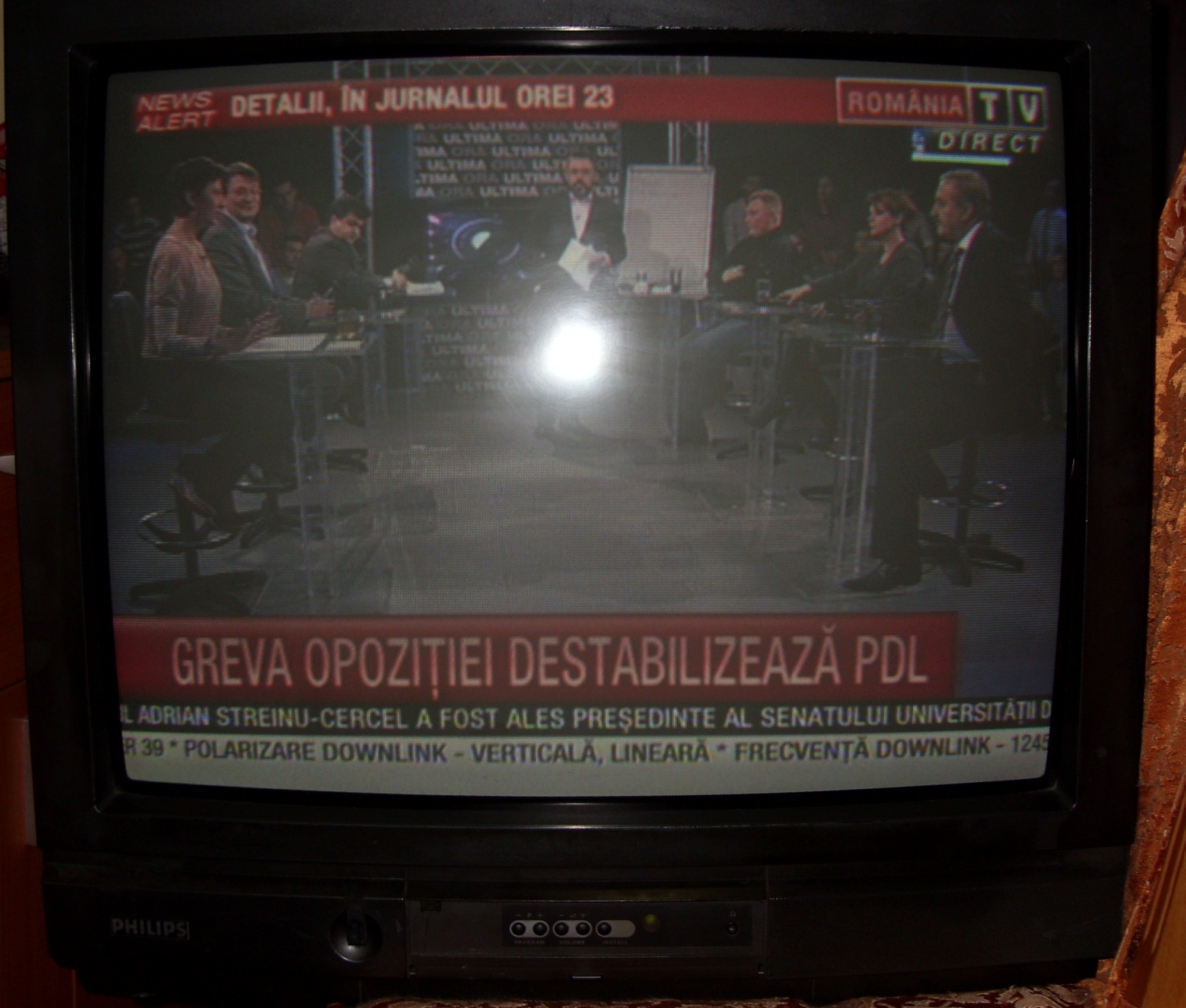

                  Mkay... Put in the HOT and the cap. For the life of me i couldn't figure out the original mounting clip of the HOT, so i drilled a new hole in the heatsink (the other side had a hole already) and used a clip from the same Nei chassis i got the parts from. Applied the highly technical method of blowing at it to remove the metal dust i created by drilling, and plugged it in.
                  Result? SUCCESS! Fired right up. Now to clean things up a bit here and move the beast to the hallway to plug it in to cable.

                        • Put the cable in and it doesn't look too bad. Edges have a slight vertical ripple but nothing a few new caps won't fix. Although i saw mostly Nichicons inside, once i get all the dust out i'm likely to stumble upon other, cheaper brands too.
                        • The screen has only a couple minor scratches. Given the size and where it was left, it's quite amazing.
                        • The best focus is at one extreme of the knob (which it was already set at). I'm not complaining as it doesn't look bad at all. It is a bit soft but hey, it's a big SD set, i'm not expecting it to look sharp.
                        • Linearity isn't stellar but this was a low-end set when it came out, it doesn't even have stereo sound. There is a place to put a second speaker but the power button sits in the middle of that.
                        • And last but not least, i'm going to need a new remote for this thing. The ones i have will only change channels and volume, they won't adjust brightness/contrast/color. This is an older set where the only menu is the one that programs the channels in. Given its age, the tube looks really good.
                        • It does appear to have a service menu though, since it has only one trimpot outside of focus and G2. It could use some tweaking but i'll worry about that when i get the remote.

                            Nah, i just put em back where the TV used to sit. Btw, i was wrong - it DOES have trimpots, so off a-tweakin' i go. I love trimpots. There's also not a service menu per se but a service mode enabled by an internal switch. It looks i won't be needing that.
                            Edit: Done tweaking size and position. It doesn't look bad, even if i say so myself. Noticed tuner sensitivity kinda sucks on UHF... or maybe we just get crap cable. Looks fine on the other sets tho, we'll see. I'll post some pics tomorrow. Btw, i couldn't find a manufacturing date on this. The only label like looks like one says 92-something. If that's 1992 it sounds about right from the set's capabilities, but i'm still surprised a tube this old has no hue shift.

                              The low sensitivity on UHF traced down to an intermittent connection on the board i suspect to be the sound converter. Its ground was attached to the shield of the tuner, and it looks like that wasn't such a good idea. It's fixed now.
                              All caps are Nichicon, Rubycon or Panasonic. If this meant "low-end" back then... It's going to be tough to find what's responsible of the ripple on the picture.

                                Found a 100u 25v Nichicon VZ that leaked from the bottom, replacing it fixed the ripples on the picture. I'm about to wrap this one up and put the cover back on.
                                Bottom line of this story is that caps don't last forever even if they're good brands. Old equipment should always be checked for capacitor failures. Attached a pic of how it looks, of course the flash dulled things down quite a bit, it's brighter in real life. I wanted the pic to have good focus and couldn't do without the flash in this condition. I think the picture is pretty good for a 20 year old tube.

                                      Thanks. I like that it isn't overly bright and the colors are natural, none of that cold, bluish white typical of sets from 2000 and up. Actually, not going overboard with brightness and contrast is probably the reason why the tube still has life left in it.
                                      Turning down the contrast to minimum gives a BLACK picture, which is a rare sight. With contrast set so that the picture is just barely visible, there is a slight red tinge but nothing major, the color balance is still accurate. Looks like this one is definitely a keeper. I don't really watch TV but it has a SCART input which accepts RGB, so it'll do nicely for watching movies.
