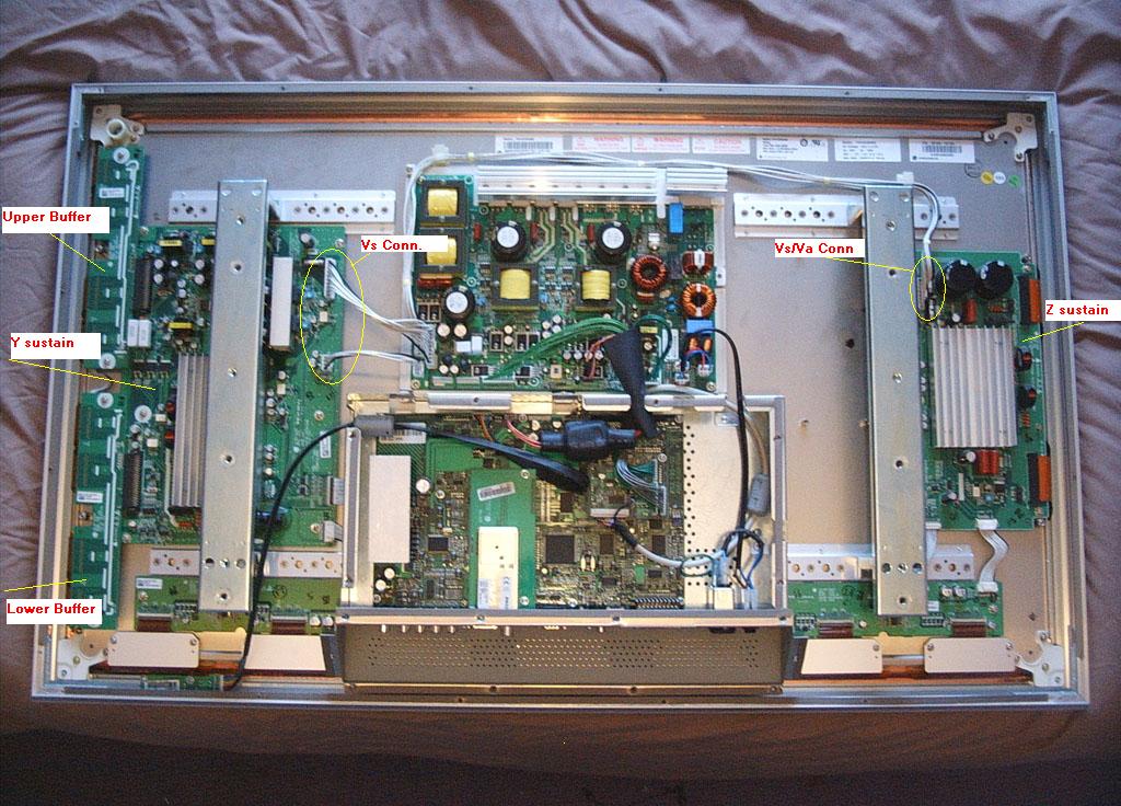

                            Re: Magnavox Plasma TV 42MF231D
                            Attached is the back of a 'typical' plasma tv. Yours no doubt looks similar; every plasma TV I've encountered has this style of layout. What you will want to do, is remove the back of the TV. Make sure it has been powered off for at least 10 minutes to discharge the capacitors, otherwise you will get quite a spark in the next step. Unplugthe connector labeled Vs conn from either the y-sustain side or the power supply side. Once it is unplugged, plug the power in the tv and try to turn it on. You will not have a picture on the screen, but the power light should come on.
                              Unplug the "Y-Whatever" (Y-sustain) and try again. Then repeat with the Z-sustain. If it still doesn't power up; check the power supply.
                                Tried it with bot unplugged, and just Y-Sus.
                                No power light, still hear click.
