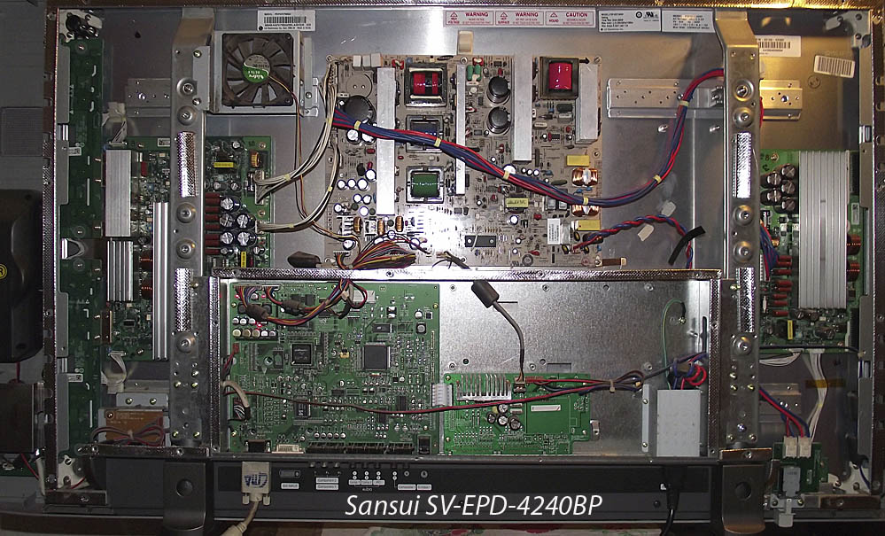

    Sansui SV-EPD-4240BP
    Was struck by lightning - December 24, 2011.
    Insurance wants a report if to pay.
    Set has power and sound but no screen.
    Y and Z boards seem to have power, too.
    Heat sinks get warm.
    I have no diagram.
    I inspected it to see if it would be a minor fault.
    Should I report it as uncertain or uneconomical to repair and charge the customer for labour?

    Re: Sansui SV-EPD-4240BP
    Repair of equipment that was the victim of a lightning strike is always highly uncertain. I'd report it as uneconomical to repair due to lack of troubleshooting information and parts availablility - Sansui seems to be no longer producing HDTVs.
      I agree, PB.
      Thanks very much for your suggestion.
      Appreciated.
