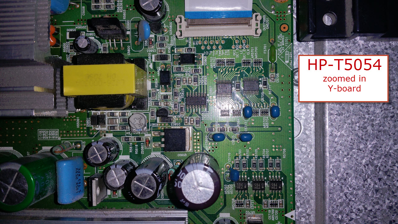

            I hope I am not hijacking someone else's thread..I have a SAMSUNG PLASMA HP-T5054X/XAA, has sound but no picture. I bought a TV from someone that posted it on Craigslist as a broken power supply. When I brought it home, it actually has the same symptoms as my TV-no picture, sound and a green light blinking every second. Can anyone help me to get my TV running again? I am not sure where to start. I bought and replaced some parts/kit from GoJimmy but that did nothing. Here is the picture from the Y Board.

              Re: Samsung Plasma TV - Worth Repairing?
              I am sorry, I don't know why the images are not showing

                #Be a good idea to tell us exactly what you've tested and what you've replaced so far!

                  Thank you for your response. I ordered this: http://www.shopjimmy.com/samsung-bn9...repair-kit.htm and replaced all the components on the y-board but the TV still has the same problem,-sound but no picture. That is all I did so far. I bought a broken Samsung HP-T5044 hoping I can use it for parts but it has the exact same problem like mine, so now I have 2 broken TVs.
