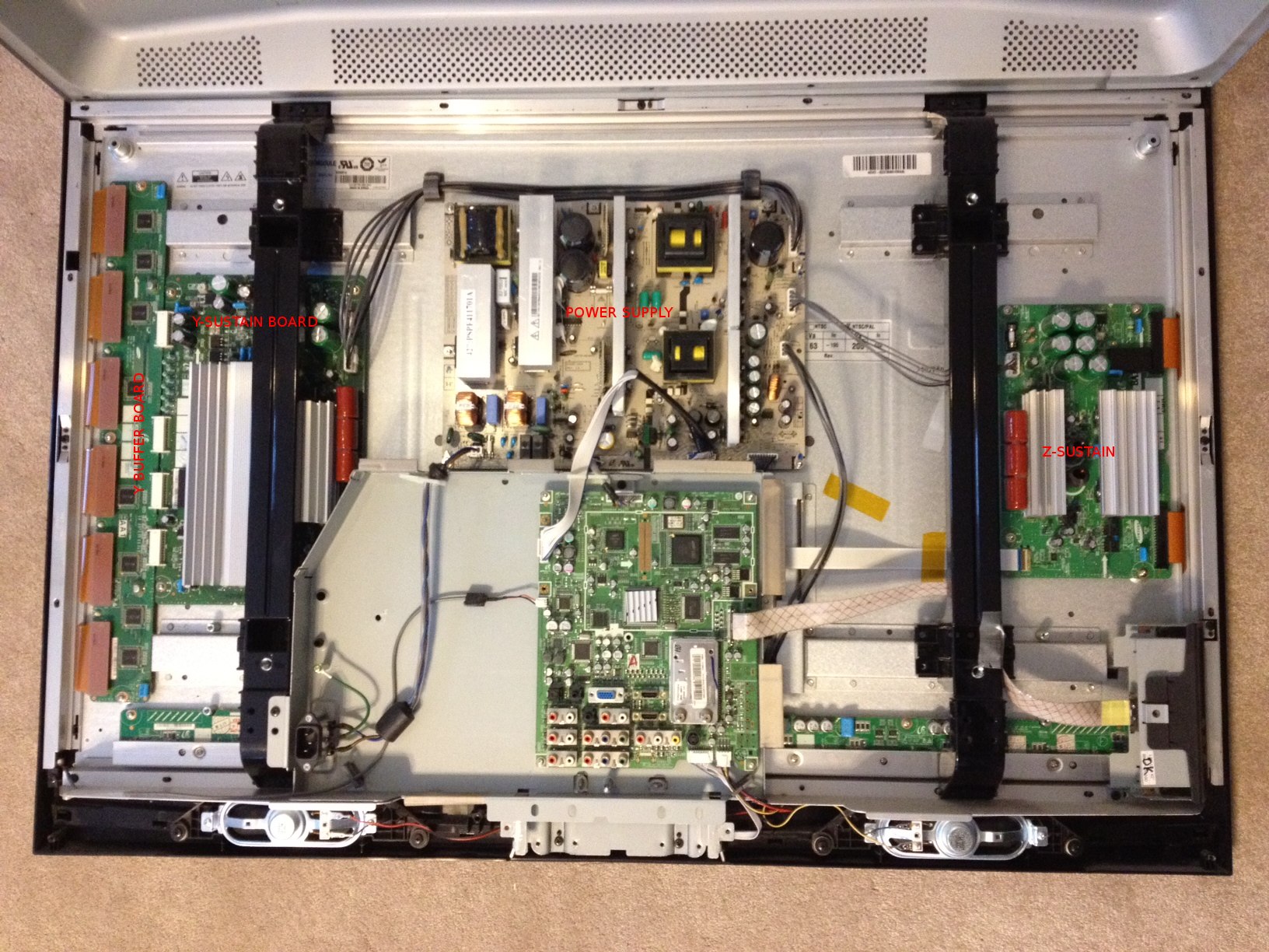

    Sounds like a sustain board failure. Yes it is fixable.
    Unplug the board on the left hand side of the TV (when looking from rear and while off!) That is the Y-sustain. If the TV now powers up with sound, the Y-sustain is failed. Then plug in the Y-sustain again and unplug the Z-sustain, which is on the right.
    Post a picture of the back of your TV, so we can help you locate the boards.

      Thanks for the reply! I am posting a picture, as requested.
      So if the TV DOESN'T power on with the Y-sustain disconnected, does that mean the Y-sustain is OK? And I assume if the Y-sustain is OK then I do the same procedure to test the Z-sustain? Are these boards readily available to purchase or order? Any idea how much they cost?
      One last question: Any idea what the crackling/popping sound and associated burning smell might have been? That just sounds bad to me, like something is really fried.

        Well, it confirms that the Y-sustain isn't causing the problem, but it could be faulty in another way. For now, it's good to focus on the original problem.
        Semiconductors in these TVs deal with high currents and voltages and when something goes wrong a lot of energy is available to damage the component which can cause a nice "pop".
        See my guide: https://www.badcaps.net/forum/showpo...42&postcount=4
        I've posted an image with labels of the boards.

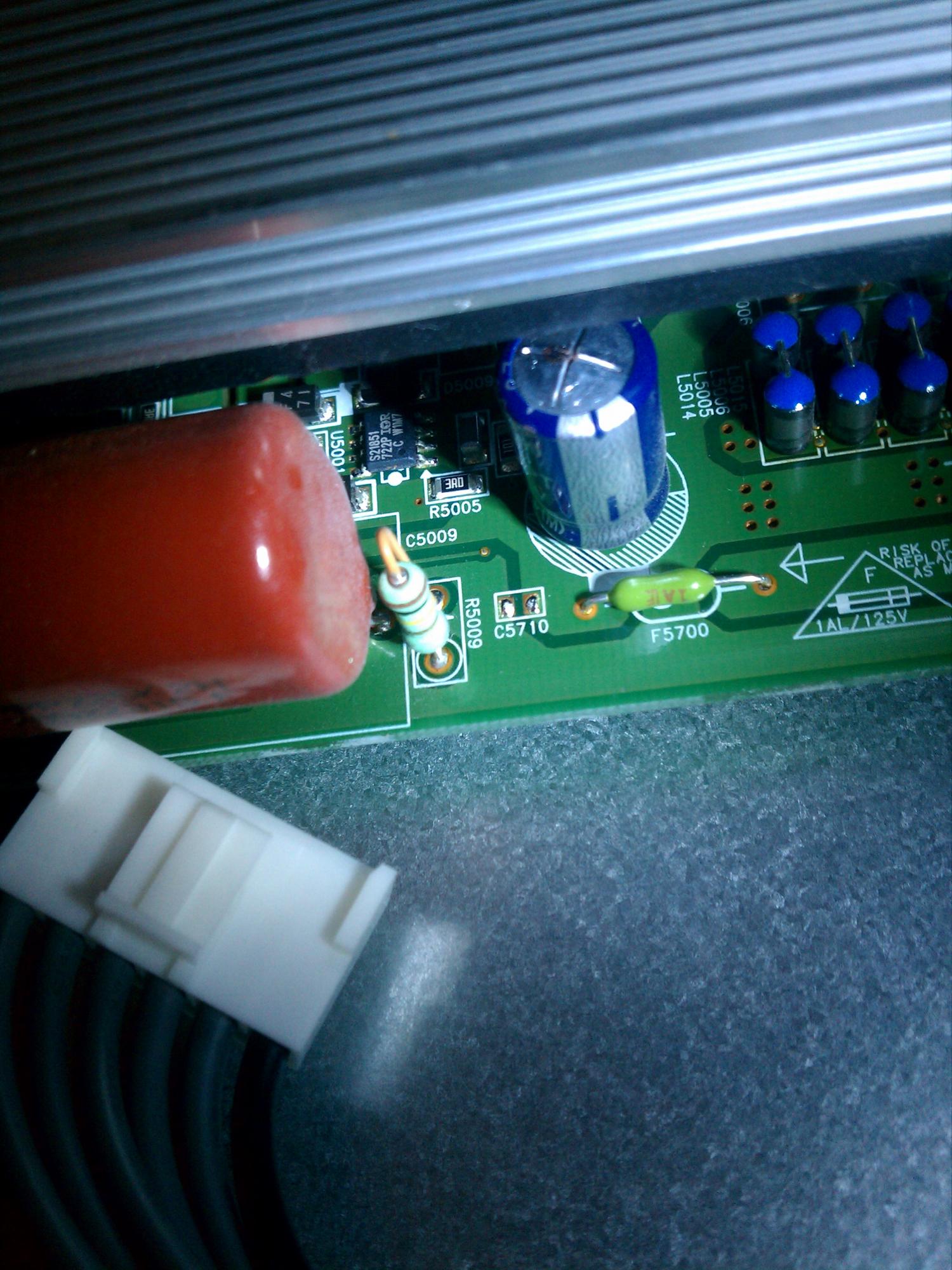

                          On the y-sustain board, closest to the power cable, there is a capacitor with the top bubbling up and a black dot on top.
                          After the TV is on for ~20 minutes, I turned it off and after 5 minutes I felt the heat sinks.
                          Both heat sinks on the z-sustain board are hot.
                          The 2 larger heat sinks on the y-sustain board are cold, while the smaller one near the bottom is hot.
                          From what it seems, the entire y-sustain board is bad. Are there any other steps I should take to diag the problem? TIA.

                            Can you post a picture of the suspect capacitor?
                            Your symptoms do not match the typical bad sustain problem.

                              Here is a picture of the capacitor. It is right next to the power cable pin for the y-sustain.
                              Side view showing the profile:
                                Re: Samsung Plasma TV - Worth Repairing?
                                What are the values on that cap?
                                  25V. 680 uF

                                    Change that cap (680UF @ 25V) and picofuse , it should be 1A. also check resister next to red capaciptor.

                                      I changed the capacitor last night, and nothing changed as far as the video went. The blue capacitor in the picture has a negative sign on one side, while my replacement cap had a giant 0 on the side. I'm guessing the side with the 0 on it is the negative side?
                                      I'll try replacing that picofuse tonight, as well as testing the resistor. What values should I be reading on my multimeter?
                                      Also, is there a way to test the cap to make sure I installed it properly and that it has a good connection with the solder?
