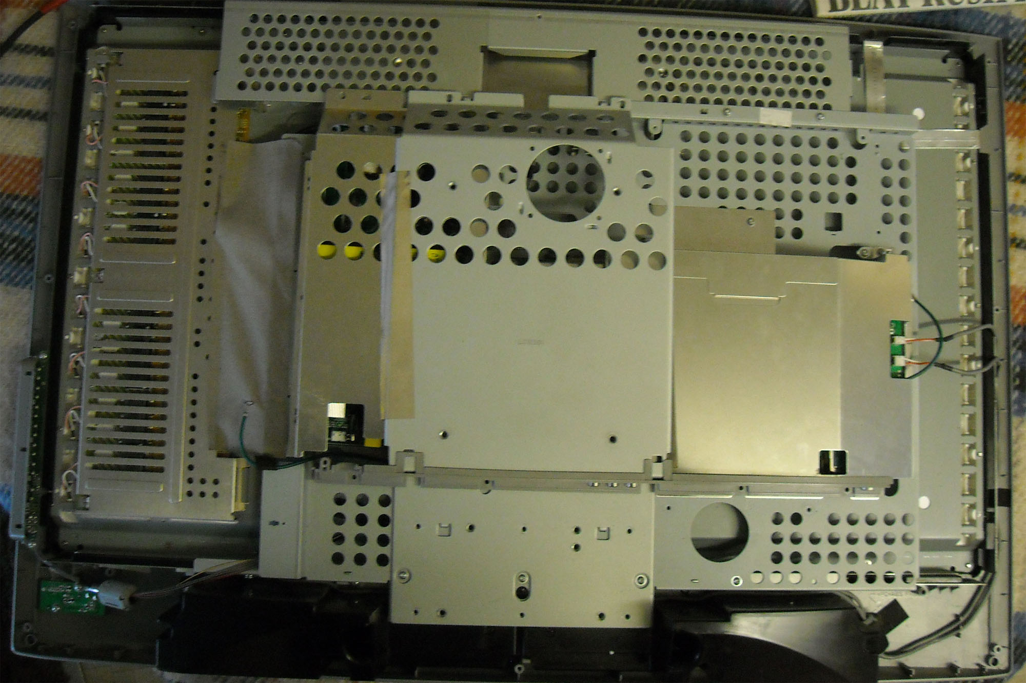

    Finally took delivery of this TV today, had bought it on eBay a few days before Christmas, but the shipping company have messed us around with failed collections etc meaning it only arrived with me yesterday.
    Got stuck into it this evening, back off and first impressions are this is a quality build. Lots of metalwork and it feels strong (there is even a hole in one of the plates that looks a perfect size for a small 100mm computer type fan including the mounting screws) I may fit one here if I can find a good 5v supply nearby.
    I am glad to report that there are no signs of anyone having been in here before me, so hopefully I will find no nasty surprises along the way.
    Ok, on with the repair.. <Yes, this time I checked - this one is definitley stuck in standby, not 2 seconds to black!> I went straight to the caps on the PSU, and didn't have to look much further for signs of what could be wrong - 7 CapXon caps of various values with domed tops.

    Post a picture of the rest of the TV (so we can see how well built it is... aside from the capacitors, of course...)

      Re: JVC LT-32A61SJ Stuck in standby
      Indeed, I have a 2007 JVC 42" LCD 1080p in my main living area, and am now wondering if I should do a recap on it before they cause damage to other components. (It is behaving itself currently)

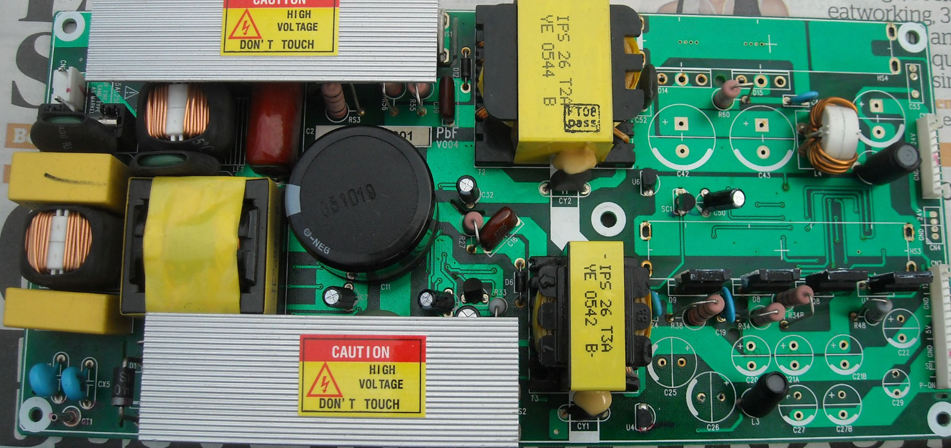

                  Well, got the caps out of the JVC PSU - I had 4 removed when I remembered tom66 asked me to do voltage checks, so I hope you will understand I didn't want to refit them (the board is double sided and I didnt want to run the risk of overheating tracks etc)
                  Anyway, all caps removed and the following was noted:
                  C25 (3300uf) 3596uf 0.02 ohms
                  C26 (3300uf) 3642uf 0.03 ohms (just outside 10% tolerance but on the HIGH side!)
                  C27 (1000uf) 1104uf 0.1 ohms
                  C27B (1000uf) 1074uf 0.12 ohms
                  C22 (1000uf) 395uf 0.4 ohms
                  C21B (470uf) leaky 3.6 ohms
                  C29 (100uf) 99uf 0.44 ohms
                  C20 (470uf) leaky 2.8 ohms
                  C21A (470uf) leaky 3.2 ohms
                  C44 (1200uf) 406.3uf 0.27 ohms
                  C42 (2200uf) 409.8uf 0.28 ohms
                  C43 (2200uf) 424.6uf 0.26 ohms
                  Those marked in red I am sure are requiring replacement. In theory (im replacing them all anyway) are others are pretty much OK?
                  Now I have the caps removed I can measure their sizes to make sure I get the right ones. Probably going to go for Panasonic FM/FC caps on this one as I want a reliable tv that can stay on the wall once fitted.
                  tom66 - I was wondering why that other JVC went so cheap, and yes I guess it went at a real bargain price due to lack of interest in the area he lives (no shipping)
                  retiredcaps - thanks for the links, I will have a look at them.
                  Jim
                  <edit>
                  Pics added, components missing from PSU board in the pic are all caps mentioned above, 2 heatsinks and two diodes (removed for access)
                    C27 and C27B are also bad (should be <0.05 ohms).
                        What's the capacitance of the main bulk filter? Manuacturer? Looks like it might be a Hitachi (hooray) or a Fujyuhhu (however that is spelt, I can never remember it.)
                        If these caps don't fix it (rare) check the output diodes and startup cap.
                        Good luck
                        • retiredcaps
                          • Apr 2010
                          • 9271
                          Indeed, Panasonic FM are 18 mOhm in 1000uF 25V format.
                              It might work with the 0.1 ohm ESR but they are on their way out and it won't last long.
