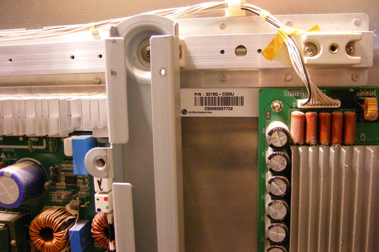

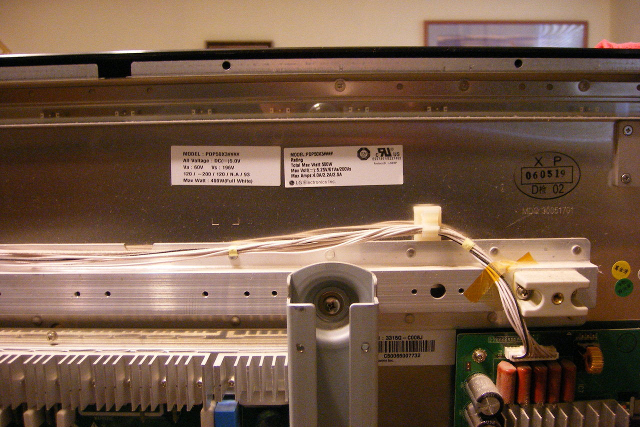

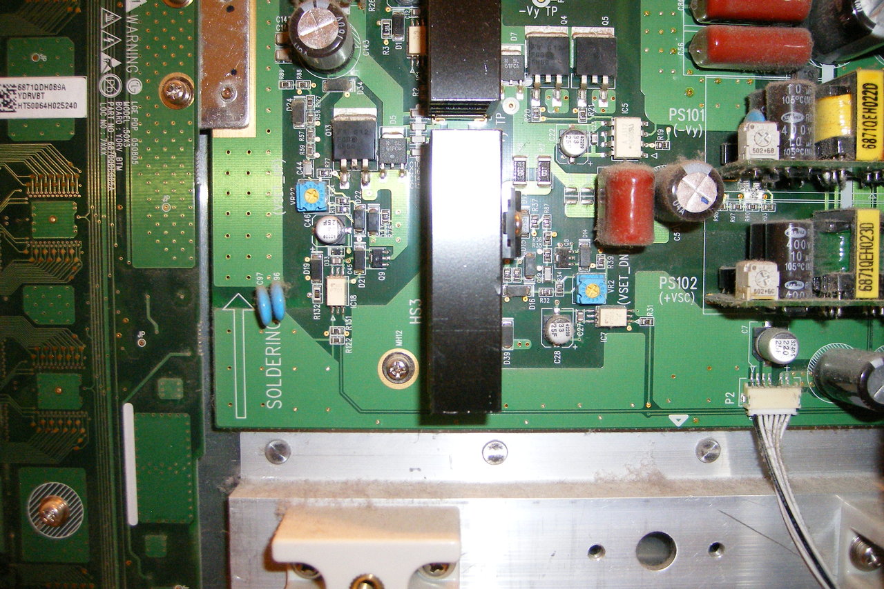

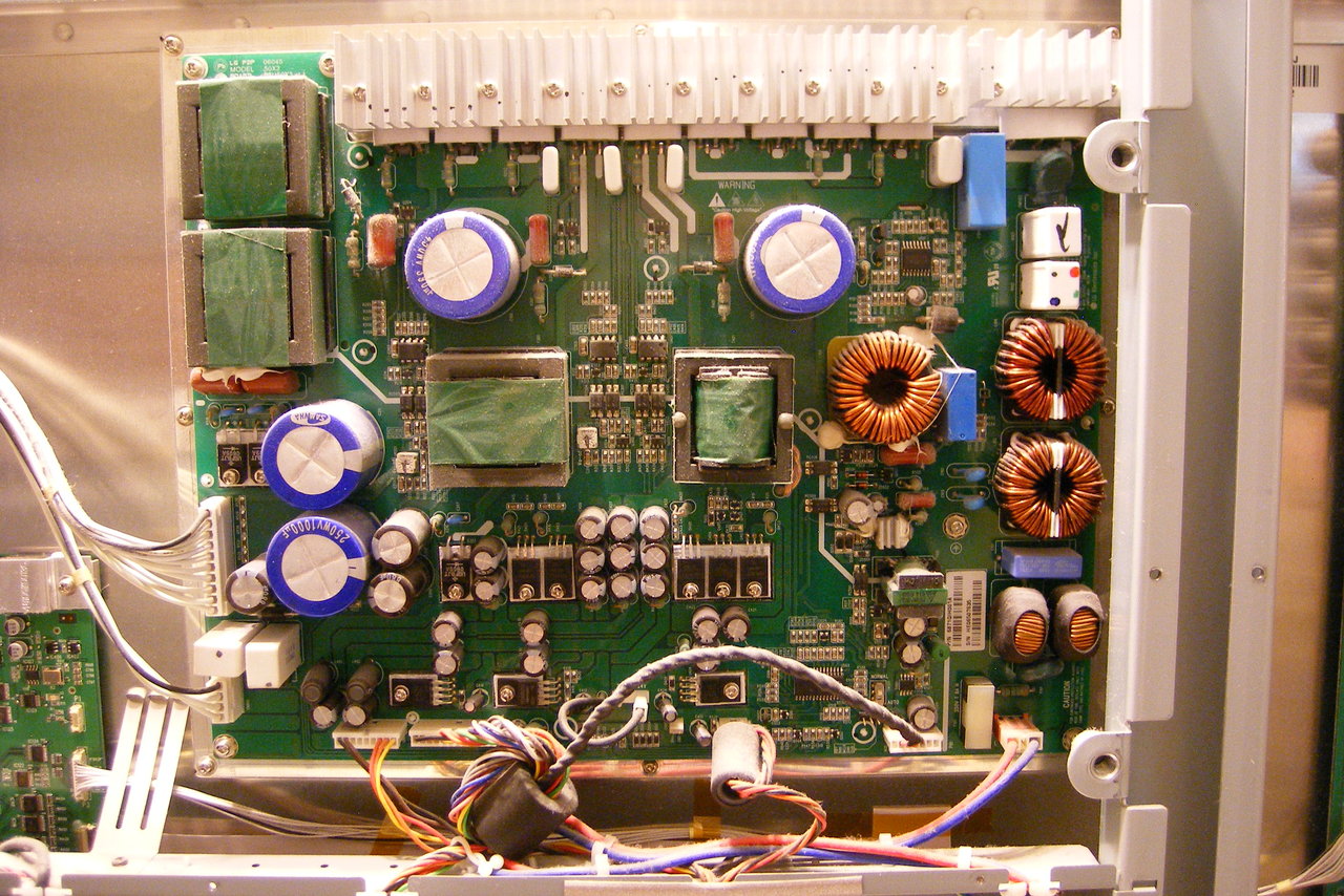

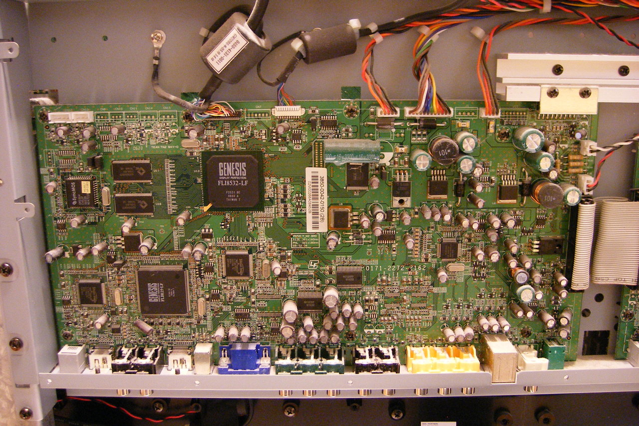

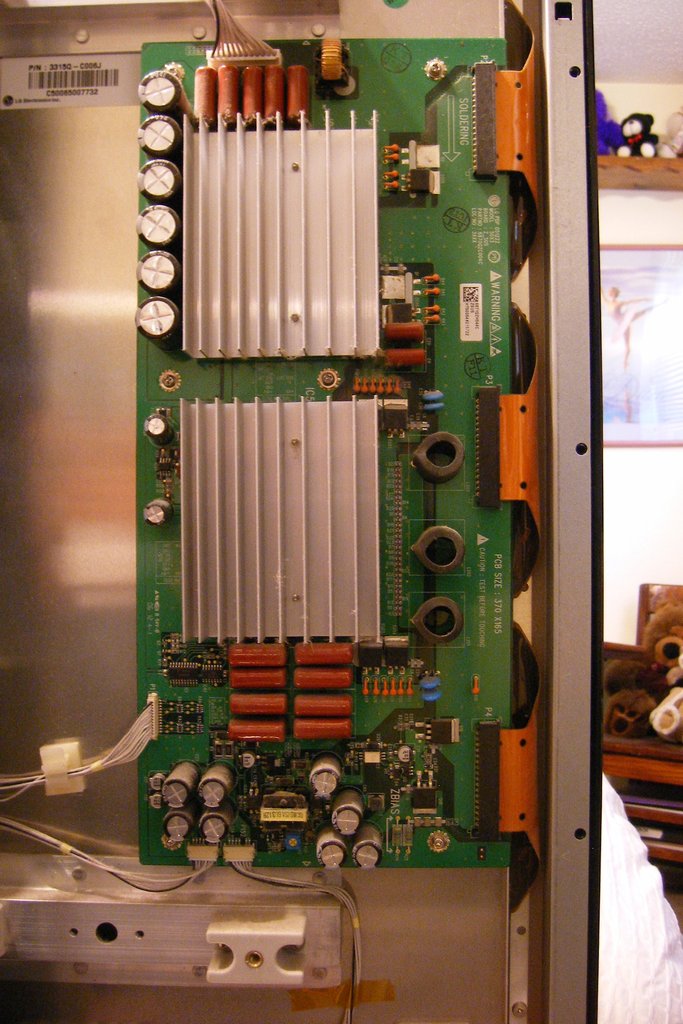

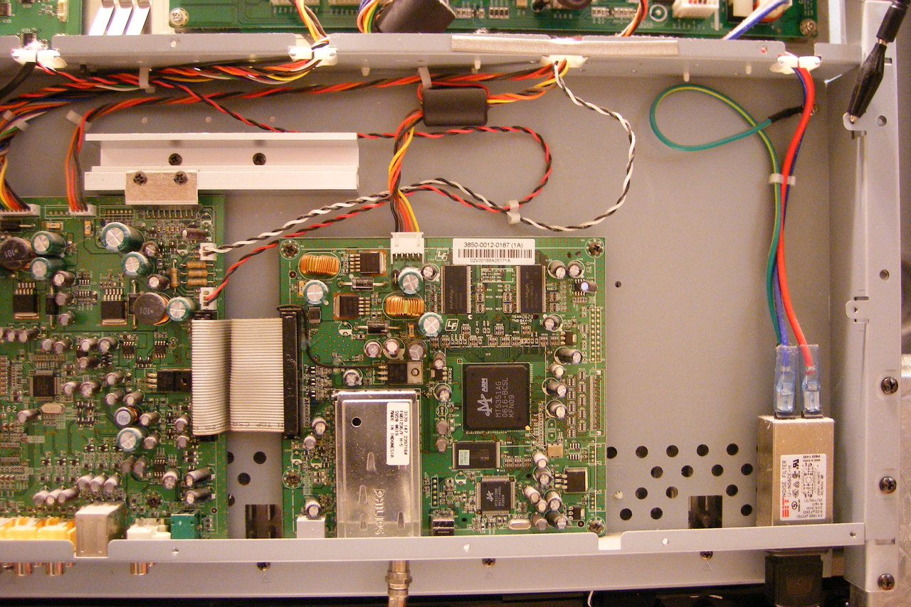

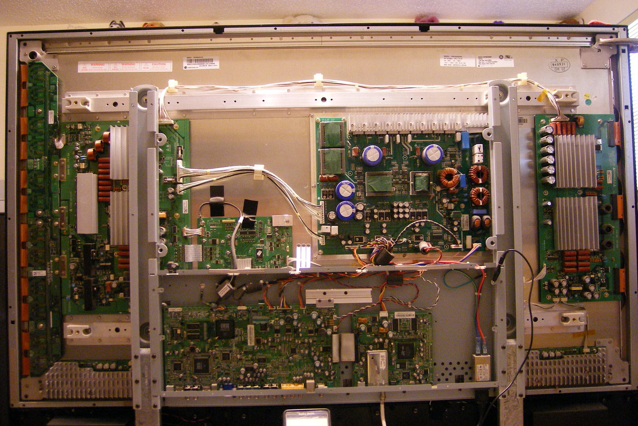

    I have aquired a Vizio Plasma that upon startup the screen flashes between an "Off" state to bright white. The power LED in front of the TV will stay green during this time. I get a faint no signal found box displayed and no sound. I connected a HDMI source as well as a regular cable tv source. I do not have the remote, and it seems none of the button controls on the side of the tv have any effect on the picture(menu, vol. up/dn, Channel up/dn). I cannot seem to change the input source.(no sound)?
    I've taken the back off of the tv and found no bulging/leaking capacitors. No burnt components that I can detect. I can hear a ticking sound coming from the Ysus board near the Hybrid IC's. This ticking is in "time" with the flashing of the screen.
    Can it be assumed the Ysus is bad? I have done a preliminary check of the voltages, and eveything appears nominal.
    Thanks for any replys and help.
    Re: Vizio P50HDTV10A Plasma Screen Flashes

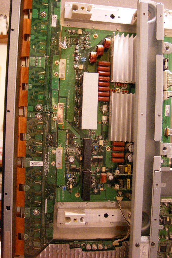

    It wouldn't surprise me if it is a Ysus problem. Disconnect the power connector to it. You should have no more flashing or picture, but the TV should now power up fully, with sound.

      Ok, so I disconnected the top power connecter to the Ysus board and the flashing of the screen stopped (blank screen) as well as the ticking sound near the IPM's.
      So I then reconnected that power connecter and disconnected the power connecter that goes between the Ysus and Zsus. Flashing of the screen stopped (blank screen) but the ticking sound near the IPM's kept going.
      I did change inputs to the tv so I CAN get sound.
      I guess it is the Ysus board.
      Any thoughts on replacements/repair of the Ysus?
      Coppell's tv repair has replacement IPM's for both $89. I believe my soldering skills are up to the task. Of course I don't know if any other componet on the board is bad. He has a repair serivce for $125. Used boards on Ebay go for $125 shipped.

        I sent the Ysus board in to Coppell's TV repair. It took two days turn around and got the board today. Installed and the tv works great.
