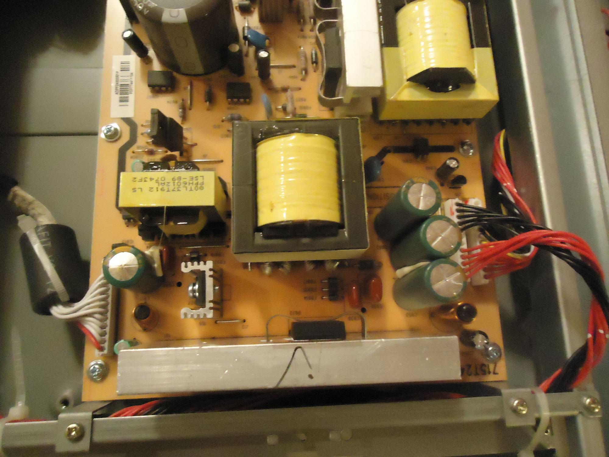

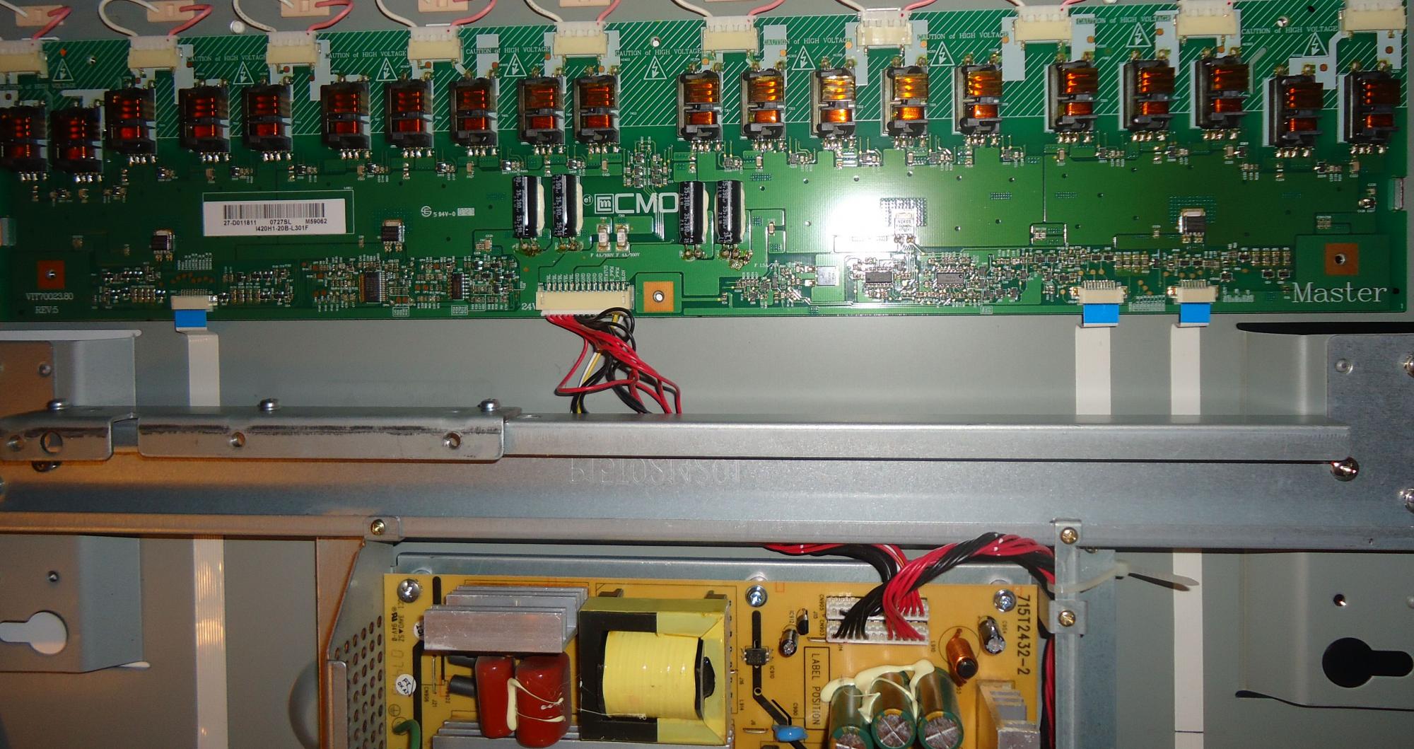

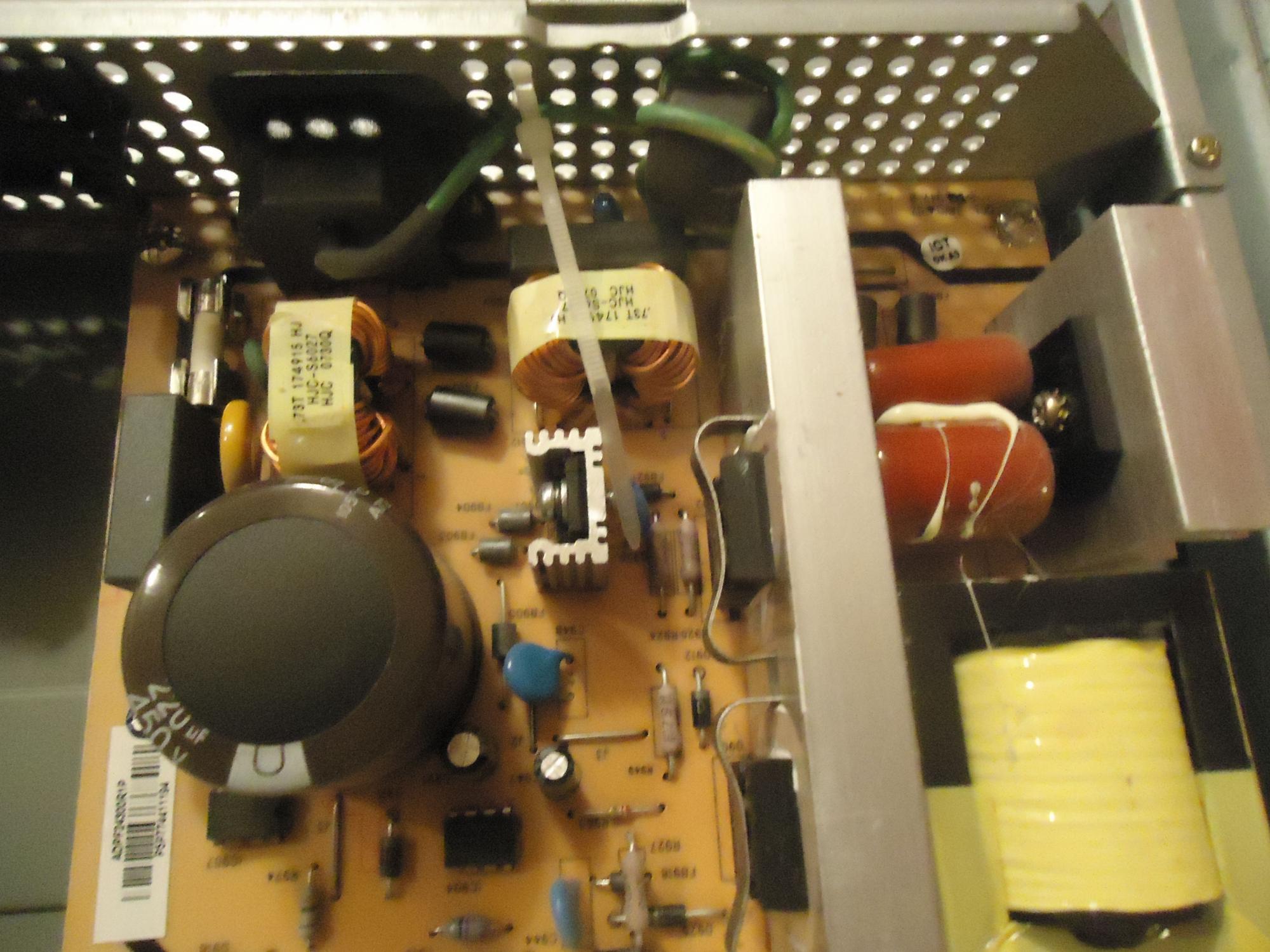

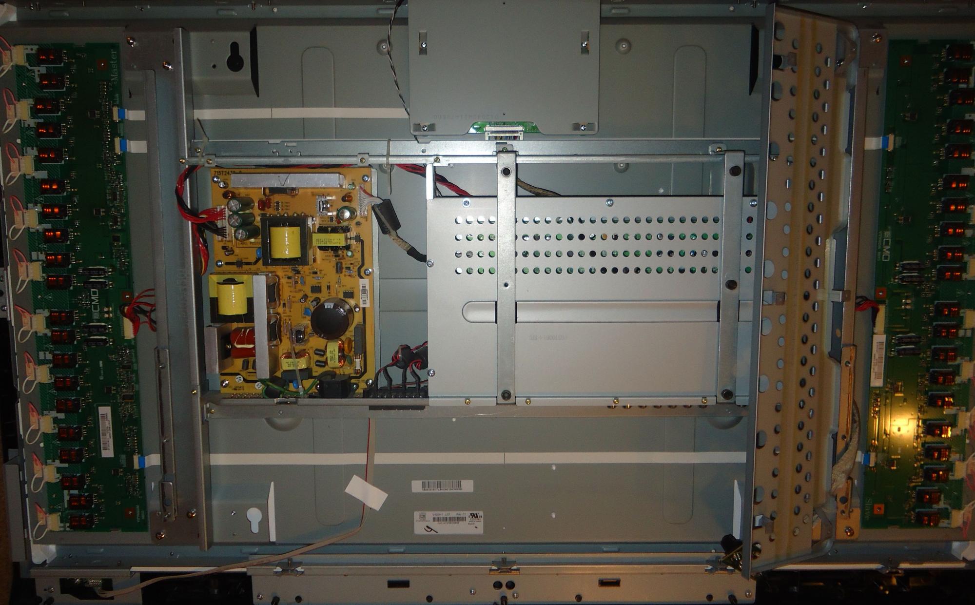

        Re: Philips 42PFL5432d/37
        Hope these are enough...
        • jetadm123
          • 2169
          I do see a bulged cap down in the lower left of your 4th photo. A recap with Panasonic FR, FM or FC series caps would be a good start. A shot of the entire power supply (from top down) would also be good.

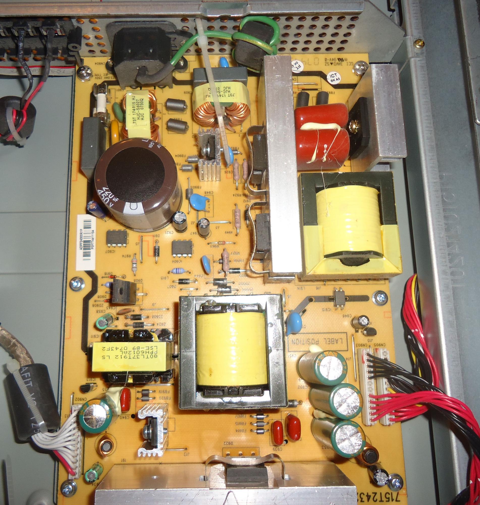

            Don't know how I managed to miss uploading that one.. Time to blame it on the meds haha
              I had a power supply with two bad capacitors - it made the same increasing in pitch whining sound that yours does. Replacing the two caps (which I had on hand - Panasonic FC) fixed the problem immediately.
                Alright, looks like I'll set about replacing the fallen soldier.
                May have the cap available at work, will find out tomorrow. If not, I'll order one.
                Should I plan (and order) to replace several on the board, or just the one that is bulging?

                    Just make sure you get a good low-ESR capacitor. You could replace it with a generic, but it'll probably go bad in another month - a good low-ESR capacitor should last another 5-10 years.
                      Parts are on order, I'll keep you all updated.
                      • another7driver
                        • Jan 2012
                        • 6
                        Worked like a charm, now running perfectly. Also, I'm a day or two from being completely healthy again as well.
