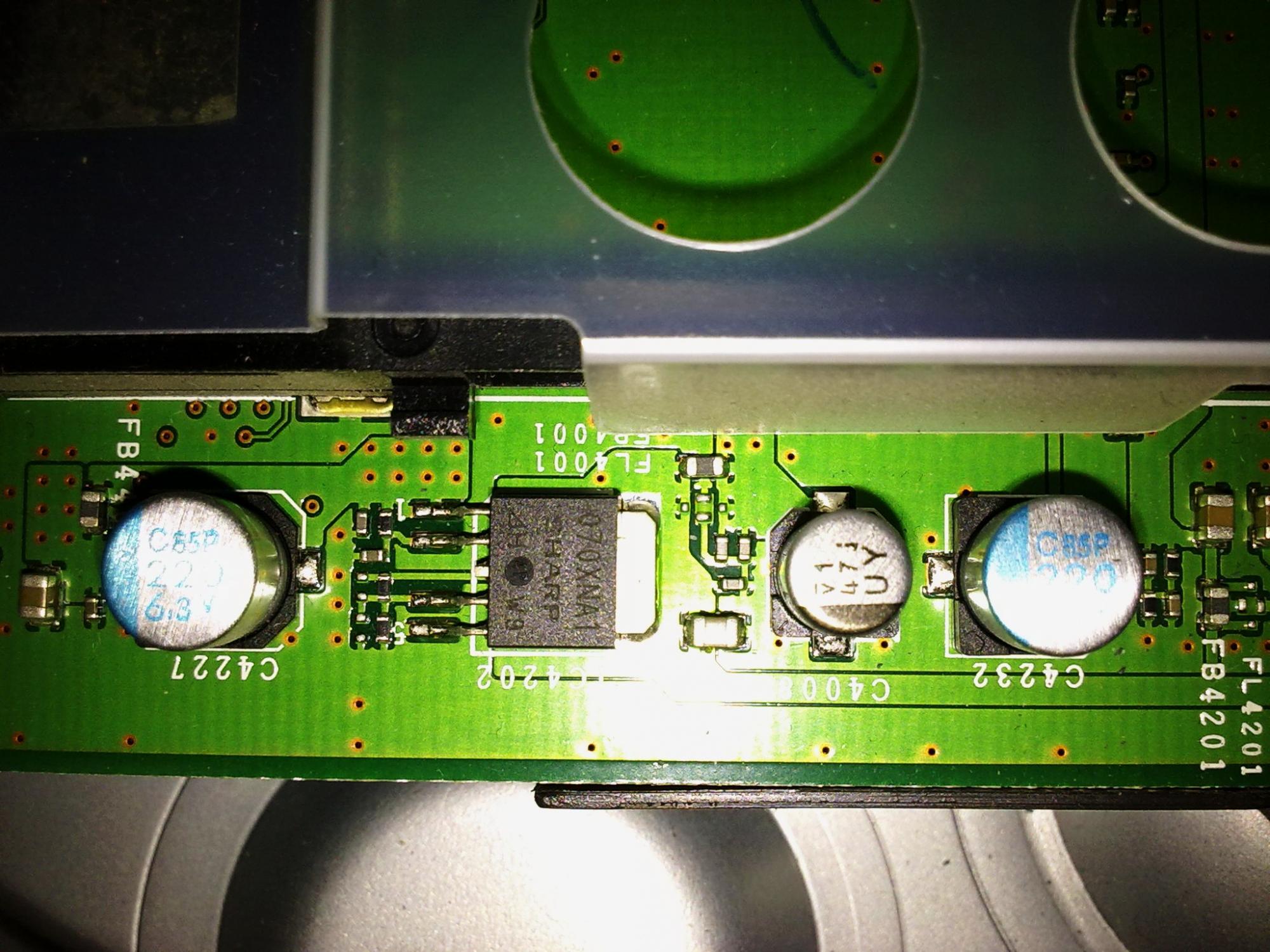

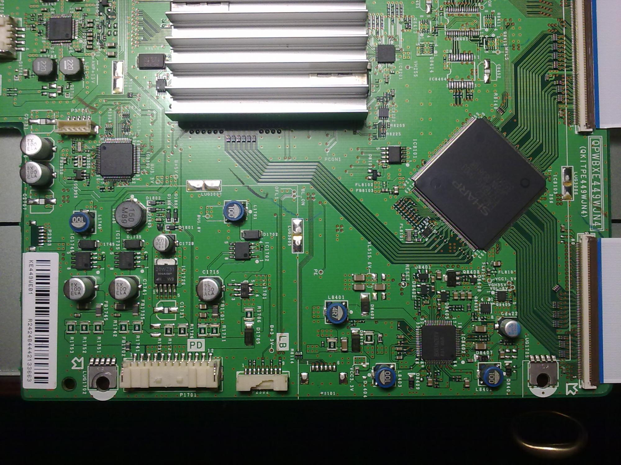

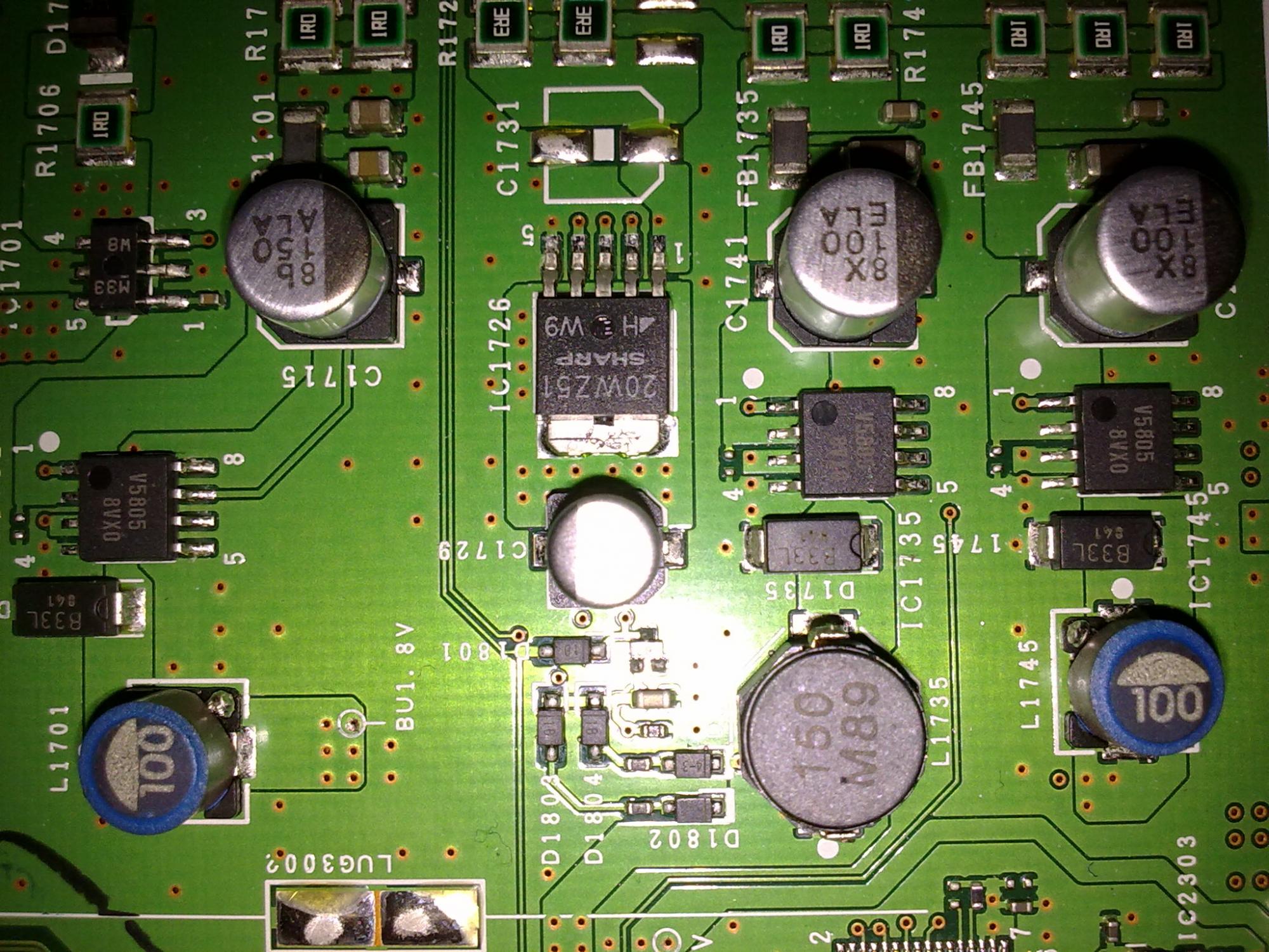

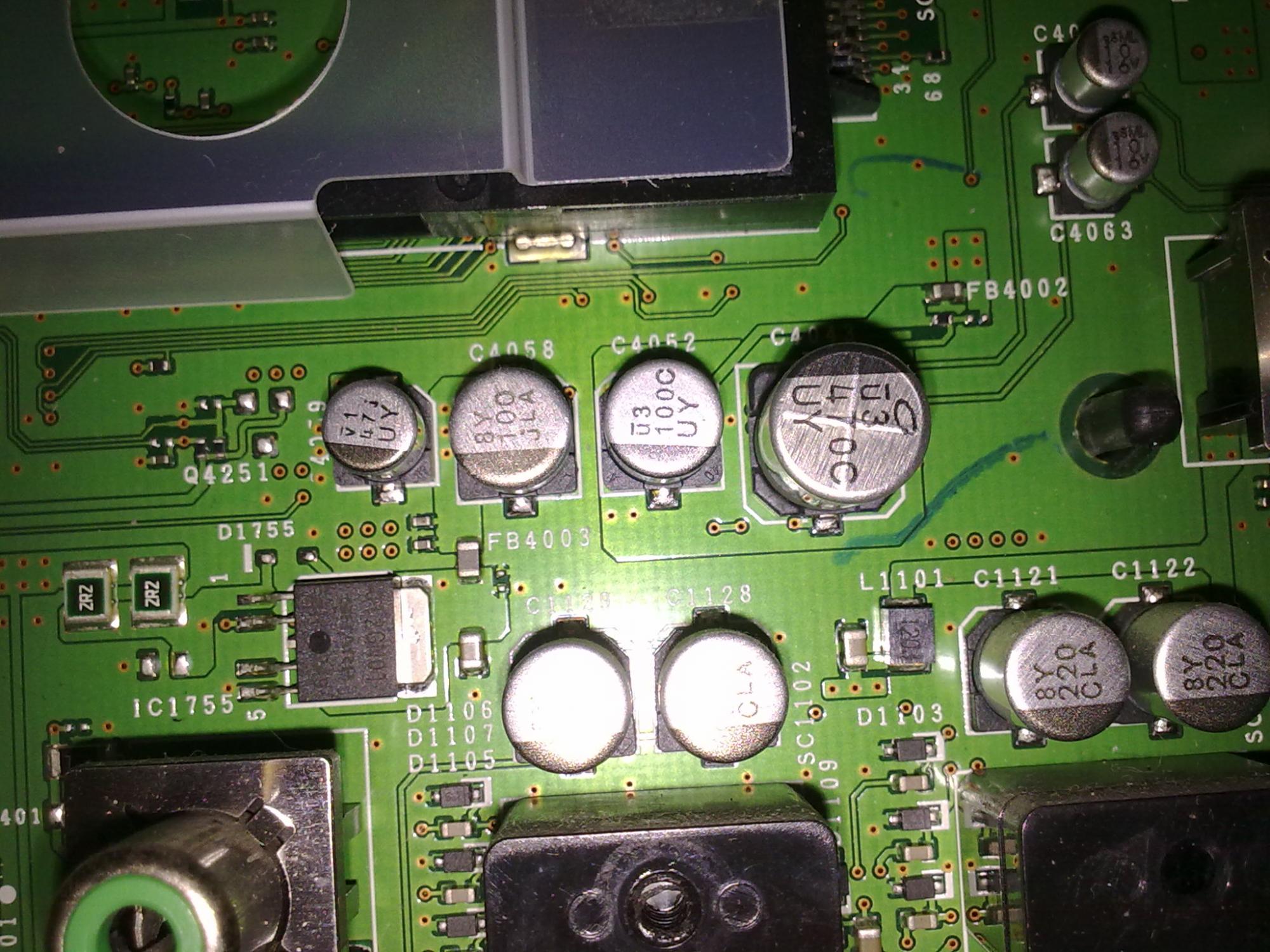

Sharp Aquos 32"
  • rigeback
    replied
    Re: Sharp Aquos 32"
    Made another cold boot check and the t-con is still dead, IC 1755 puts out 3V on one pin so maybe it has a fault, AMP+13V is back on line but otherwise I'm lost! Some of the fuses do read 20-30 mv less across but I don't think this could causing the drop out in the t-con area. I'm considering buying another board but the vendor doesn't have one in stock at present.
    Leave a comment:
  • rigeback
    replied
    Re: Sharp Aquos 32"
    Yes all the fuses had power across but some of the diodes in that area were dead on both sides including the one I was going to remove, seems theres a regulator not working like Q8408 but it also was dead, other parts of the board are mostly OK apart from AMP +13V bottom side, that was also dead.
    Leave a comment:
    replied
    Re: Sharp Aquos 32"
    That might be a standby mode problem. Are you getting good supply voltages from PSU? Same voltage on both ends of fuses? Trace the voltages across the board and see where they disappear.
    Leave a comment:
  • rigeback
    replied
    Re: Sharp Aquos 32"
    Well I didn't remove the diode as yet because I've disscovered that I have no power going to it and the t-con area after leaving the unit on for some time. I've lost power on
    VGH35V and VGL-6V, VCC 1.5V , VCC 3.3V and VLS15.6V any clues to why this has happened much appreciated!
    Leave a comment:
  • rigeback
    replied
    Re: Sharp Aquos 32"
    Tom, I was reading one of you posts within this forum that you recommended heating the board with a hair dryer, I might give this a go myself before de-soldering the diode!
    Leave a comment:
    replied
    Re: Sharp Aquos 32"
    Originally posted by rigeback
    After re-testing the diodes and going back to Toms message with picture #1 it seems there could be a bad diode, far right next to the ribbon connector, it measures 174 com / cathode and 280 opposite, would this suggest its shorted since the most of the others measure infinity "1"?
    You will have to remove it and re-test, as the rest of the circuit could be altering the measurement.
    It is probably okay; most diodes fail shorted, although there is the possibility a diode could become "leaky" if it fails.
    Leave a comment:
  • rigeback
    replied
    Re: Sharp Aquos 32"
    After re-testing the diodes and going back to Toms message with picture #1 it seems there could be a bad diode, far right next to the ribbon connector, it measures 174 com / cathode and 280 opposite, would this suggest its shorted since the most of the others measure infinity "1"?
    Leave a comment:
  • rigeback
    replied
    Re: Sharp Aquos 32"
    These are the last schematics of the manual if someone can point me in the right direction, thanks.
    Leave a comment:
  • rigeback
    replied
    Re: Sharp Aquos 32"
    And this is part of part 6 of the Sharp 26"
    Happy New Year Everyone.
    Leave a comment:
  • rigeback
    replied
    Re: Sharp Aquos 32"
    I've uploaded this manual in 5 parts incase anyone wants to have a look, I know its the holidays but please keep me in mind, part will uploaded later!
    Leave a comment:
  • rigeback
    replied
    Re: Sharp Aquos 32"
    IC2303 From top side pin1 & Pin2 = 3.24 Pins 3 & 4 = 0 volts and pin5 = 0.30V athough when I probe pin5 the back light of the screen suspends for a few seconds with a hissing noise and then returns.
    IC4202: Pin1 = 3.20 pin2 = 3.18V Pin3 = 2.44V Pin4 = 1.21V Pin5 = 0 Volts
    I've indicated measurements for both IC's but there are very slight veriations:
    IC1745 Pin1 = 7.15v Pin 2 = 12.97V pin3 = 3.17V pin4 = 0V Pin5 = 0.79V Pin6 = 1.33V pin7 = 3.07V pin8 = 1.97V
    IC1735 Pin1 = 8.77V Pin 2 = 12.87V pin3 = 4.88V pin4 = 0V Pin5 = 0.79V Pin6 = 1.40V pin7 = 3.07V pin8 = 1.97V
    IC1755 Pin1 = 2.86V Pin 2 = 2.14V pin3 = 1.18V pin4 & 5 = 0 Volts Both fuses 1.7 ohms
    The IC4410 just below C4420 has 5 Volts on pin5 the rest are 0 Volts, test pont 3.3V has 3.29 volts
    Last edited by rigeback; 12-28-2011, 06:05 AM. Reason: ID number
    Leave a comment:
    replied
    Re: Sharp Aquos 32"
    I haven't looked at the service manual yet, but I think tom66 has the right idea to check the rest of the voltage regulators. I see a few more.
    Starting with this picture, check IC2303 (left-middle side of the picture, close to the 2 electrolytic capacitors):
    https://www.badcaps.net/forum/attach...6&d=1324947839
    On this picture measure voltage on the pins of IC4202:
    https://www.badcaps.net/forum/attach...3&d=1324944651
    I wonder what the 8-pin ICs with v5805 do. Check voltages on all pins and post back. I wonder if these could be 5v linear regulators.
    https://www.badcaps.net/forum/attach...4&d=1324944651
    Measure voltage on IC1755 and check the 2 fuses to the left of it.
    https://www.badcaps.net/forum/attach...5&d=1324944651
    Lastly, measure voltage on the pins of the IC between the antenna input jack and the card slot. The IC is right below electrolytic capacitor C4420. There's also a 3.3v test point to the right of C4420. Check if that test point gets 3.3v.
    https://www.badcaps.net/forum/attach...2&d=1324333526
    Leave a comment:
  • rigeback
    replied
    Re: Sharp Aquos 32"
    Originally posted by rigeback
    Yes you're right there is a fuse that measures 3.8 ohms and 2 others that 2.2 ohms, the rest are between 1.0 - 0.9 ohms.
    I've quoted all the measurements because mine are slightly higher than yours!
    For Sharp IC-1726 Pin 1 = 12.91V Pin2 = 3.6V Pin3 = 8.16V Pin4 = 2.62V Pin5 = GND
    For IC1701 Pin1 = 1.21V Pin3 = 4.29 Pin4 = 3.91V Pin5 = 3.25V
    Thanks for the help.
    I forgot to mention that the diodes you outlined were all OK.
    Leave a comment:
  • rigeback
    replied
    Re: Sharp Aquos 32"
    Yes you're right there is a fuse that measures 3.8 ohms and 2 others that 2.2 ohms, the rest are between 1.0 - 0.9 ohms.
    I've quoted all the measurements because mine are slightly higher than yours!
    For Sharp IC-1726 Pin 1 = 12.91V Pin2 = 3.6V Pin3 = 8.16V Pin4 = 2.62V Pin5 = GND
    For IC1701 Pin1 = 1.21V Pin3 = 4.29 Pin4 = 3.91V Pin5 = 3.25V
    Thanks for the help.
    Leave a comment:
    replied
    Re: Sharp Aquos 32"
    Okay... lots of checks... and this is the first image. If these checks pass, we'll have a look at the rest.
    RED circled components are diodes. With the TV off (no standby, either) use the diode test setting to check if the diode is shorted. It should measure from 150-600 one way and infinite ("1 ." or OL) the other way. If it measures less than 30 both ways, it is definitely shorted and this will cause a supply on the board to not function.
    The BLUE circled components are all resettable fuses. These fuses temporarily trip if current is exceeded; when the current subsides or after a period of time, they will reset (like a circuit breaker). However, due to their nature of operation (rapid heating), if they are subject to many trip cycles they can permanently fuse and fail open. Test using your multimeter's ohm range. A polyfuse less than 3 ohms is good (most polyfuses have a significant, non-zero resistance, of a couple ohms.)
    The GREEN circled component is a Sharp voltage regulator (fancy that, Sharp use their own parts. Beats an LG plasma I have seen which used Panasonic driver ICs for the Y-sustain. Heh.) All measurements relative to the case of the TV, board installed, and TV turned on with fault. Pin #1, counted from the left as in the image, is the input, measure this. Pin #2 is the ON/OFF pin, it should measure >2.0V. Pin #3 is the output, it should be >1.2V (we'll determine exact output later.) Pin #4 is the voltage adjustment terminal, it should be ~1.2V. Pin #5 is ground, don't worry about measuring this, and the metal tab is the output pin - be very, very careful not to short input to output or you could fry your board - use the tab to measure the output voltage if it makes it easier.
    Leave a comment:
  • rigeback
    replied
    Re: Sharp Aquos 32"
    I hope these will identify the parts that you mentioned, I added one extra near the scart connectors,
    Cheers.
    Leave a comment:
    replied
    Re: Sharp Aquos 32"
    Originally posted by rigeback
    Tried connecting the PC again with softMCCS http://www.entechtaiwan.com a good little program to learn what the software is doing inside the TV but it does not see the LCD and its now obvious that there is no power at the serial connector nor SCART / HDMI connectors, this area is dead! Need to find the supply point??
    You might have a bad LDO or a bad switching controller/diode.
    Post some close ups of the areas highlighted...
    Leave a comment:
  • rigeback
    replied
    Re: Sharp Aquos 32"
    Tried connecting the PC again with softMCCS http://www.entechtaiwan.com a good little program to learn what the software is doing inside the TV but it does not see the LCD and its now obvious that there is no power at the serial connector nor SCART / HDMI connectors, this area is dead! Need to find the supply point??
    Leave a comment:
  • rigeback
    replied
    Re: Sharp Aquos 32"
    Sorry I got side tracked thinking I was looking for an 8V signal due to the way its printed on the board, I was reading that this problem could be related to the HDMI system?
    Leave a comment:
    replied
    Re: Sharp Aquos 32"
    Originally posted by rigeback
    All the tests were good except for BU 1.8V and BU+1.8V lines seems to have a problem there is only 1.78 Volts on these test points so I think one of the IC's might be bad.
    No, those voltages are right. BU1.8V should be 1.8v. 1.78V is close enough.
    I will look tomorrow for other things to look at. Seems the t-con is working fine.
    Leave a comment:
  • scubacamper
    Sharp Aquos LC-70C6400U Half Screen Dark
    by scubacamper
    I found another post on this site the other day which has been very helpful in troubleshooting this issue I am having with my tv. The left half of the screen is dark, and the other half is VERY slow to generate it's image - and it only generates part of its image at that.
    Based on this yt video, I have narrowed it down to an issue (short?) on the left side of the display, somewhere in the system of ribbon cables.
    when I remove the bezel and the rear cover, I can get the image to display correctly by manipulating the ribbon cables on the left side which connects the left lower display...
    05-03-2025, 12:19 PM
  • sefoster
    Sharp Aquos Lc-80LE757U flashing Sharp on screen when plugged in
    by sefoster
    I have a Sharp Aquos LC-80LE757U that randomly made a loud popping noise when when watching TV one day. We found that the fuse blew and the thermistor. We ended up replacing the entire power supply board and have also replaced the TCON board. Now as soon as I plug the TV in it lights up and has the Sharp logo flashing on and off of the screen. If I unplug the ribbon cable from the TCON board to the main board I get the 2 long 5 short error code. Any ideas on where to go from here? We've tried resetting it but nothing has worked. If we plug it in and let it cycle through the flashing of the Sharp...
    11-20-2022, 09:29 AM
  • jonah1024
    Sharp Aquos LC-40UG7252E LCD TV burn in?
    by jonah1024
    Hello!
    I'm a few days old into this TV screens repair universe so please bear with me.
    Recently, and all of a sudden my 40ā€ 4K Sharp Aquos LCD TV turned on with colors all smudged in some places on the screen that remain like that even without any kind of video source. I do have image but the colors are smudged/tinted/ washed out in patches as per defects. This to me looks similar to burn in but I’m shore this is not an OLED.
    - I did the classic unplug and hold power button to discharge the caps but it didn't help.
    - I did a factory reset as well...
    07-16-2024, 04:23 AM
  • klassic
    Sharp Aquos LC-60LE635E three blinks
    by klassic
    Hi community,
    I will describe my problem with a TV in those short following terms to be the most precise :
    What i have :
    Sharp Aquos LC-60LE635E
    power board DPS-162KP-1
    main logic board QPWBXF733WJN2
    symptoms :
    white led light logo at startup,
    after 2 minutes, blinking 3 times a row, repeating
    no backlight (and apparently no picture, checked panel with flashlight)
    no startup sound
    powerboard investigations :
    1-2 PNL : 0v
    3-4 GND
    5-6-7-8 UR : 13.15v
    9-10-11-12...
    10-24-2023, 01:39 PM
  • foxyUK
    Sharp Aquos LC-32LE600E, No 12v as no PNL_POW
    by foxyUK
    Can anyone help me diagnose this? Almost not worth bothering with, but it has 'sentimental value' for the owner. I'm no TV technician, but dabble a bit.
    The TV has standby power but no reaction at all to switching on or reboot steps, No flashing lights or response to menu button. All voltages on the power board are correct apart from missing voltage on pin 12 of CN7003.
    There is 13 v on U7053 but no 3v signal to switch it on. I don't really understand whether the 3v should come from U7401 in the standby control area, or (as suggested elsewhere) from the mainboard via pin 12....
    10-22-2024, 10:27 AM
