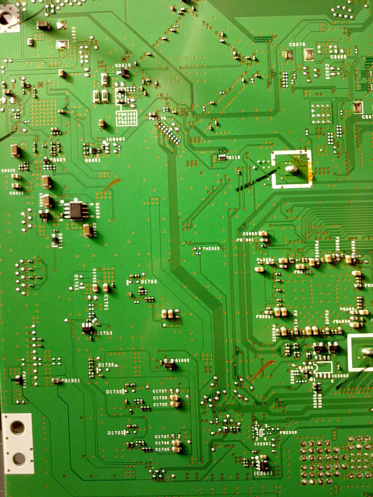

        Originally posted by momaka
        I haven't looked at the service manual yet, but I think tom66 has the right idea to check the rest of the voltage regulators. I see a few more.
        Starting with this picture, check IC2303 (left-middle side of the picture, close to the 2 electrolytic capacitors):
        https://www.badcaps.net/forum/attach...6&d=1324947839
        On this picture measure voltage on the pins of IC4202:
        https://www.badcaps.net/forum/attach...3&d=1324944651
        I wonder what the 8-pin ICs with v5805 do. Check voltages on all pins and post back. I wonder if these could be 5v linear regulators.
        https://www.badcaps.net/forum/attach...4&d=1324944651
        Measure voltage on IC1755 and check the 2 fuses to the left of it.
        https://www.badcaps.net/forum/attach...5&d=1324944651
        Lastly, measure voltage on the pins of the IC between the antenna input jack and the card slot. The IC is right below electrolytic capacitor C4420. There's also a 3.3v test point to the right of C4420. Check if that test point gets 3.3v.
        https://www.badcaps.net/forum/attach...2&d=1324333526
        Mr. Momaka please swing by when you have a chance regarding the results for the above, thanks in advance and happy new year.

            master hoarder
            • May 2008
            • 12170
            • Bulgaria
            #45
            Re: Sharp Aquos 32"
            Originally posted by rigeback
            could be this be a duff screen or control switch??
            Maybe, but I doubt it.
            Will connect and re test each component next!
            Yes, do that and see if the voltages disappear again.

              Aaaand I just went through all of the schematics... whew.
              There's so many things to check I don't even know where to start. It seems this TV uses at least a billion voltage regulators.
              Since there's so many of them, I suggest you cycle the power to the TV every now and then, as in every 5 minutes. The reason for this is to prevent the TV from entering standby after a certain time (if it even does that). Ideally, it would be best to cycle the power before testing each regulator, but that's way too many cycles and is bad for the PSU, so cycling power every 5 minutes should be okay I think.
              Also, disregard my post above about the voltage regulators. Segments 003, 004, and 005 of the schematics you uploaded in post #28 tell you all of the voltages that should be present on each voltage regulator.
              Before you begin, take a note of how the schematics are drawn. Note that all of the power rails are drawn with thicker lines - these are the only rails we are interested in right now. Also, for most regulators, the output pin is denoted with Vo, the input as Vin, and ground as GND. On some of the regulators, like IC1702, IC1735, and IC1745, the output is denoted with SW, however you cannot measure the voltage on that pin since it is SWitched (i.e. pulsed DC). For these you measure at the output capacitors... I will tell you on which capacitors to measure.
              I think the best place to start is page 1 of schematic Segment 005 since it has most of the voltage regulators. You will check the voltage on each and make sure it's good. I compiled a list of all of the voltage rails and which IC/voltage regulator is responsible for these rails:
              B+3.3V --- IC1745 (for this one, measure the output voltage at capacitor C1745 or C1746, otherwise you may get erroneous results)
              BU+5V --- none. BU+5V seems to come from BU5V (pin 11 of connector P1701) through two 1-Ohm resistors in parallel (resistors R1712 and R1711). Check to see if the resistance of these resistors is good. Should be under 3 Ohms, depending on how low your multimeter can measure.
              B+ANT5V --- IC1725
              S+8V --- IC1726
              BU+3.3V --- IC1701
              B+5V --- IC1735 (for this one, measure the output voltage at capacitor C1735 or C1736, otherwise you may get erroneous results)
              B+1.8V --- IC1756
              B+1.2V --- IC1755
              BU+1.8V --- IC1702 (for this one, measure the output voltage at capacitor C1706 or C1707, otherwise you might get erroneous results)
              Next, look on page 8 of schematic Segment 003, lower left corner. The following ICs should have the following voltages:
              IC202: Pin 4 (Vin) = 5V, Pin 5 (Vo) = 3.3V
              IC204: PIN 1 (Vin) = 3.3V, Pin 5 (Vo) = 2.5V
              IC205: PIN 1 (VDD) = 2.5V, Pin 5 (Vo) = 1.0V
              After this, look on page 4 of schematic Segment 004, lower right corner. IC4202 produces the B+2.5V_ST rail (a 2.5v standby rail - should be there whenever the TV is plugged in). Measure voltage on the following pins of IC4202: Pin 1 (Vin) = 3.3V, Pin 3 (Vo) = 2.5V
              Finally, move to Page 5 of schematic Segment 004.
              IC4410: Pin 6 (IN) = 5V, Pin 1 (Out) = 5V (only if Pin 3 (EN) is higher than 1.8V). IC4410 is not actually a regulator but a switch.
              And that's all the regulators I saw so far. Also check VLS15.6V, VGH35V, and VGL-6V again. Let me know if any of the voltges are missing or way out of spec. Out of spec would be +/-5% of the stated voltage value.

              • rigeback
                • Mar 2011
                • 421
                • Malta
                #47
                Re: Sharp Aquos 32"
                One thing I can confirm is when I connect the screen ribbons I loose power to the t-con area VLS15.6V, VGH35V, and VGL-6V.
                I have removed the ribbon connectors for the tests since some of the parts are located on under side of the board.
                • rigeback
                  • Mar 2011
                  • 421
                  • Malta
                  #48

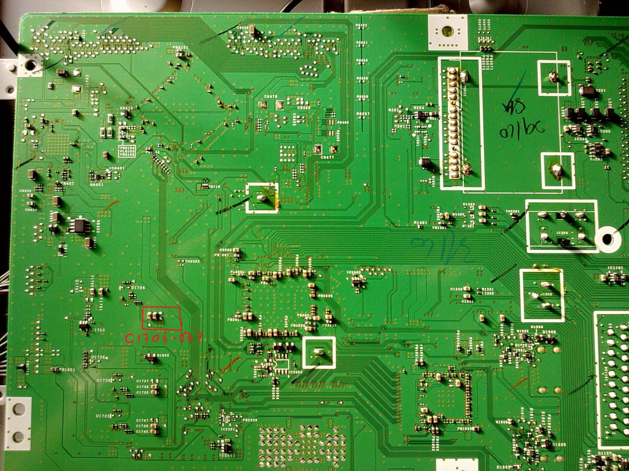

                  Re: Sharp Aquos 32"
                  Hi Momaka, most of the checks went well although I could not find C1706 or C1707, seems they forgot to print the board or I need new eyes or specks! the attached photo illustrates what I believe is the location.
                  IC4202: Pin 1 (Vin) = 3.21V, Pin 3 (Vo) = 0.0V I think it has a problem
                  Finally, move to Page 5 of schematic Segment 004. IC4410: Pin 6 (IN) = 5V, Pin 1 (Out) = 5V (only if Pin 3 (EN) is higher than 1.8V). IC4410 is not actually a regulator but a switch.
                  Here again IC4410: Pin 6 (IN) = 5V, Pin 1 (Out) = 0.00V Pin #3 also 0.0V
                  Bear in mind that the screen connectors were disconnected for all the above since the board had to be rotated anyway.

                    #49
                    Re: Sharp Aquos 32"
                    Looks correct to me.
                    Yes, that's a problem. Check voltage om pin 2 (SW) and pin 4 (Vref) of IC4202
                    That one is fine. If the voltage on pin 3 (EN) is less than 1.8V, them the voltage on pin 1 (out) will also be 0V.
                    • rigeback
                      • Mar 2011
                      • 421
                      • Malta
                      #50
                      Re: Sharp Aquos 32"
                      I must have miss probed this one as its okay today Pin 1 (Vin) = 3.21V, Pin 3 (Vo) = 2.45V pin 2 = 3.20V and pin 4 = 1.22V.
                      I re tested every thing and I found some lower values on VGH35V = 30.2V and also on the 2 fuses Next to IC1755 are 3.20V-2.80V both fuses same values across?
                      B+ANT5V --- IC1725
                      And finally IC1725 = on pin 6 is 7.56v and the rest are 0.0 Volts??
                      Thanks for all the help.
