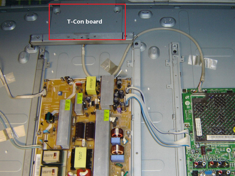

        The t-con (timing-control) board is usually replaceable, and fairly cheap (depends on the LCD model).
        Ebay would be your best bet to get one.
        I'd give it a shot and replace the t-con board first. If it turns out to be all that's wrong with the set, don't forget about the caps on the powersupply board (knowing what junk caps Samsung always uses..)
        edit: I forgot.. The T-Con board is usually in the top center at the back of the LCD itself. On screens this size it's hidden by a metal cover most of the time (see attachment for an example.. also a 40" Samsung btw)

            Ok, got the back of the tv and had a look 1st at the caps on the PSU - none seem to be bulging so straight to the tcon board. The board in this unit is a t400hw01 V0 checking on eBay I see some boards, with different V numbers - is this version? are they interchangeable?
            I have noticed that the vertical lines appear in different locations on the screen if I turn it on and off multiple times. Also, the lines fade out to black after about 15-20 seconds.
            Does this point to anything in particular?
