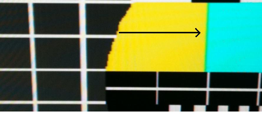

          Connected up the laptop today and fed in a decent testcard image to see just how bad the ghosting actually was with a good signal.
          The ghosting isn't that noticable and even less so in a photograph. However I did notice there is a bit of a problem between the yellow and cyan squares, a green vertical line like the colours were mixing.
          See attachment

            ^Probably another stupid image enhancer. Try turning off edge enhancement or sharpness down to minimum.
