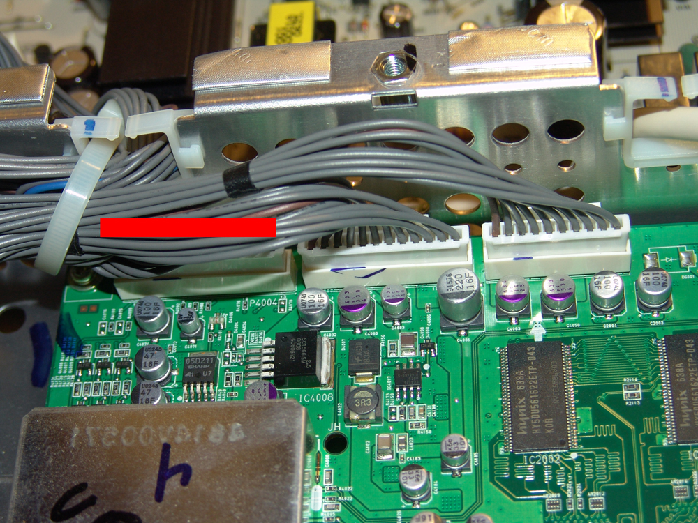

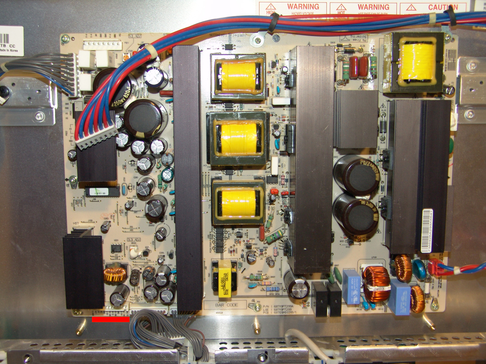

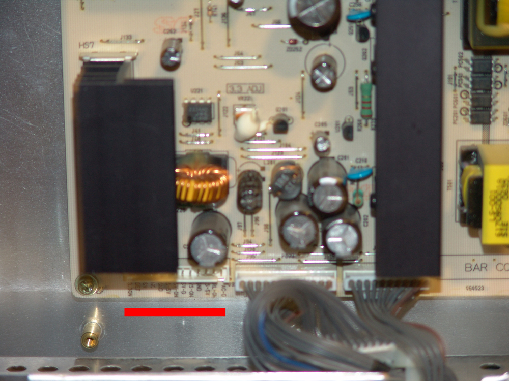

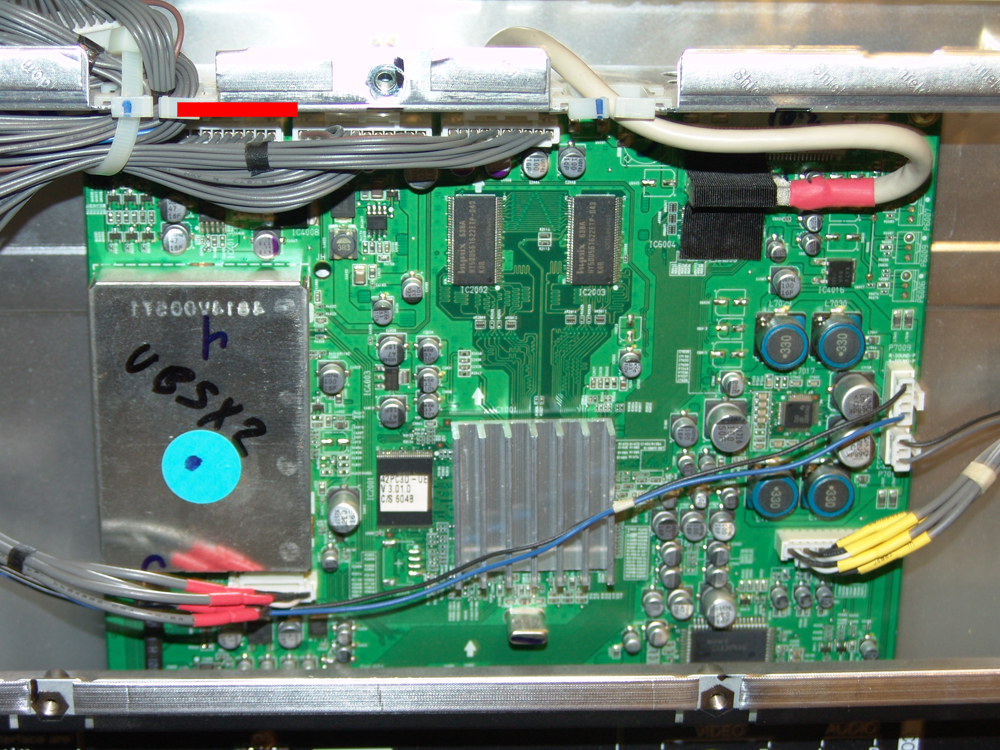

                It's the first cable the goes from the power supply to the AV board (out of the 3 connectors that go from the power supply to the AV board)
                It's a 13 pin connector, below is the labels in order from left to right:
                3.30N , DET , 6V , NC , GND , 5-5V , M5V-ON , 5V-D , VS-ON , GND , 5-5V , RL-ON , AC-D

                    • Peter9DO
                      • Dec 2011
                      • 277
                      Re: Lg 42pc3d-ue
                      So the first image is of the power supply where the red line is, is the location of P800. The 2nd image will brings it in a little closer.
                      The 3rd picture is of the AV board again the red line shows where the P800 is. 4th Image brings you in a little closer.
                      I also have the service manual on this TV and I was not able to figure out why it's doing what it's doing other than the z-sus and maybe the AV board is bad.

                        Thanks for the identification. I'll see if I can find P4004 on the schematic and update the thread.
                        EDIT: OK, I was having a senior moment. This time I found the connector. As closely as I can determine, the main board is turning the power supply off. My experience with this chassis was the power supply would work even if the Z-Sustain was disconnected. I agree, you may have a bad Z-sustain and a bad signal board.
