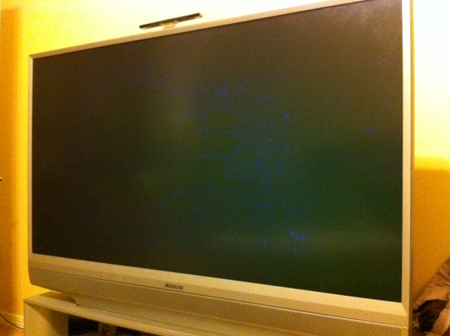

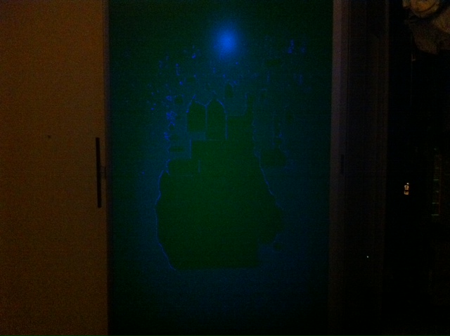

    Okay! not sure if there is a separate thread for DLP or if I've came to the right place! I have a Mitsubishi DLP WD-62530. I'm having an issue where the screen has a yellowish green tint to it. It started slow, first blue blotches all over the screen, then it turned yellow, now the whole screen is yellowish green. NOW there appears to be "water marks" on the screen. I will post some pictures in hopes that someone can please tell me what the problem could be. In the pictures that screen is supposed to be a BRIGHT blue.

    This isn't a DLP, it uses an LCD in the optical engine. And it doesn't seem to be available.

        A DLP set produces its picture using a spinning color wheel:
        http://en.wikipedia.org/wiki/Digital_Light_Processing
        A Projection LCD set (what you have) just shoots light through a tiny, transparent LCD panel and projects the image onto the screen. In your case, there are three LCDs (one for each color) and it looks like the blue died.

          part# 938P054020

            part# 938P054020
            And available here for $345.
