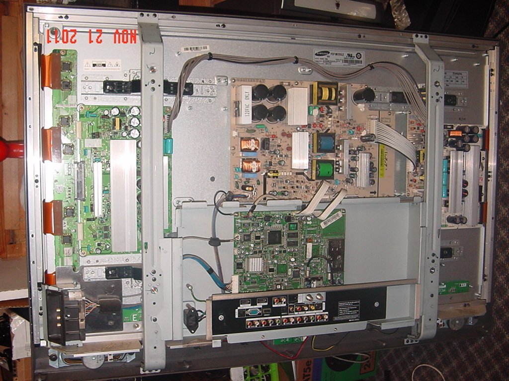

              OK Here we go...
              First, for identification...
              126.jpg is the Model ID...
              118.jpg is the whole enchilada...

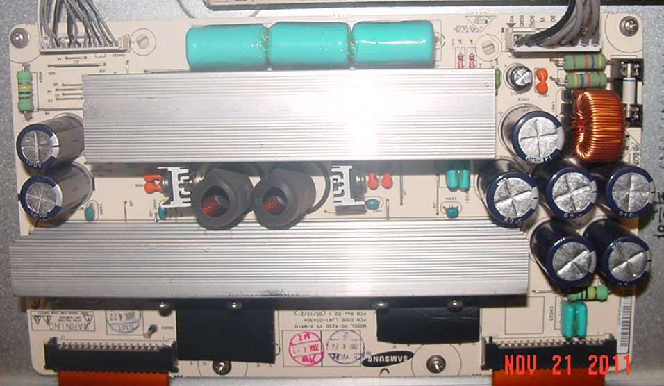

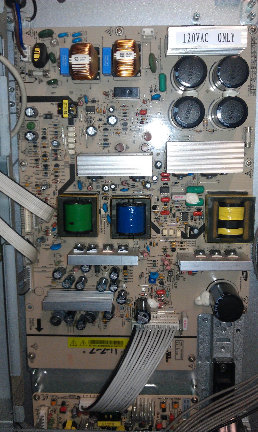

              IMAG0013.jpg is the large Power PCB
              135.jpg is the smaller Power PCB

                Hoo, boy. First, this isn't really worth much effort. It only has 852 x 480 resolution - standard definition. Friday you should be able to buy a new 42" HD TV for $300.
                If you REALLY are determined to spend the time, you will need at least a DMM. Toward the bottom of the picture of the power supply is a 12 pin connector. The function of the pins are labeled. Measure the voltage on each of the pins; use the mounting screw as the ground point. Report the voltages and the description for each pin.

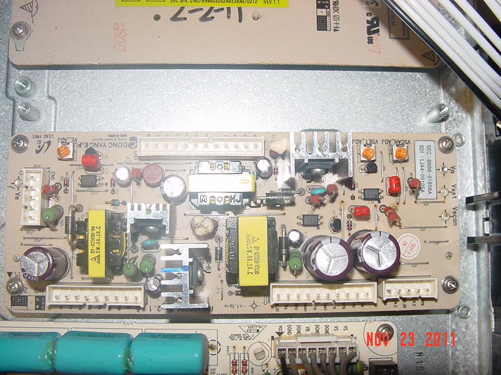

                The picture you called the 'smaller pcb' is the X Main board. There IS a smaller power board just to the right of the main power supply. A Picture of that would be useful - you will probably have to remove the mounting brace to get a clear shot.
                The Y-sustain is at the left side. After you are through measuring voltages, turn the TV off and check the temperatures of the heat sinks on the Y-sustain and the X Main. They should be at least comfortably warm.

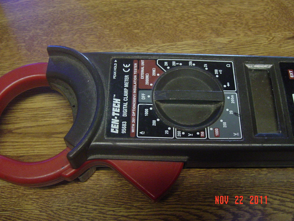

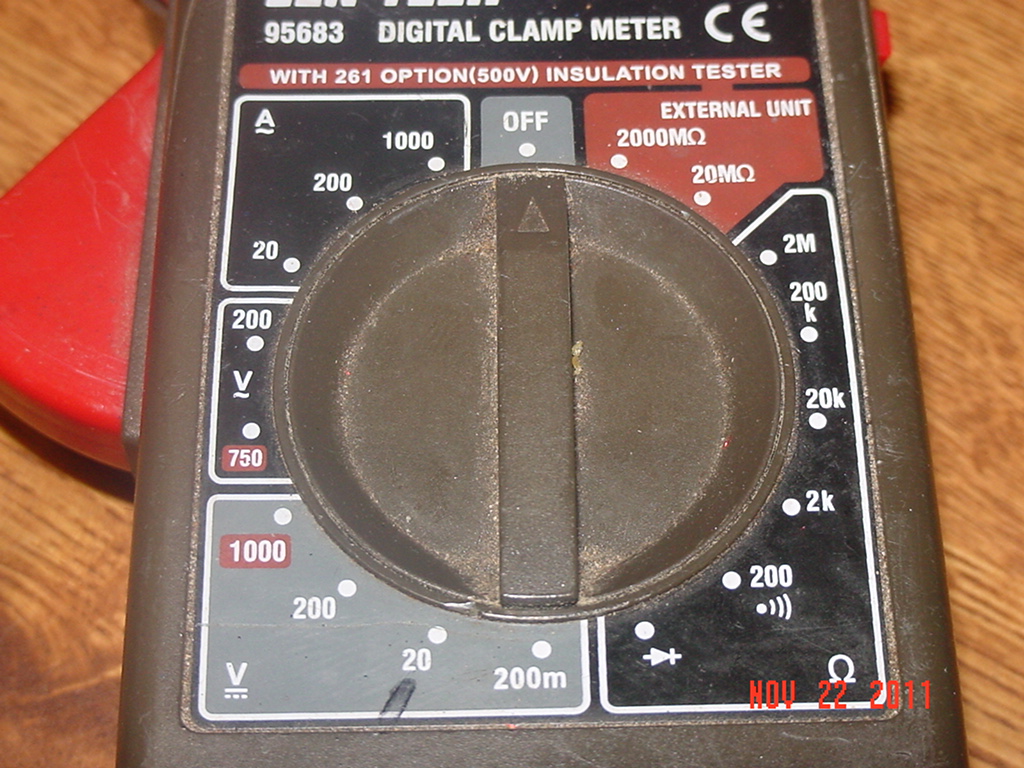

                  I don't mind saying, I have always been a bit wary (ie chickensh*t) of working around hi voltages which is why I usually just replace PCBs. But in this case, I guess it would be a good idea to know WHICH PCB to replace, eh?? If it's going to be too much, I'll just likely go with your advice and chuck it for a new one..
                  The only thing I have to do check voltages is pictured in the attachments.
                  Is that sufficient???

                    Re: Samsung SP-S4243 No Picture 4-Blinks
                    Not the greatest meter, but it will do.
                      OK, here is the smaller Power PCB...
                      Normally when I use this meter for laptop power supplies and such, I use the marked setting (20)
                      I am assuming I need to change the setting for measuring the voltage on this TV... True?
                        Again, many thanx
                        Michale
                        On the back of the panel should be a label with a number of voltages Va, for example. The first step is to verify those voltages are correct on teh output of the main power supply and the outputs of the small supply.. Any other power supply output lines that give an exact voltage (5V, 12V, etc) should also be verified.
