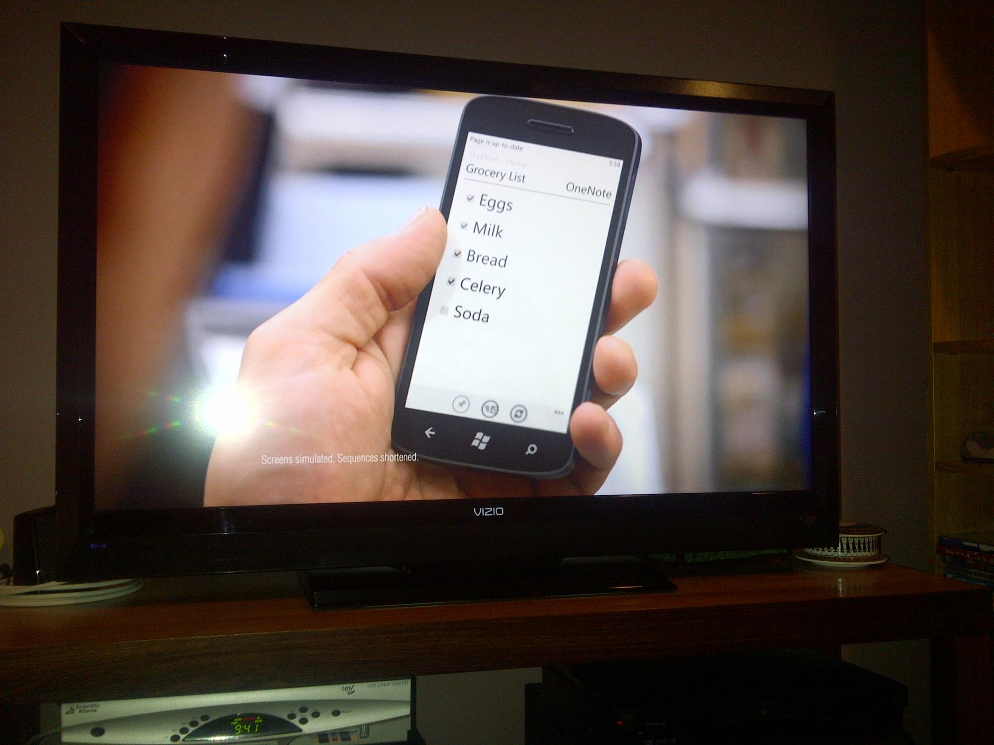

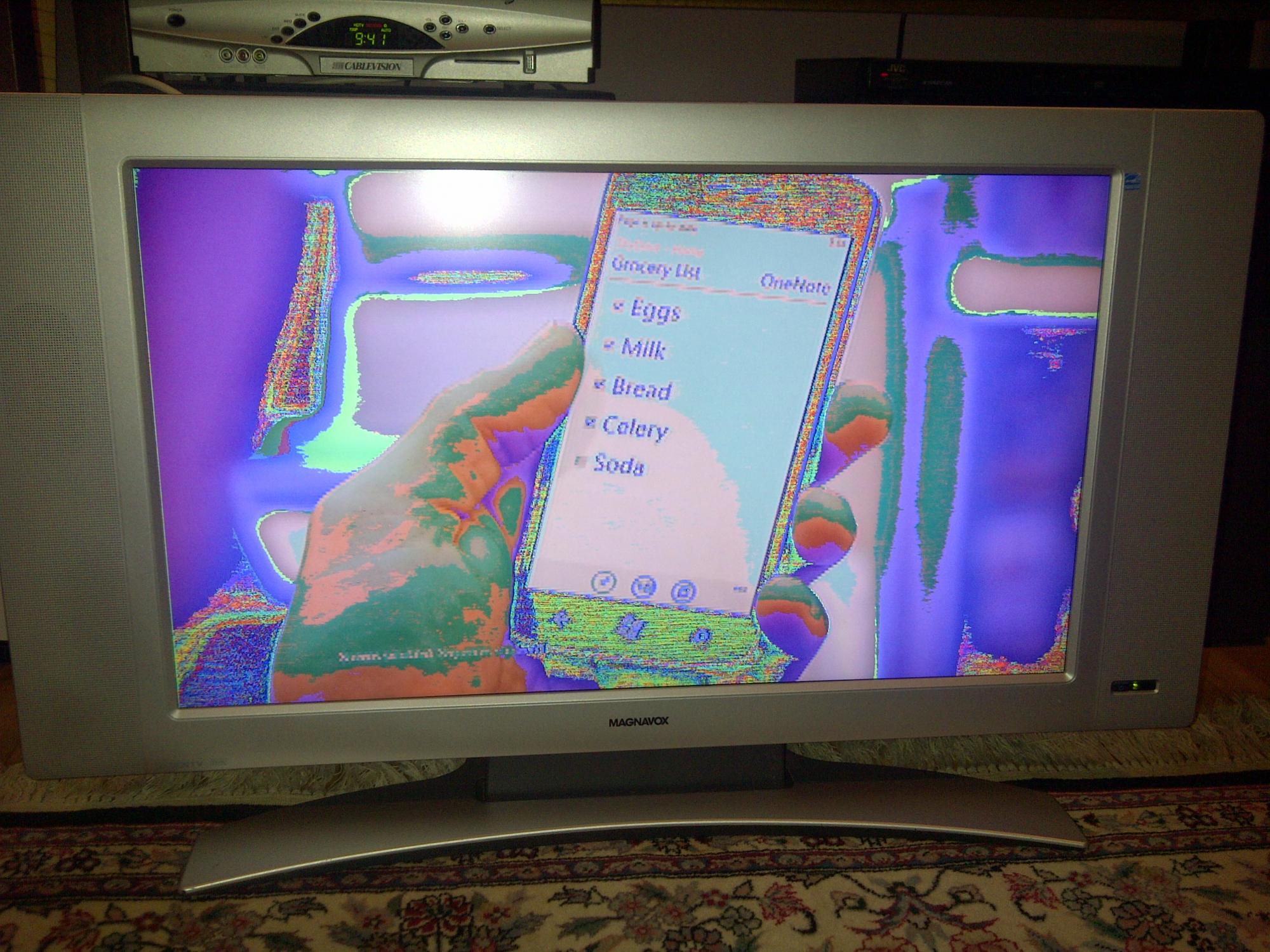

    I replaced two bad caps on this tv that were swollen and leaking, the TV wouldn't even turn on. The caps were on the Power supply board (2079-1200uF, 2081-1200-uF, and 2074-2200uF). No other caps "looked" bad.
    The good news, the TV turned on, the bad news, the picture is very "washed out". Adjusting color, contrast, tint have very little effect on the picture.
    I have attached 2 pictures one of a "good TV and the bad picture.
    Any ideas on what might be wrong? suggestions appreciated.
    Re: Magnavox 32MF231d bad picture
    Ebay Item number: 200677285270
    T-conn board for $15 + $5 shipping. Try this - hurry... it's very cheap and worth the try. I only see one at this price.
      Thanks, works great now!
