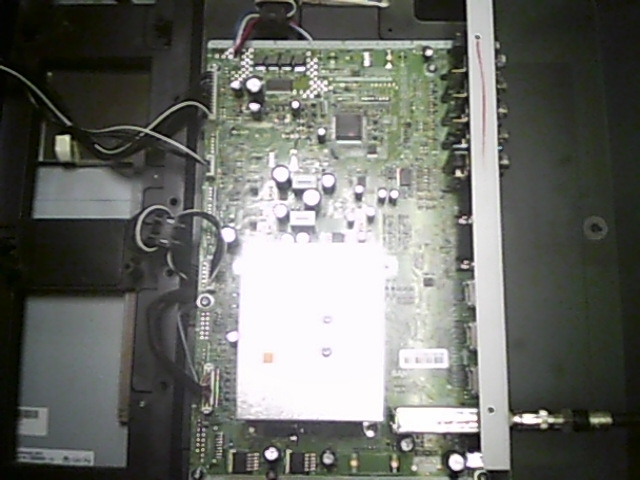

This Sanyo DP42849 will flash and shut down upon start... Still have sound.
No obvious bulging caps. Checked them all and they were good.
The big connector (CN2) have the 5 volt standby, the 12 volt as well as the 13 volt for audio.
The smaller connector (CN6) has the 5 volt standby, BLON is 2.44 volt and the BLDIM is 3.26 volt.
Just to see if this would change anything, I disconnected the BLDIM to see if the backlight would come and stay on... It did not.
I apologize for the quality of the pictures, but it is the only camera that I have...
The boards are as folllow;

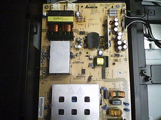

Power is 14V4U20C41500
Main is N7AE
I rang the inverter transformer and it was inconclusive.
The new power / inverter module is pricey and is out of stock most everywhere..
